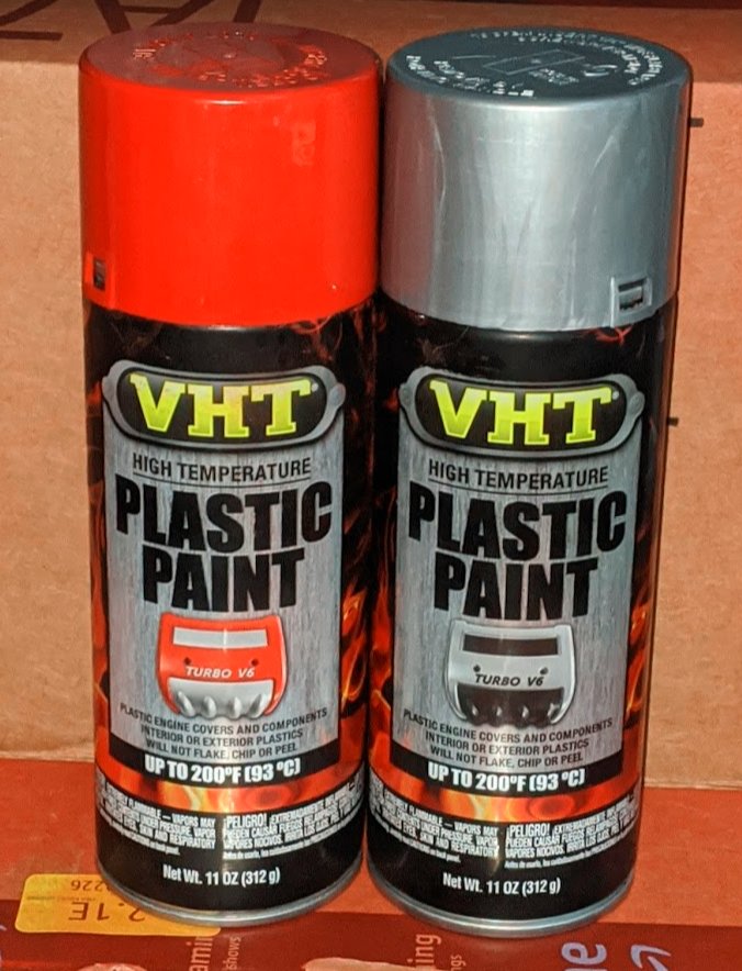

    Did you have to lightly sand the areas you painted?

    No, I did not. Most of the other paints like Rustoleum and Duplicolor recommends scuffing and primer, but the VHT says that it can be applied directly to the plastic without any other prep (other than common sense good cleaning with grease remover and rubbing alcohol with lint free cloth).
