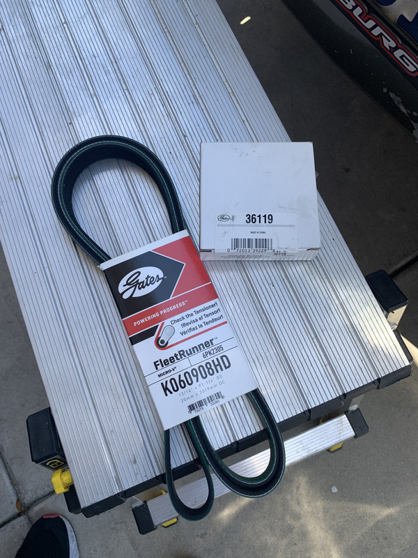

    Replaced the Pcv value, serpentine belt, and tensioner belt pulley. This should fix my cold start Squeak in the mornings. Did the Pcv (replaced with oem), just cause (takes a 7/8 open wrench to remove)
    Went with the Gates green belt and gates pulley (part #36119). Read on another thread that it worked and went with it. Please note o’Reillys will tell you the part number won’t fit the truck and will want to sell you the whole assembly.
    [​IMG]bearing had some play and should fix the issue
