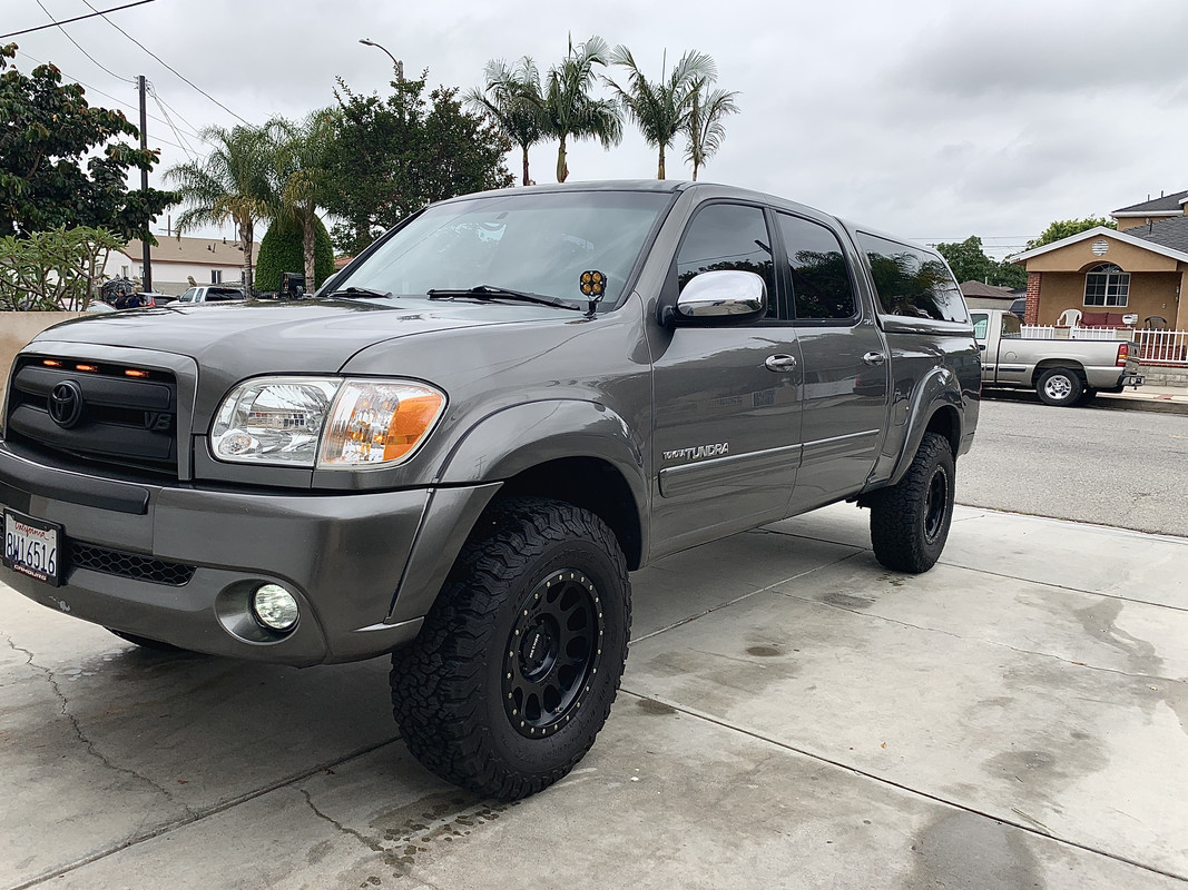

    Oil change, found a loose alternator bolt and a car wash.
