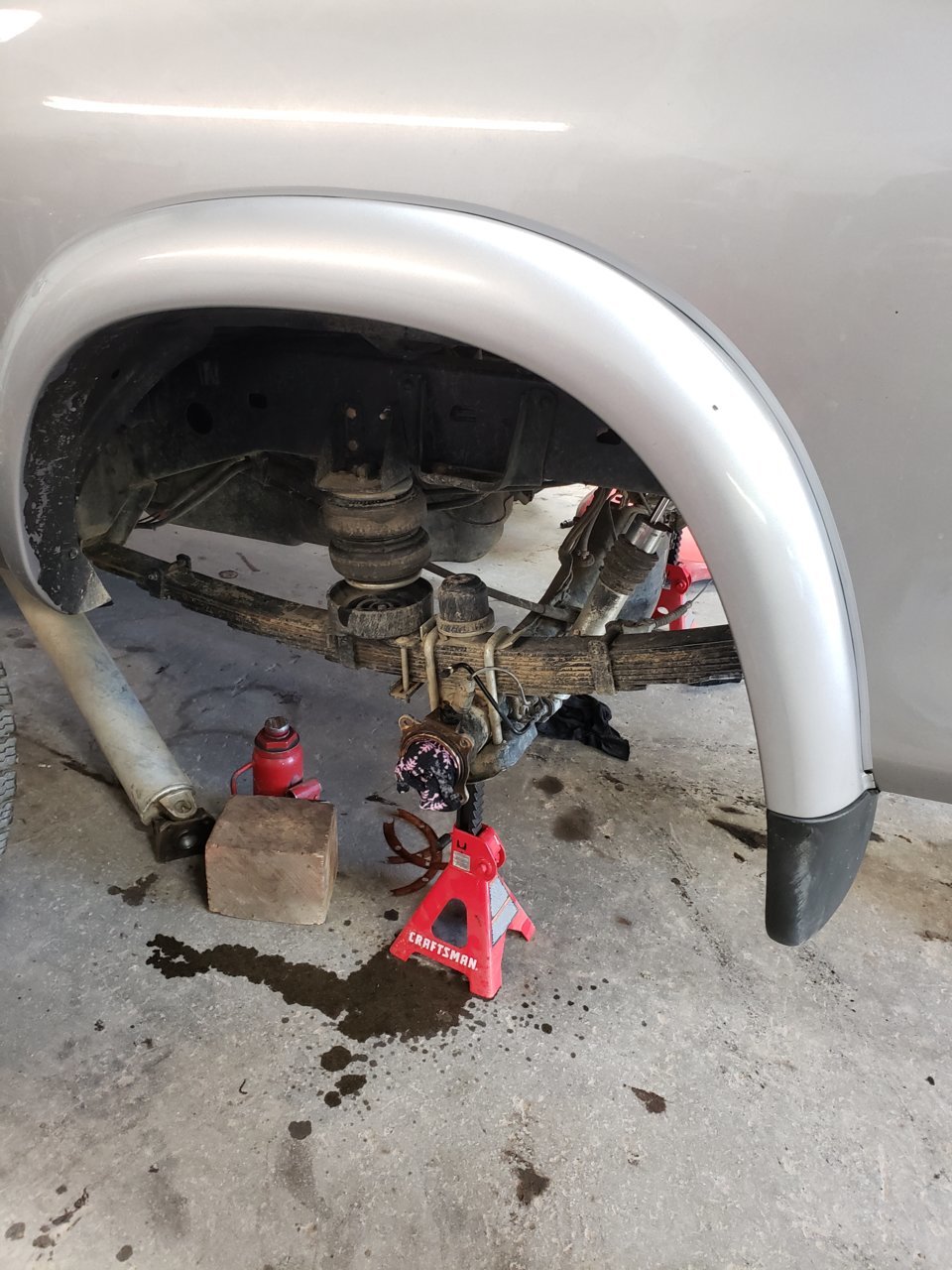

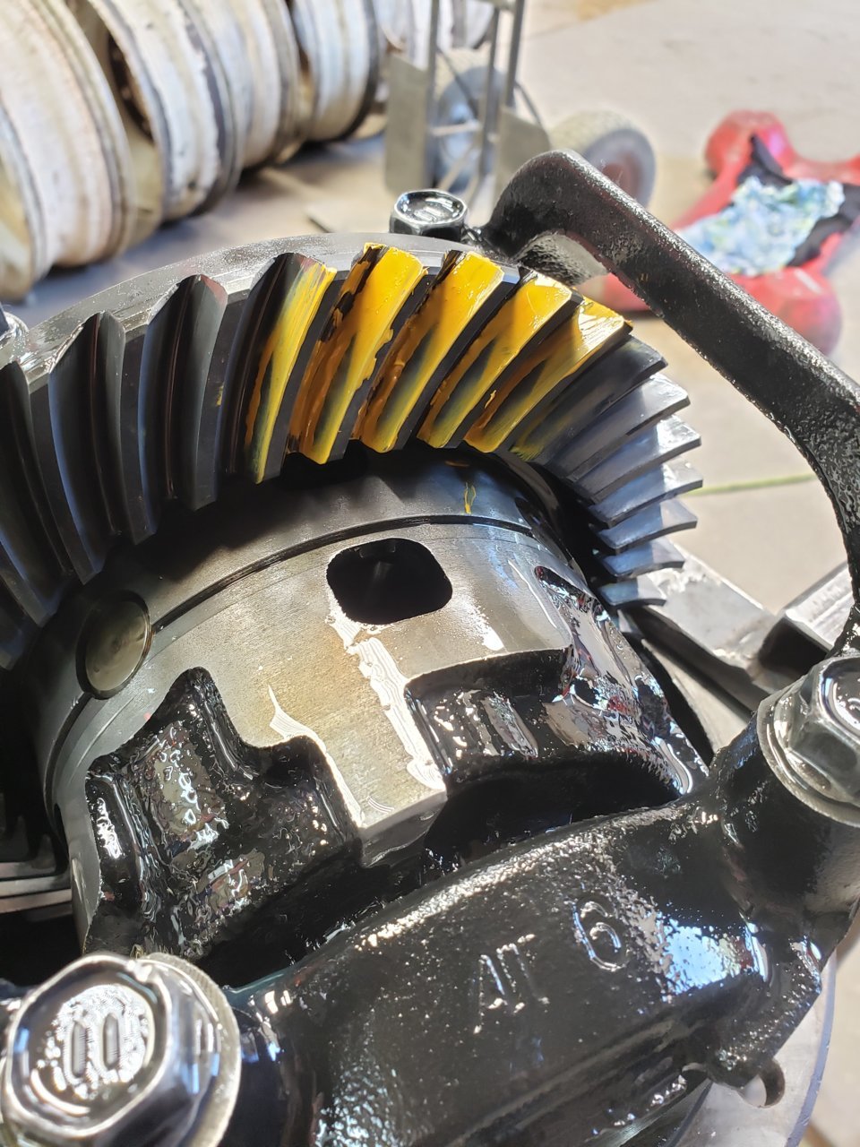

    Pinion depth is wrong.
    I'd recommend setting up a solid pinion spacer while you're at it.
    Lol. Or me... just sayin'.

    I had the solid spacer installed by the shop the second time I brought the diff to them.

    I'd double check their setup of it then. Given everything else was wrong...

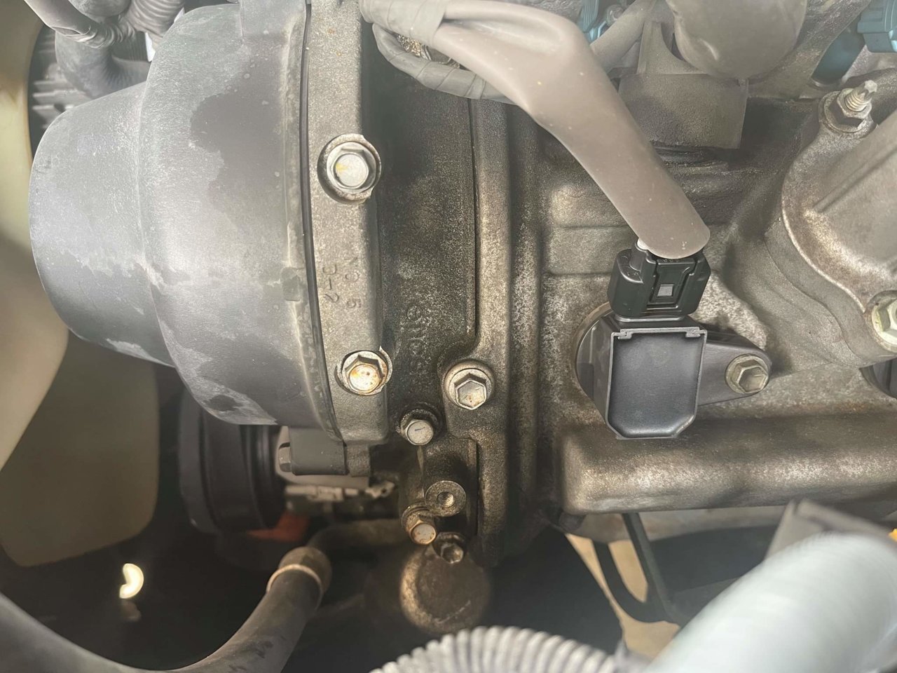

    192130314_10159137362920275_224569775151_7d52c0c27072d705ac60cc0bfad0d343aa25f4eb.jpg
    next up is valve cover gaskets. Aside from the VC gaskets, are there any other gaskets ill need? Ive read its like a 6 hr job for stealerships, so what am i getting myself into? Link appreciated. Are the cam pulley covers a seperate gasket?

    6 hours? It's not THAT bad. Just be careful with the bolts. 20 INCH lbs, not ft/lb.

    It doesnt look that bad, dunno where i got that time from, but ill get some hoses just in case i crack one while trying to remove things.

    Oh, and get you some wire or something to get everything up and out of the way. Makes it easier. Like this:

    I dont have to pull the manifold do i? Maybe the dipstick.
