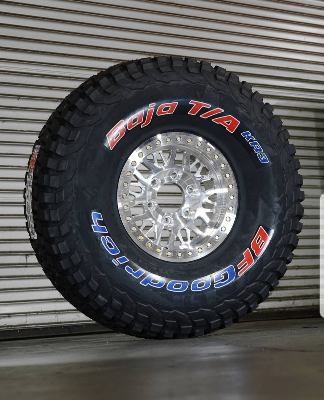

    Todd Wiley takeoffs? No idea if he's still racing or whatever but he was running huge tires on that Chevy. 42" maybe? Haha that would be a good Photoshop.

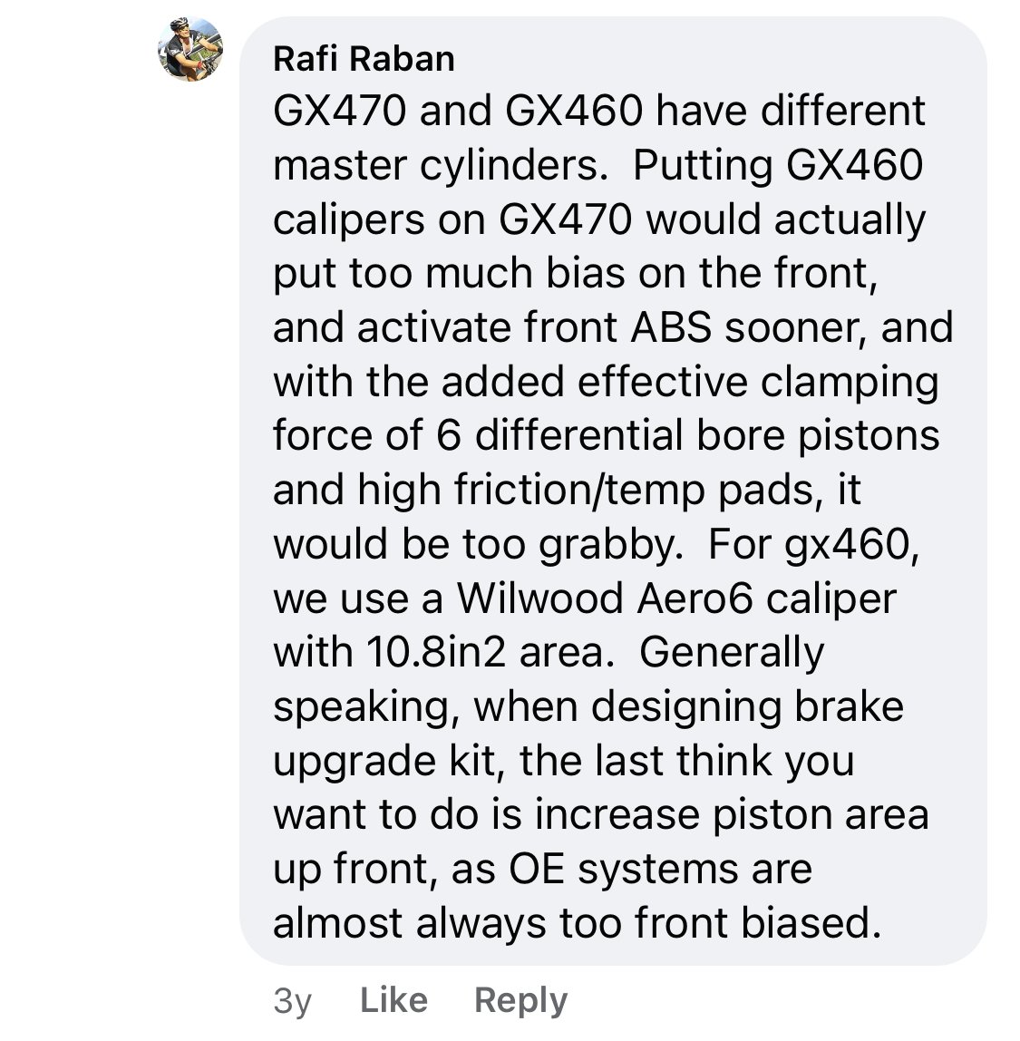

    East TN
    2002 AC TRD 4x4 V8
    Adjusting the LSPV has done literally nothing for me. Hasn't helped a bit.
    FrenchToasty likes this.

    Yes. If I do anything at this point, I'll go back down a size to 13WL calipers. I found this post on TacoWorld. It's not about our trucks but I think he might be onto something in that last sentence.
