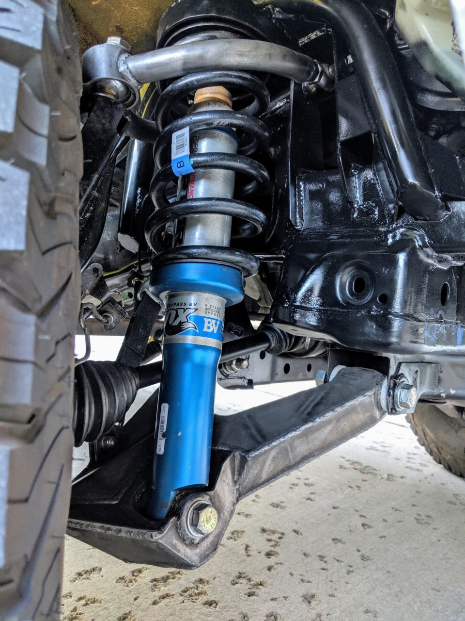

    I haven't seen anybody use those but I have looked them over before. For my truck they wouldn't work.
    Those would only work with SPC arms or long travel kits with hiem joints on the pivots. Maybe JBA arms, I'm not sure if those have adjustable ball joints.

    I ran my own version of those. I adjust caster and camber with my upper arms now. Kinda hard to see but I welded the slot closed with some moon kinda shaped filler pieces and did some weld washers over that. Same concept more or less.

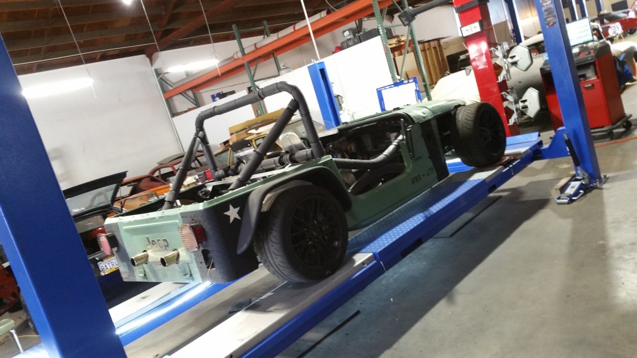

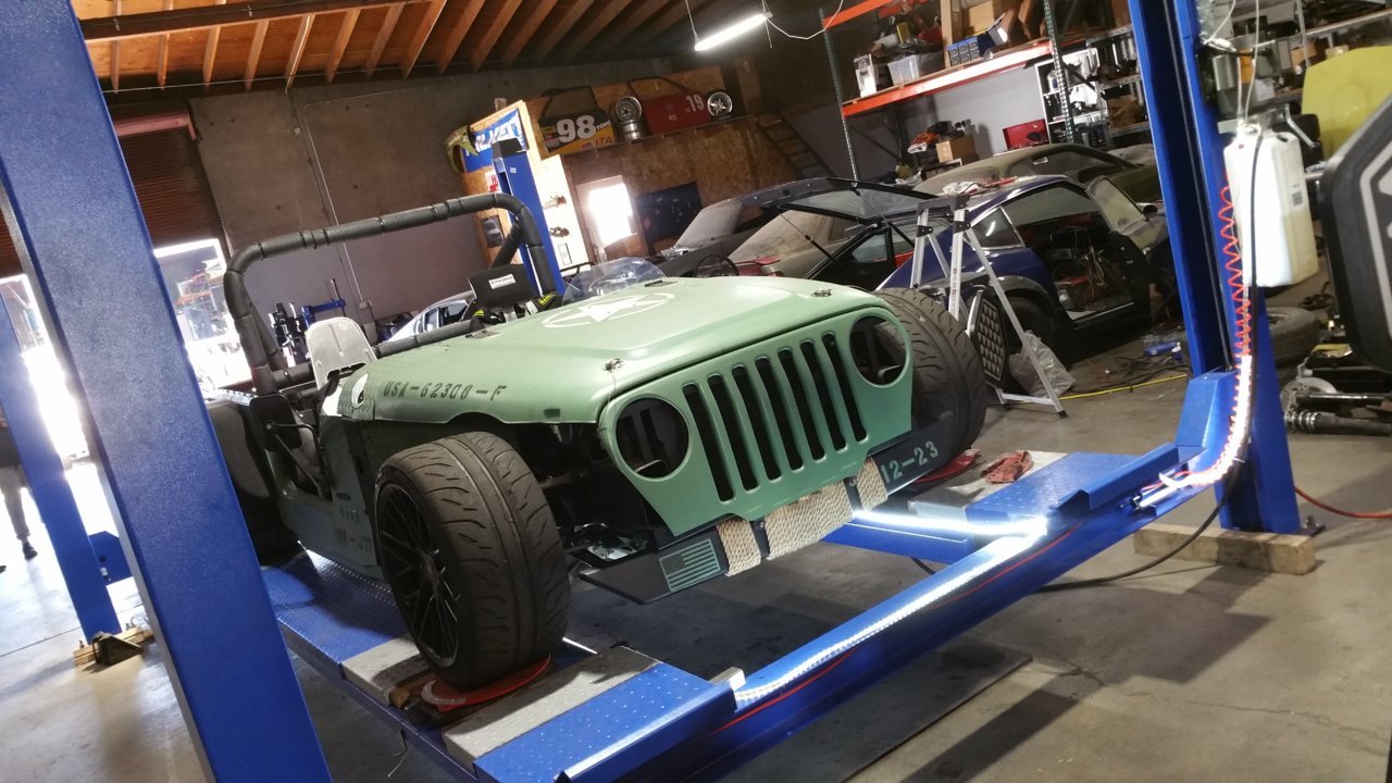

    One of the more unique chassis I've worked on. C5 vette with coilovers and a jeep body. Track use only race car.

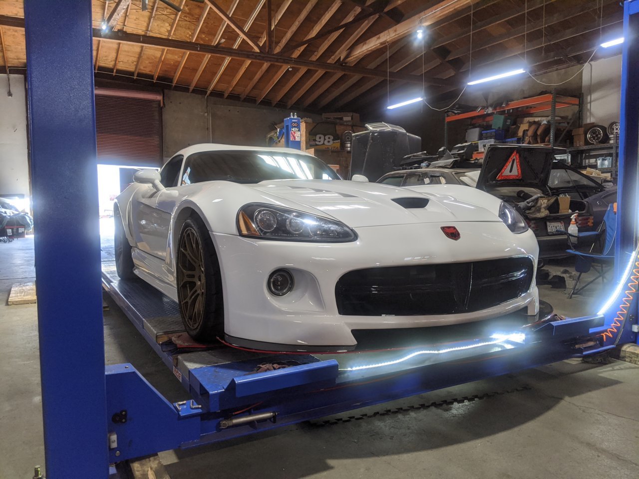

    Wide body viper:

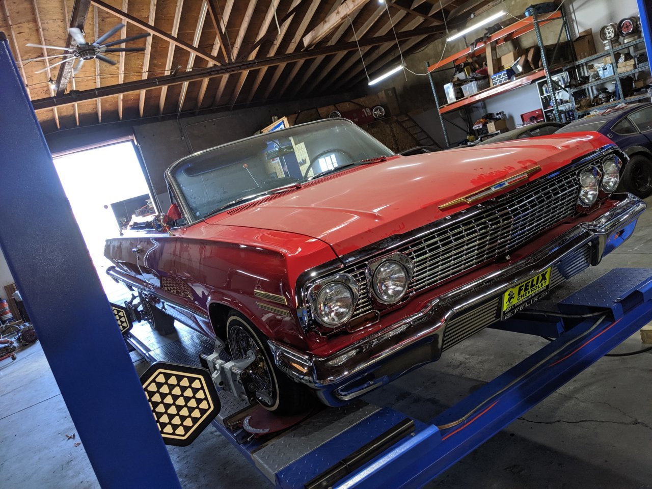

    Oldschools:

    63 Impala SS :confused:

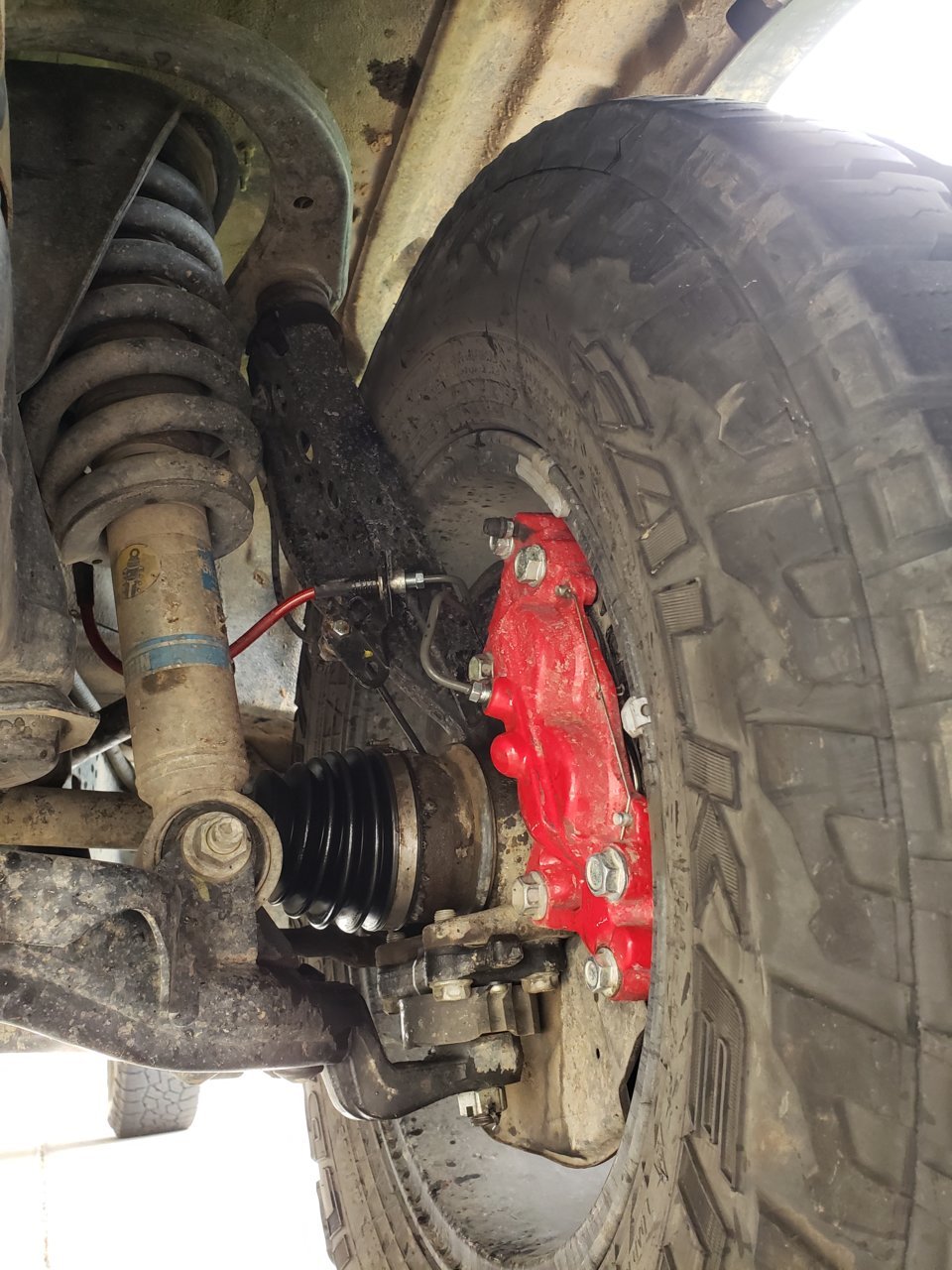

    I noticed the steel brake line that runs into my caliper had a leaking fitting. I tightened it and it started leaking worse. I ended up buying a new line from the dealership and it's installed now. Feels good to not have leaking brakes.
    While under my truck, I looked at my weeping front differential and noticed the leak isn't coming from the housing itself, but from the breather. Glad to know It's not the differential housing that's leaking. Anyone have tips on how to get to that breather without dropping the entire diff? Or am I SOL?
