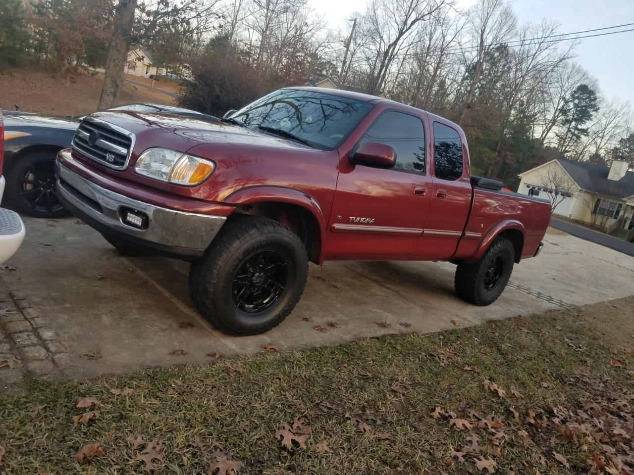

    Ramon
    Daily driven 2000 toyota tundra
    16in M/T wheels with a 305 70 r16 tire 3in space lift front add a leaf in rear Led headlights upgrade OEM fog light delete replaced with 7in light bars in OEM locations Led interior lights and tag lights and cargo lights also Kenwood double din head unit self powered subwoofer under driver's seat
    Washed her and waxed her

    Welcome :wave:
    Good looking truck ya got there :)
    Got any future mods planned for it yet?

    In the future install some bumpers, as of now I cant think of anymore mods to do

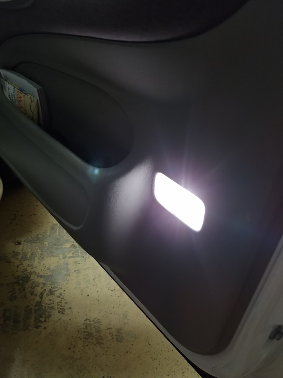

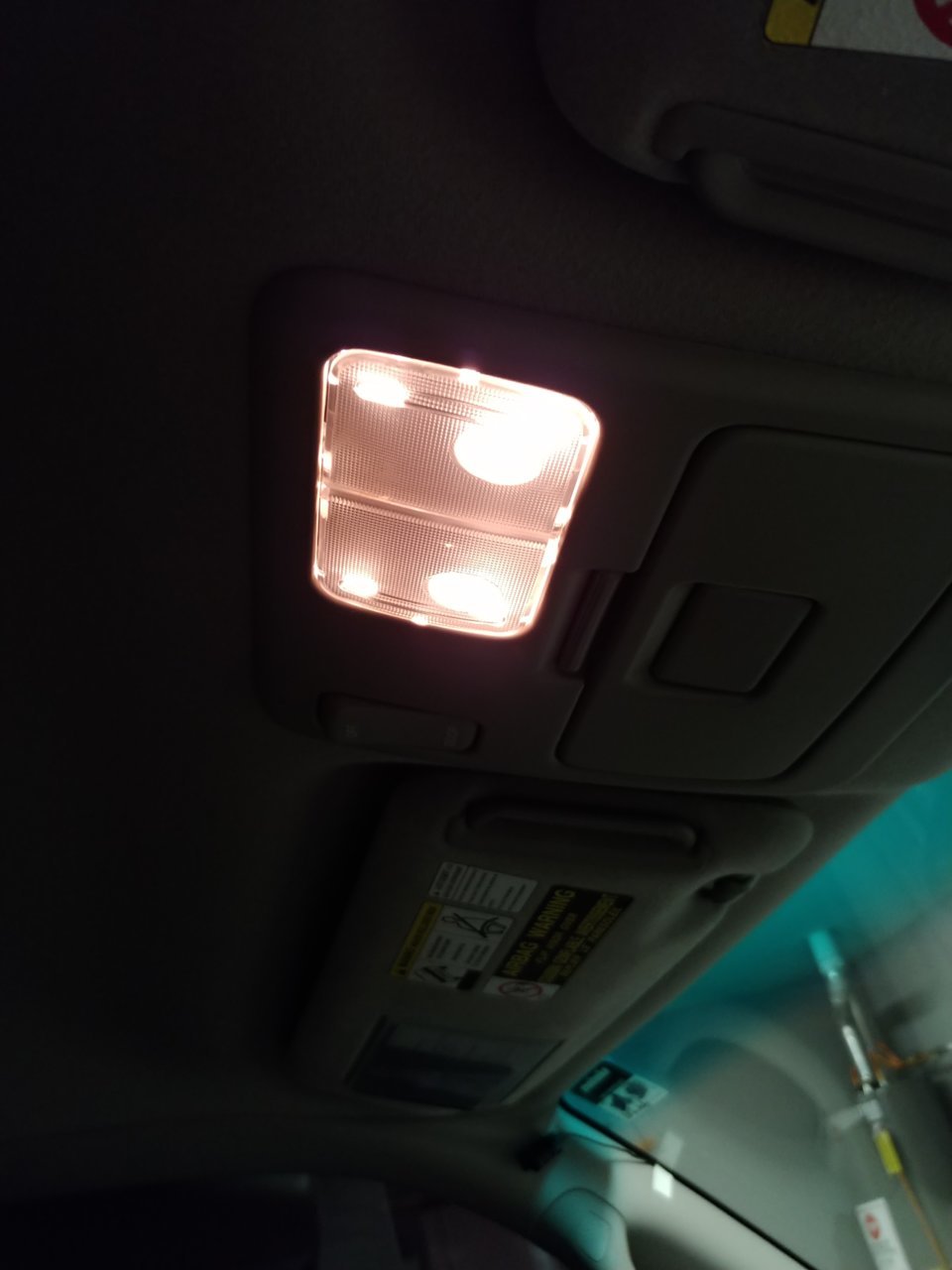

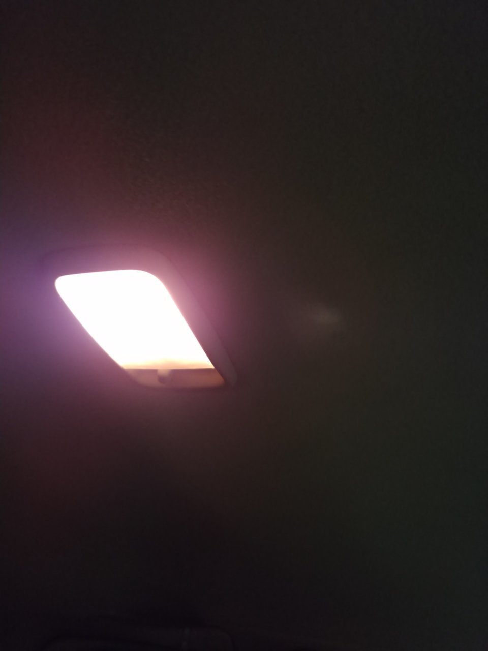

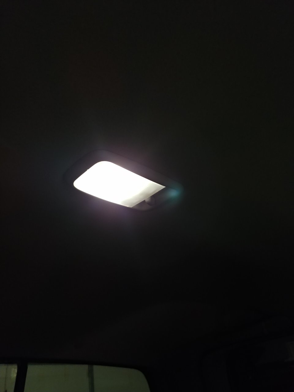

    Just installed new LED bulbs inside the truck. The door lights are impressive but the ones above my head are a bit disappointing. I like the fact that they are white instead of yellow but I really thought they would be brighter.
    Before:

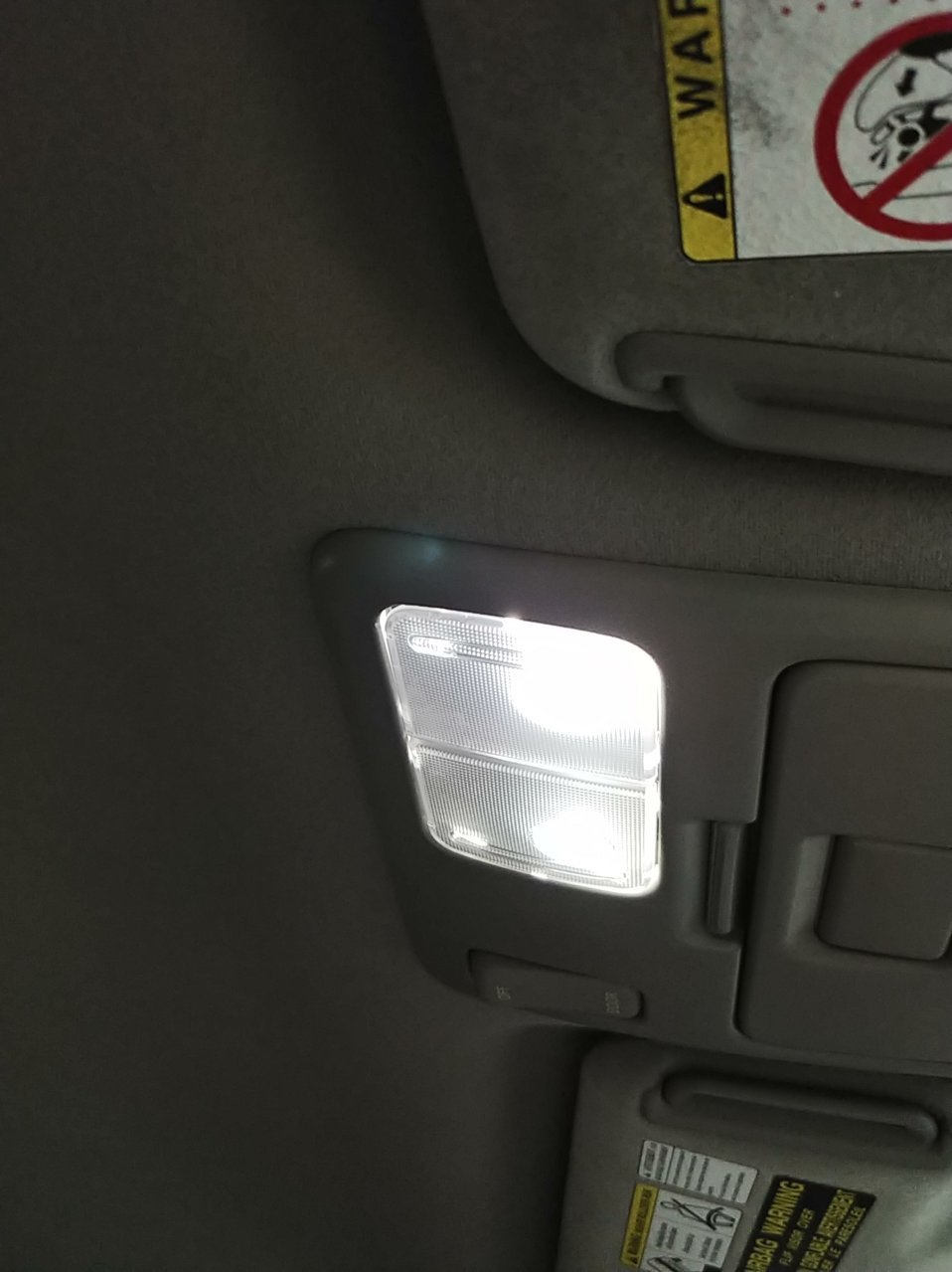

    You pop those metal reflectors off the back of the map lights lens?

    Genius. I didn't even notice those. You sir are a wise man. That's much better now.

    There you go. How are those Cargo lamps looking?

    Outside? Don't have those yet. Will advise once they are installed. Loving these inside LEDs though. Especially now.

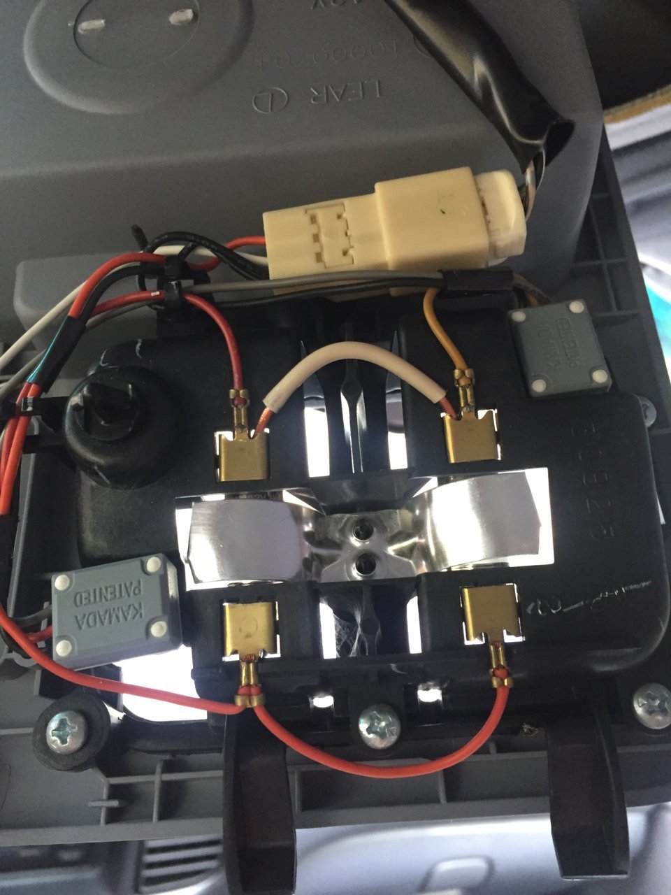

    Put a jumper wire across the two terminals on those map lights and all it takes is one push to light both.
    Solid white wire in the shape of a rainbow is the jumper.
