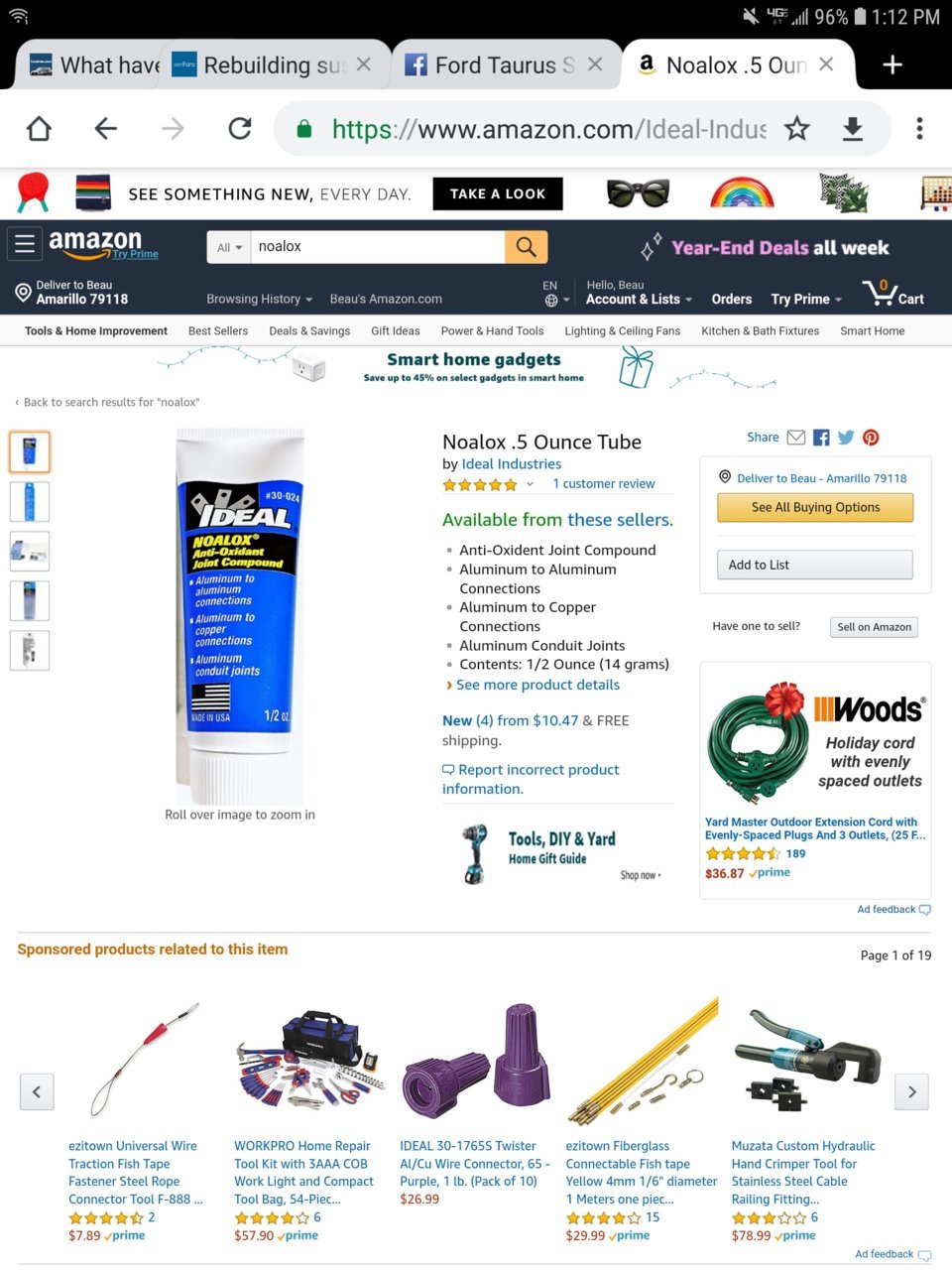

    We call it pookey in the electrical world.

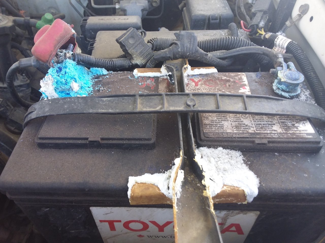

    Think I should deal with this? Lol. As far as I can tell, this is the original battery...

    :eek:
    I'm impressed it's still working.

    Yeah I’m impressed with the original battery lasting this long....
    Pretty sure simple Baking soda + water will help get rid of that stuff.

    You and me both. :D
    I've tried baking soda + water as well as other corrosion inhibitors/removers. The only work for a short time.
    I guess so. I always thought cold was bad on batteries. All I know is this thing has worked just fine down to -45 Celsius. :notsure:
    This spring I'll be replacing it with an Odyssey AGM and installing new connectors.

    Its the heat from my understanding that kills batteries. The weakness isn’t revealed until cold settles in. Everyone of my batteries has gone bad in the fall usually 3 days after a cold snap. We go from super hot summers to cold winters here.

    You won’t have to worry about corrosion or leaks ever again!

    It's because your battery is off gassing more than typical because of the age/condition. It's kind of like rust too where if you don't get all the corrosion it spreads faster.

    That makes perfect sense. Someone told me it could be something to do with the fact the previous owner wired in floodlights on a bull bar and when that was removed, the wiring was left behind. You can see the inline fuse in my picture.
