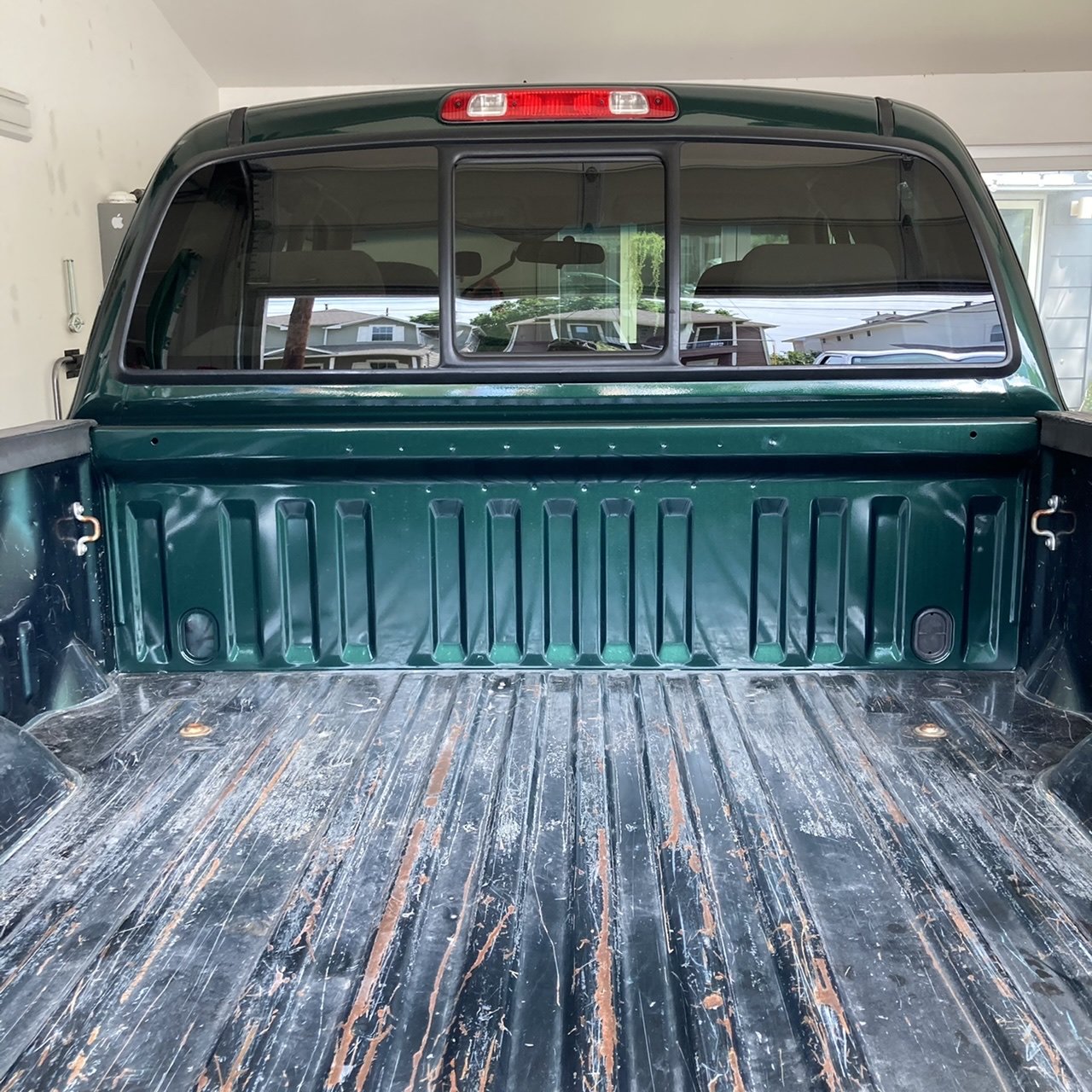

    Got the truck back from the body and paint shop today. Replaced the busted up front bed panel. Now on to Line-X it.

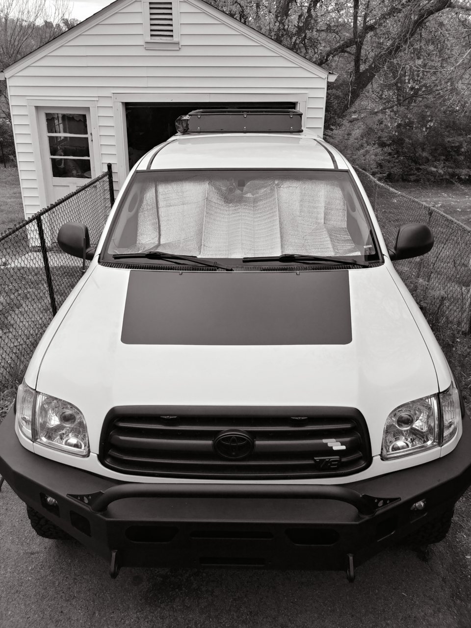

    Well, I don't hate it. I have a new appreciation for folks that do those wraps professionally.
    I'm curious how much this will cut down glare from the hood.
    I'm a little bummed about my bug guard. Tried to reinstall it, and 2 of the mounting tabs inside the good gave up the ghost after 19 years. Seems unlikely that I'll find replacements.

    I also washed the truck today and applied a coat of Griots 3-in-1 to help cure my PTSD after seeing @des2mtn :D That's why the paint looks so good in this picture. There was half an inch of pollen on there.

    I like the matte black. I think it looks good. How's it look from about 40ft away?

    I think it came out nice. Adds a unique look to the truck. Only thing that bugs me is the bit of white at the top but it could just be the picture angle.

    I'm not sure yet. The way my driveway is angled I wouldn't be able to see it from that far away. I wish it extended down to the grill and covered that entire section but it's growing on me.
    There is a tiny gap there. I tried my best to cover it but installing it was a real bitch. There were a few times I thought it was ruined. I was hoping the soapy water would allow me to slide it around but it didn't. It just keeps it from sticking too soon. If I had had a 2nd person helping it would have been much easier I think.

    The projector headlights are looking great. Is that a brute force on the front end?

    It sure is.
