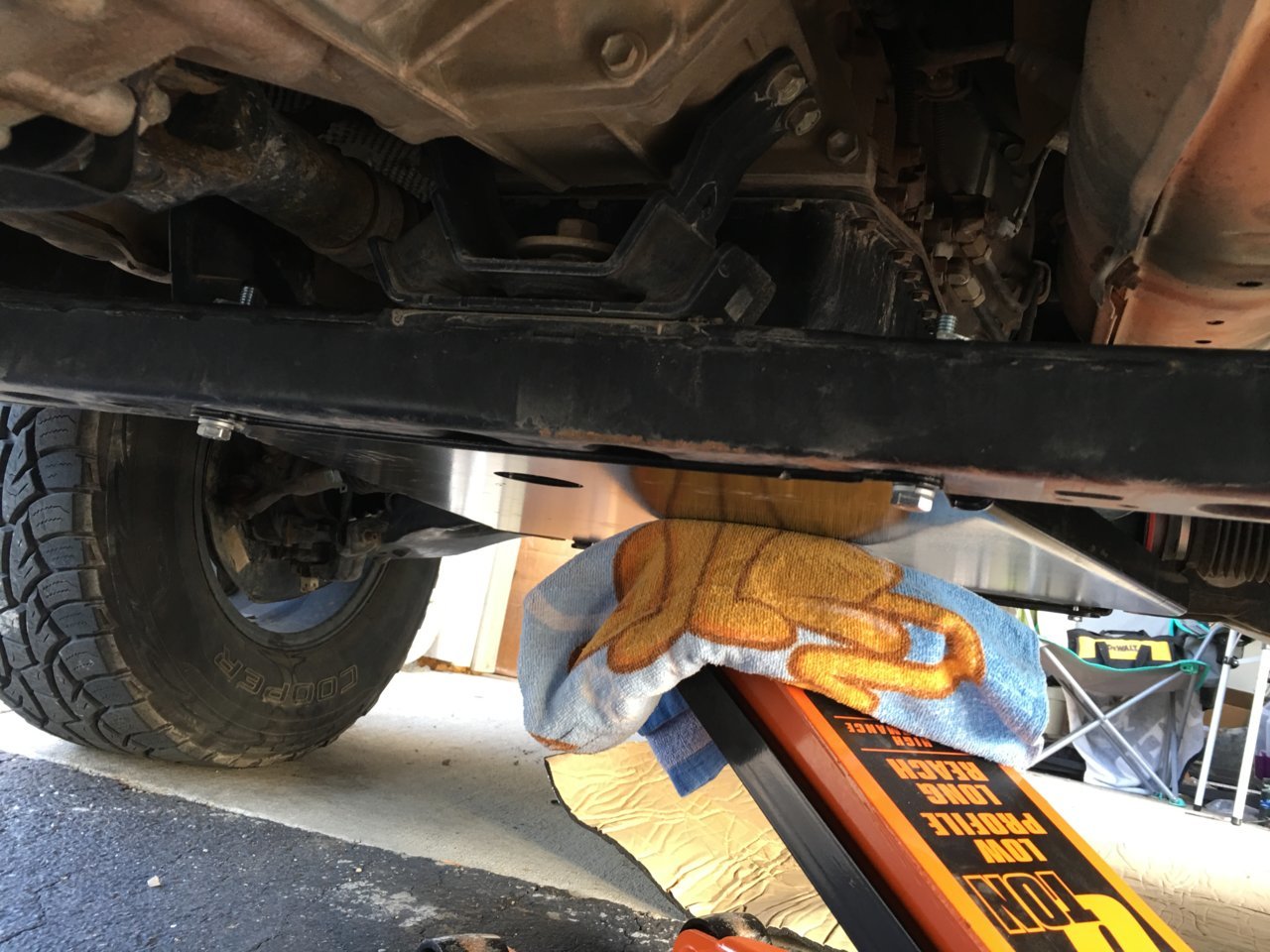

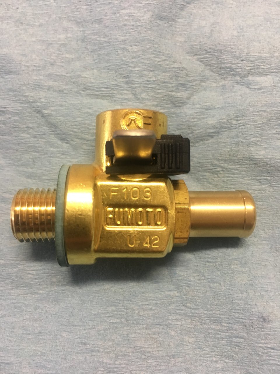

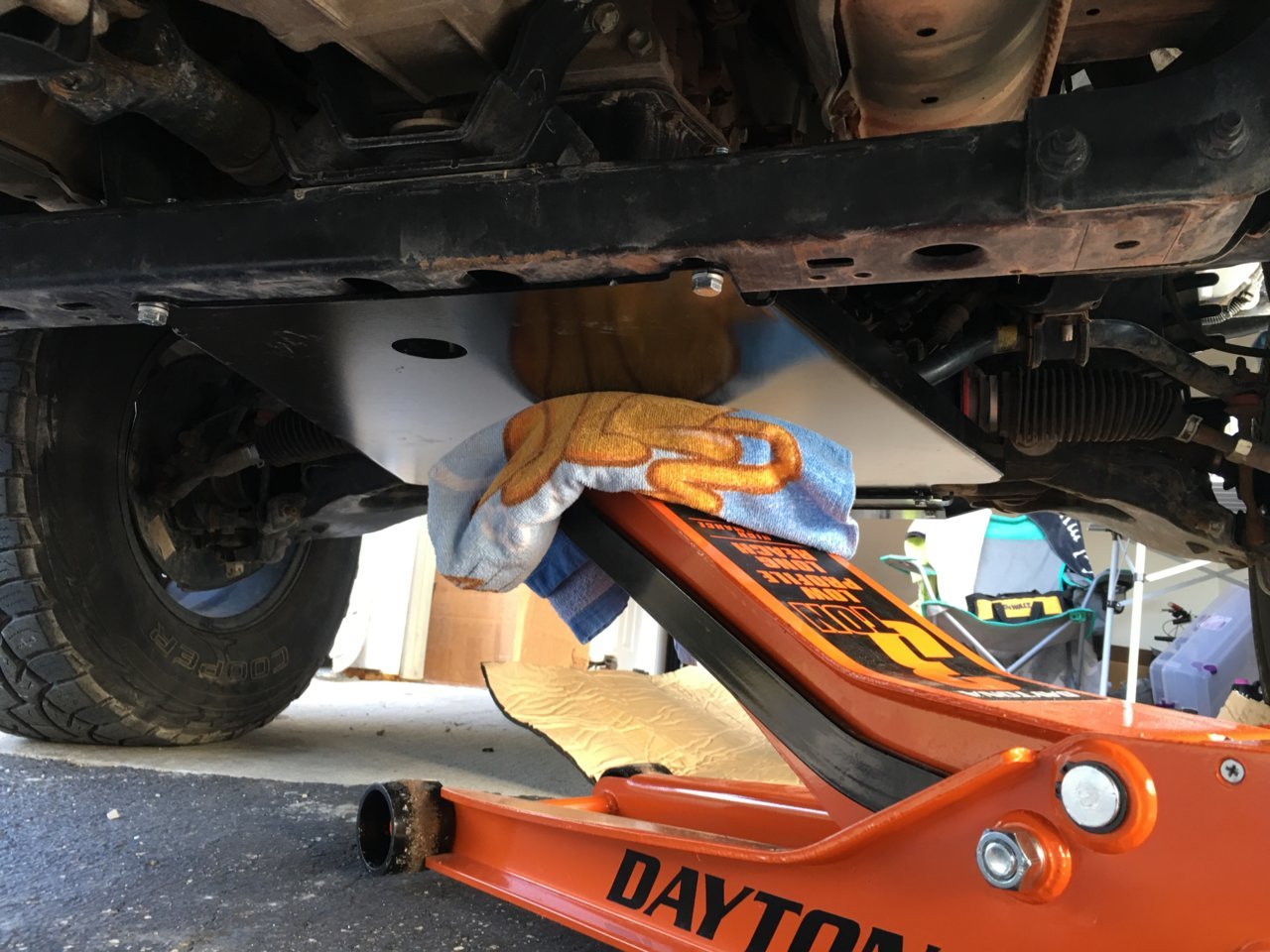

    Changed the oil and installed a Fumoto drain valve for easier and cleaner oil changes once the skid plates are mounted.

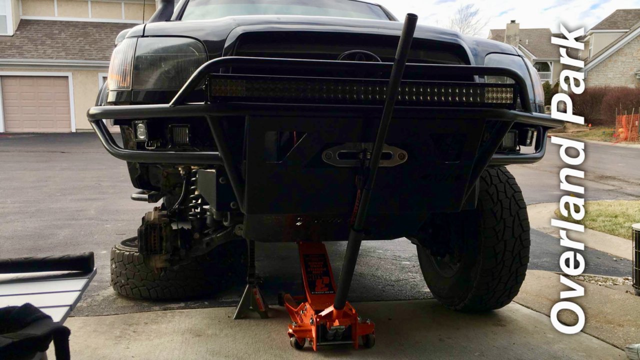

    Went to replace my rotors / pads today and one piston is seized. The buggar would not move. Luckily it was the first side I worked on so, I put everything back on to not start my new pads off to a bad start... Time for new calipers. I’ll probably pick up some from Napa with Lifetime Warranty sometime next week so I can get the fresh rotors and pads on.

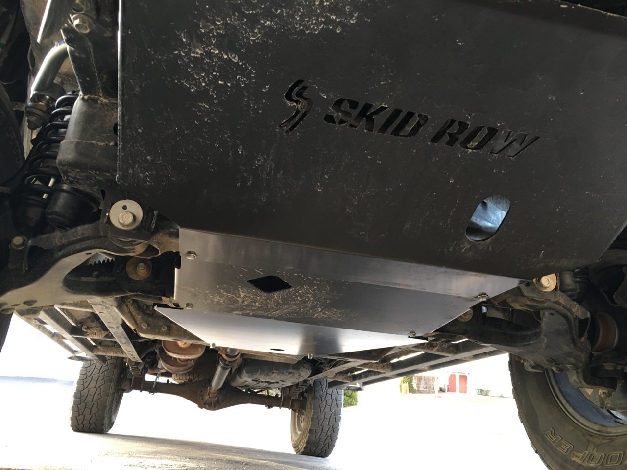

    On a positive note, the Tranny skid is mounted (Thanks Skid Row for your Black Friday Deal). Very simple. Used my floor jack to lift it into position. Got the front two bolts in holding it steady then lifted the rear to its final resting spot and drilled the 2 holes. Went nice and smooth (only needed to drill holes on he under side of the frame, there are factory holes on the top side that lined up for me). Nice and sturdy ready to protect...
    Anyone else replaced their calipers recently? Any tips? Did you replace and brake lines while you were at it?

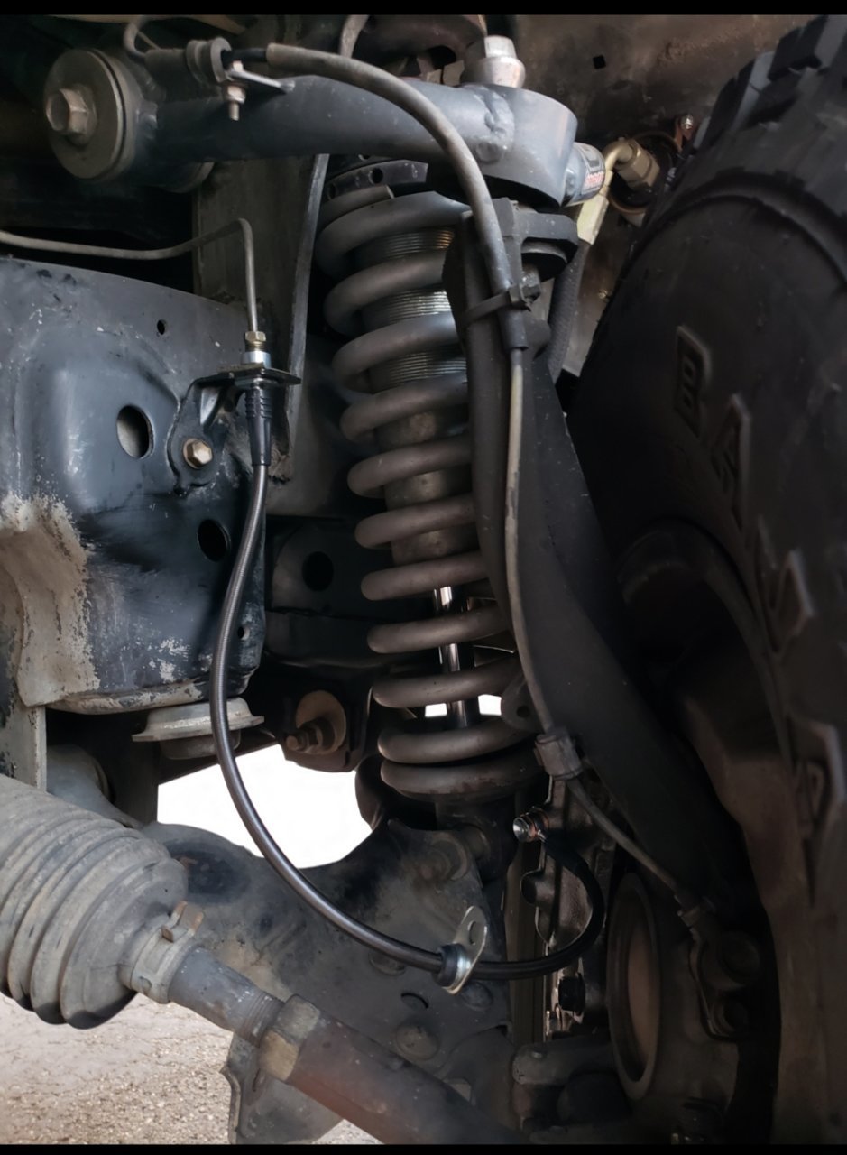

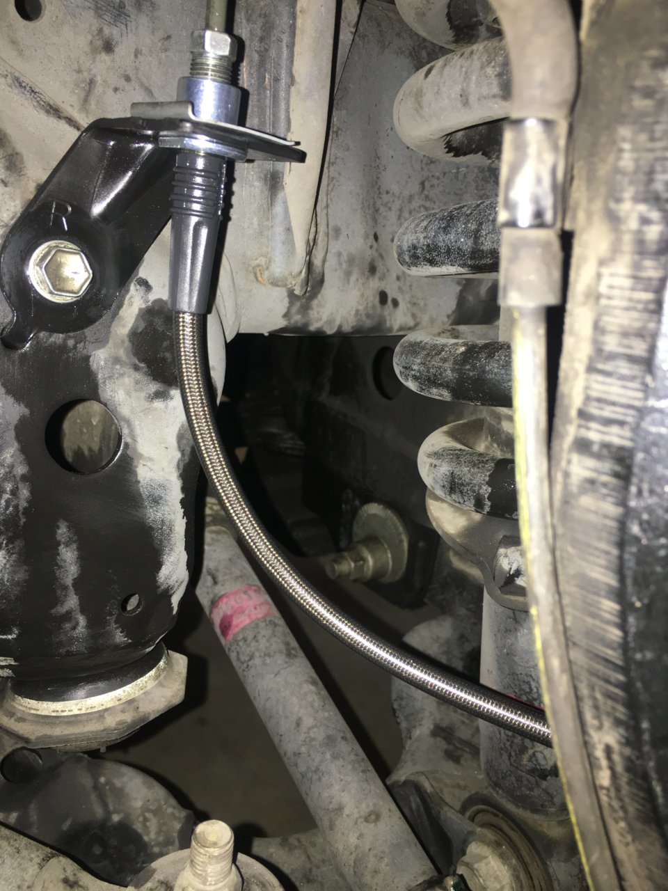

    Nice! Thanks! Are these the lines that connect to the caliper? Any pics of yours installed?

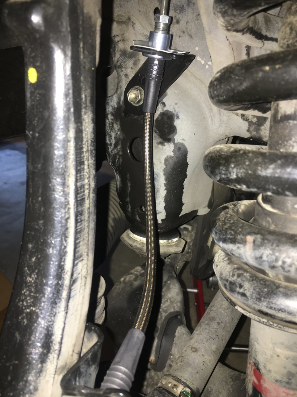

    These braided lines connect the hard line of the body to the caliper hard line. Here are a few pics, I can take more tomorrow morning if it helps.

    Awesome. Thanks for the photos.
    Are they straight forward / easy replacing?

    Very easy and straight forward. Loosen the fittings, remove oem retaining clip, unscrew line(brake fluid will drip out), put new line in the support brace, screw on fitting, install new retaining clip and tighten fitting.
    You won’t want to hear this but I recommend flushing the front brakes since you’re replacing the calipers. You don’t want old brake fluid/gunk in the new calipers. Flush the fluid before replacing the calipers and lines.

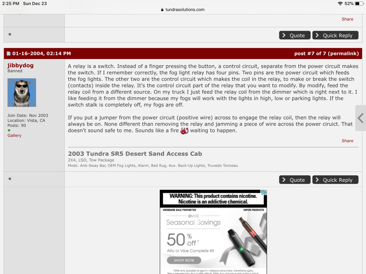

    I’ve asked this before with no answer back. Anybody ever pull out their relay fuses? Feels like they are stuck in there. Don’t want to pull to hard as it seems there are 4 white clips that hold the fuse cover on. Im assuming the fuses plug into the panel contacts below.
    Specifically, the DRL associated Relay fuse.
    Seems there is some kind of secret society surrounding the ‘Relay Fuses’ online searching. Do I need to wear a tin foil cap?

    Thanks for the advice so far. Found some research (was wearing tin foil hat doing it) and some others have had the same problem. Confirmed that there are white ‘tabs’ that need to be pressed in to remove cover. Also, and this is still to be determined, the plugs/base need prying out with a screw driver.
    Secondly, SCORED!!! Found this tib bit for us 00-03 Tundras ‘Fog Anytime Mod’. Confirms my intial hunch about the mod needing to be done in the Relay. Credits to jibbydog in picture. He looks like he was banned (very punk rock!).

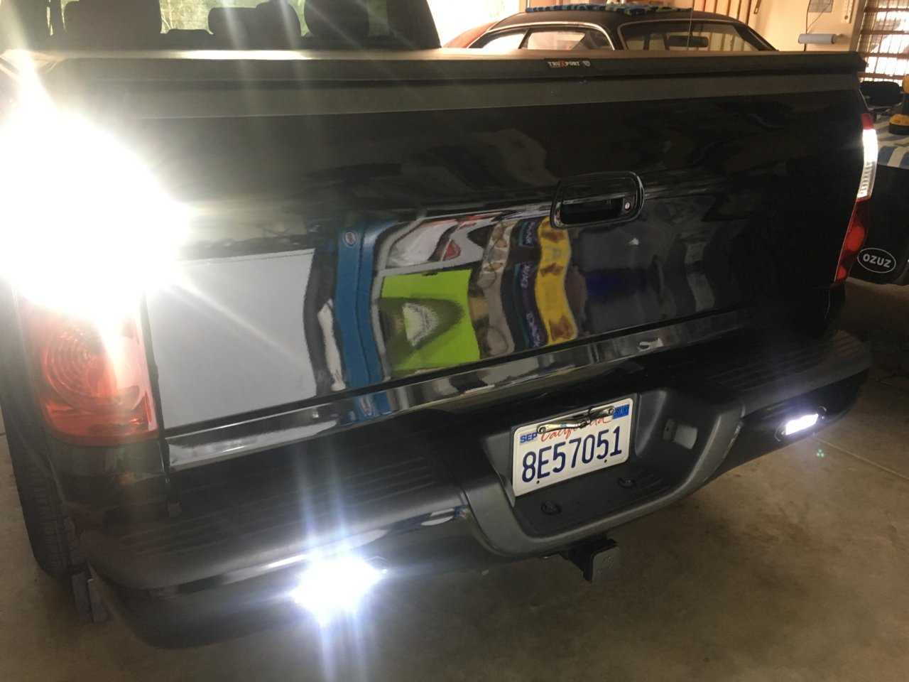

    Wired up my reverse lights, finally.
