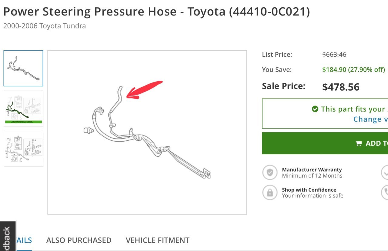

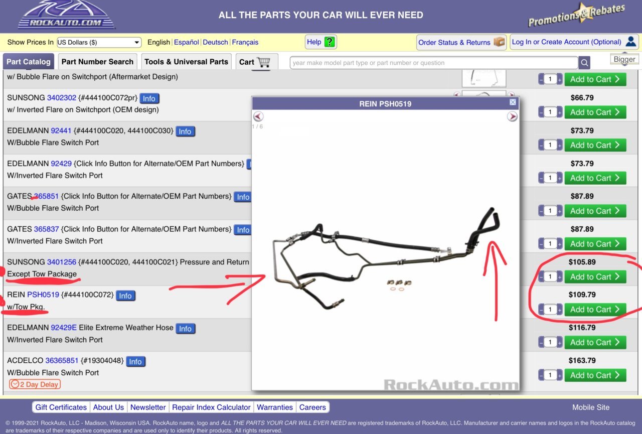

    jImmegart Second Youngest tundra owner in the west!

    #28798
    930
    Jonah

    I went with a morimoto elite from retrofit source. Im about to go to work but I will add up my total later
  3. Apr 2, 2021 at 11:04 AM
    jImmegart
    Apr 8, 2019
    #28798
    930
