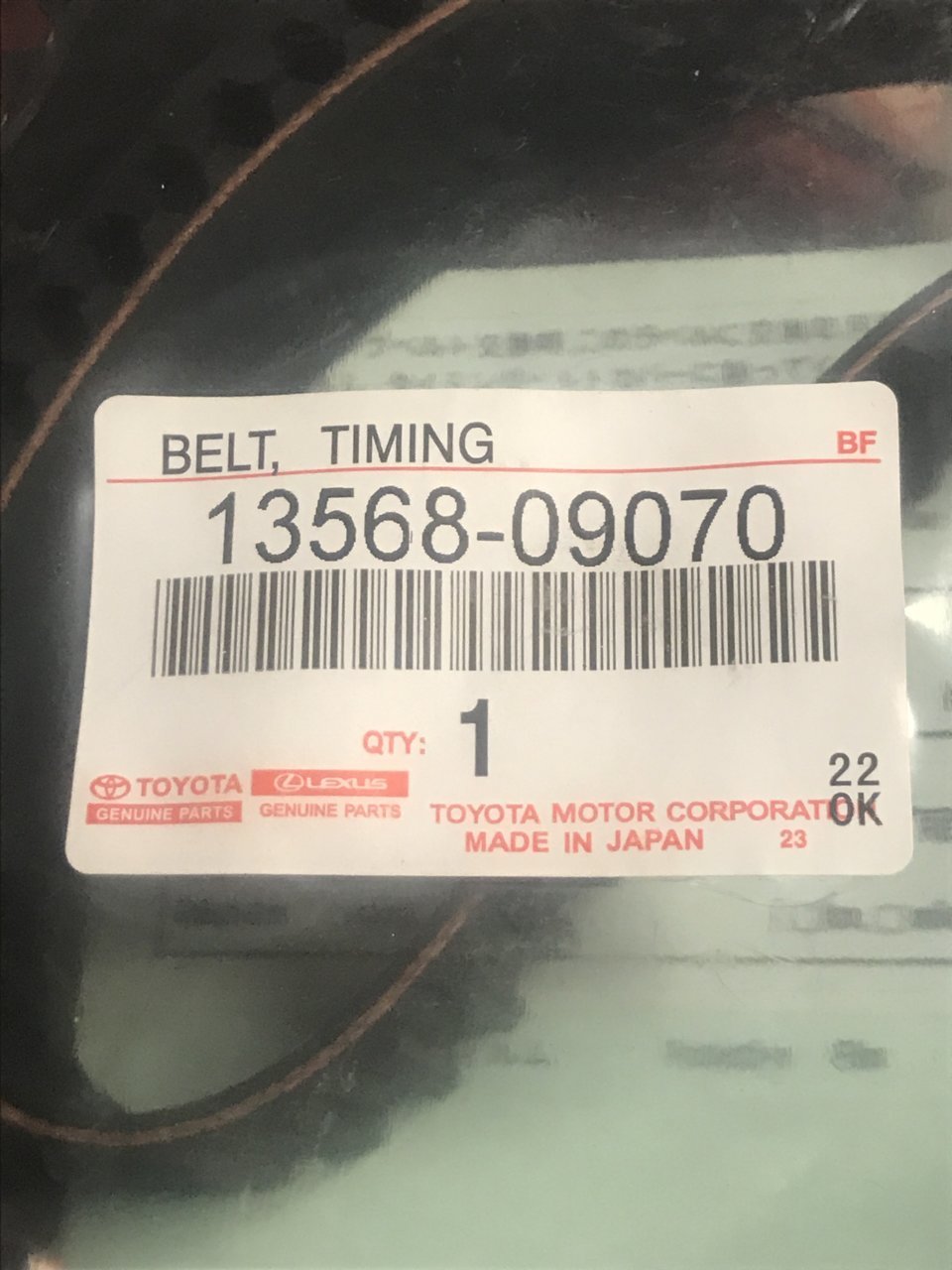

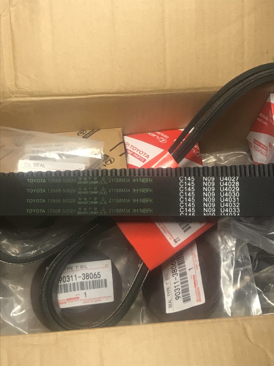

    Timing belt time. Kit showed up today. After scrollin thru hundreds of different kits and learning what I have about this job and the truck, i went with an all genuine Toyota oem parts kit. Opened it up to find that the timing belt has no timing marks on it. The majority of the belts I looked at and have seen on videos had the 3 marks labeled R-cam, L-cam, and crank, and I guess I had assumed the Toyota belt would as well. Moving on.... I know that the marks on the belt aren’t entirely necessary to time the truck correctly, but I like the idea of using them, so this is the plan I’ve come up with; in disassembling the front of the engine, before removing the timing belt, I’ll crank it over by hand until my marks are all on point, and mark each with a paint pen. Once the belt is removed, I’ll transfer marks to the new belt before installing it. Any thoughts/ideas/experiences are welcome. I don’t believe this should make any difference, but it will be the first tb replacement @ 154k miles
    Darkness likes this.
  2. Mar 25, 2021 at 11:18 PM
    empty_lord
    Feb 1, 2019
    #25441
    10,124
    Dan
    Indiana, Chicagoland
    05 rollover special
    Where did you buy the stuff that’s “OEM”? Oem belts walkways have marks. If you bought off Amazon or eBay there’s a good chance you’ve got counterfeit
    If there’s ANY doubt in the quality of the belt DO NOT install it. A fake factory belt can spell the end of a motor

    The belt looks be of great quality, REALLY doubt it’s a fake. Everything in the kit came separately packaged in Toyota/Lexus genuine parts boxes and sealed bags, and all with part number stickers with barcodes. The timing belt itself is actually marked, w/Toyota stamp but not with the 3 timing marksF32EF72B-5130-4FD0-907B-74ABD814A2EE.jpg520FBAE0-2336-4CDF-B9DE-803A5338E92A.jpg

    It's probably fine...but fakes are really good these days. I would call your local dealer and ask them if the OEM belt they stock has timing marks...
    https://www.youtube.com/watch?v=aeqYIt1x7Jw&t=4s
    Voss and RUSTYNUTS[QUOTED] like this.
  11. Mar 26, 2021 at 9:07 AM
    empty_lord
    Feb 1, 2019
    #25441
    10,124
    Dan
    05 rollover special
    you can see one cam mark in this photo.
    those marks dont come off easy either. ive reused belts with 30k on them and still readable marks.
    oscardog86 and RUSTYNUTS like this.
  12. Mar 26, 2021 at 9:24 AM
    RUSTYNUTS
    May 10, 2020
    #46370
    2,277
    Rusty
    sOCal
    to be continued...
    yes, those are the cam marks I’m talking about. Have you ever seen a timing belt without them? I was pretty confident in the quality and packaging until I just watched that video. Thanx speedtre. I actually live about 2 miles from a dealership, I think I’m gonna take my box o goodies up and have a service tech verify authenticity, just gonna have to James Bond past the service writers without being seen first.

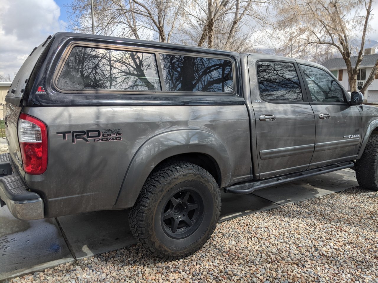

  23. Mar 26, 2021 at 1:11 PM
    Voss
    Voss Dust in the wind
    Feb 28, 2019
    #26833
    1,537
    Valod
    2003 AC TRD 4x4
    That's a nice looking Tundra! Are those sliders bolted or welded on the frame?
    FrenchToasty likes this.
  24. Mar 26, 2021 at 2:18 PM
    06tacomadc
    06tacomadc New Member
    Dec 28, 2020
    #56760
    120
    Motor City
    Tundra
    Do you have a pic of your truck de-baged? Thinking of doing it
    oscardog86 likes this.

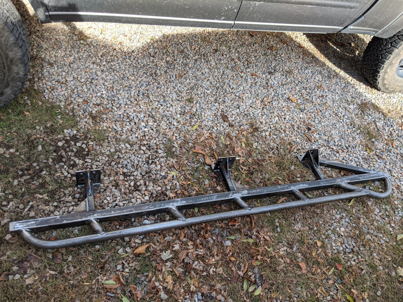

  25. Mar 26, 2021 at 3:09 PM
    KarmaKannon
    KarmaKannon Master of None
    Jun 3, 2019
    #31428
    1,919
    Utah
    2006 Double Cab w/long travel
    Some junk

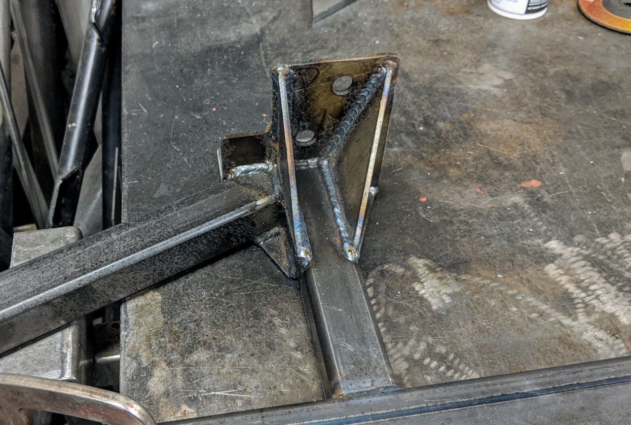

  27. Mar 26, 2021 at 3:57 PM
    Voss
    Feb 28, 2019
    #26833
    1,537
    Valod
    2003 AC TRD 4x4
    Nice. Have anymore pics of the sliders and how/where they connect on the frame by any chance? I would like to build a set for my truck, would really help me figure things out.
    oscardog86 and des2mtn like this.

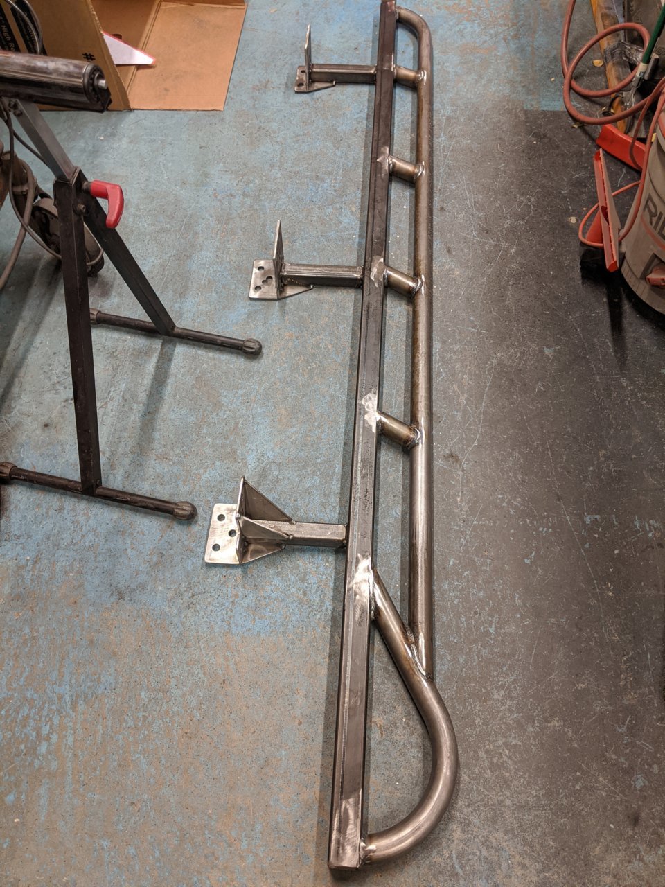

  28. Mar 26, 2021 at 6:38 PM
    KarmaKannon
    Jun 3, 2019
    #31428
    1,919
    Utah
    Some junk
