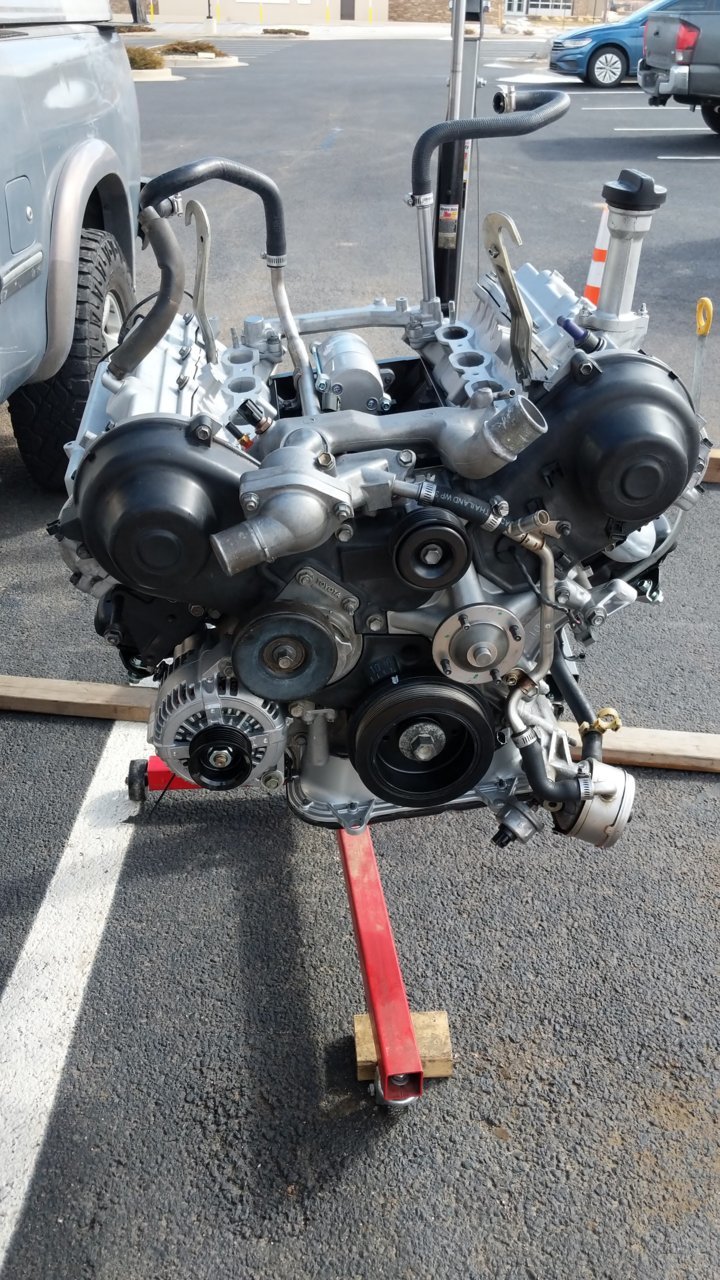

    (Camper conversion underway.) Rebuilt engine w/265K miles, A.R.E. camper shell (w/cab pass-through, rooftop fan, and side windows delete), bedlinered steel ladder rack (w/wooden rooftop deck and hammock mount), all LED lights (red dash, 4" side floods, 32" rear bar), Android head unit, 1.5" lift from Bilstein 5100 struts, 32" DuraTrac tires on factory rims, 1.5" wheel spacers, Moog suspension parts, SuperSprings leaf kit, diff drop, Reese trailer brake control, GoRhino Hitch Step, debadged, F-150 rear bumper, Sequoia center console unit upgrade, partial rear bench seat delete, dashcam, aftermarket speakers, 50% sound deadening coverage, custom tools unit.
    Big engine rebuild update

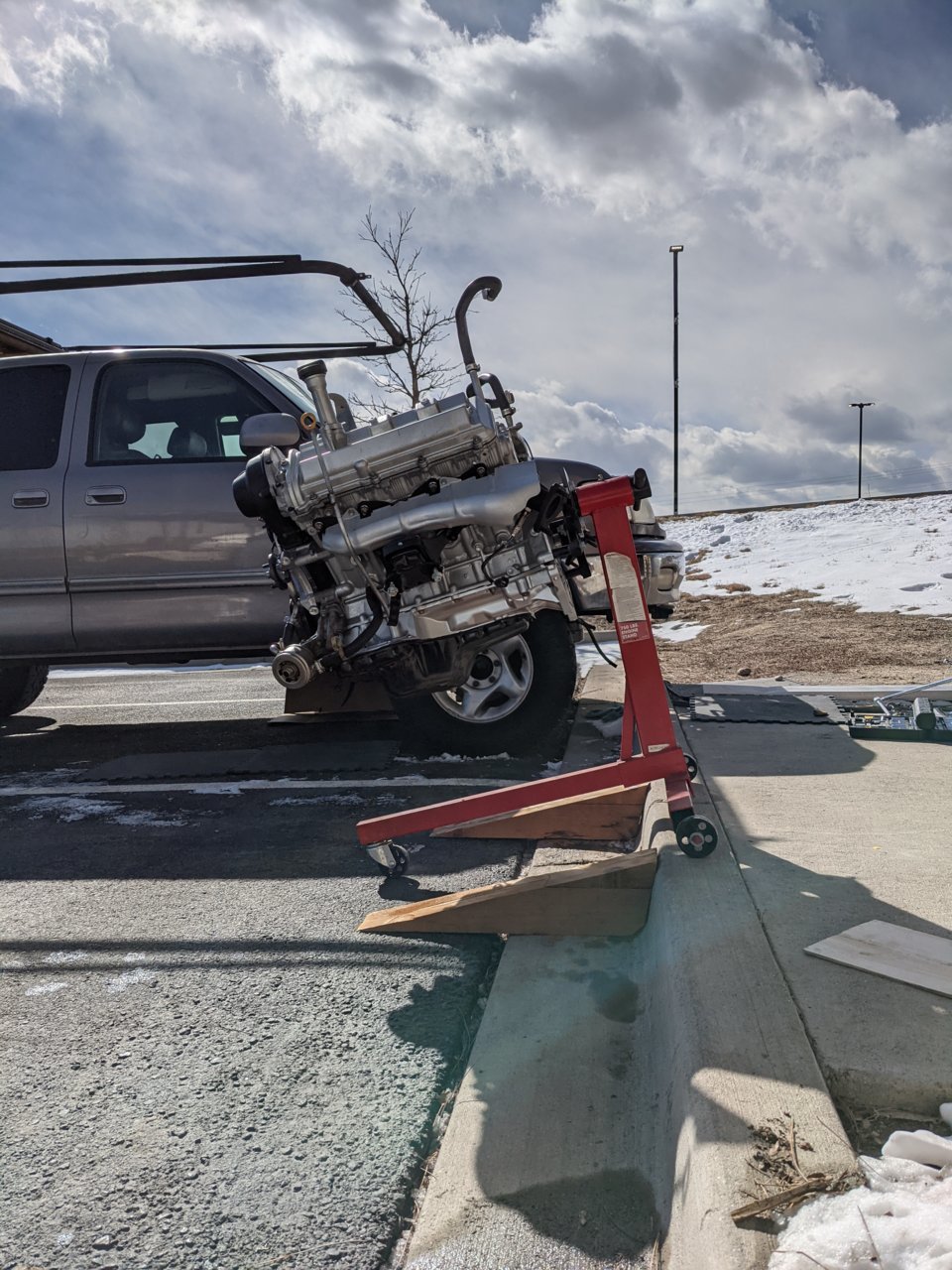

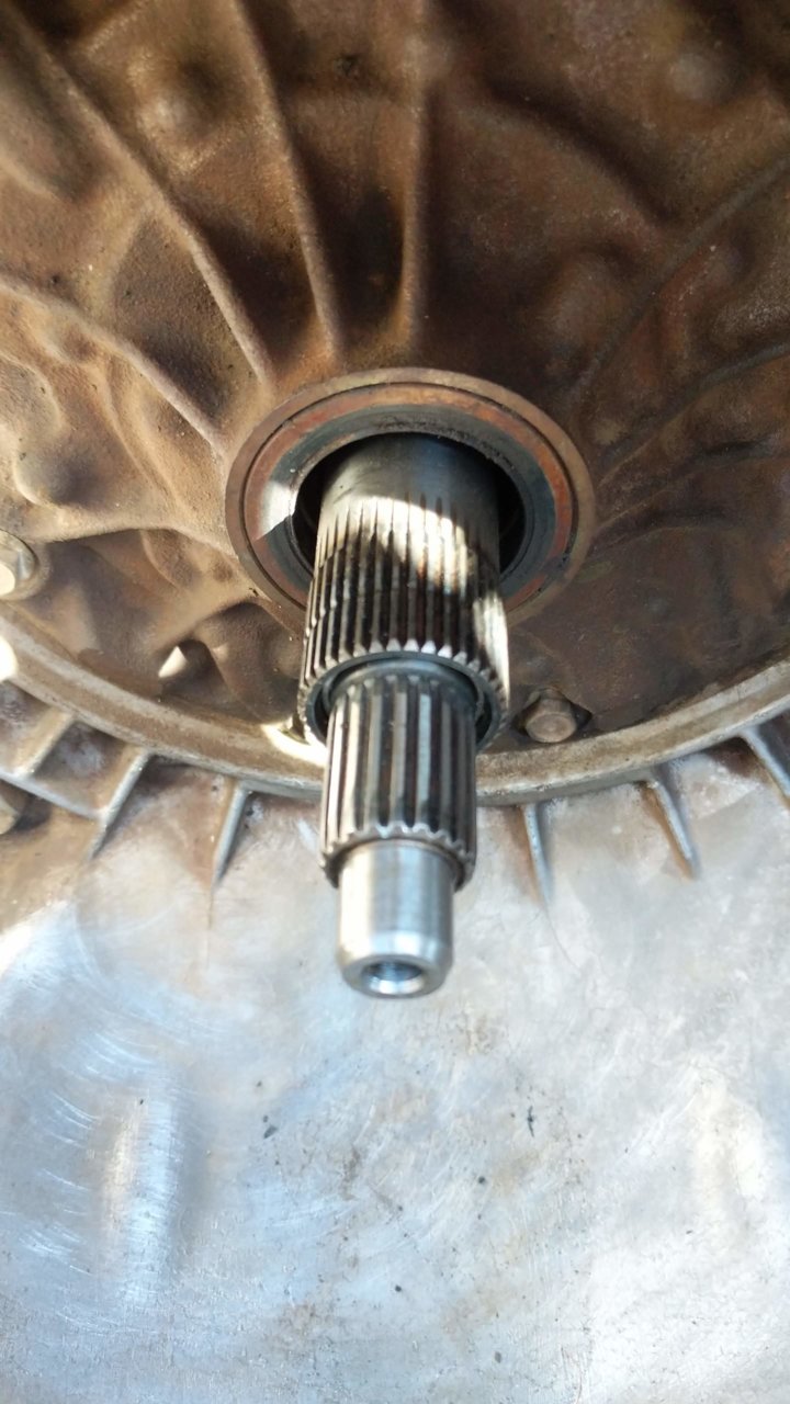

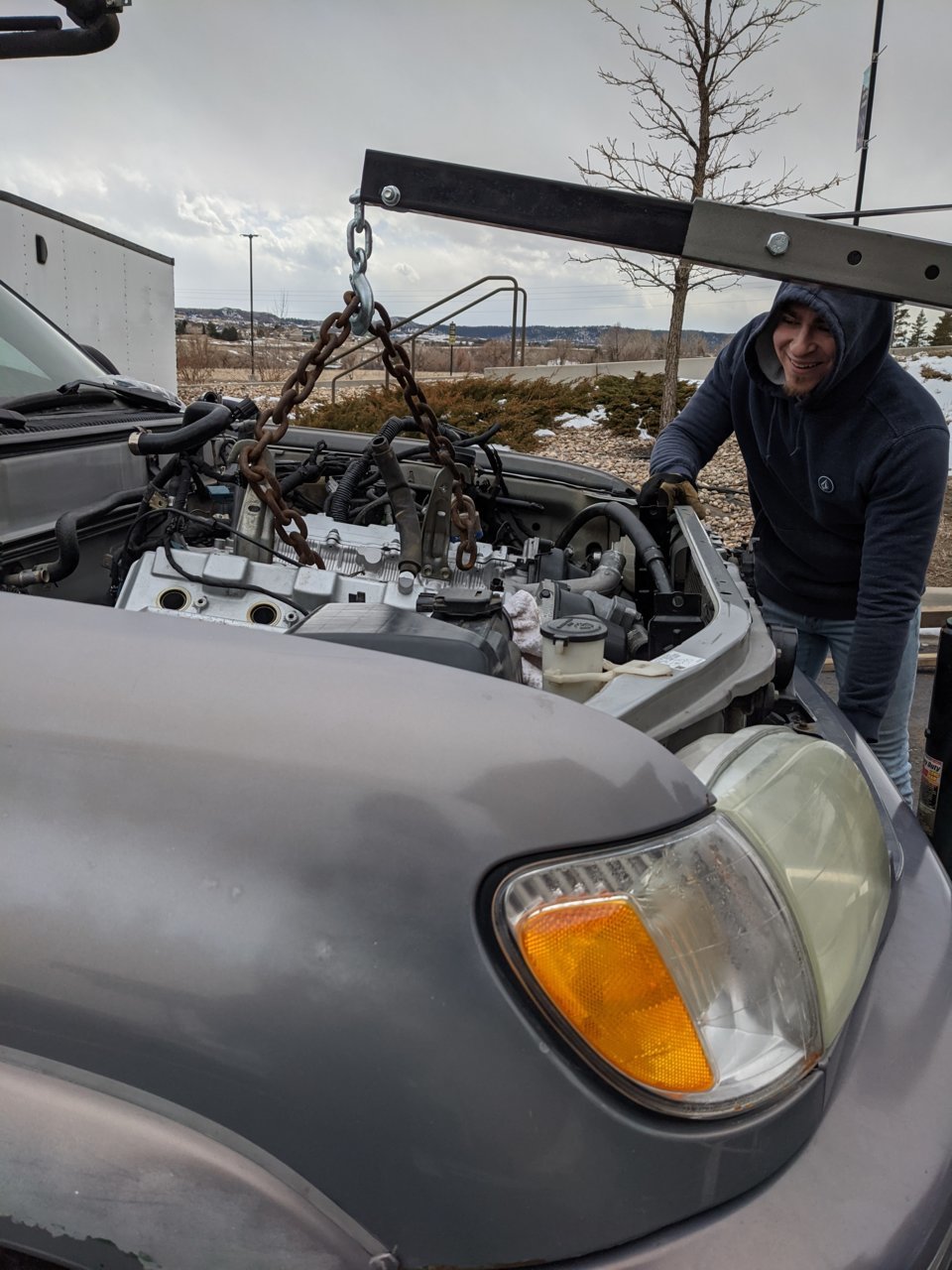

    Getting it from the top of the curb to the parking lot area was scary AF. Thankfully, with help from my friend and some ramps I built from 4x4's, we and the engine made it to the bottom unscathed.
    Me, acting like we're not gonna have to pull this engine back out like 3 more times in the future:

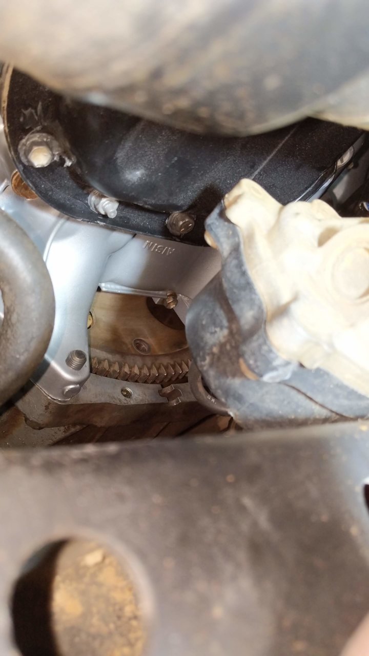

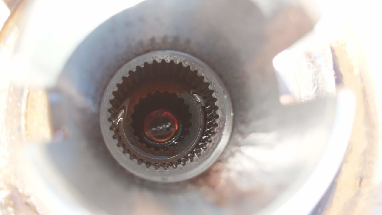

    As you might have read not long ago, we did install the torque converter incorrectly, which prevented the driveplate/crankshaft from turning, and we had to yank everything back out. The manual didn't say anything about the TC seating, I guess you just have to be a mechanic and know it. We inspected critical areas for damage after pulling, like the splines and TC internals, since we had bolted them together wrongly.
    The parts that mated looked fine, I mean; not perfect, but fine. We initially couldn't get the torque converter to seat on the shaft. Finally, I just pushed pretty hard and it went in! Satisfying moment. I think this picture was still before it got happy:
    For some reason the mating process was more difficult the second time around. One transmission bolt even got cross-threaded. Still, I got all the things hooked up and situated over the following days, such as accessories, vacuum lines, intake parts, fan, radiator, coolant, oil, new gas, and most frustratingly, wiring. Golly, the wiring was a PITA. Passenger side? Laid back perfectly. But the driver's side has this plastic casing that only goes one certain way underneath the exhaust only once the starter is connected. Toyota didn't have any literature, I had failed to take photos of the original fitment, and the Internet had nothing. Thankfully this forum swooped in like heroes. Thanks again @FirstGenVol and the rest who helped so quickly with pictures when I didn't know where random grounds and stuff went.

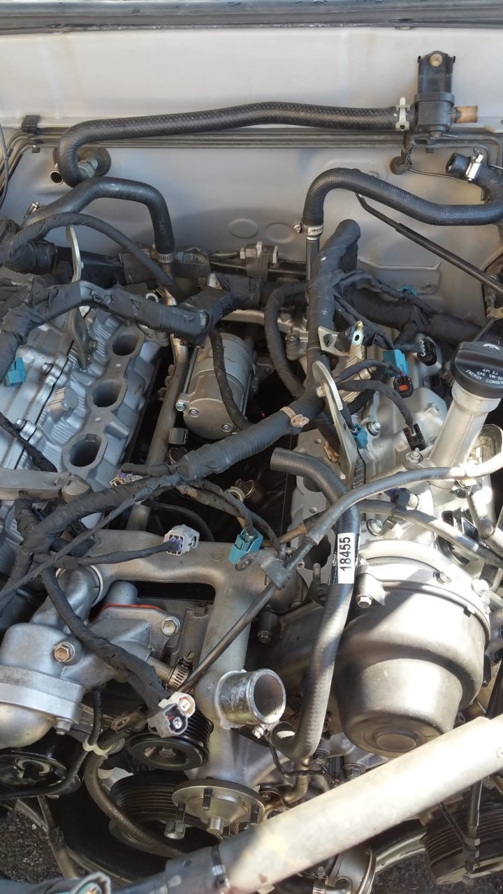

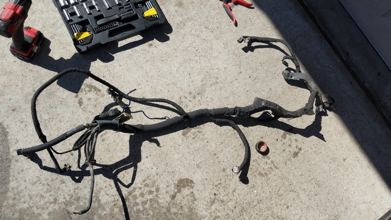

    Here's the stupid side of the loom that F-ed up my hands:
    After the wiring gremlins, things went back on without too much trouble. Note to self, install serpentine belt before all the radiator hoses and fan stuff is on. There are still a couple random lines I should replace and different spots to detail, but here is the engine in all her aesthetic beauty, I hope @Professional Hand Model says I've made it to engine bay dusting status. I think I did a damn good job:
    The Anticipated Startup

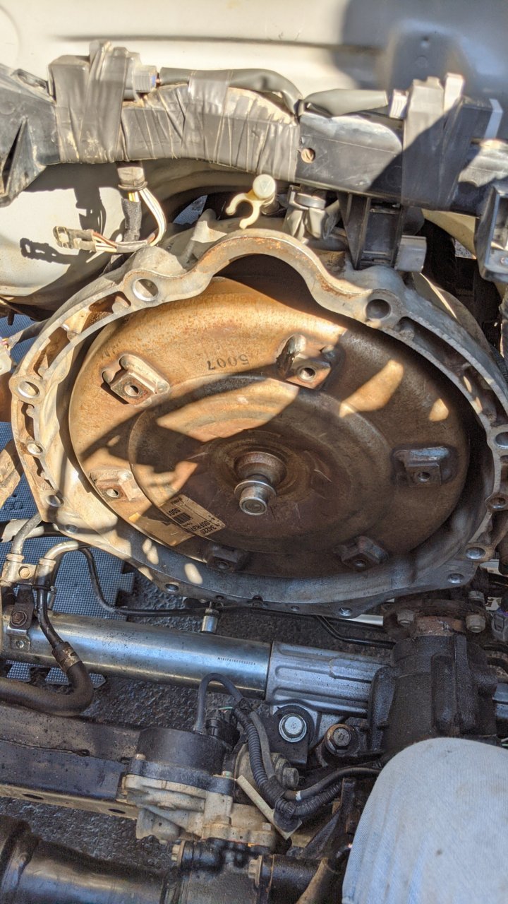

    Unfortunately, I tried to start the engine and it wouldn't "catch," just spun. I didn't have oil pressure. Then I discovered the new oil dribbling out of this rear main seal area between the engine and transmission on the underside (photo just of location, not problem):
    I'm going to have to drop the transmission and see where the leak is. It's either coming out of 1) the new rear main seal due to it not being seated correctly, 2) the new little seal above that one whose purpose I'm unsure of (maybe it slipped out of its groove before the plate was reinstalled), or 3) I didn't RTV adequately around the plate that holds the seal. I am 95% sure it's not the head or something else; gas, air, spark, and the other thing seemed fine. Has anyone else replaced their rear main seal, and if so, do you know if it's supposed to be flush with the plate? That's how I installed mine, but there was weirdly room for the seal to seat further in until it stopped. If that's the problem at least it's free to fix. I'm not sure why it wouldn't be flush; the Haynes manual says to hammer a piece of wood over the seal until it seats right which means flush. Anyone who has thoughts please chime in. I have hit so many speed bumps during this project and I'm just ready for it to be over.
    I will at least note that when it was trying to start, the motor sounded different than I remember... You long-time Tundra drivers know what it's like to be used to the certain sounds of your truck. I swear mine almost sounded "newer" and had more "kick." :D

  3. Mar 9, 2021 at 6:45 PM
    empty_lord
    Feb 1, 2019
    #25441
    10,129
    Dan
    Indiana, Chicagoland
    05 rollover special
    back is different than front if i remember right
  4. Mar 9, 2021 at 7:13 PM
    Tundra2
    Tundra2 Zoinked
    Feb 10, 2019
    #25875
    12,446
    Noah
    Western Kentucky
    They are. Called stealer to confirm.
  5. Mar 9, 2021 at 9:11 PM
    theblurry1
    theblurry1 ~
    Jan 9, 2020
    #40957
    288
    David
    Castle Rock, CO
    2001 Thunder Grey Tundra AC Limited 4x4 V8

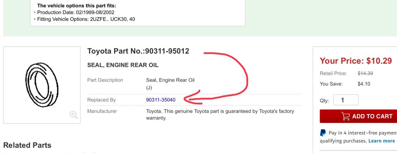

    Just dawned on me that I potentially installed the wrong rear main seal, which would explain the oil leak. Stevenson Toyota lists 90311-95012 as the part, but I put in a 90311-A0002 from McGeorge Toyota. Can I get a second set of eyes on this to confirm if the parts are different? If yes, the small gap when seating the wrong seal makes sense. Their superseded part #'s match, but idk if that's relevant.

  6. Mar 9, 2021 at 10:44 PM
    MrDirtjumper
    MrDirtjumper Ol’ dickhead
    Jun 19, 2019
    #32133
    1,055
    Josh
    Slam Angelo, Texas
    06 DC TRD, 2wd to 4wd Conv.
    I know that the fronts are M12x1.50x40mm because I just replaced two on my donor spindles.
    Haven’t really caught up on the thread so I don’t know if you’re looking for fronts or rears.

    @empty_lord
    @landphil
  11. Mar 10, 2021 at 5:58 AM
    empty_lord
    Feb 1, 2019
    #25441
    10,129
    Dan
    05 rollover special
    Did you pull off the rear main housing? If so was it properly resealed?

  15. Mar 10, 2021 at 7:43 AM
    landphil
    Oct 9, 2016
    #4814
    4,471
    Phil
    BC, Canada
    ‘08 TRD doublecab
    I’d certainly confirm the seal P/N with a dealer. Also be sure there isn’t a groove worn in the crankshaft where the seal lip runs, and that the seal is installed perfectly straight into the housing, as a crooked seal is a leaky seal. If there is any groove in the crankshaft, you may be able to drive the seal deeper so the seal lip runs on a good surface.
    But before you split the engine and trans again, I’d try to make 100% sure the oil isn’t running down from above.

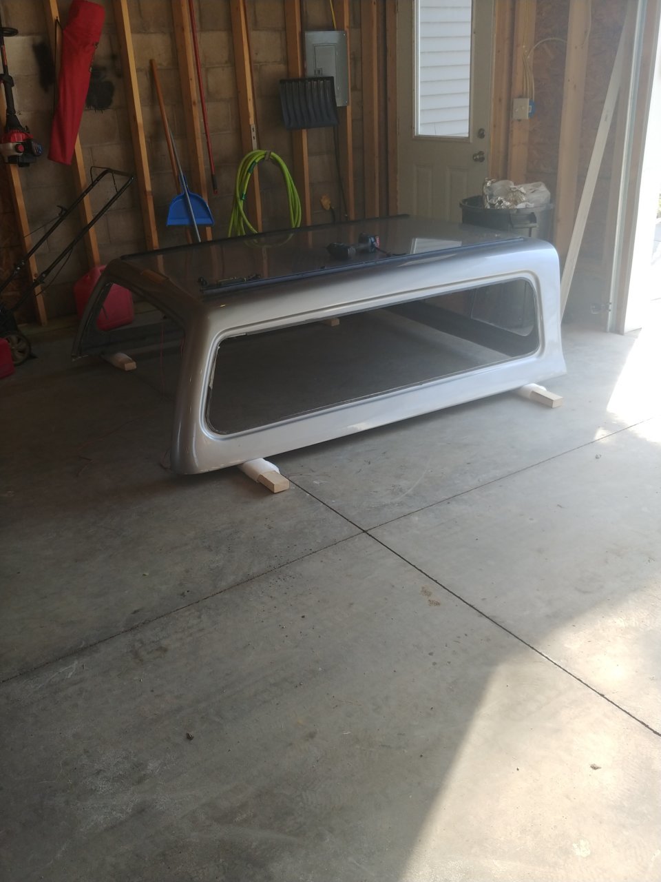

  16. Mar 10, 2021 at 11:12 AM
    gcholmes1
    gcholmes1 New Member
    Jun 4, 2020
    #47542
    22
    2006 Tundra SR5
    Finally Found a topper/cap for my 06 DC, planning to build a camping setup. It's a Glasstite, I had to drive out of state to pick it up, but it's made for a DC tundra so it's a perfect fit.
    Got the windows and rear hatch pulled off to replace the weather seals (they were a little leaky). I'm planning to paint it while I'm at it. Has anyone ever use raptor liner on a topper? That's my plan at the moment, I think it should look decent. I used it in the bed and was very happy with it.

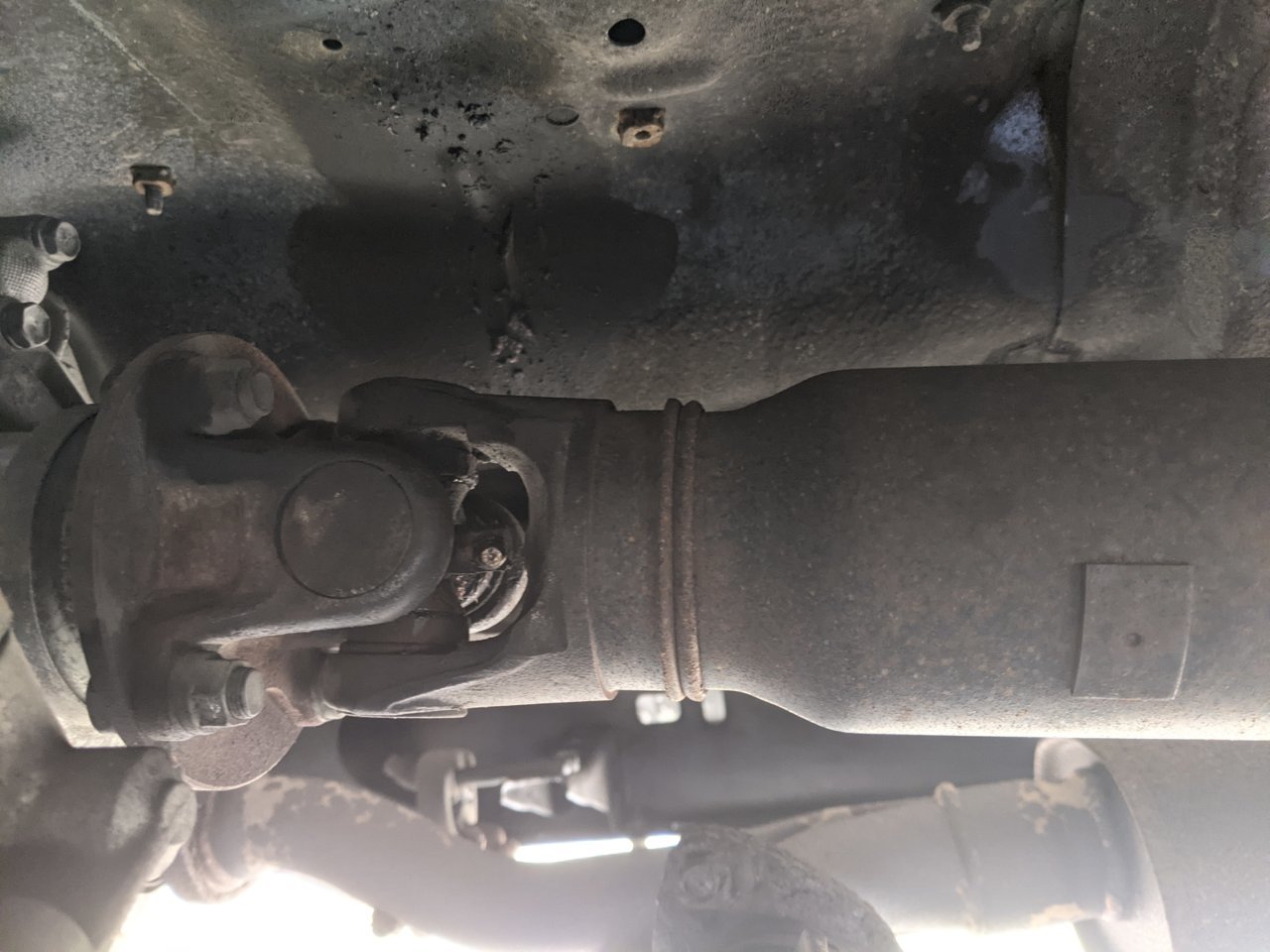

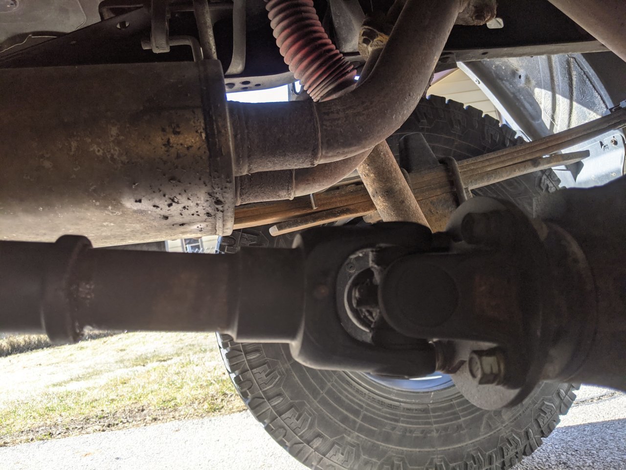

    I duhrka duhred this morning and didnt mark my driveshaft while changing the carrier bearing. Can anyone with a stock driveshaft first gen confirm zerk angle?
    3 joint type, please.
  21. Mar 11, 2021 at 10:06 AM
    FrenchToasty

    You mainly want to make sure the shaft is in phase all the way down.
    It’s basically means having all the ears in line with each other
    Sirfive[QUOTED] likes this.

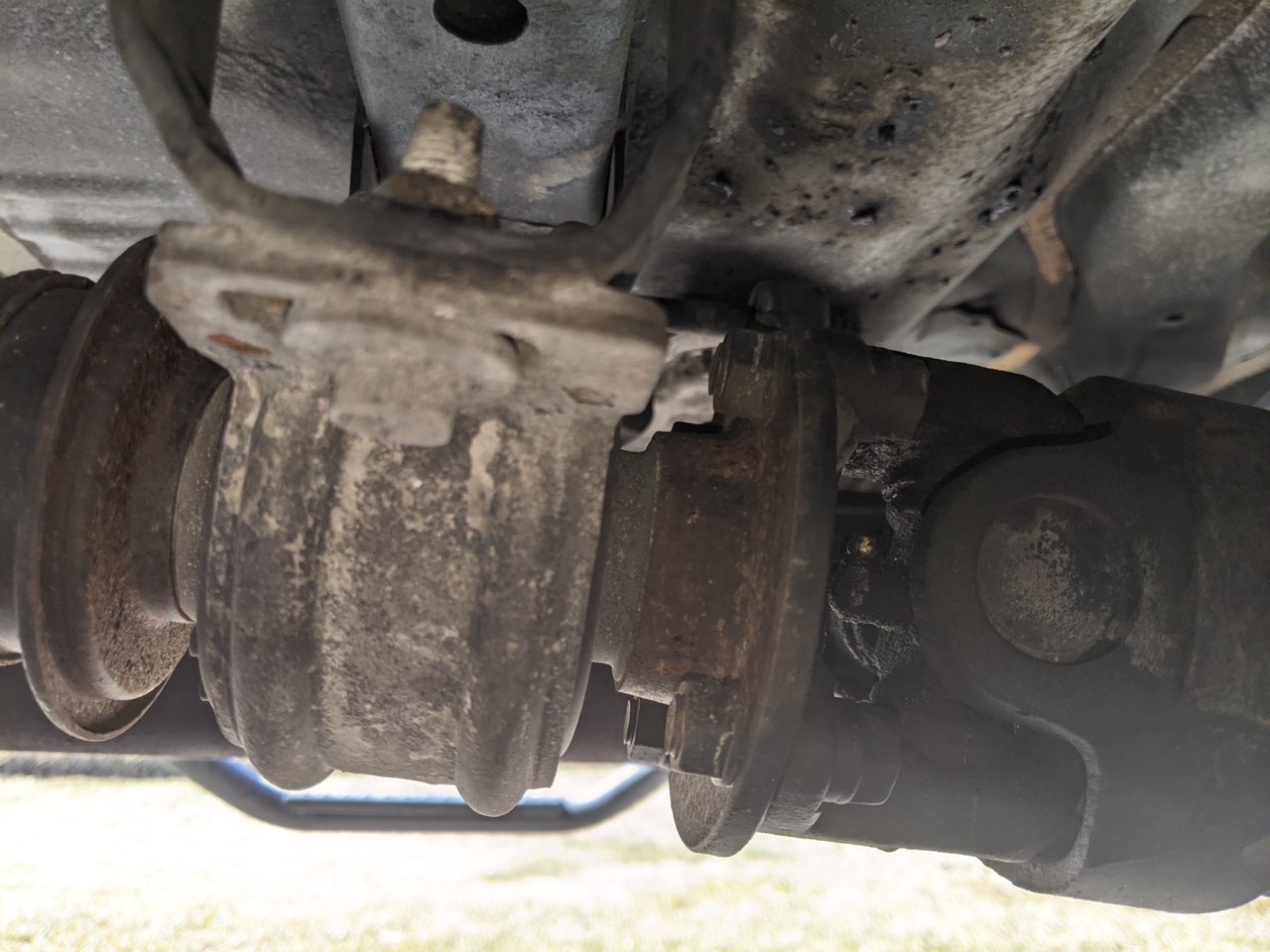

    I meant for the factory balancing. That image was from a tacoma forum, but id imagine theyd line up everything like that. Sequoia is 2 joint.

    All taken from same side and angle- ish. Hope this helps

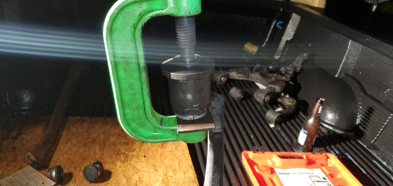

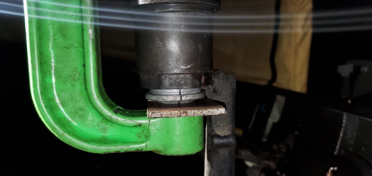

    I pressed on my UBJ for about 3 minutes with no results. I was like WTF! Finally I scraped the dirt, and grime away revealing the retaining ring. :facepalm:
    I felt like a dumb ass, but gotter done.
    The kit I rented didn't come with a good adapter for the SPC adapter. I used a 3/16 plate.

    Can confirm diagram is correct.
