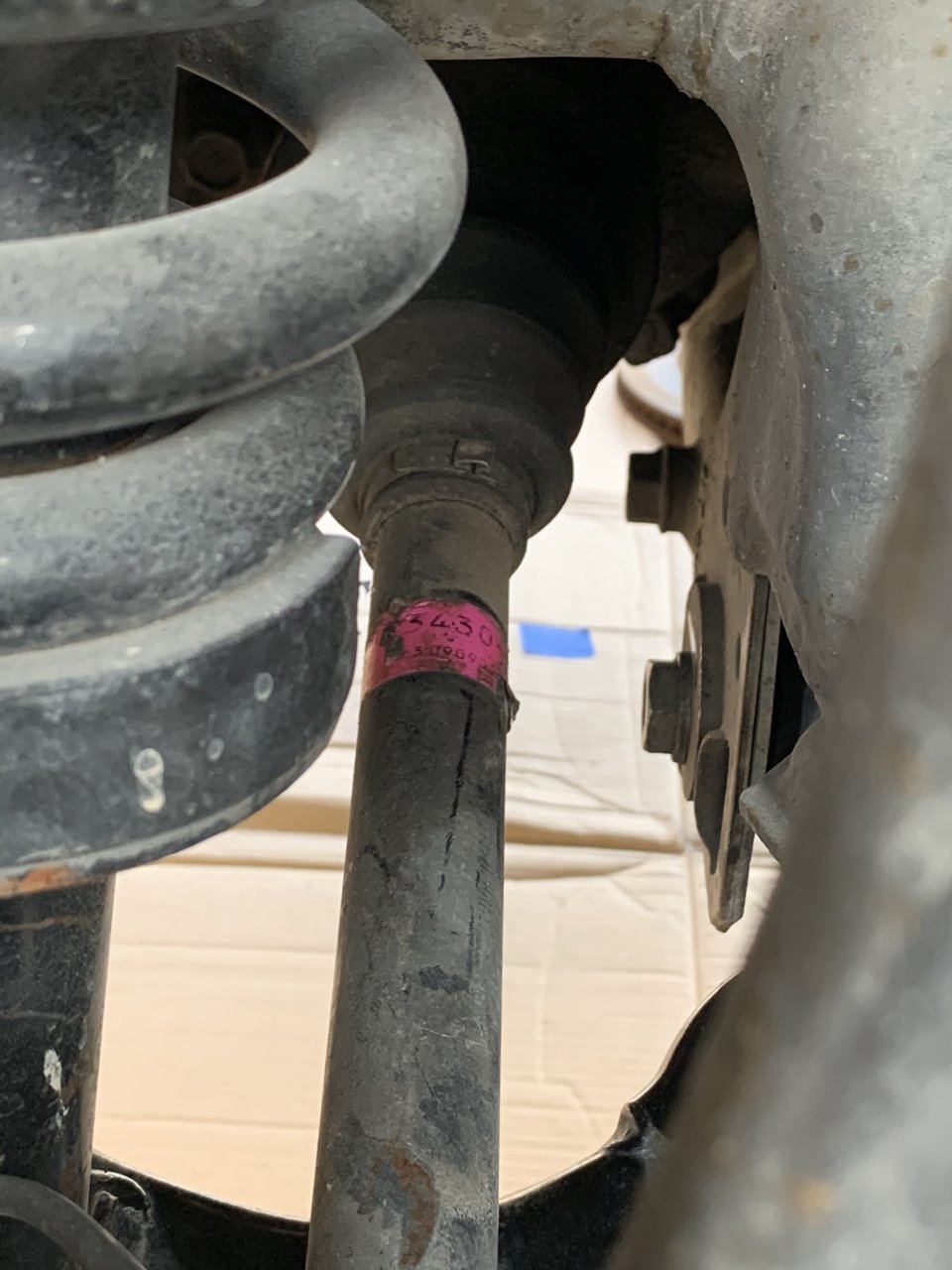

    Blammo!
    Pass side, you can see the torn boot:
    Driver:
    This truck just keeps getting better.

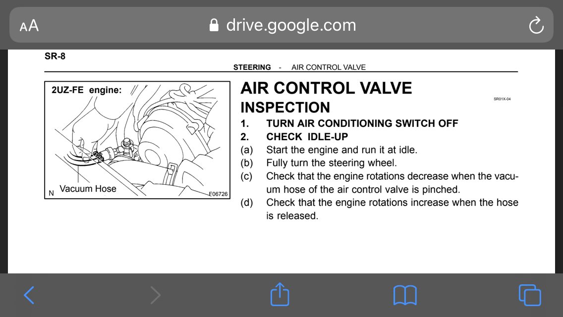

    Did some critical testing today, not sure how I should take the results, I was checking my “idle up” thingy, located on the PS pump zonal region, and it failed the test in the manual. For shits and giggles I did the same test to the other tube coming off the intake, and it preformed as the test describes.
    I pinched both lines(separately) coming off the idle up valve and no change in rpms(noticeably) but when i pinched the one going to the evap system(?) it Audibly and visually changed rpm.
    a tech said his always seem to idle strangly lean, and maybe that’s what I’m feeling or imagining?
    I still might get it smoke tested, but not sure about the failed results with the idle up valve..... maybe the deep voice will chime in soon....

    Did you turn the wheel fully as you were pinching? You have long arms if you did.

    Yeah I wasn’t sure of the specifics of the hand move for this one; I turn the wheel......... and then walked around and pinched tubes in question. It doesn’t say keep it banked, or anything like that, so I think it just needs some kind of resistance on the pump? When I turn my wheel I do get idle up and down, but I’m wondering if it’s not enough....... I didn’t glance at the right moment but when I did bank and hold I thought I saw it dip to and maybe below 500rpm.
    That valve isn’t cheap, but it isn’t expensive either

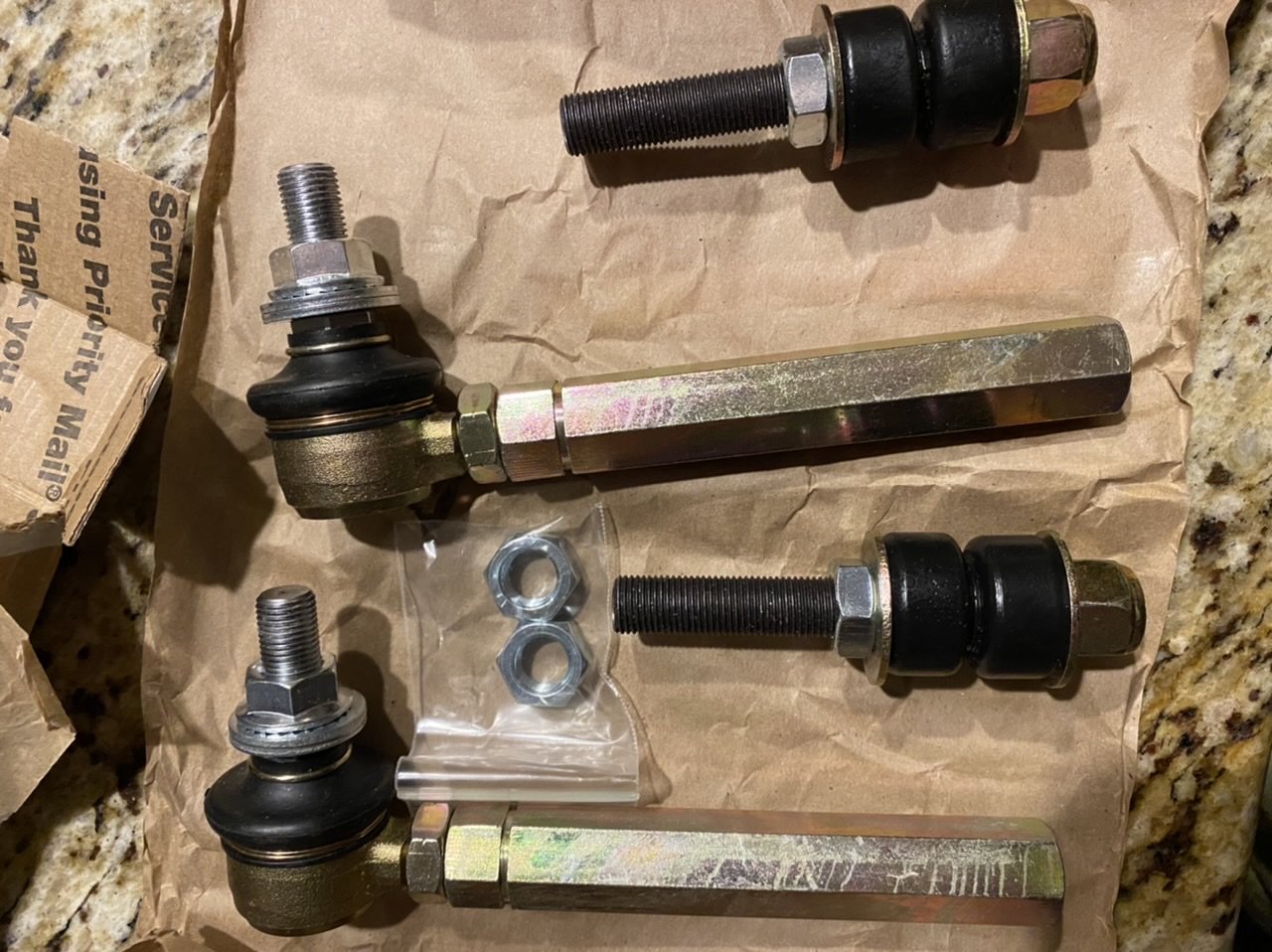

    just over here collecting more parts. Shoutout to overland custom designs for some killer sway bar links. Should pair nicely with the energy suspension bushings I ordered earlier.

    I think that 50rpm dip is proper and iirc is written in my Toy Manual in the Glove Box as a reminder that is normal.

    Beefy!
    If I ran one I’d consider them, but I rarely see freeways or freeway speeds.

    I bet your correct, but I wonder why the device test still failed. I wonder if it can be cleaned?

    I think that might be Bad Mojo. Better to buy new the first time than to Mangle and have to buy new after the fact.

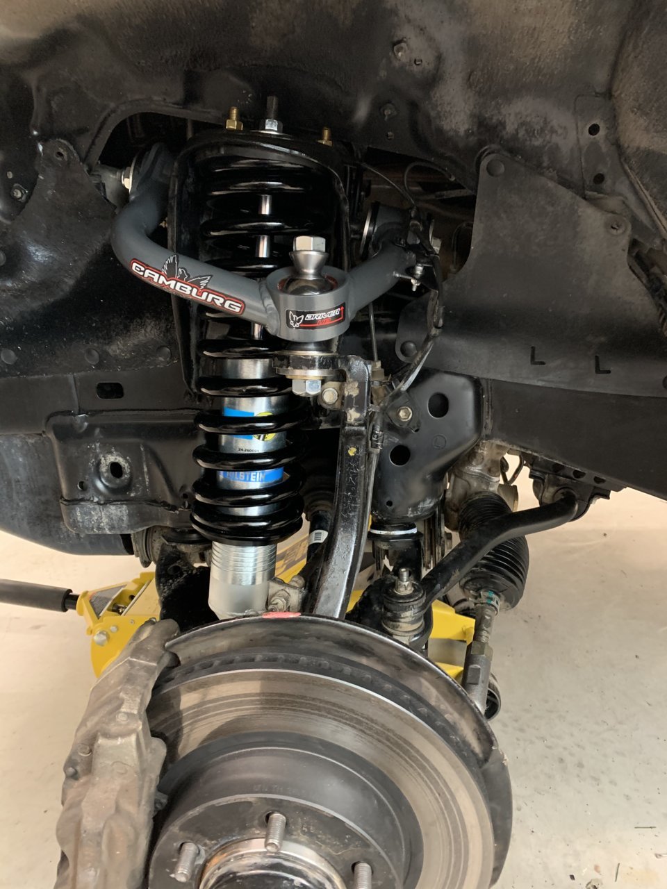

    CAMBURG UCA
    Moog tie rod ends
    Moog lower ball joints
    Hellman front sway

    Nioce and shiny down there!
    Be careful with moog lbjs; seriously just get Toyota lower ball joints and be done with it.

    Hmm. That suspension looks soo much like mine. [​IMG]

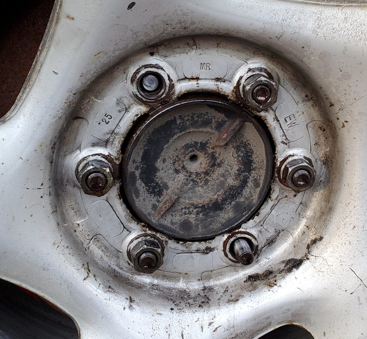

    I heard a "tink" from the rear this morning on the home stretch.
    Found my tink.
    Who do we use for lug studs?
    Currently taking this wheel off to investigate further.
    Looks like the High dolla alignment shop used 15 too many ugga duggas. I checked the other three wheels. Both rears look like way too many duggas. Fronts are OK.
    Edit: I guess it would be a good idea to replace all 24 lug studs, eh?

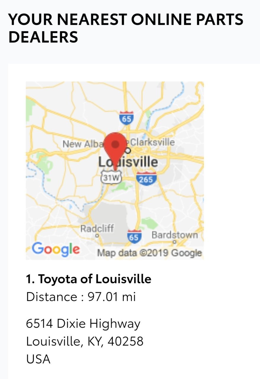

    Not even 75 miles away?

    You mean participating stealer, or in general?
