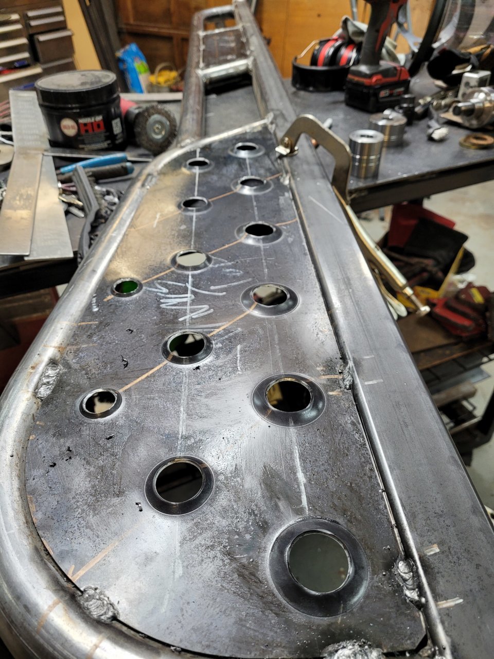

    After almost a month Hiatus from the garage (grinding spark in eye followed by storm damage cleanup and work getting in way).
    Plated the sliders for Tundra and pulled the first plates worth of dimples. I swear im.gonna actually install these soon....

    @Siebler, those are looking so good man!

    This is exactly what I plan on doing for sliders I eventually put on... plating looks soo much better to me... plus it’ll help keep all the shit off the side of the truck

    I dont like the solid 1 piece long fill plates so i chose to just plate the middle of the long run, where I stepessentially. Figure if i want to I can always plate the other 2 sections in.
    The inverted dimples make awesome grip when getting shit on/off roof rack and stuff too. I went with 3/4", 1", and 1 1/4" on these.

    Those dimples are key!

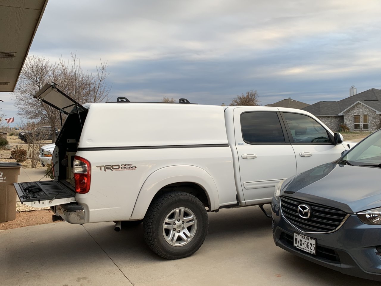

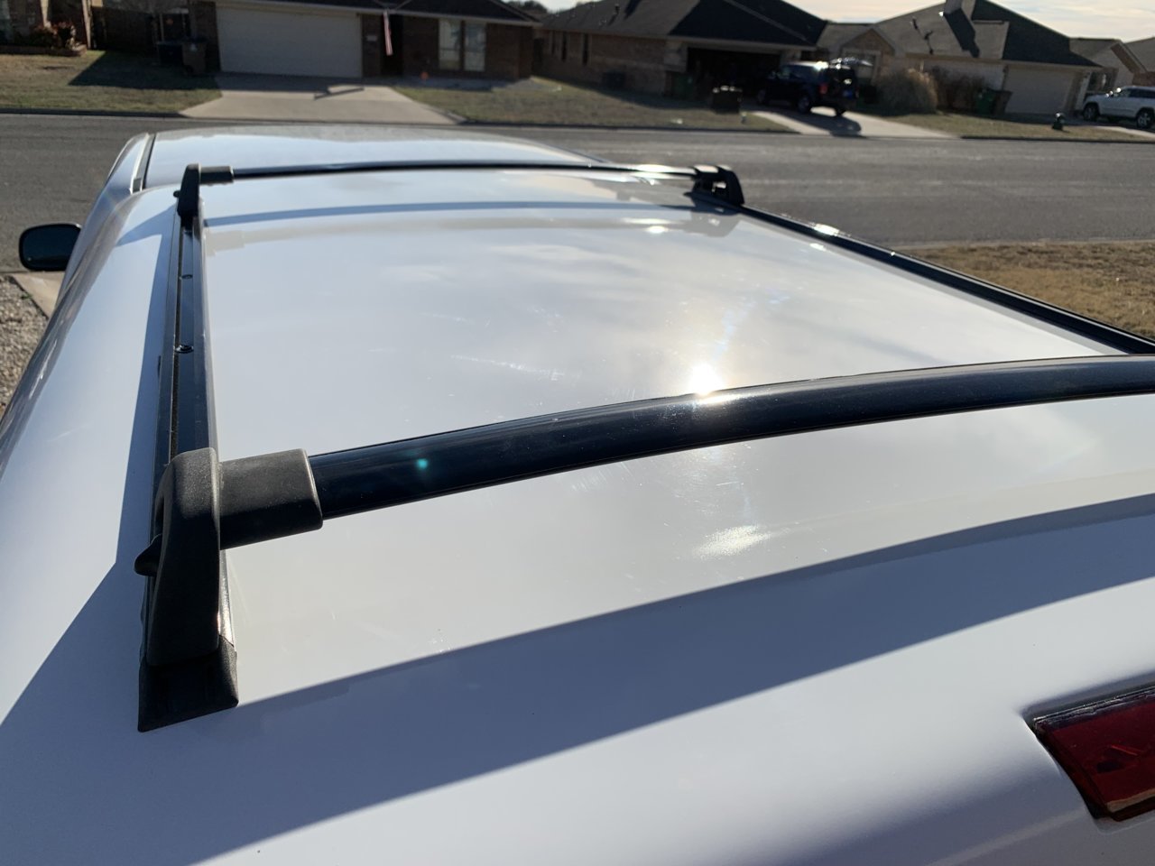

    It was pretty sun beat so I hit it with some 120 and threw a coat of Rustoleum on it. I probably should have went flat vs gloss but ehh... The cool thing is that these Escapes are everywhere. I counted at least 4 in my small yard. If you need/want more cross bars, they seem to be plentiful.
    I ran two rows of butyl tape along the bottom and a bunch around the screw holes. I had 3/4 of a roll left over from reinstalling the windows but a fresh roll was under $20 at the big box store.
    oscardog86, hammeron, NUDRAT and 4 others like this.

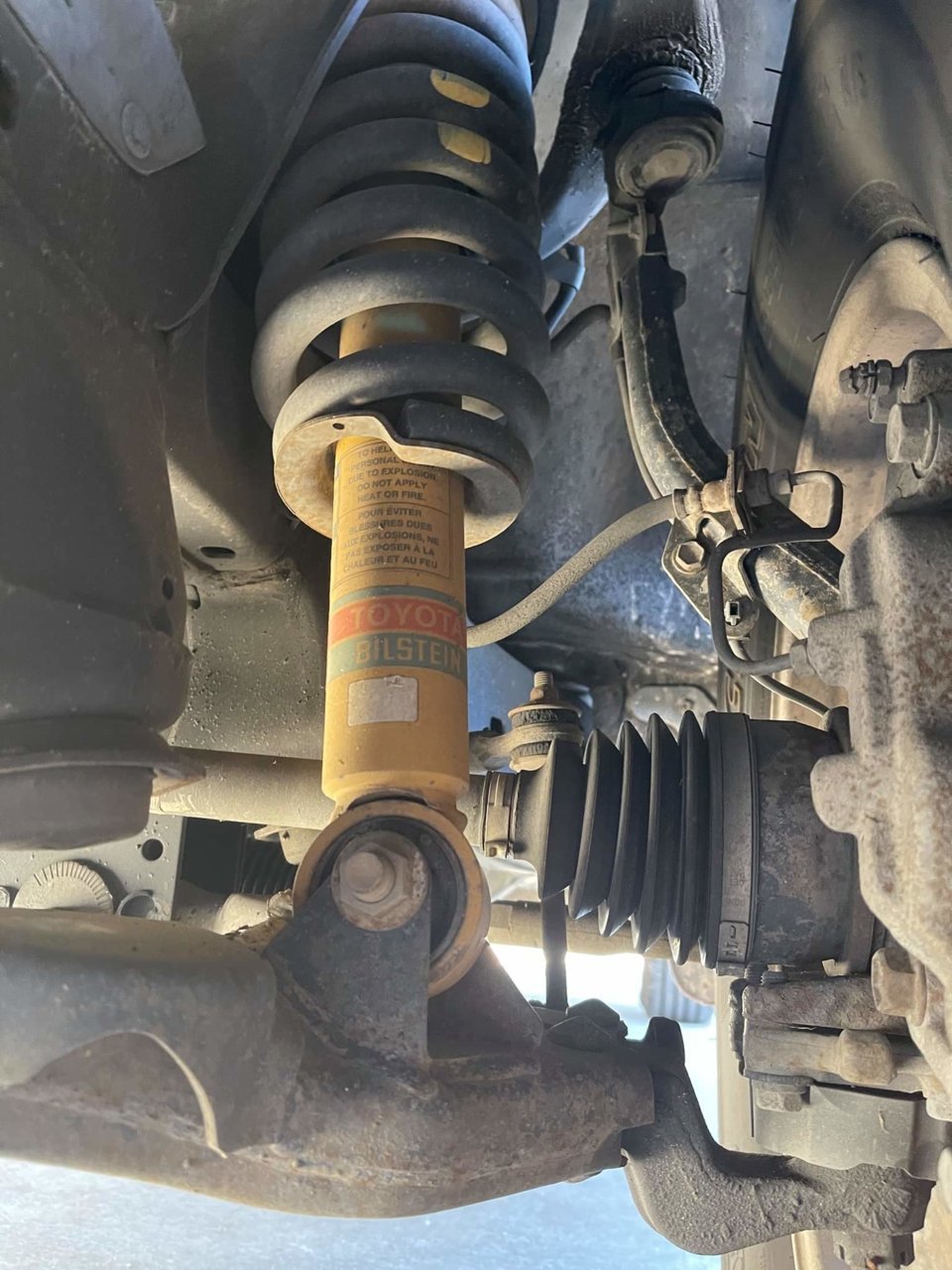

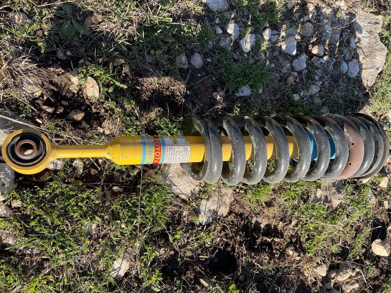

    No real work yet, still planning, collecting, and eyeballing.
    old
    157297000_10158936602940275_754754188689_d45ed25827532b584fa3cfced985cd164e334525.jpg
    New
    156138850_10158936576870275_766144357942_28e07b9f2395c50ef9fd4146c810c93898071cad.jpg
    The 2nd leaf has a hook? I think these are tacoma springs, but does that hook go forward? Is it to protect the rear shackle?
