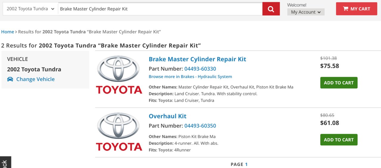

    Posted the wrong parts above earlier. This is the rebuild kit. Looks like our New Cylinders are $1200?

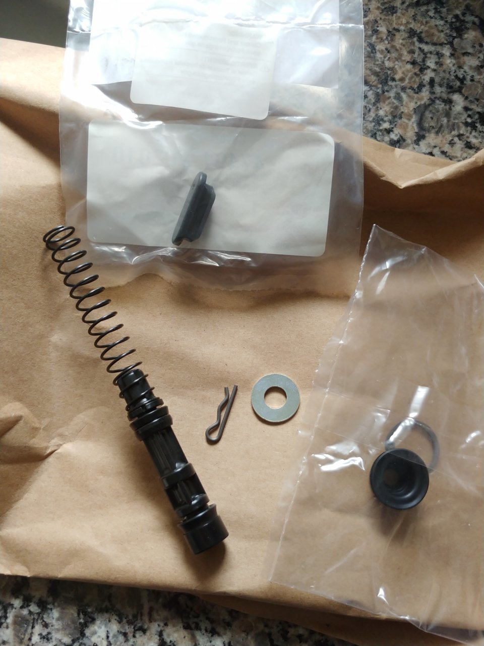

    Here is what the parts look like. There isn't much to a MC. I watched a video on it which I posted before. They guy explains why there really isn't a need to replace the entire thing when you can easily rebuild them. He said you only replace if the cylinder bore is damaged like Empty mentioned.
    I see no reason to spend $250 on a new MC when the new spring/plunger thing is $30.
