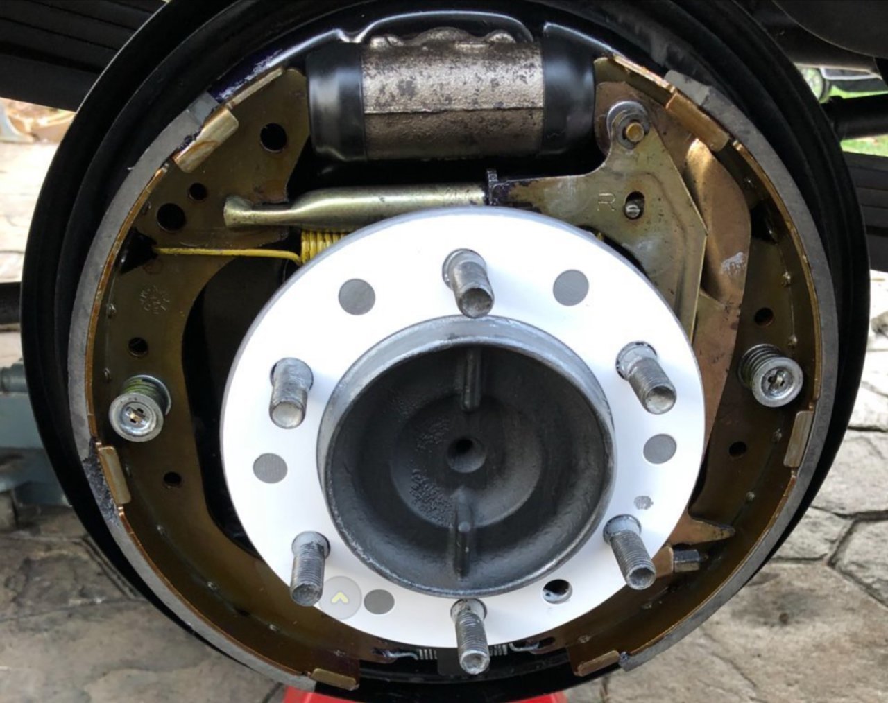

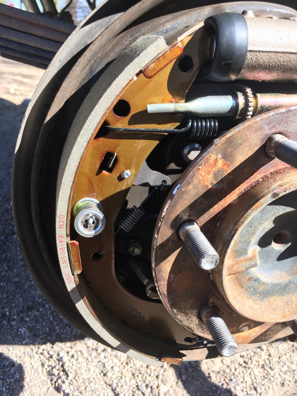

    Finished up the rears and the new brake lines.

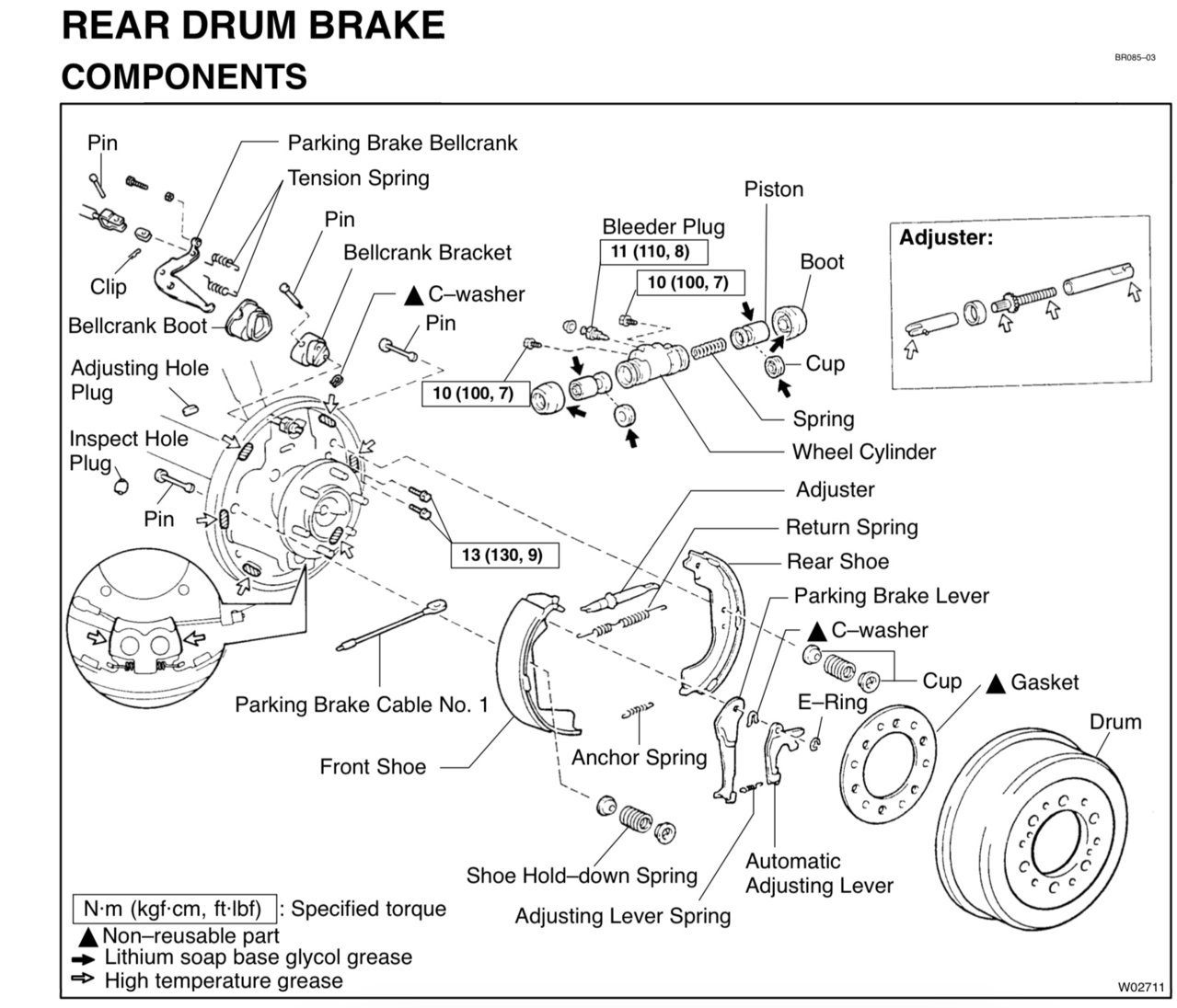

    Maybe some of the pros can help out. I got everything the way it should be but the rear adjusters aren’t moving when I work the parking brake arm, I don’t see where I missed anything. Is this why a lot of people say the auto adjusters don’t usually work?
    Darkness, hammeron and wandering_boy like this.

    They are side specific. One side clockwise. The other counter. We have them proper?
  4. Feb 14, 2021 at 10:03 AM
    Professional Hand Model
    #14878
    14,993
    Fred
    Hand Protectors
    Another member reinstalled his originals backwards and they didn’t self adjust.

    I did them one side at a time, so I’m pretty sure I have them proper(I can still adjust them out and hear the clicks, and it won’t spin the other way due to the ratcheting system, so I believe they are proper)
    It’s almost like it’s not getting enough down travel on the adjuster to clear the racket finger to get it to click, but I don’t see how/wear to correct that
  6. Feb 14, 2021 at 10:46 AM
    #14878
    14,993
    Fred
    Hand Protectors
    Did you swoop under the bottom guide with the inner drum cable?
    Goofy mechanic that did mine went straight across and the reason I could never get the adjustment proper until discovery when re-doing brakes.

    Yeah I went under.
    Are you able to get yours to click with the drums off?
    My buddy said it might be because the shoes and everything is moving to much to get that Lil wheel to move enough to grab and turn. So I’ll try slapping drums on later and see

    Never tried with the drums off using the pedal. Just did the hand click to make sure things were loose and moving. Put the drums on and everything worked. I could hear the drums click separately and set with the door open when setting pedal for first time.

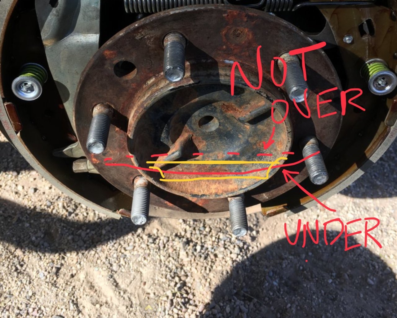

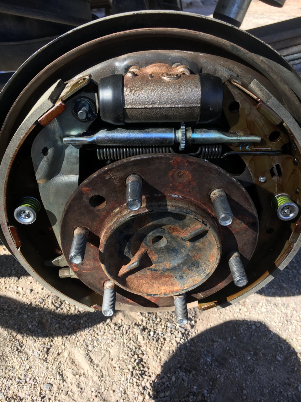

    So it appears we have some different parts on our rears for some reason, but I looked in my fsm and it basically matched yours.
    After looking on your build page; So on yours the self adjuster is attached to the same shoe as the parking brake lever and the self adjuster is in front of the star wheel. And attached to the same pivot as the parking brake
    On mine, and all the other videos I watched, I have no eclip, and my self adjuster is behind the star wheel, and pivots from the opposite side as the parking brake lever.
    I got both sides adjusted out as far as I’d like to go for now, wheels torqued and on all 4 for the night

    Yeah that’s the exact picture I was looking at. It’s also interesting your rear shoe doesn’t have the pin for that auto adjuster lever. I wonder what year it changed(I even downloaded the 05-06 fsm)

    Not sure, but the FSM pic I posted and used for my brake job was from 03. Wire that paper off the axle hub. Its killing me. :rofl:

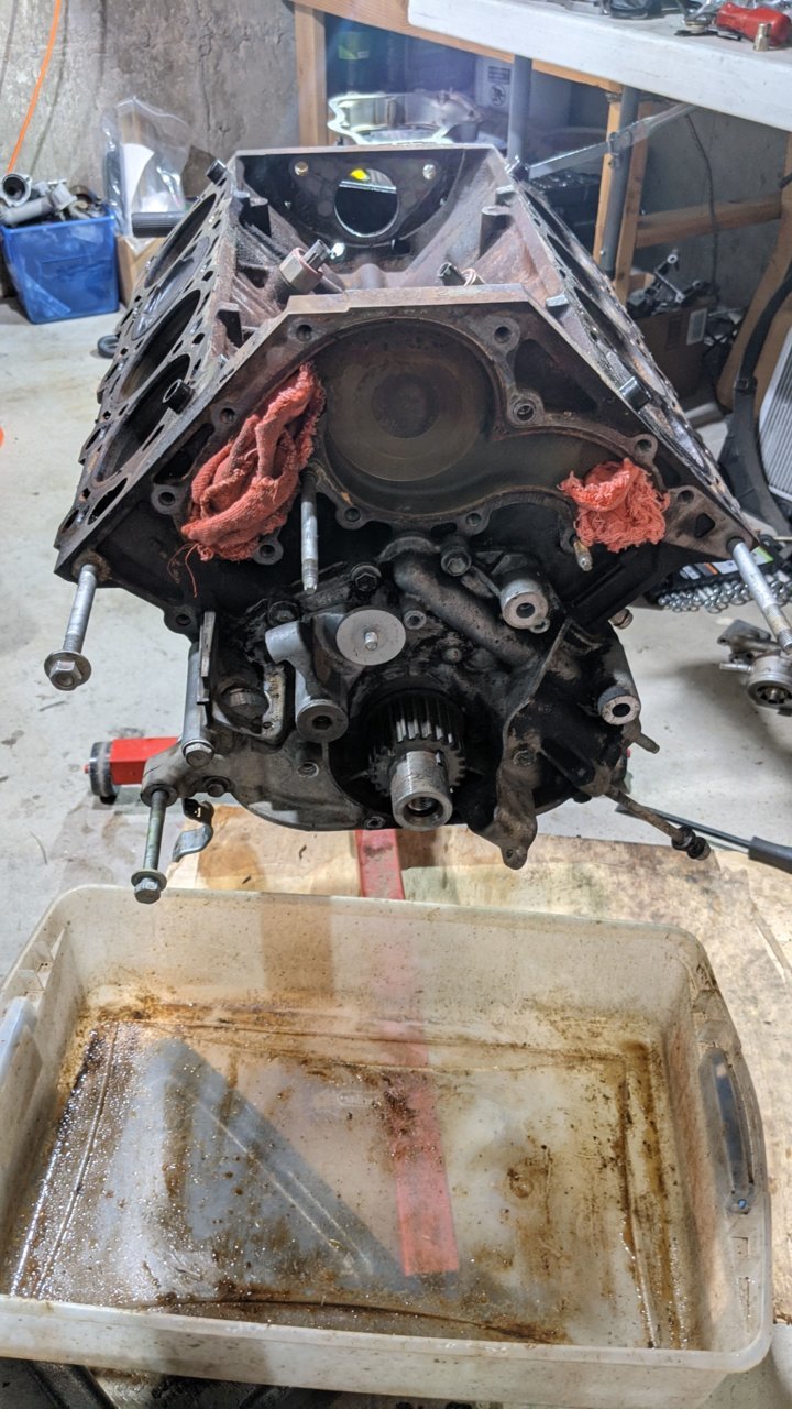

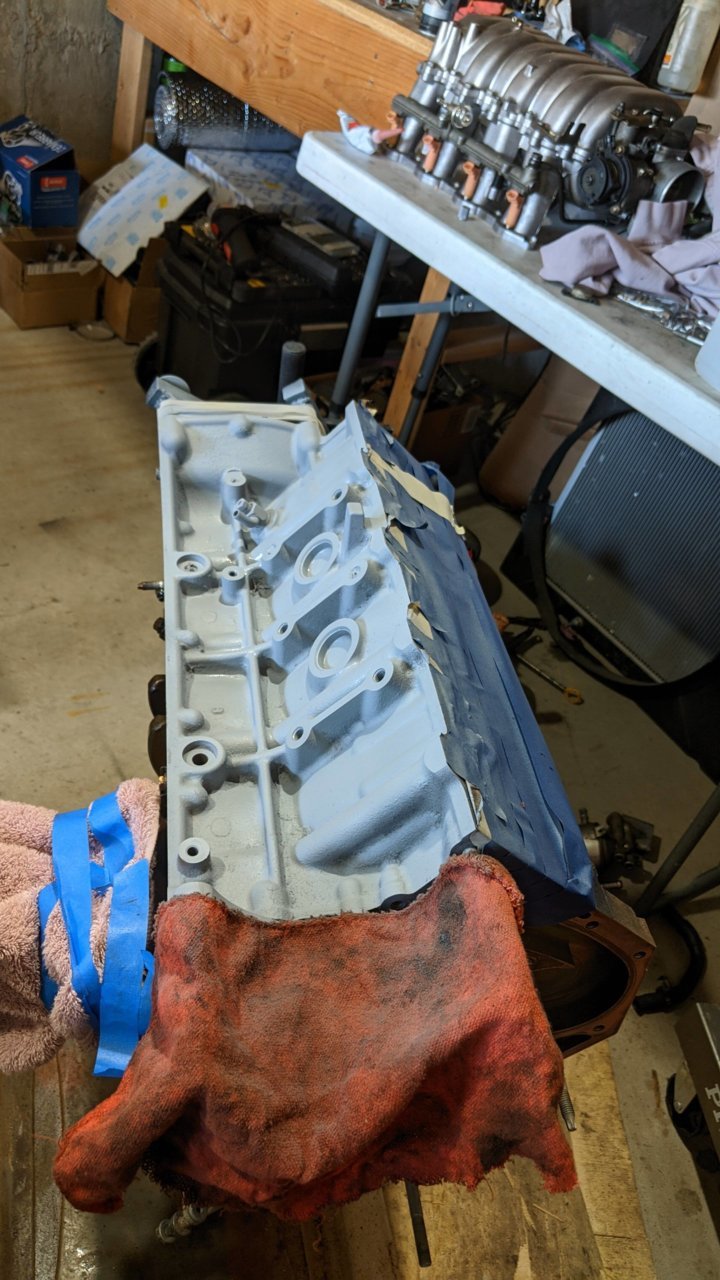

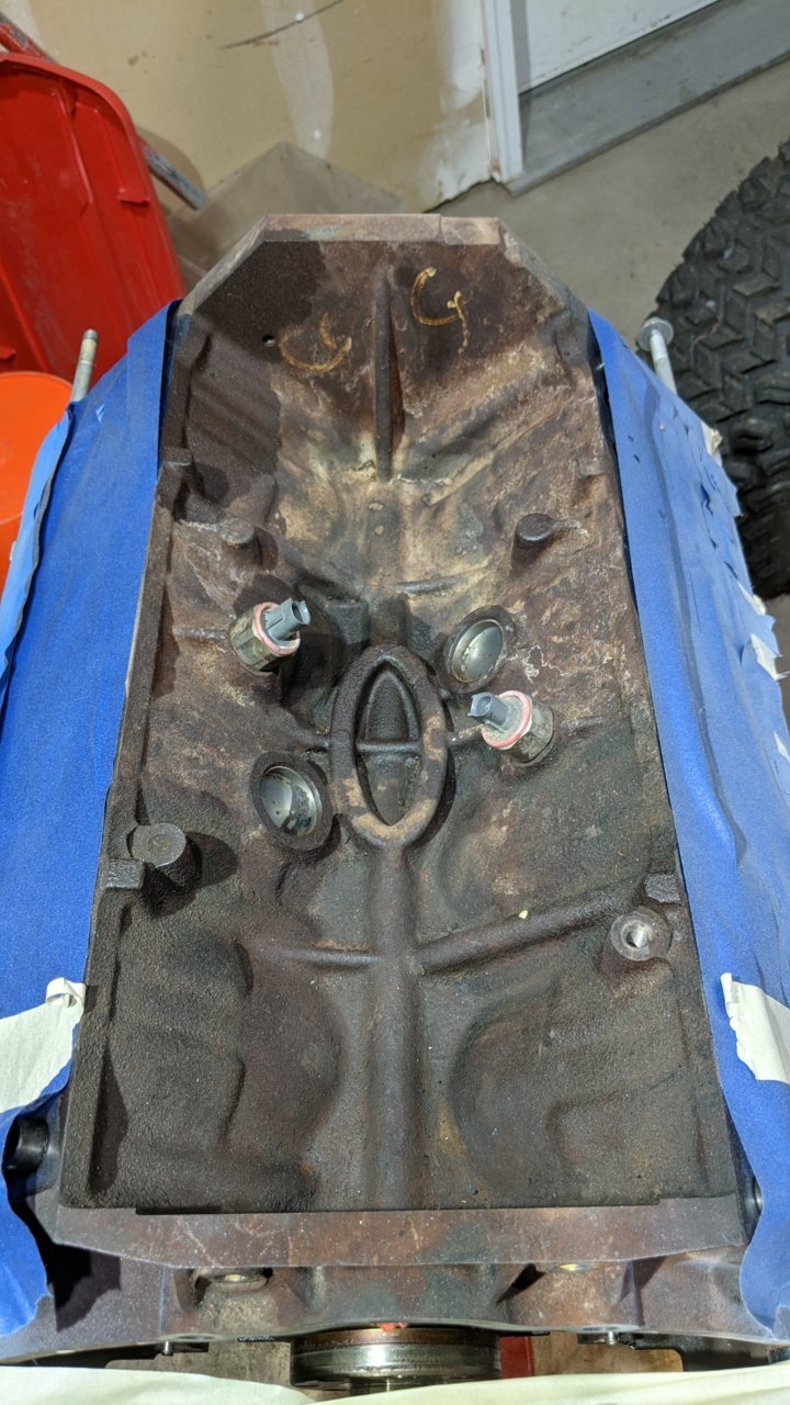

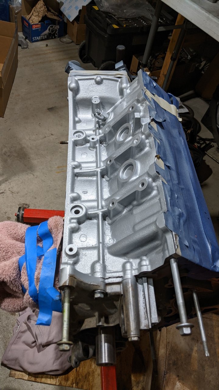

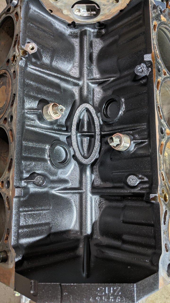

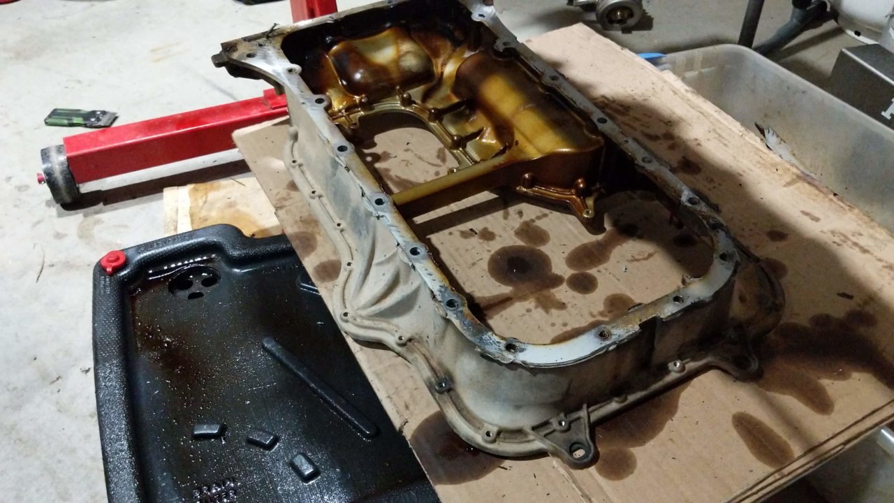

    So excited to share my progress with you guys. Got stuff done on the engine rebuild the past few days, here's what.
    •Painted the engine block. A missed opportunity to go with neon orange or green.
    I took a day properly preparing the surfaces by wire-wheeling with different sized brushes, scuffing up the rest of the rust with Scotch Brite pads, vacuuming the dust, cleaning with alcohol, and finally taping off areas to prevent overspray. I swear by Duplicolor high heat engine paints, and I layed down some nice coats of their primer, enamel, and clear coat per their specific instructions. I thought the clear coat would be a waste, as there's no UV rays under the hood, but it actually makes paint last longer as an extra protectant. I really like how the black on the top turned out!

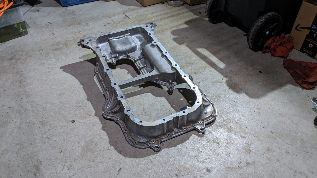

    •Removed the upper oil pan for cleaning and resealing. It's that large piece the oil pan attaches to, not sure what it's actually called.
    I noticed its gasket material was old and brittle with some pieces actually coming off inside the pan. Restoring it was probably overkill; still, I don't want any more problems down the road. Dumb Dumb Moment #1, I painted it separately instead of when it was on the block. Hurray for extra steps. The picture only shows post-cleaning, I'll take another when it's all put together.
    •Removed rust from the cylinder walls. SB pads once again, doing the trick. No pics because it's not 100% yet. While we're not dealing with microchips here, I couldn't help thinking precision matters and screwups now would affect tens of millions of revolutions. (Someone can do the math.)
    •Replaced a single expansion plug. Yep, just one. I bought the whole set because I thought I'd do them all as preventative maintenance. Seeing that just one was a PITA, I decided against that. Listen, these things are IN THERE. Really hammered the old one to get it out, I think I'll be fine leaving the rest of the original freeze plugs and they're not going to spontaneously fall out. They also do not rust. I applied RTV around the new one and placed a similar-sized socket over it to be easily pounded in. I'll sell the rest.
    •Cleaned and prepared front of engine.

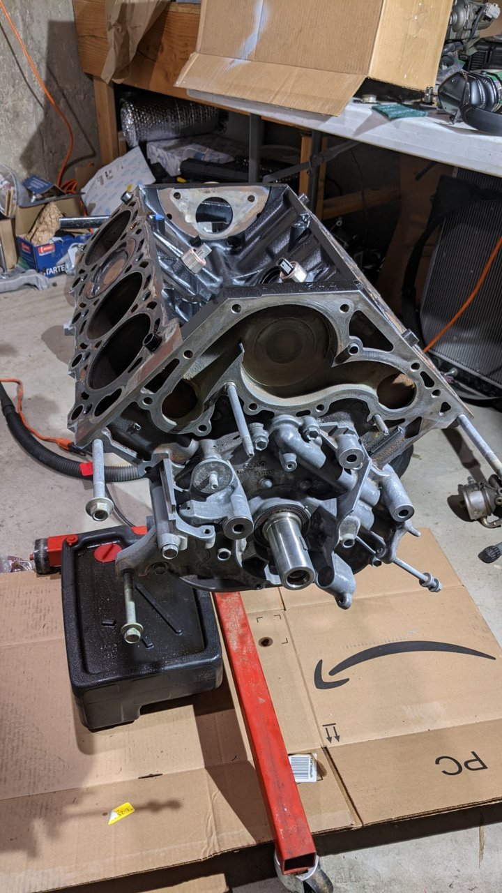

    Before:
    The water pump gasket surface had rust and that whole area just needed a restoration, I guess when my friend and I replaced the timing belt two years ago we weren't meticulous. Looks good now and is ready for all the parts.
    After:

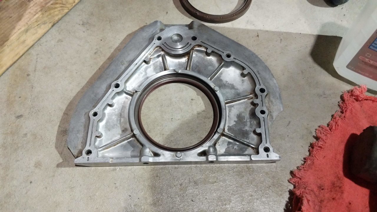

    •Restored the rear main seal plate and replaced the seal.
    These aluminum parts sure do clean up nicely, don't they? Still been doing the oven cleaner, dish brush, and spray bottle water technique.
    Did have trouble getting the seal out when the plate was still on the engine, so if anyone ever tackles the ambitious rear main seal job, the seal will pop right out with the plate off. I removed about 90% of the carbon buildup and prepared the surfaces (the bottom mates to the upper oil pan piece). A little white lithium grease on the seal will help the crank move against it. Also, Dumb-Dumb #2 Moment. A piece of the plate had cracked off when I tried to pry it from the engine, while unbeknownst to me, two bolts hold it securely through the oil pan. Everything will operate fine without the piece as it's a non-mating surface. Oops though.
    The machine shop will hopefully finish the heads tomorrow, I'll pick up the new head bolts on the way, and then everything is mostly reassembly from here minus preparing the head gasket surface! My biggest concerns are getting the timing perfect (with heads being off and me moving the crank around for cleaning), and also finding torque specs for all the front engine stuff.

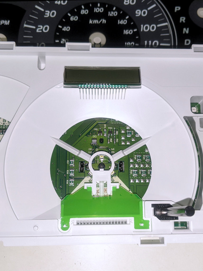

    LED Dome light finally came in (sat). Required slight bending of contacts but it works. Pulled it off the truck and fitted it while inside the house.
    Pulled the cluster and wet sanded the majority of the color. Gently removed the odometer LCD and replaced the green backing with a clear piece cut from packaging.
    Skipped the gear (PRND32) indicator area, but I will probably pull it and do it later. I also sharpied the backside of the kmh portion. Not 100% sure I'll keep it that way.
  28. Feb 15, 2021 at 9:51 PM
