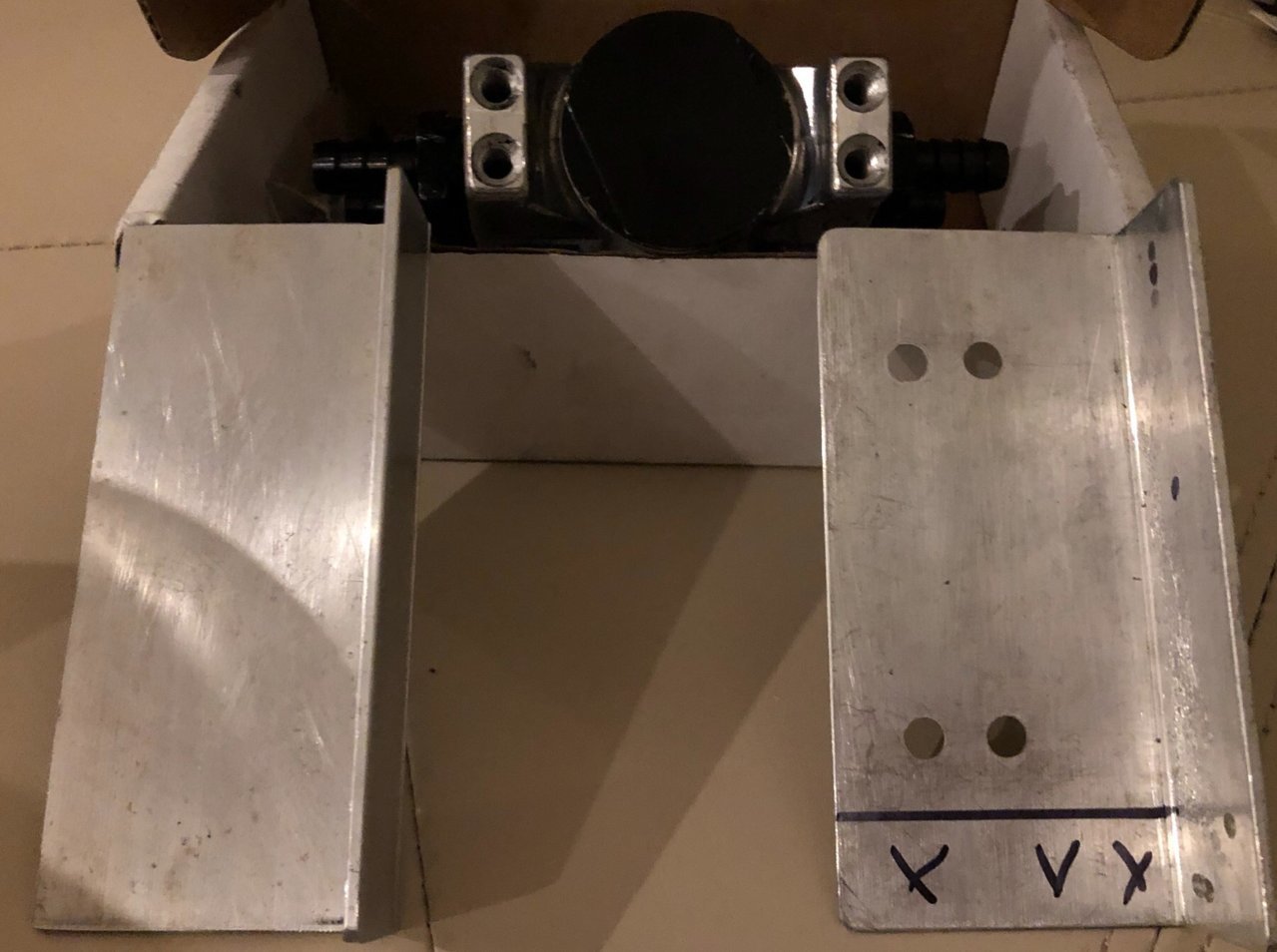

    Screwed in the adaptor fittings last night and Fab’d up the bracket today on the Fluid Control Valve. Need a few minor adjustments and to buy some screws. Might do the install this weekend if weather permits. Probs go ahead and drop the Skid Plate and change my Engine Oil and do a Drain and Fill on the Transmission as both are due. Three birds with 2 stones.

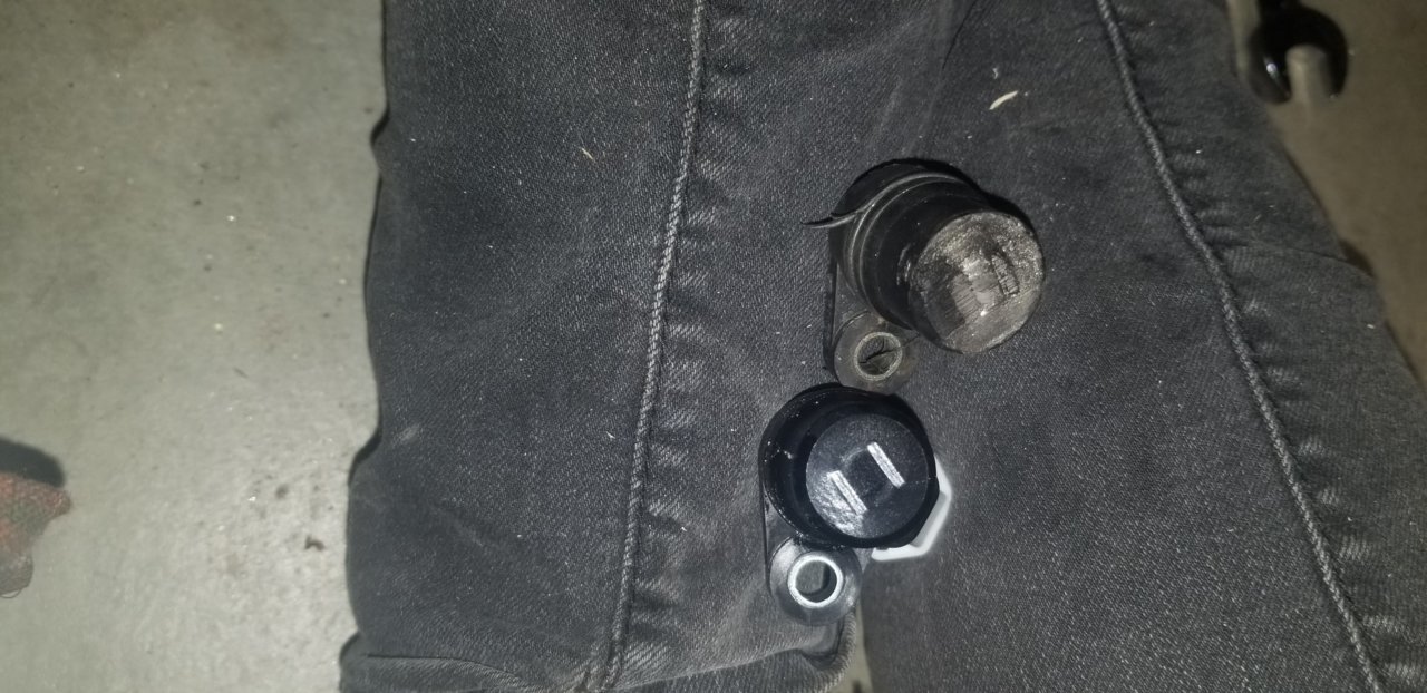

    Went and finished messing around with the sensor and got the new one in. Reset the ABS light and drove around the yard a few times and got ABS to kick in three separate times without the light coming back on. Should be fixed. :yes:
    You can see the difference between the two. Since this is such an expensive part I wanted to see if the old one would work after cleaning it up instead of replacing altogether which it obviously didn't.

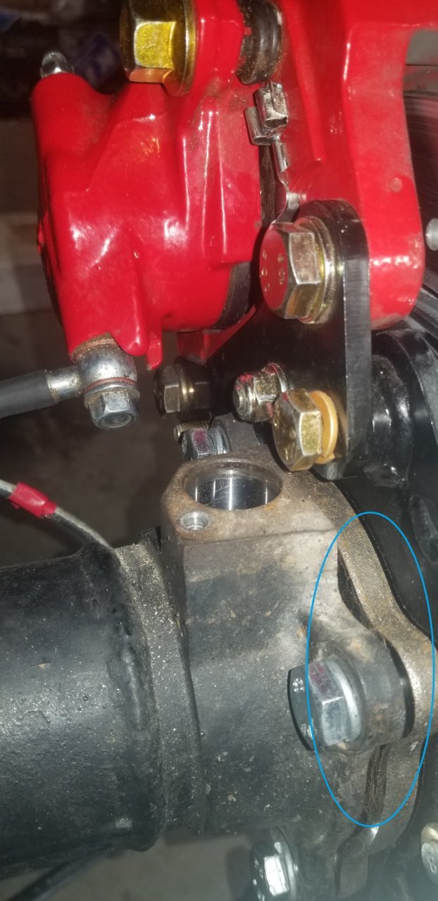

    This is how much I had to push the back the bearing housing and backing plate to replace it.

    :( that sucks

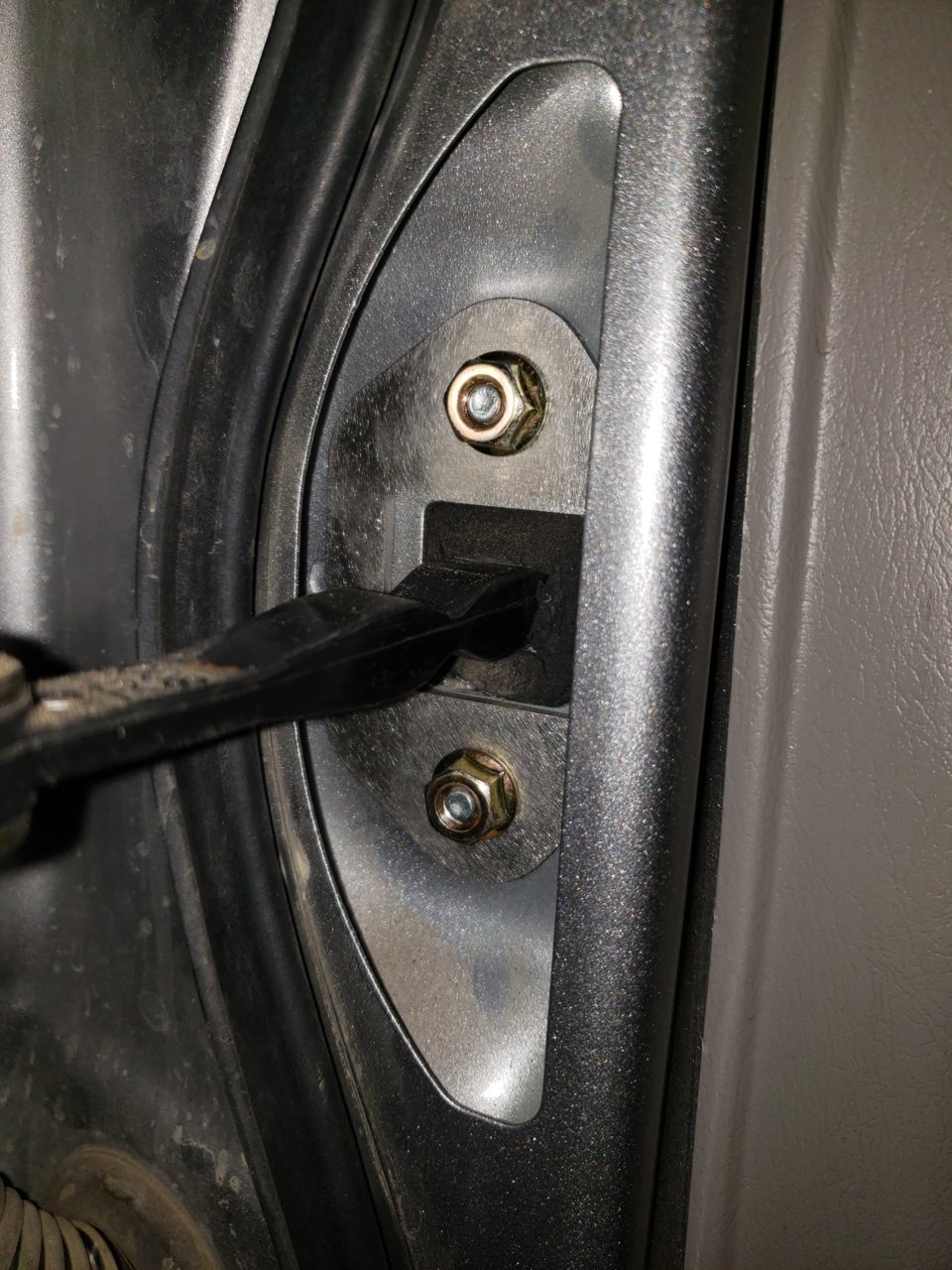

    Installed some door hinge reinforcements this morning.
    Buttoned up my leather install with heated passenger seat and heated plus ventilated driver’s seat last night. Used factory switch for the passenger get and put the driver’s switch in the console near the USBs. Absolutely love the ventilated seat here in SWFL.

    Who makes the reinforced pieces? I’ve never seen someone do tgat

    I got them from a guy named George Bailey on the FB group First Gen Tundras.

    I'm running those door reinforcements myself. They're really helpful considering almost every first gen I've seen has cracks around that door check.
    I guess I never made a post here about it, but I've been running it since September.

    Prototype Fluid Control Valve Bracket on the right. Blank soldier on the left waiting for the install.

    Cracks in the metal? I've never heard of this issue before now.

    The sheet metal in the door that surrounds the door check tends to tear/crack when people rip their doors open too hard. Most people don't even notice the damage until it's been ripped out almost entirely. It'd be worth checking your door jams for any signs or symptoms.

    Whats Facebutt Forum charging for these?
    I might make my own out Alu-mini-um (English Accent) Scrap.

    Was $40 shipped for the DC. Less for AC.
