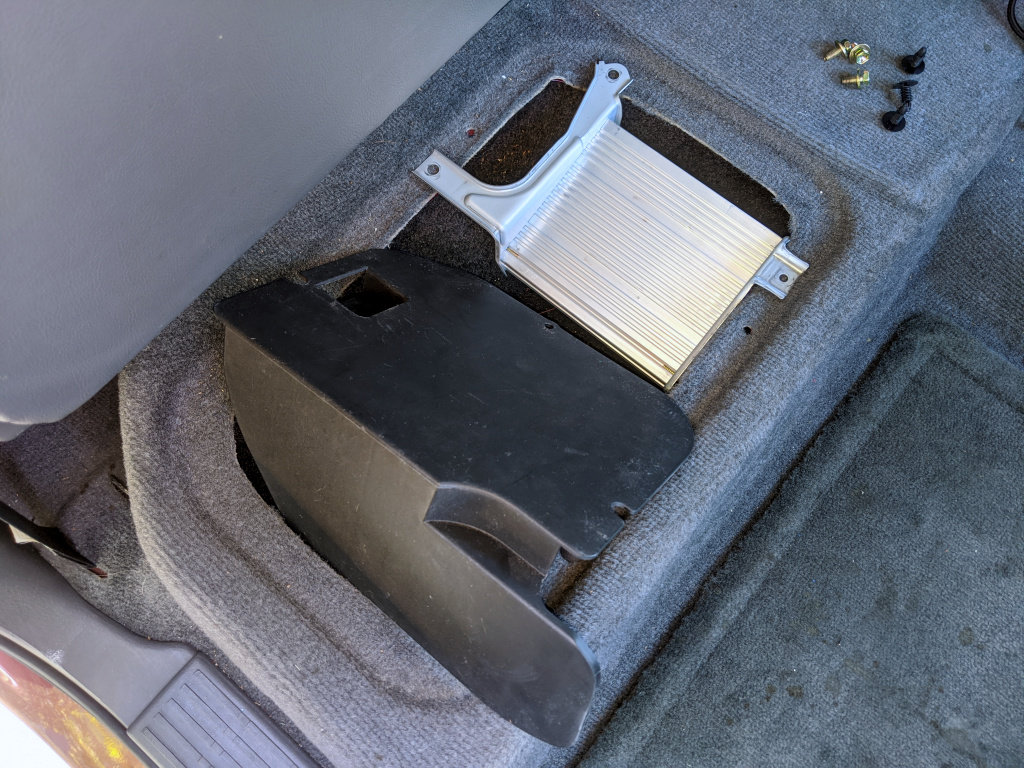

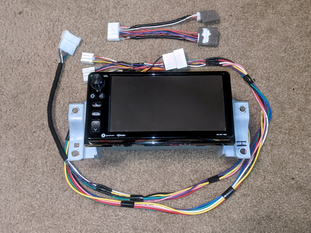

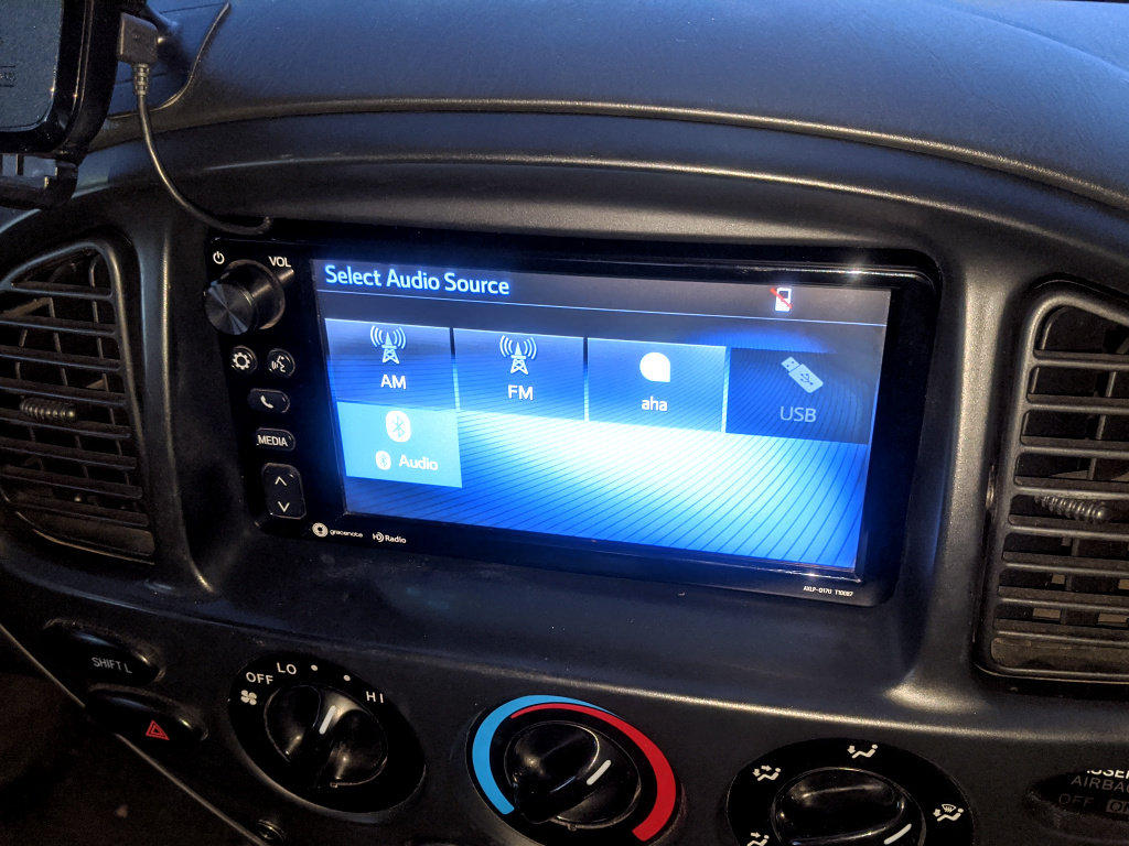

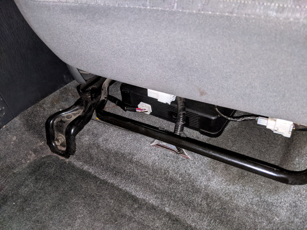

    I'm in the process of installing a 2017-2019 Toyota 86 radio. (Inspired by @empty_lord, also thanks for the help.)
    I have an '05 access cab, it had a 6-disc/cassette non-jbl radio. Unfortunately '05 & '06 models put the external original amp below the passenger rear seat.
    The 86 radio doesn't have low level (RCA) outputs to feed the original amp. The built in amp is more powerful and better sounding than the original, no reason not to ditch it IMO.
    I'm still waiting on a few things to complete the setup. Currently does Bluetooth audio only (no mic installed). Antenna and USB adapters are on order.
    Still have to install a backup camera and make the adapter harness for it, but it's been raining the last couple days. Not trying to lay on wet ground to do so.

    looks good so far.
    the stock large pin connectors on the 86 should have a pin for amp turn on. Typically a white wire on the diy harness ends. This could be used to start the amp.
    (I just notice you said ditch the stock amp)
    The highlanders with the older unit before this one used a seperate amp. I’ve been curious how much more power that amp had

    Also.. looking at you’re harness. Soo much cleaner than mine... I prototyped too many times.. need to find another factory radio harness plug to redo and cleanup mine.

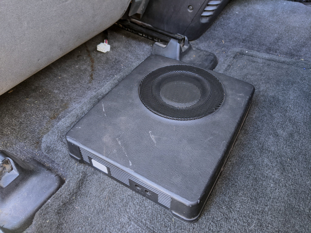

    Yeah. Definitely ditch the Tundra one. Way better without it. I didn't feel the need to buy speakers but now it's not even a question. :thumbsup:

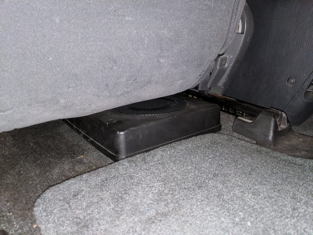

    Even the under seat subwoofer is working better with the cleaner output (it takes speaker/high level input).
    I don't know about the Highlander amp. Does it have a larger fuse showing that it may provide a larger output?

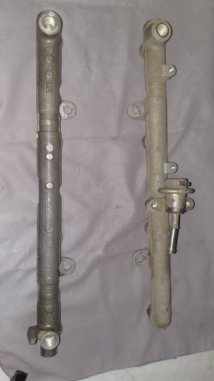

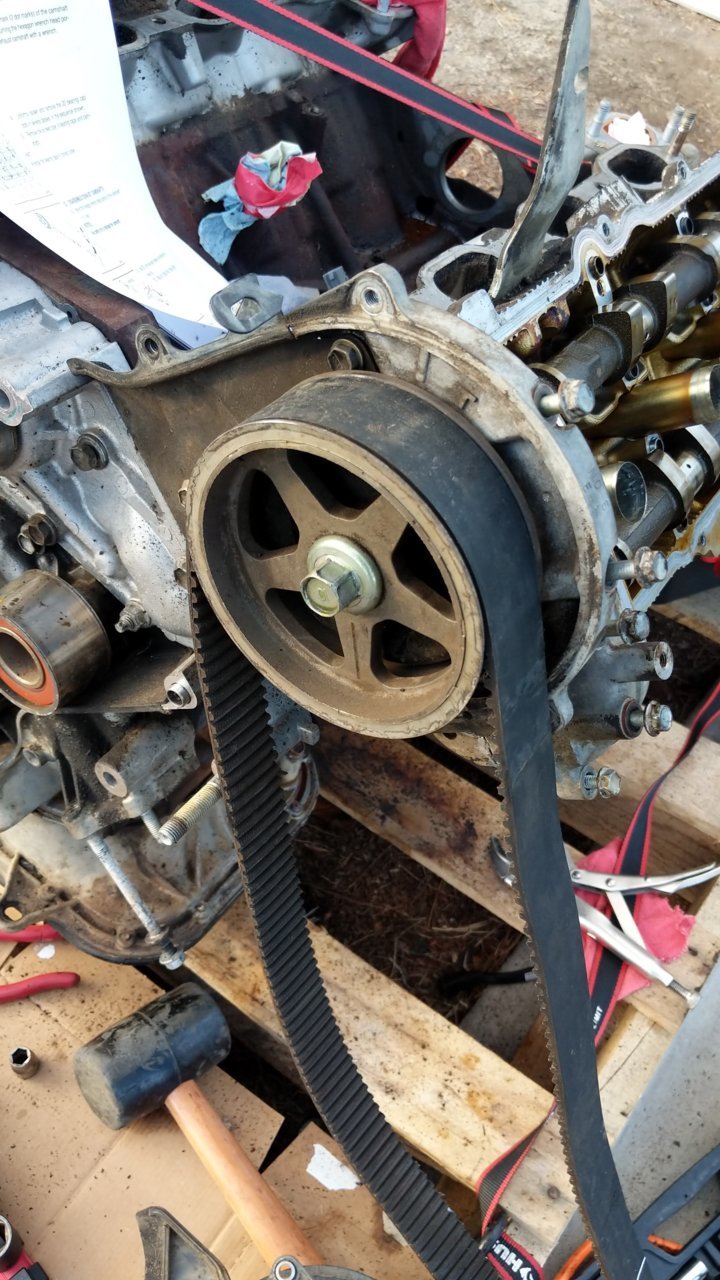

    Restored a bunch of my engine parts like my throttle body, intake, bypass pipes, and fuel rails (shown in process) since they are off anyway.
    For plastic bits (pics to come) I cleaned them and wiped on some Aerospace 303. For metal I used that 3-in-1 oil + toothbrush combo that @Professional Hand Model recommends and while I didn't get the same results, I was impressed. The oil helps loosen dirt that's engrained in the metal, while also being absorbed as a protectant.
    I went ahead and ordered a new fuel pressure regulator, they are supposed to last the life of the vehicle, but I aim to eliminate all negative factors for fuel economy/performance.
    My new Aisin fan bracket came today as well as the steering coupler bushing piece; while I'll compare them side-by-side, the new one already feels firmer than the 260K mile one.
    So far the head gasket job is going slowly, I got the cam shaft service bolts in and removed/organized the bearings, but the cam gear bolt won't budge! I have a camshaft pulley holder on the way which will hopefully help.
    I need to lift the old engine on to my engine stand and get it in the garage. I think the bolts are M12 x 1.25. Since the plan wasn't originally to repair it I'd merely strapped the block to a pallet and tied a tarp over it, which is not fun to work on in the Colorado cold and snow.

    It's a Subaru one. It was an option and available separately from Subaru for their cars. Occasionally you can find them in the junkyard.
    Sub info here:

    the sub looks decent.. probably enough for a regular cab. i was looking at the new JBL basspro for under the seat.. has the high level inputs.

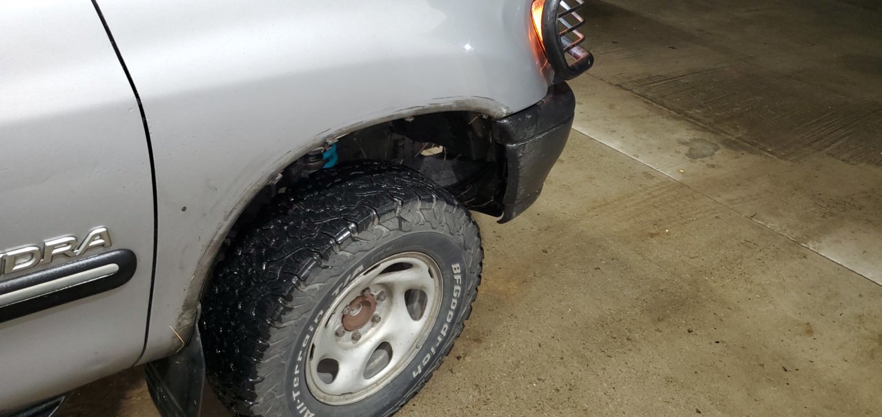

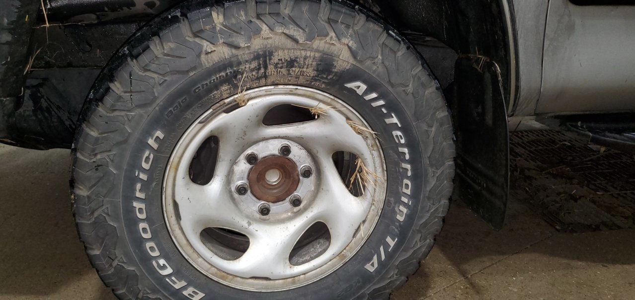

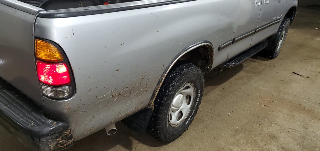

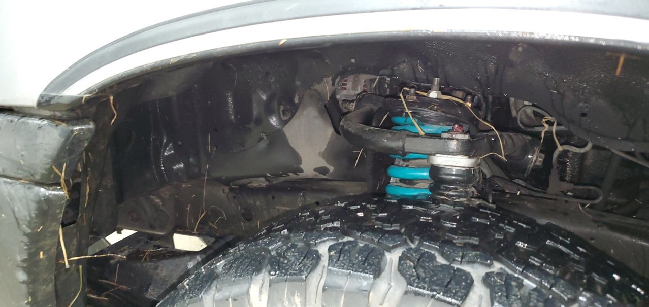

    Stopped at a local car wash to pressure wash all the shit out of everything. Or what I could get to.
    20210126_045327.jpg 20210126_045333.jpg 20210126_045352.jpg 20210126_045406.jpg 20210126_045414.jpg
    Lost a fender flare/trim. Bummer.
    Lots of field grass, just everywhere.

    Speaks volumes about the V8 head gasket reliability.
