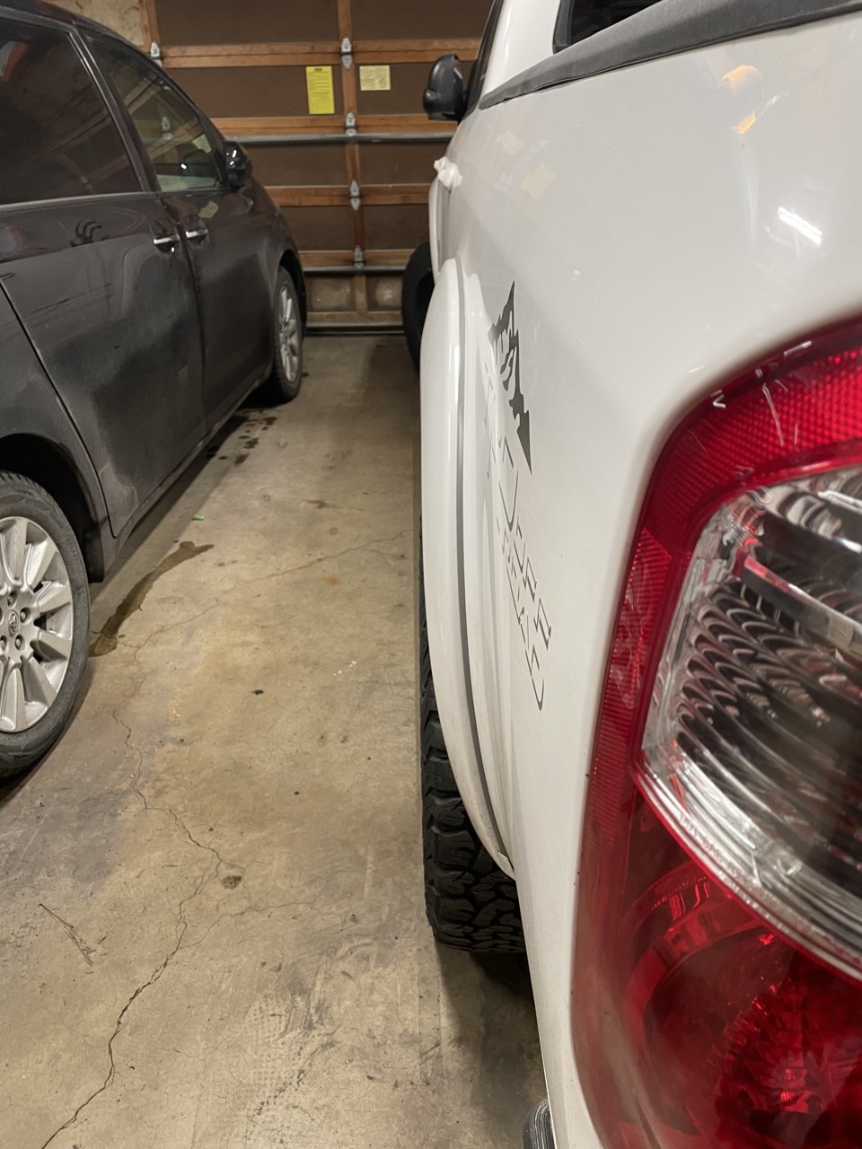

    About to do something I hope I don’t regret.
    Long story short.
    I got this truck with 20” wheels and replaced the tires last summer since it was cheaper than finding a 17 or 18” wheel/tire setup. I would like to go with a smaller wheel but I have yet to find one that I like AND that doesn’t sit further into the wheel well than my current setup. I initially had 295/55R20 open countrys but they nearly rubbed so I went a bit smaller this time around with 275/60s. May go back to that 295/55 next time again though as I’ve changed a few things.
    I want just a bit more poke from this wheel setup but haven’t found it in other wheels so I’m thinking of wheel spacers. Spider trax obviously but this would just be for the ‘look’....I feel like im becoming too vain and turning into a 3rd gen

    Yes without issue but these oversized fenders make the stance look bad. I keep comparing wheel/tire profiles on willtheyfit.com and everything Toyota I find pushes in about 2 inches

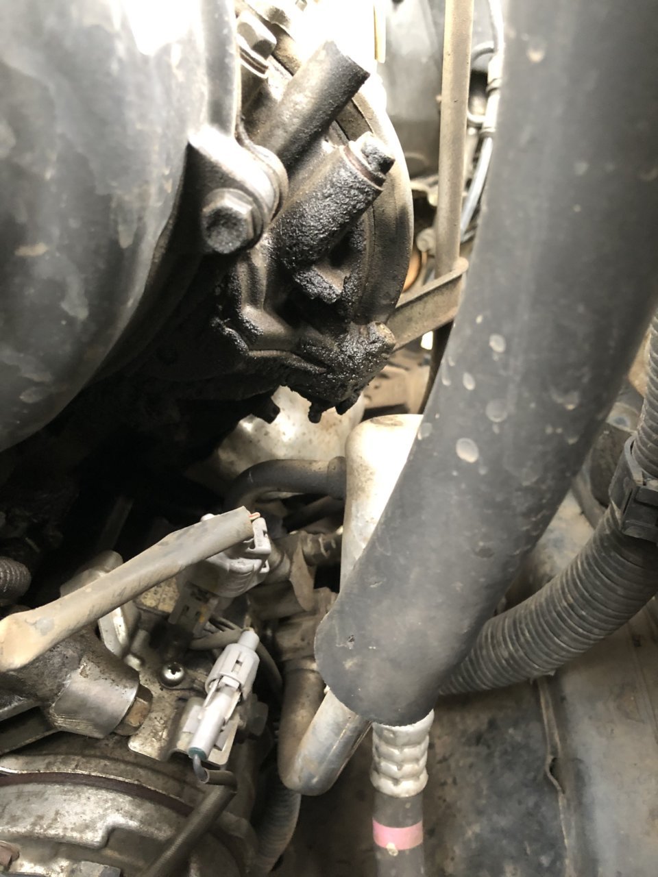

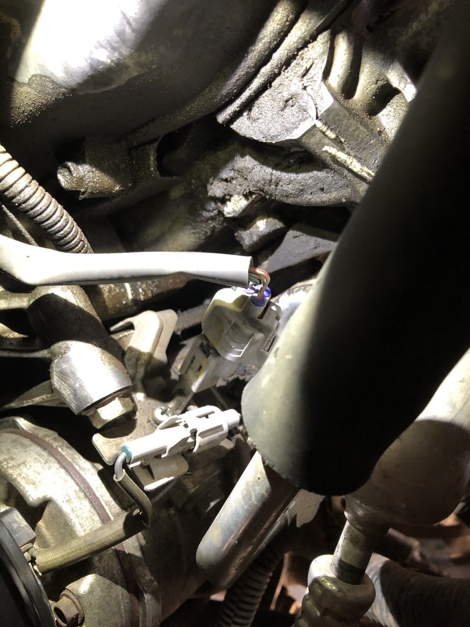

    Feeling pretty shitty right now men. Found my first leak yesterday and upon further inspection today i am not sure what it is. Left side cam seal maybe? @empty_lord thought maybe Tried torquing all valve gaskets down and various bolts nearby But finding correct specs is confusing with fsm What do the experts suggest? Could this catastrophically fail and fry the engine? FML The timing belt was replaced less than 20k ago07FB398D-56EA-4946-B917-6801D8B73754.jpg5DCEC77B-10D1-4A68-B6D0-C2FB2A27CE4F.jpg4C564FC2-1227-4AB0-8310-540D5CA88E4B.jpg

    Valve cover bolts are 53 INCH lbs, if you don't have an IN-LB torque wrench just turn them until they're snug no hulk strength needed.

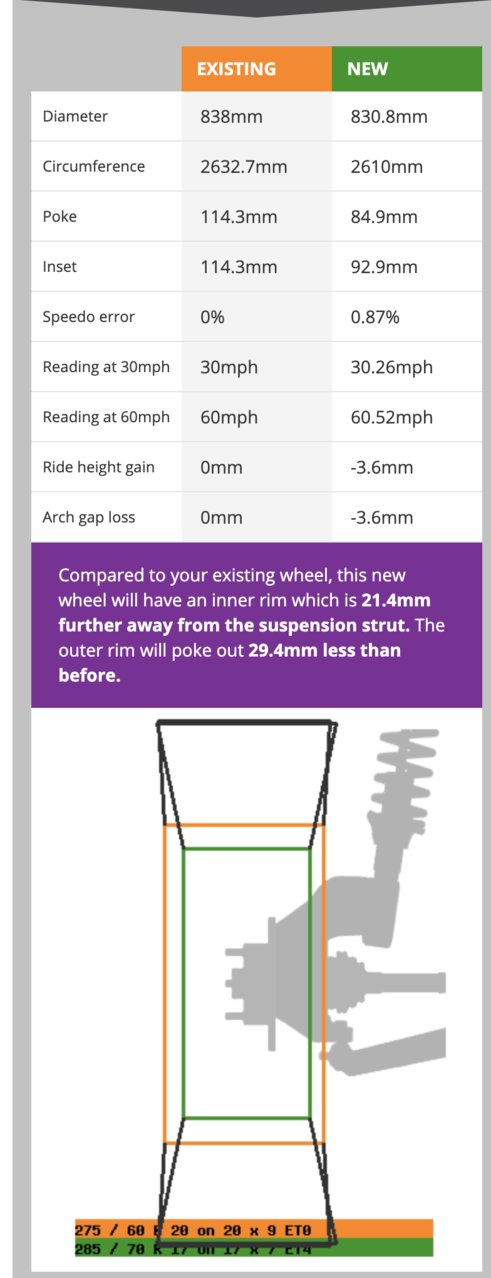

    Been there done that through all the pages. I’ll snap a few shots of comparisons to show what I mean
    here is the TRD pro and sema wheels. 17x7+4 with 285/70R17Screen Shot 2021-01-25 at 12.39.06 PM.jpg
    almost 1.2 inches tuck from my current setup. And that goes for most toyota wheels that I've looked at.

    This will not kill the engine. Just keep an eye on oil levels. Many of these trucks never have that leak fixed and still go 300k miles

    Just get the spidertrax spacers. As you've noted OEM wheels have at most 4mm offset. to get the stance you want, you've basically got Method or FCS wheels that are expensive. Depending on the OEM wheels you want, they're anywhere from $50-$300. I got 4 spoke 4runner rims with duratracs in good shape for $150. Painted em black and I like they way they look for a cheap setup (I do have the speidertrax spacers though)

    That would Chap My Ass real good knowing the TB was only changed only 20k ago. :annoyed:
    Looks like Cam Seals Leak which means a full tear back to TB Job. :annoyed:

    See, that's the problem with the cam seals... They should be done at the 2nd TB swap, but many times, myself included, those seals aren't leaking, so they don't get changed. So, when they do start weeping, you have to go back in for surgery again...
    @fighthedude sorry that you have to deal with this. The VVTi engines have to have the cams removed to install the seals. It's a good sized job.

    Yeah. Mine weren’t leaking, but thought they were but it ended up being my Oil Pump O-ring as discovered during the TB job. I had the 2 Cam Seals and 1 Crank Seal on hand and replaced them anyways even though they weren’t leaking. Glad I did based on what you are saying.

    I know parts are cheap for this but what you think labor would be for this? $1k?

    VVti would be $2k parts and labor around here. Maybe more. They wanted $3000-4200 for my Timing Belt and Alternator/Radiator/Cam-Crank Seals/Rad Hoses/Fan Clutch at two various shops (non VVti).
    Did it myself in 3 days work ($1500 in Aisin/Toy parts).

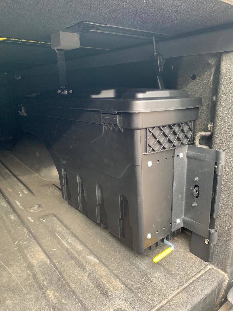

    Installed the swing case toolbox; no name brand I got for about $130. I was able to leave the tie down installed and my handle for the lid tucked in behind the box.
    Thanks for the pics earlier guys! I should have done this long ago...

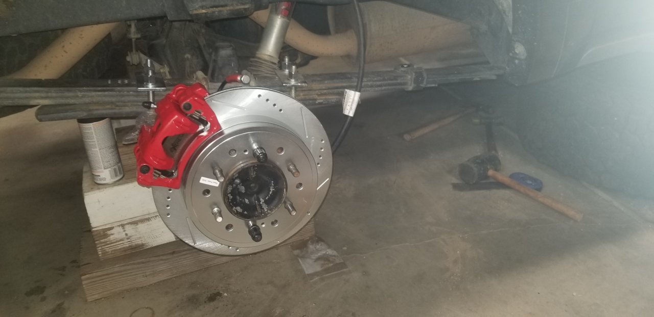

    Tonto cover

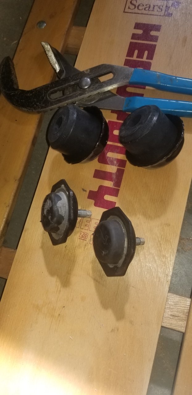

    Running into a few hiccups here and there but the truck is almost moving again. Rotors, calipers, and pads are on and the rear diff is filled. Next step is to make sure the parking brake cables will clear my tires and then I can finish hydraulics. These new parking brakes feel so much tighter at the pedal, the old cable system has definitely seen better days.
    I bought one set of Timbren ABSTOF bumpstops for the front a few months back and have really liked them, so I added a second pair upfront. The stock ones came out no problemo with the help of WD40 and my big blue oil filter wrench. Look at how much beefier they are
