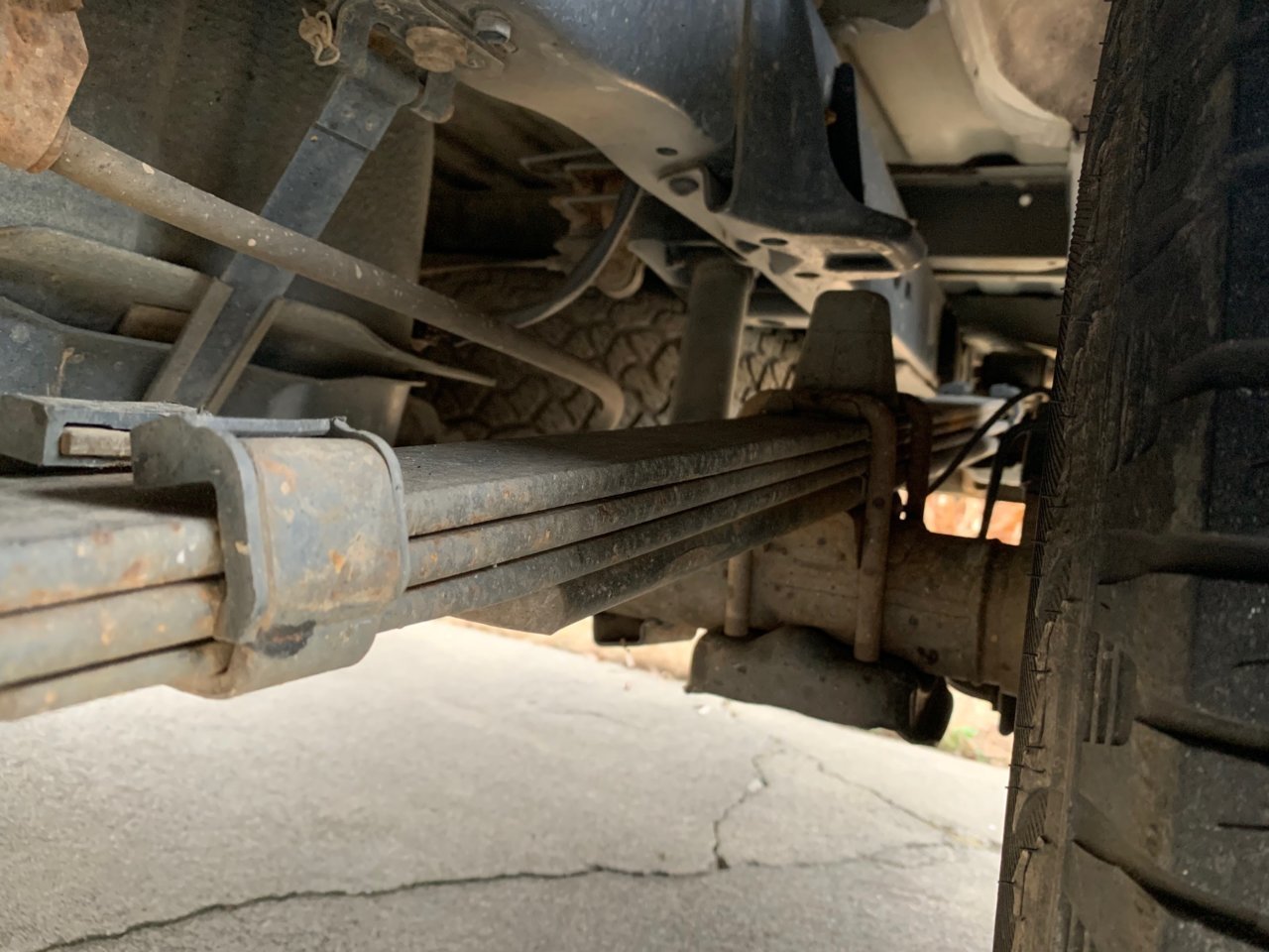

    Loaded her up with what appears to be around 1200# or so of tile and old linoleum. About an inch and a half from the bumpstops. Really need some new Leafs.
  3. Jan 10, 2021 at 7:10 AM
    Professional Hand Model
    #14878
    14,993
    Fred
    Hand Protectors
    About an inch clearance on my bumps means approx. 1200lbs. so your estimation is close. Report back on the actual.

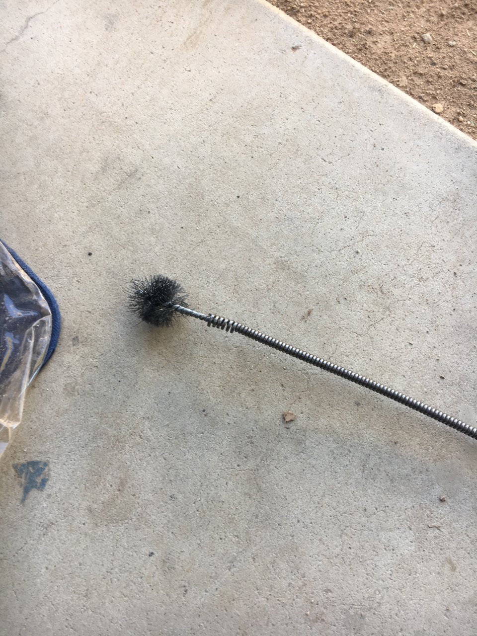

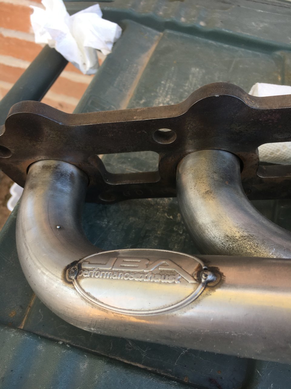

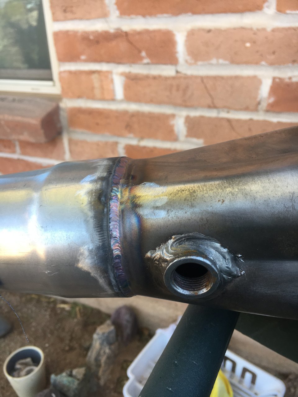

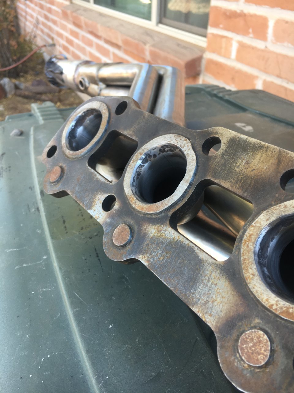

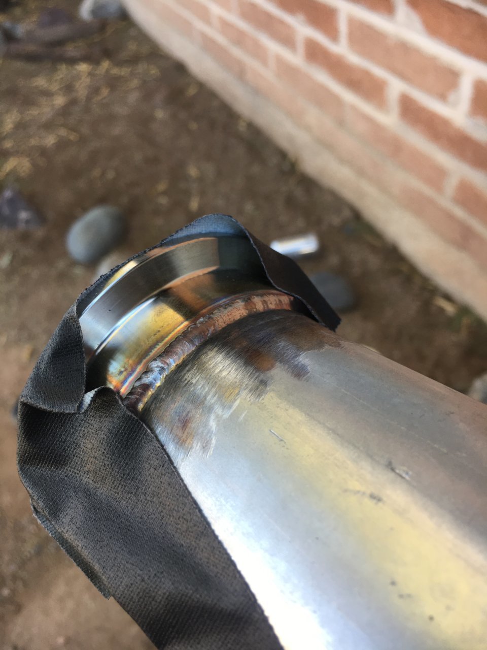

    HEADER UPDATE
    I found a local company to coat my headers; I’d rather give my money local than “THE greater PHOENIX AREA” sorry valley cats, after the gas it isn’t worth it. I had my friend weld on my reducer cones and VBand flanges from Monkey Fab Garage; super nice flanges that have a copper crush ring to seal the surfaces. Next I will order my cats and have flanges welded on those as well as the straight pipes to fill the spots of the cats; I’ve got flanges up until that point. Hoping I can not need any from there back.
    I had to put down some new puddles and grind them as flat as I could by eye. From jba the aip block off was ground down to almost nothing and I didn’t feel confident in it sealing to the head.
    There were lots of buggers and slag inside the tubes, collectors, pretty much everywhere. So I ported as best as I felt comfortable and wire brushed the insides with a fancy 3/8 snake cable and a copper cleaning brush attached to a drill! I’m a lil OCD so I tried to clean everything up as best possible before the go to ceramic coat, also these are definitely not 304 stainless, maybe 409 if I’m lucky, flanges are definitely mild steel.
    Made sure to file down all these burrs 9E6A4599-E3A4-437D-A72D-71F04DCFE7FD.jpg
    Blobs I did to seal better to the AIPs
    I may have gotten partial chub when I put an air hose down each tube and felt the pulsing suction........it’s gonna be super fun once these are installed!

    Nice attention to detail. I read a few others had to file their JBA ports like you. Didn’t realize it mattered until reading the pros discuss it. Clean work is key to success.

    Yeah I tried to “port” as best as I could without getting myself into trouble.
    One side has one connection with a weld after a 90; and I peeped my flashlight and saw a lil “hooker” I didn’t get all of it but mashed it or smeared it best I could. I know it’s not perfect but I’m sure it helped; there were lots of slag welding turds inside the tubes that I knocked of with a brass “drift”.
    My welding and grinding isn’t perfect but neither was theirs which was kinda sad.
    My welder friend was super impressed with the Vbands; I’ve never seen them/ used them, he said they are the kittens mittens.
