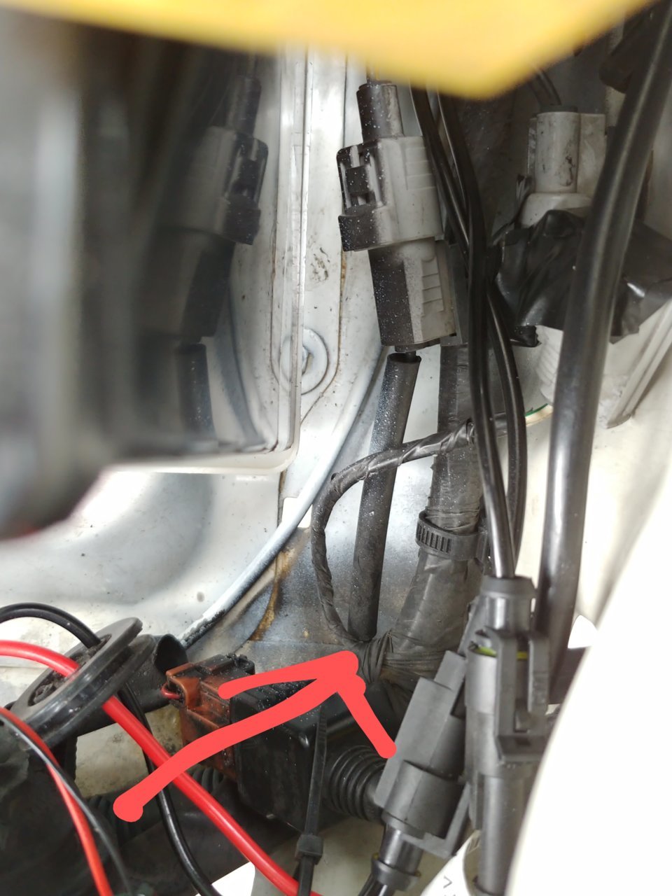

    I have no idea what that means. Remember, I don't know dick about wiring. All I'm trying to do is disconnect my trailer brake controller so I don't have power running to those wires I had to cut. I thought they were telling me to remove both wires from the positive terminal. I did that, and lost all power to the truck. I just hooked the other one back up( the one that runs to the fuse box) and I have power again. Still unclear if I successfully disabled the brake controller.

    The trailer plug, the one you had to cut off at your rear bumper. The same one that was all fubar after your last sporting event.
    Was that a 4 pin "flat" connector, or a "round" looking connector?
    I'm going to bet that since you mentioned a brake controller that you had the 5 or 7 round connector.
    Leave fuse box power on. Have a cheap multi-meter? Can test the cut wires to see if there is still power when the wifey presses the brakes. (Can Google a pin out of a 5 blade, or 7 blade connector to see which wire did what)
    On my truck, at the rear, there is a plug in the harness that runs down to my 4 pin flat connector for trailer lights only.
    In the engine bay I have the same harness as you plugged into the same connector as you show here.
    I have no idea where the rest of the trailer bull shit comes from.

    My bad. I'm with ya now. The one I removed was a round 7 pin. It ran to the flat 4 pin so all I had to do is unplug it. I'm assuming that means I could still tow with the 4 pin in a pinch.
    There were two wires that ran from the 7 pin which I had to cut.

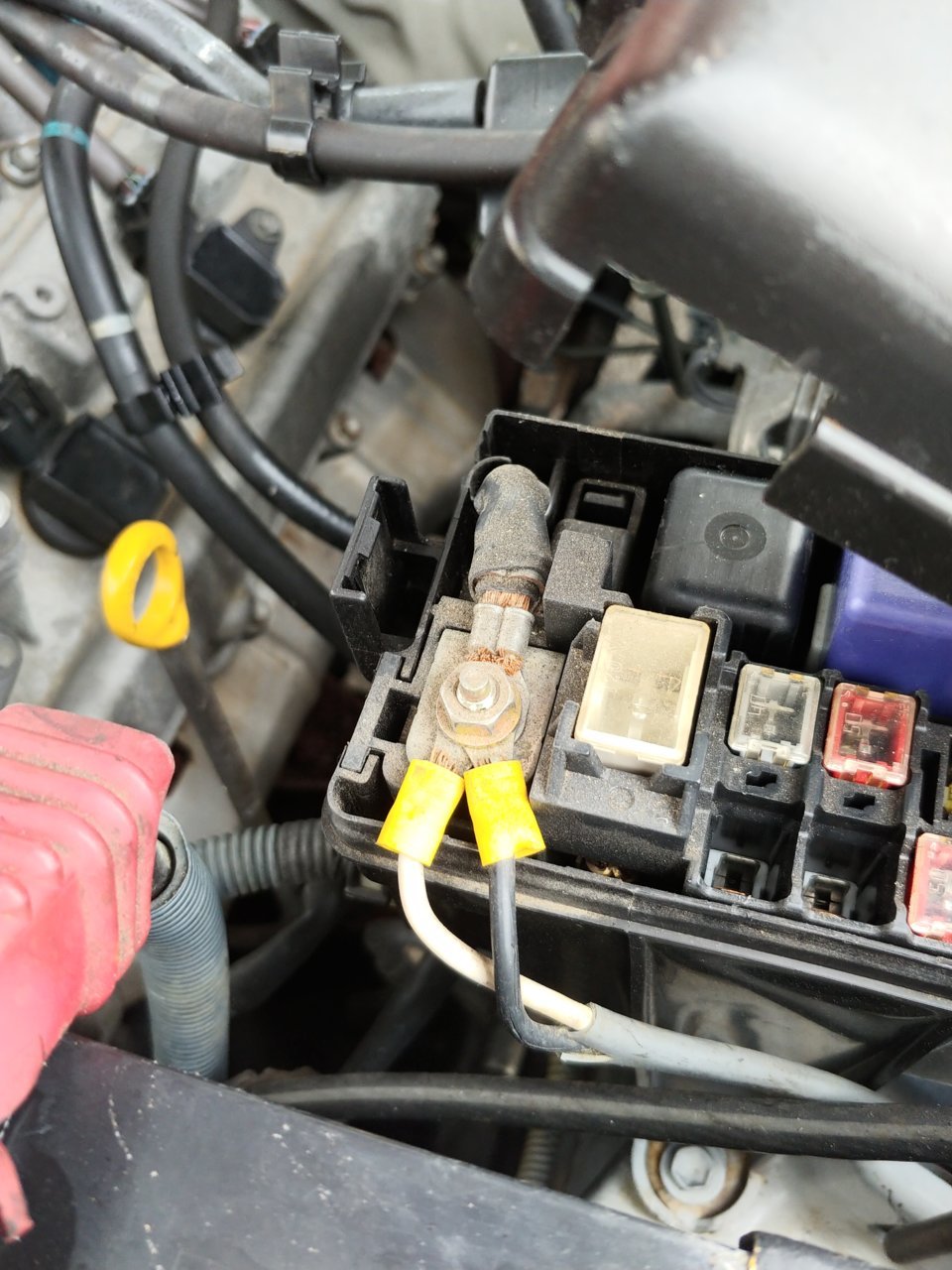

    I know you had 2 circuit breakers on your fender wall. Do both of them go to that one wire you pulled off the battery?

    I believe at one early generation point the 7 pin was not a factory option. So that may be the case here, the 4 pin is likely tied to a taillight converter hidden somewhere back there and then the brake controller wiring added to the 7 pin.

    The Brake controller isn't factory, So your factory wiring Won't be what I would think is controlling it. Those firewall mounted breakers should be connected to the battery. Trace them back to their power source and you can disconnect them there, or pull the fuse that powers them.

    No. Two run into the cab through the firewall, one runs to the back of the truck it seems. The others run to the fuse box. So now I'm
    not clear what I removed from the battery.

    I’m not sure what you removed from the battery either.
    but, if you remove those two from the fuse box, your problem should be in the clear. Follow that wire from the battery and see where it goes.

    It's the one I showed above, it says trailer light power fuse but it runs to a factory plug near the battery. I guess I'll reconnect this one and just disconnect the 2 from the fuse box.

    It ties into what looks like a main wiring harness.

    The one your holding is separate power for the trailer lights so that a short on the trailer doesn't kill your trucks lights.
