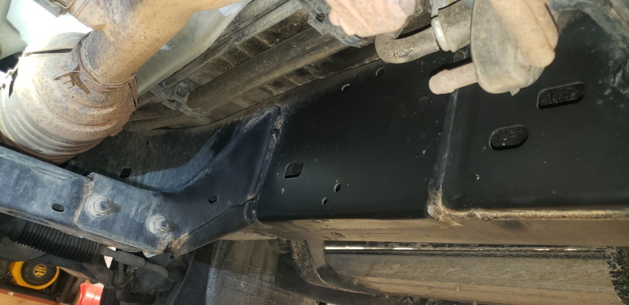

    Appreciate you guys not calling @bmf4069 on me with my FG Sequoia up in here. :spy:
    Cleaned some dirt off my frame today, happy with what I found. I was under the assumption I shared the same frame as a FGT, but mine is fully boxed. No problematic frame brace @FirstGenVol
    Pass side, trans crossmember.

    Sequoia are always welcome here. Never knew they have a boxed frame.

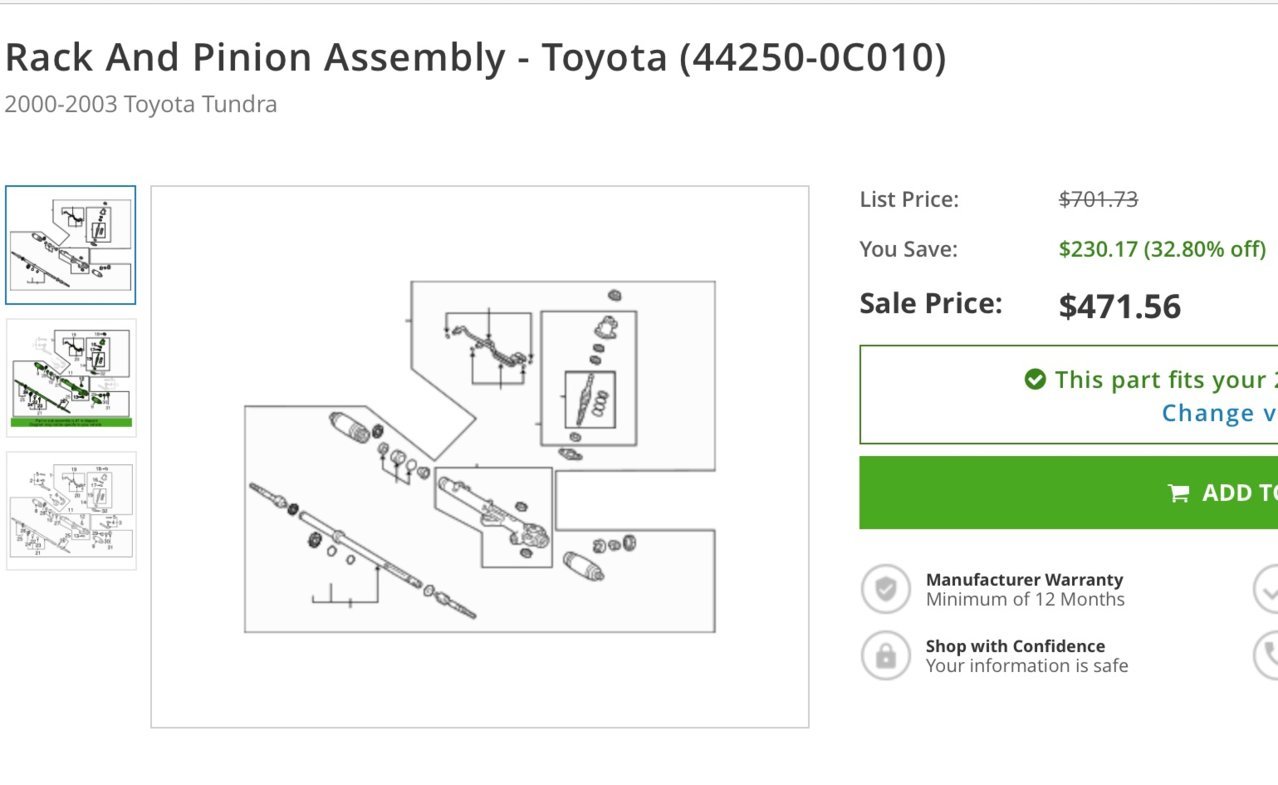

    Merry Christmas everyone!

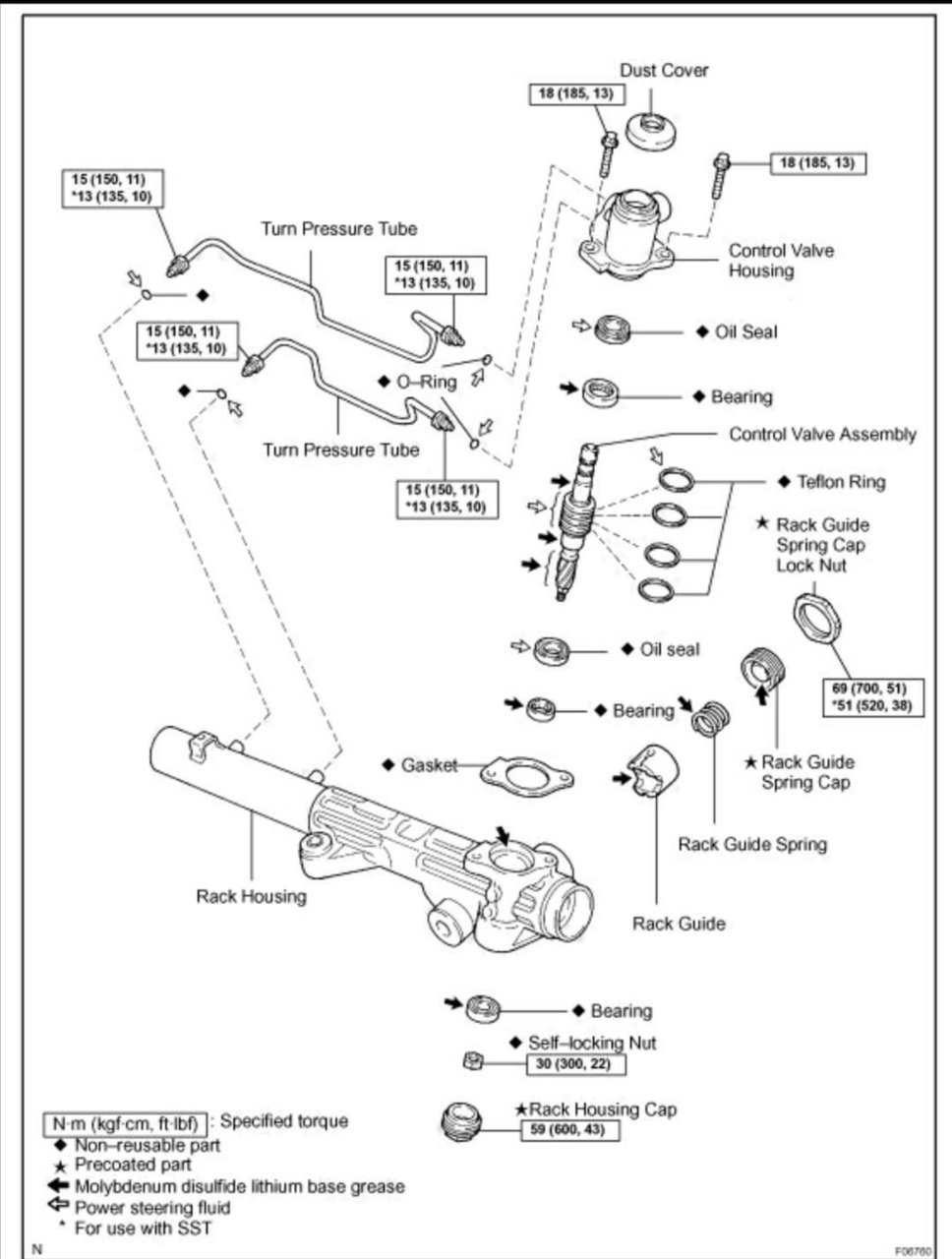

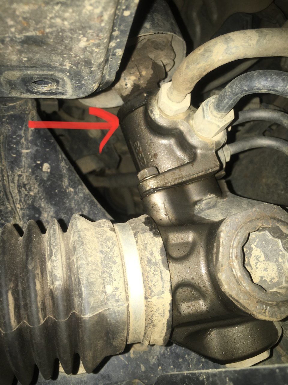

    Well after further evaluation, it’s leaking from the top seal. It was a very small seep early on but now its more than that. Haven’t lost much fluid but it’s time to do something.
    Rack is 4 years old. This is the only leak so I’m hoping I can just replace the top seal and run it for more miles....It is a remanned unit a buddy and I put in along with new LBJs and new bushings all around...That was a long day lol
    Has anyone messed with replacing the top seal?
    The perfect scenario would be replacing the top seal while the rack is still on... :monocle:
    But if no avail I’ll just resolve the rack and call it good.
    I would go OEM for $700 but a lifetime warranty unit from Napa is tempting. If I have to replace it every 4 years so be it. At least the part would be free.... anyone running a unit from NAPA?
    :spending:

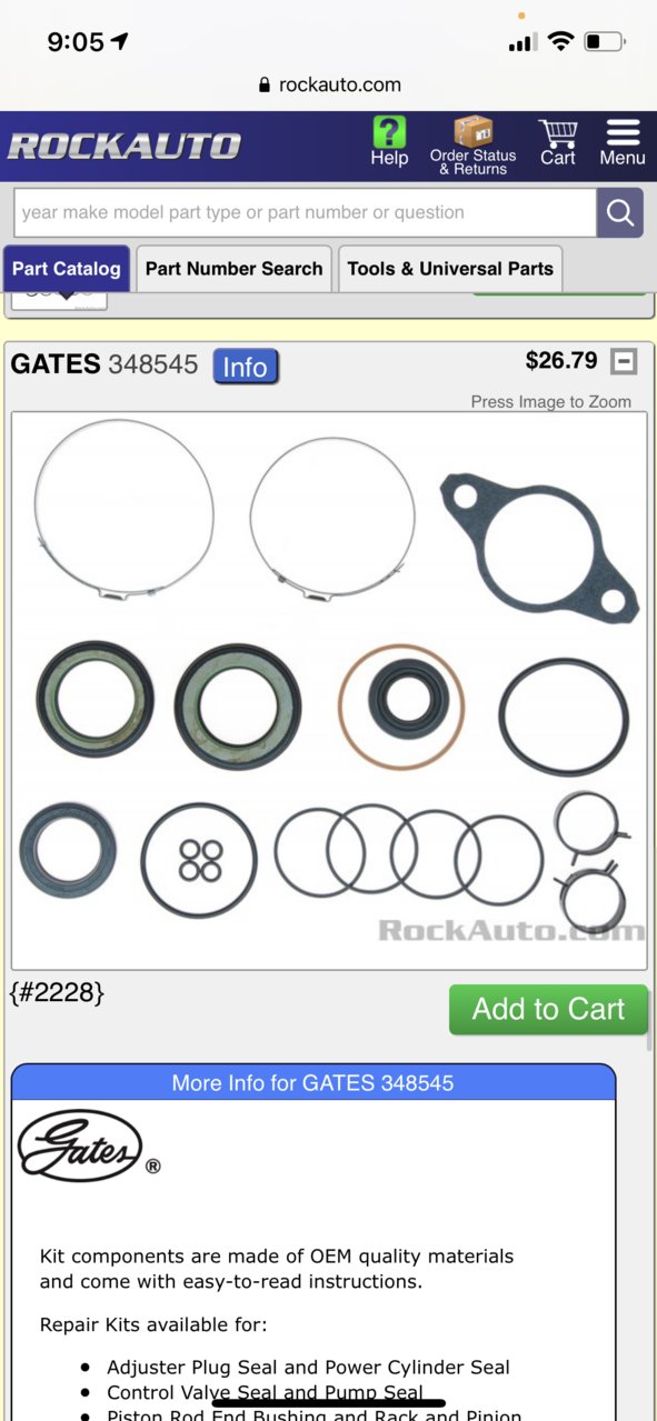

    I wish the 2006 was that cheap. :(
    Good news, found some people on the FB Group that have changed the top seal while the racks still in there. So just ordered the seal kit! Woo

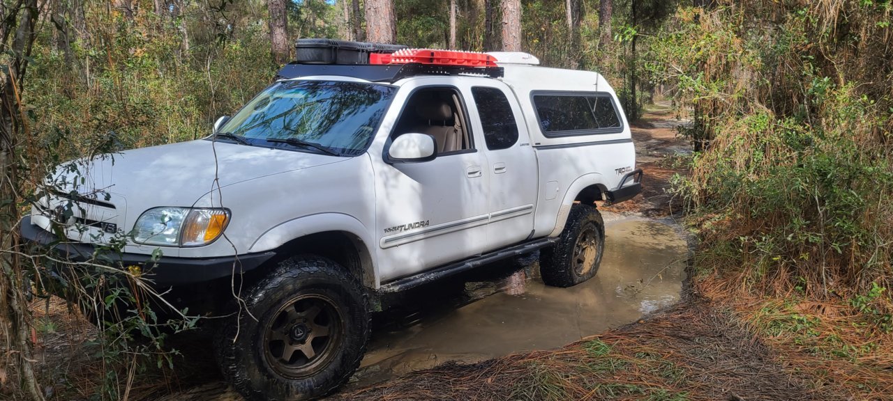

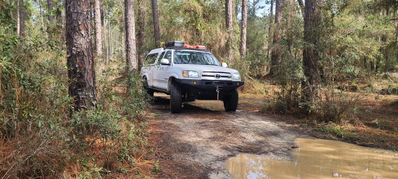

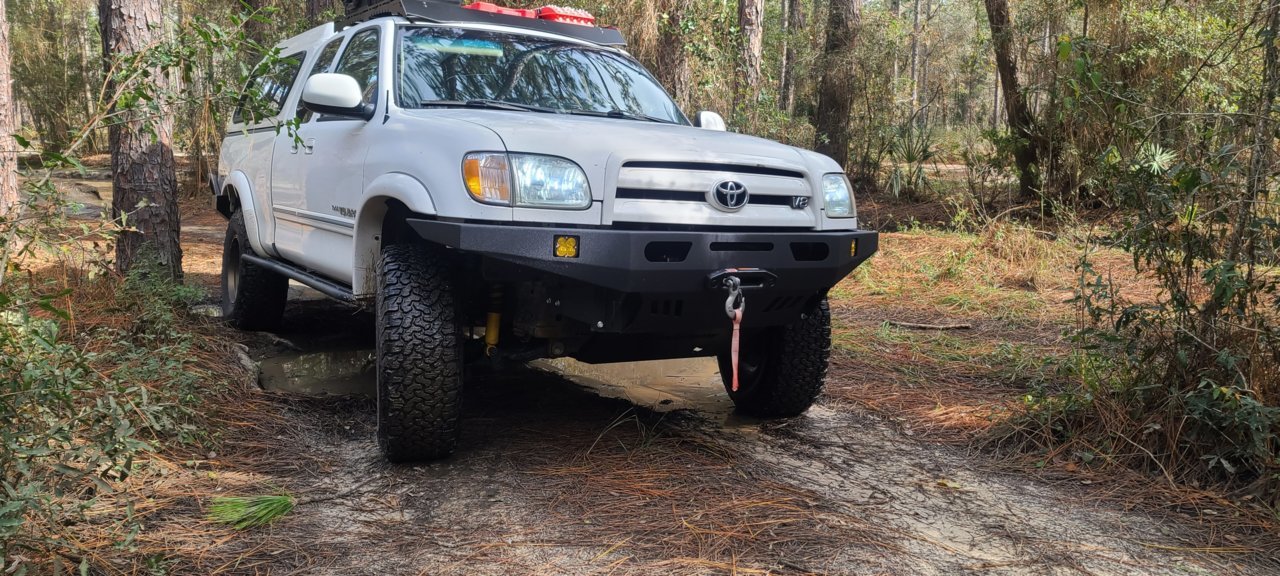

    Drove it where it was meant to be driven!
    20201226_095738.jpg 20201226_111023.jpg 20201226_110237.jpg 20201226_110242.jpg 20201226_110231.jpg 20201226_110217.jpg 20201226_111139.jpg

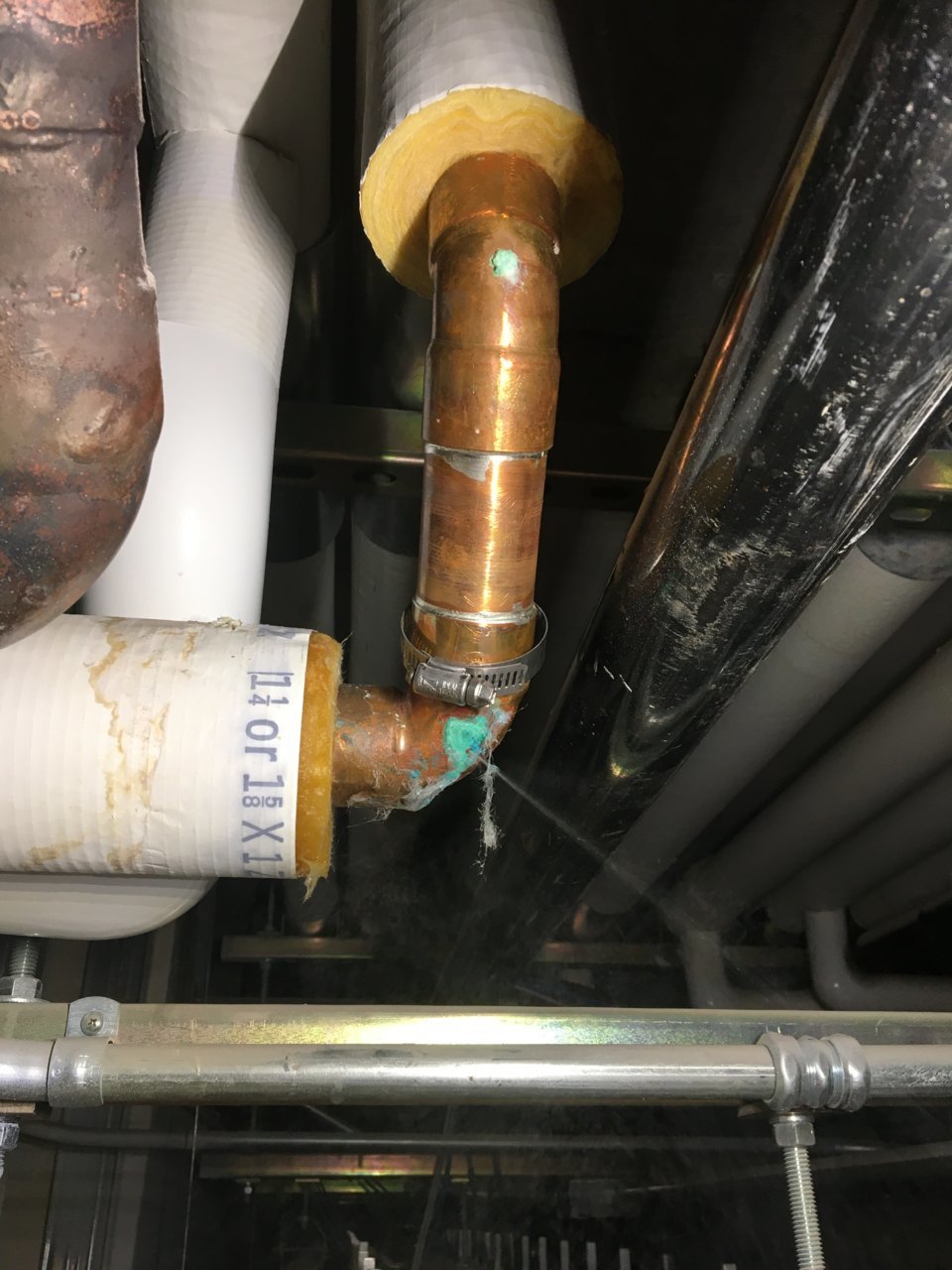

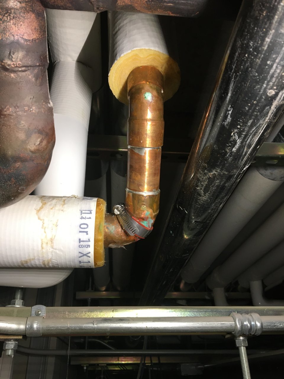

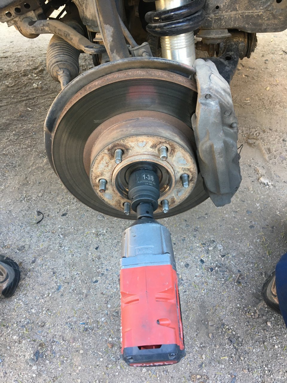

    I was literally about to bust a nut, and then I got a call; a water leak......
    And the world famous “patch”
    Notice the 45 has a cauliflower going on it........

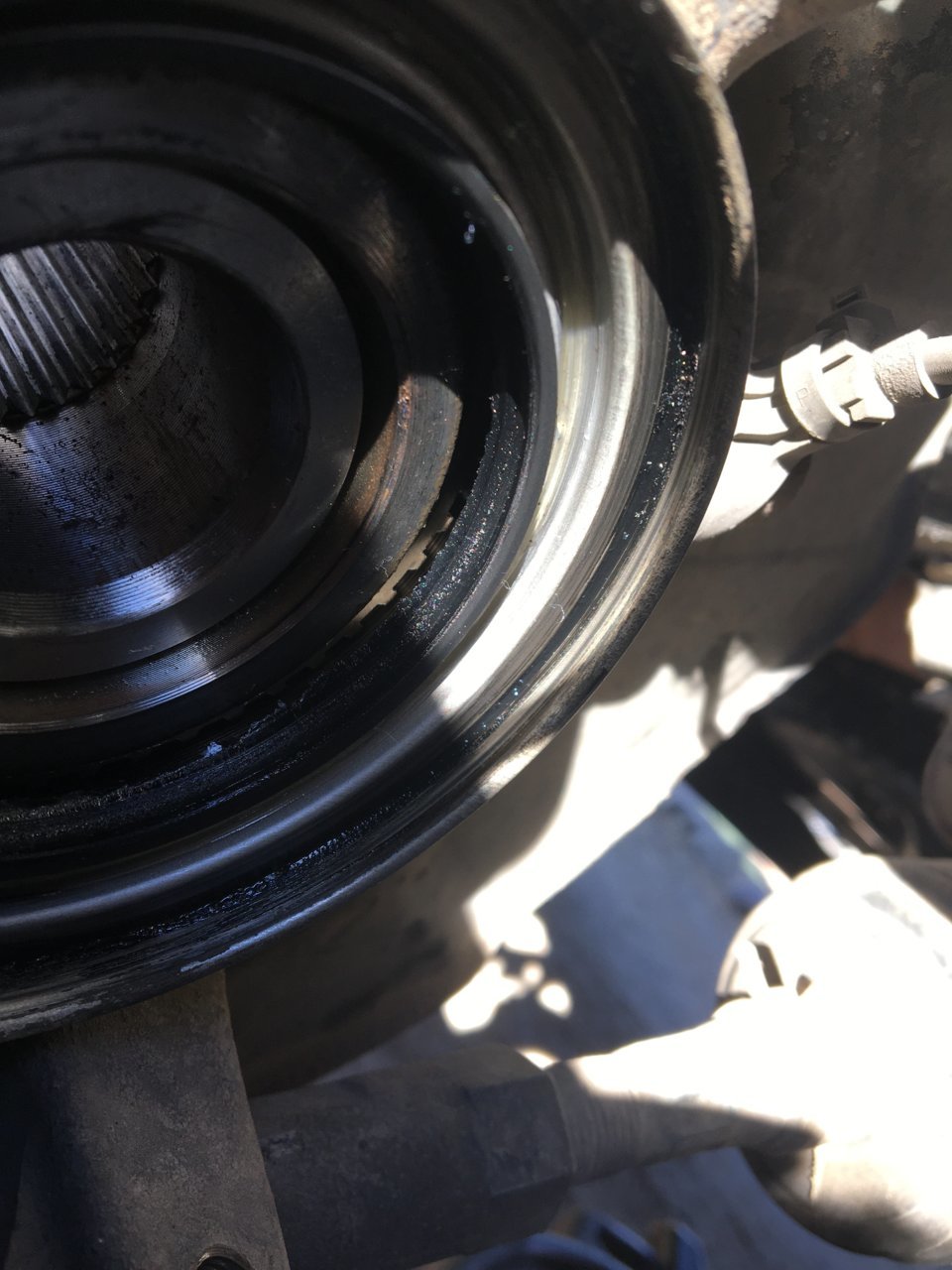

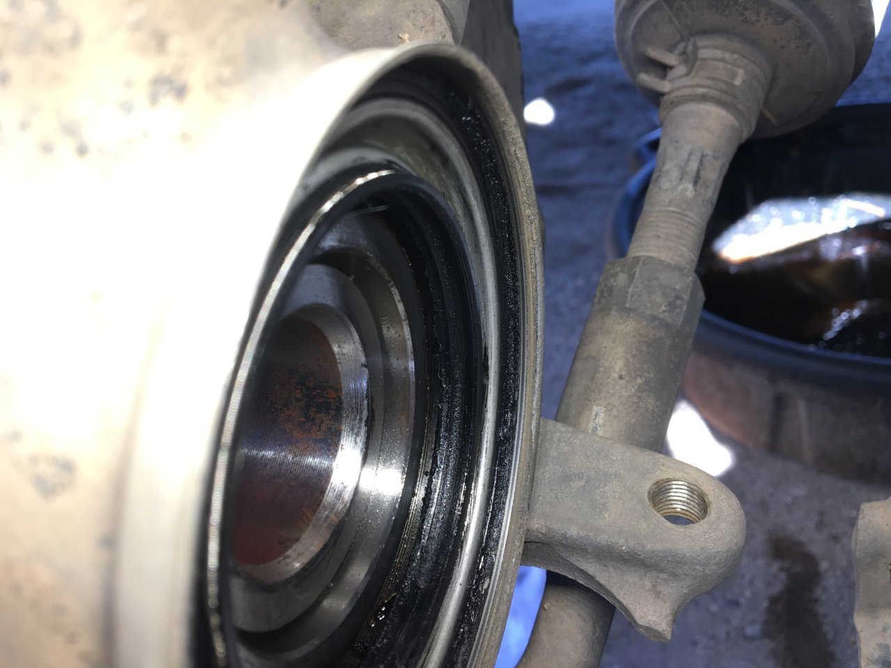

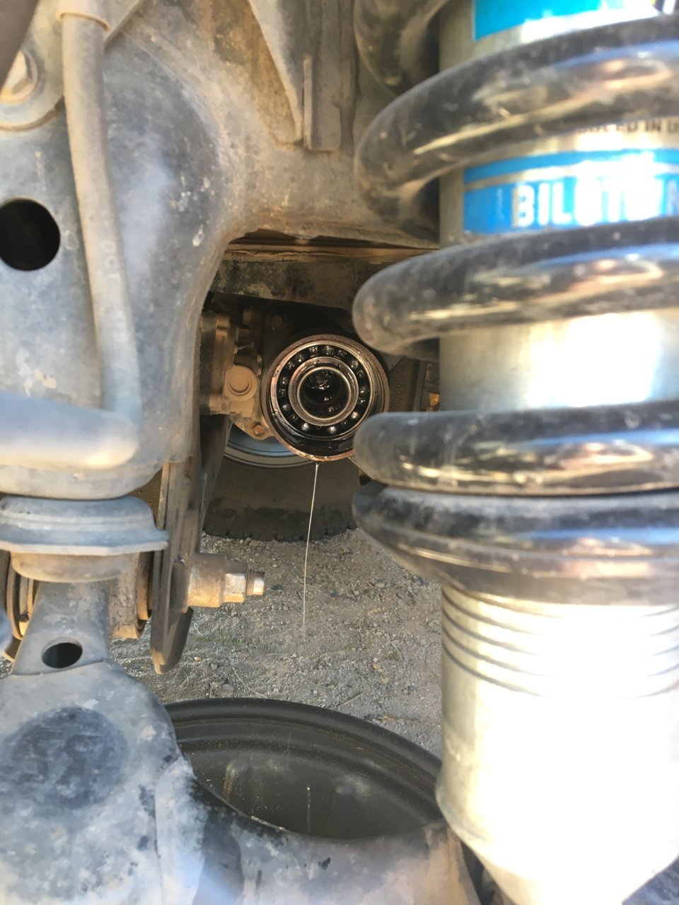

    Now back to it! I only completed one side due to having to run out for that call. But I took my time and got the passenger side axle seal damn near perfecto! I used some joe Gibbs Ass lube on the shaft seal and shaft itself. Then I started to clean the dust seal? On the knuckle, I don’t think I should be able to see the abs gears?
    See the teef towards the bottom right?
    @empty_lord should I just replace that dust cover when I do my brakes, or should I be worried about the bearing?
    tomorrow I will finish the driver side.

    If the bearings not making noise, you should be fine

    Should I not even touch that dust seal? Or try to replace just it

    They’re not hard to replace. But chances are it’s also not in dire need of replacement

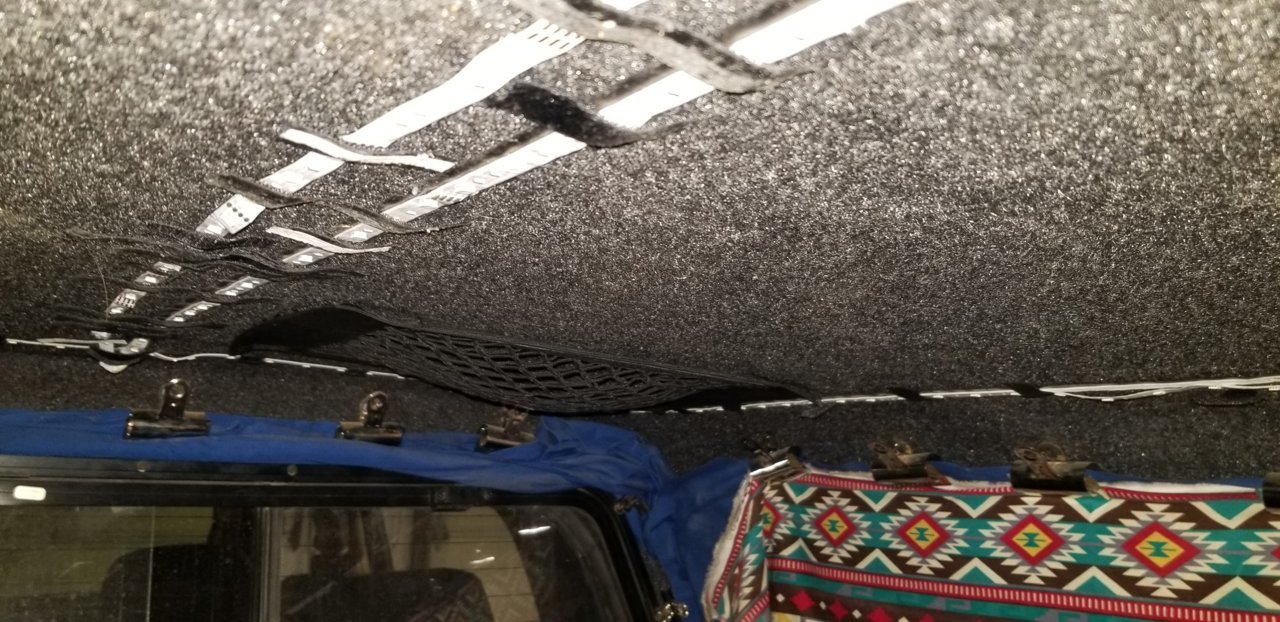

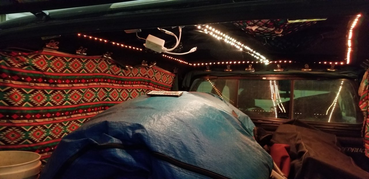

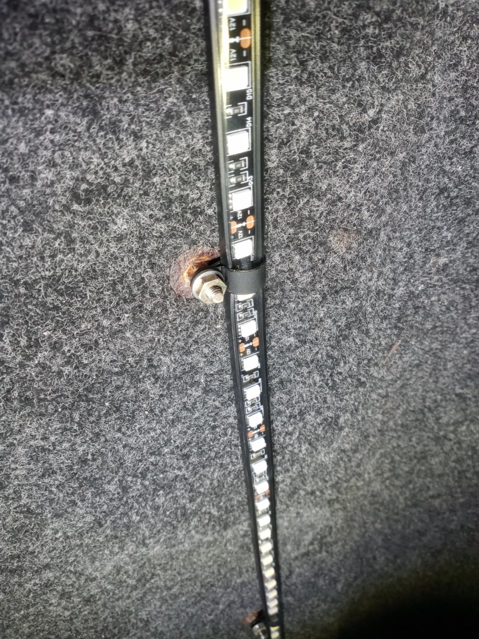

    Love to see more people building out their campers. Are you going to carpet the bed box? I used adhesive velcro on my adhesive light strips, then I cut small strips of velcro and placed them every few inches where there weren't LEDs. It's not the cleanest looking but this was the best way to get the lights to stick. It has worked extremely well.
    Bed box when I first started:
    Now:

    I used P-Clamps for my light's. I push the button and they come on. I will carpet the bed box. And add a foam pad soon. Ill be adding usb charging, volt meter soon, also a small solar panel on the roof of the camper to keep a second battery charged later on down the road.

    Definitely look forward to seeing how that turns out. Those P-Clamps are definitely cleaner! I'd have to poke holes in my shell for anything else other than velcro. I use a 100W folding panel for charging when I'm parked and move it around as needed for max sun, but a fixed one would definitely be convenient. IMO, our alternators provide more steady juice than a solar panel would while the truck is running/ moving.

    The only reason I have the holes poked through my shell is the roof rack.

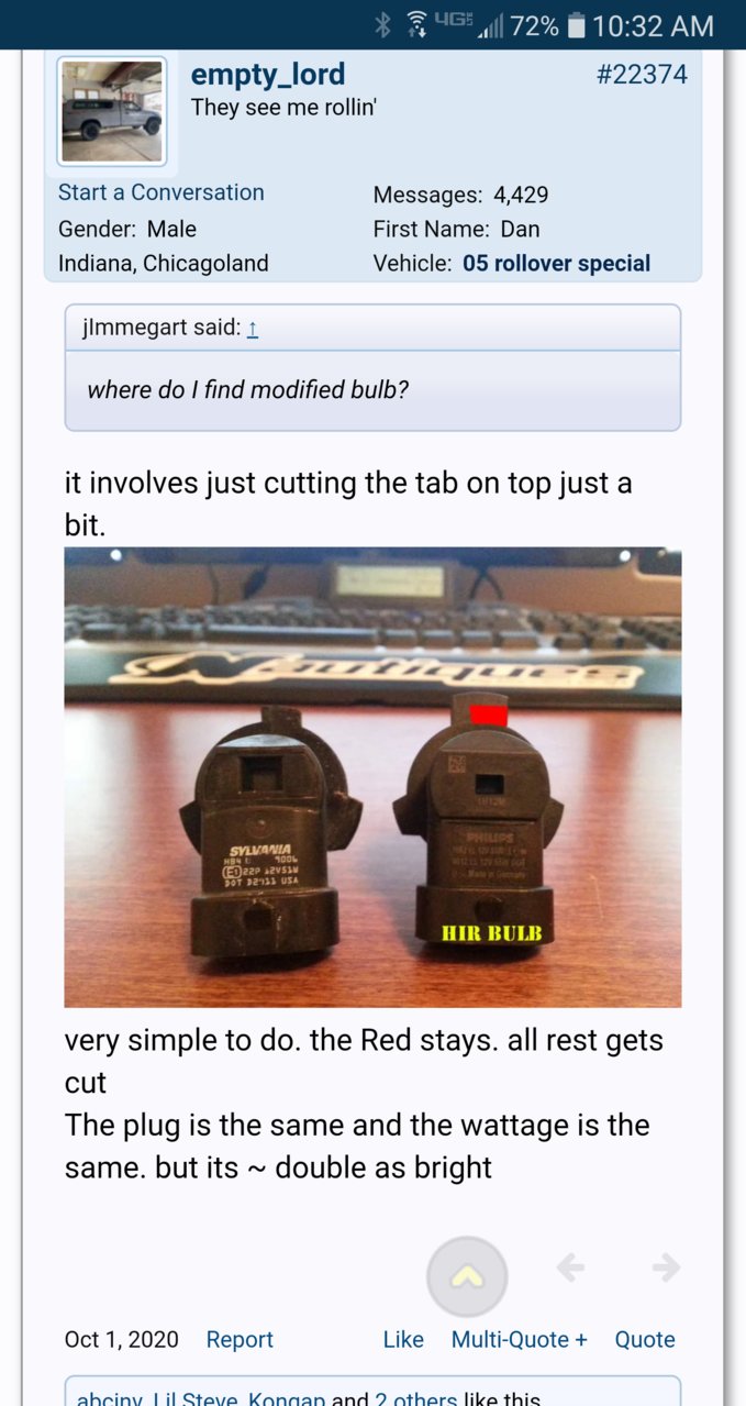

    Just had my driver side headlight low beam burn out...stupid. Did I read we could put better headlights in that just needed a tab modified? Wondering if that was for something different than a 1st gen.
  22. Dec 27, 2020 at 8:13 AM
    FirstGenVol
    Dec 13, 2018
    #22934
    14,347
    East TN
    2002 AC TRD 4x4 V8
    No that was here. I took a few screenshots of that. @empty_lord wrote about it. It was back on 10/1 if you search.
    NUDRAT and CodyP[QUOTED] like this.
  23. Dec 27, 2020 at 8:33 AM
    CodyP
    CodyP Such a n00b
    Oct 27, 2018
    #21047
    3,153
    Cody
    CDA, ID
    2006 Tundra 4x4 DC
    Weird, I don’t think my bulbs look like that though.
    I have 9003 or H4 bulbs that just come straight out the back and don’t 90degree angle
  24. Dec 27, 2020 at 8:47 AM
    Tundra2
    Tundra2 Zoinked
    Feb 10, 2019
    #25875
    12,456
    Noah
    Western Kentucky
    Those are fog light bulbs in the picture...
