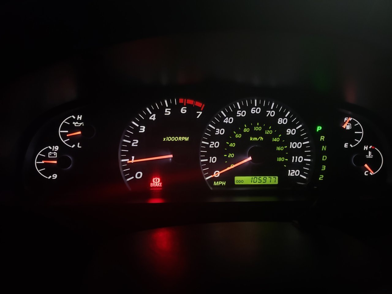

    Do you have to remove the needles just to remove the green film? I just want the stock white leds to shine white through the cluster.

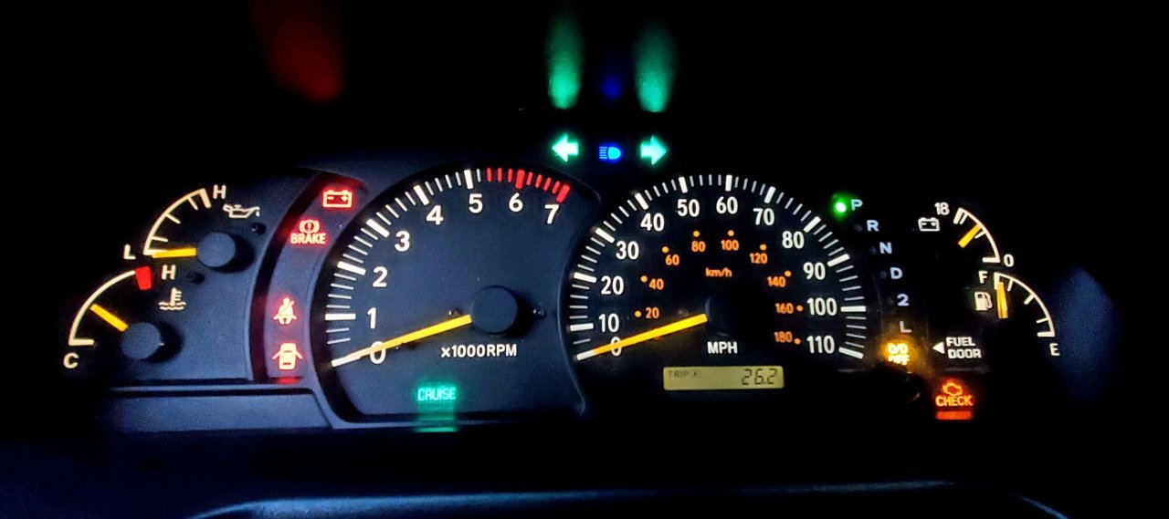

    I can't remember if it was 04' or 05' when they changed the cluster from this
    If your cluster looks like the picture above you should be able to change the bulbs to LED.
    If your cluster looks like @Thrussn's you'll have to take the needles out, and wet sand the filter.

    Mine looks like the one on the bottom, so if I remove the needles how do I do that and also properly put them back in the right position? Thanks

    Pretty sure cluster changed in '05 with the change to five-speed transmission.

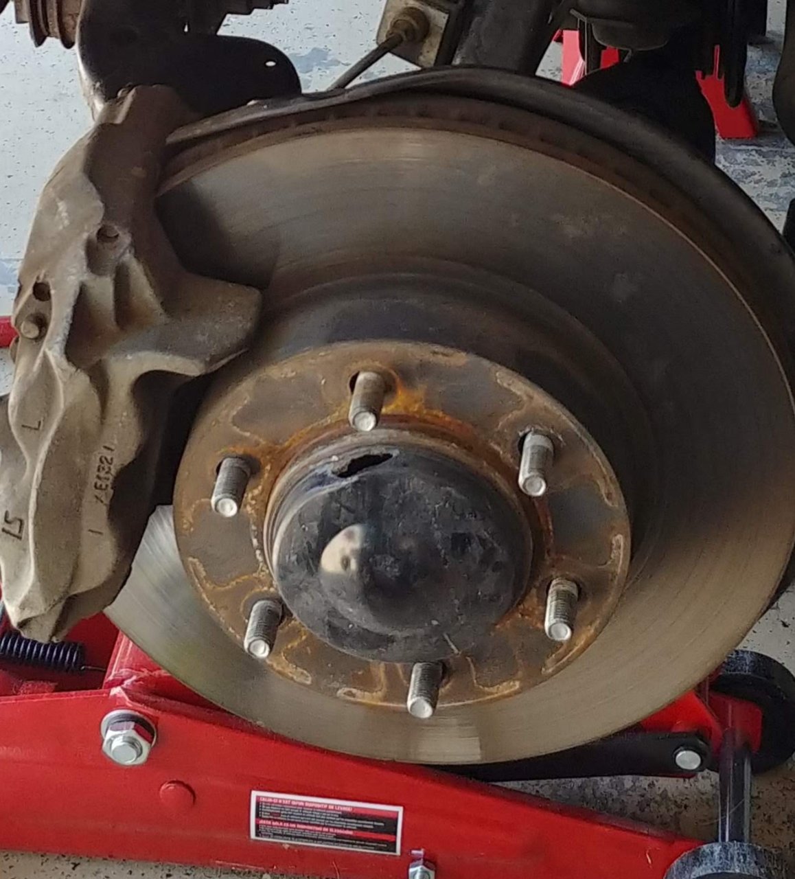

    anyone have the part number for the front cv axle dust covers? I'm confused when I look at the part diagram and don't see it listed on sparksparts

    these “bad boys”?

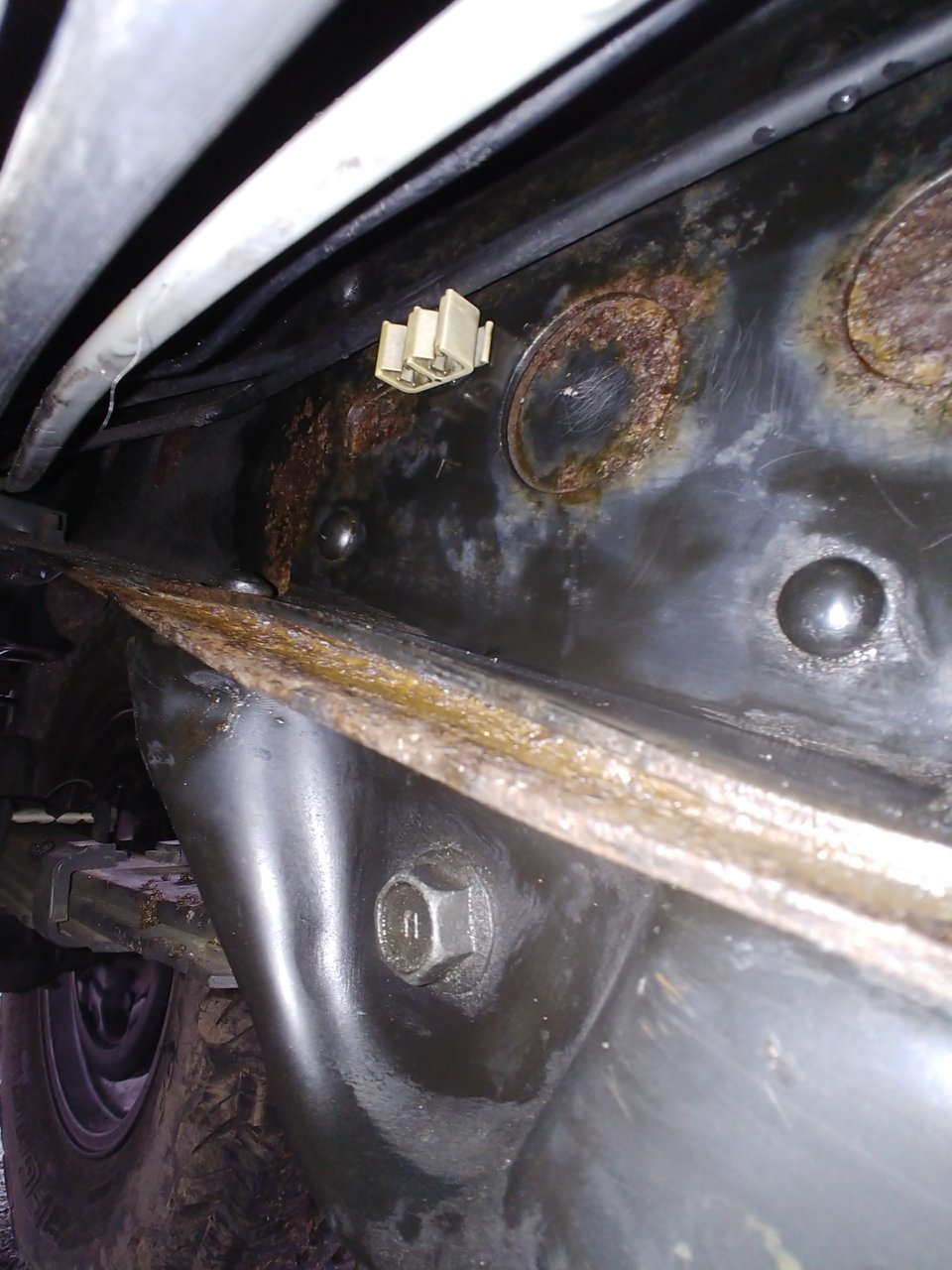

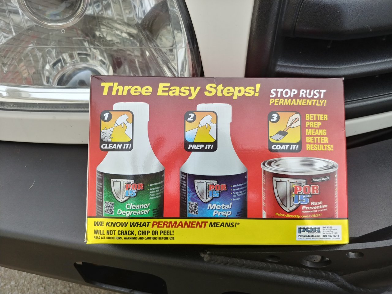

    Yesterday I bought this kit and spent a few hours prepping the frame.

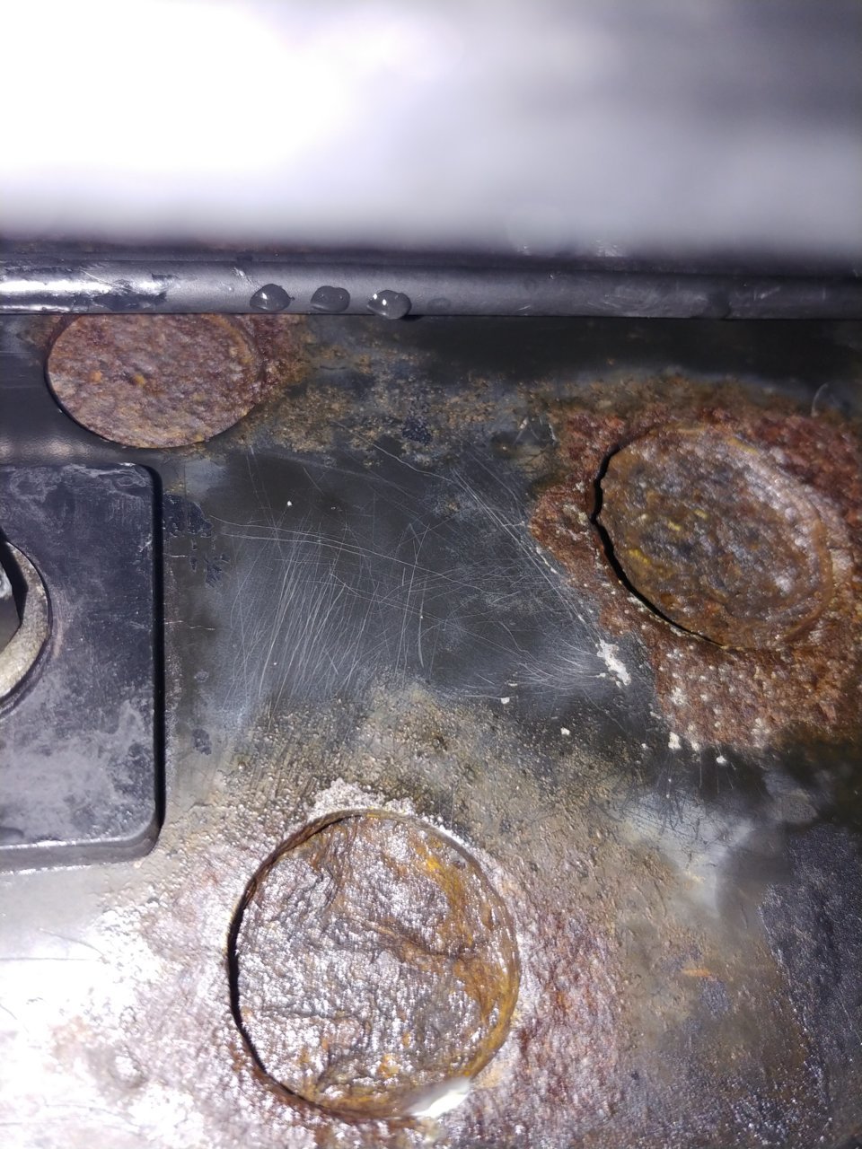

    98% of my frame looks like this:
    So its really frustrating that the area where it overlaps is such a death zone. It traps moisture and dirt. After cleaning off the old grease and fluid film it looks like this. Can't decide how bad it is but I know it's not good.
    It's delaminated here.
    Once the temp improves and the humidity drops I'm going to paint that area with the POR-15. After that dries I'm going to squirt as much PB blast into the cracks in hopes that it will drain down into the area where the frame overlaps.
    Keep an eye on this area guys as it will breed death. It's crazy that the rest of my frame still looks new.

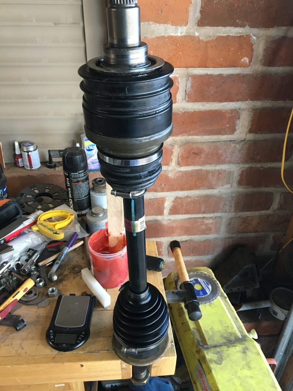

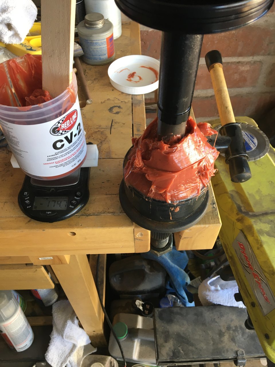

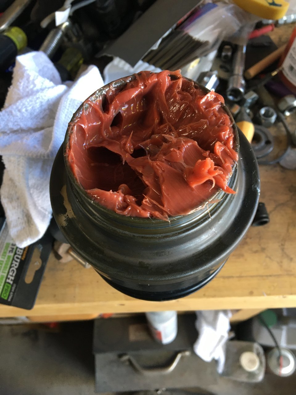

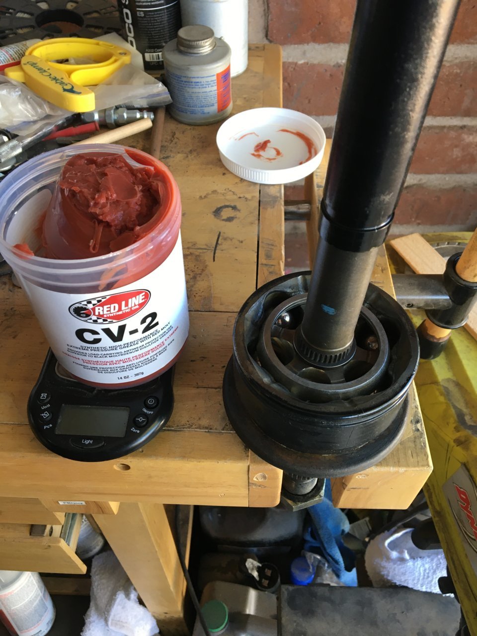

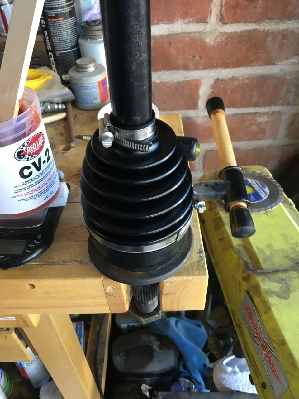

    reboot wasn’t to bad, just like baking a cake! I used my coffee scale to weigh out 230-250 grams of grease per boot. Jammed all the grease I could into the joints but it was colder out so it didn’t flow that great. I used smooth band worm drive bands from McMasters, used a 7mm hex head. I offset/ clocked all the hex heads for weight balance reasons, I will probably clip off the tail ends of the clamps or fold and tuck. All and all it was a 6 rag, 2 beer(I ran out of mine, so I was drinking hers; Papago orange blossom) job that wasn’t to bad!

    Just make sure you didn’t over-tighten the clamps. Then you’ll end up with u even pressure all round

    The oem boot kit came with work clamps? I gonna look at mine and see what it came with.

    Those come with the stock style clamps that use otiker pliers or a screw driver (forget what style the tundra has)

    No I got those and the diff oil seals. I thought that was a dust cover at the end of the axle but maybe I don’t even need to take those off when I rebuild.

    It didn’t not come with worm clamps, I got them seperate from McMasters Recommended from a local member

    Yes you'll have to remove that cover to get to the axle nut. I think it's part # 43514-28010
    This is what you're talking about right? I replaced this damaged one.

    @CodyP I just realized Frenchie already asked you about those. I assume you're asking about the other side. I didn't replace those. I just cleaned them up.
