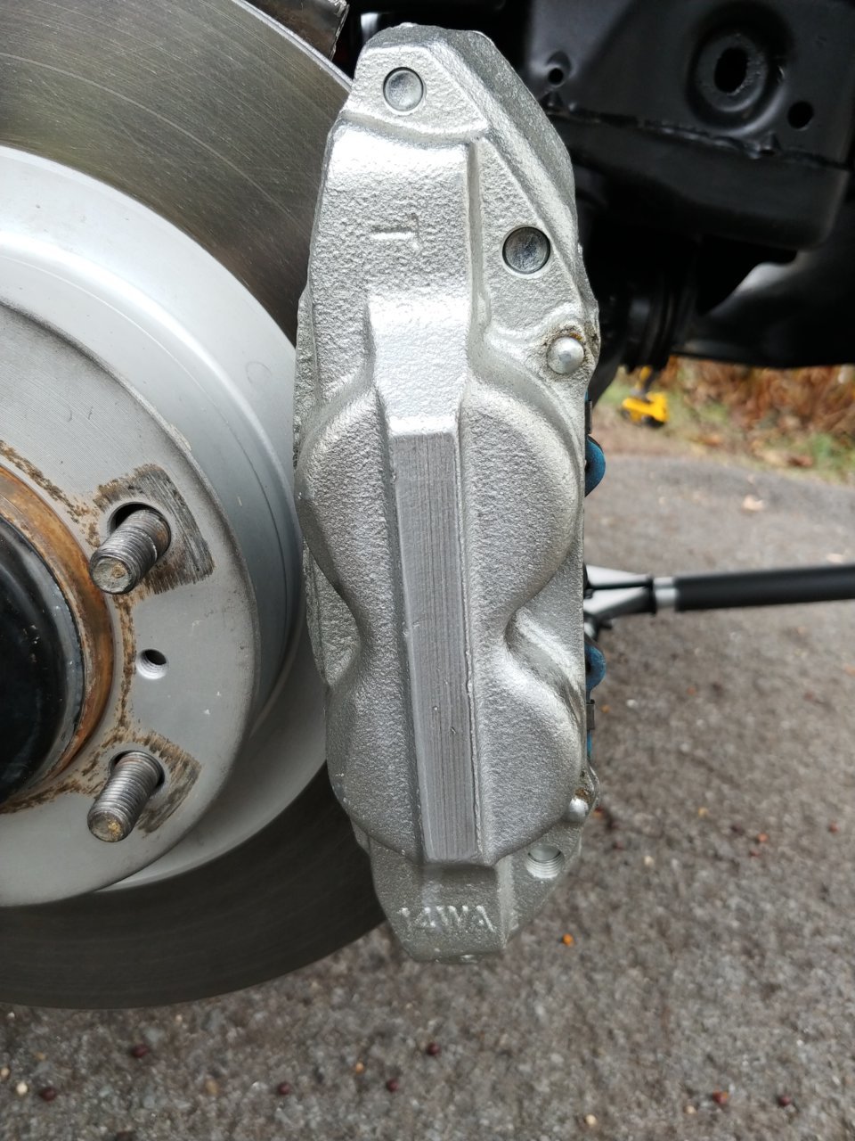

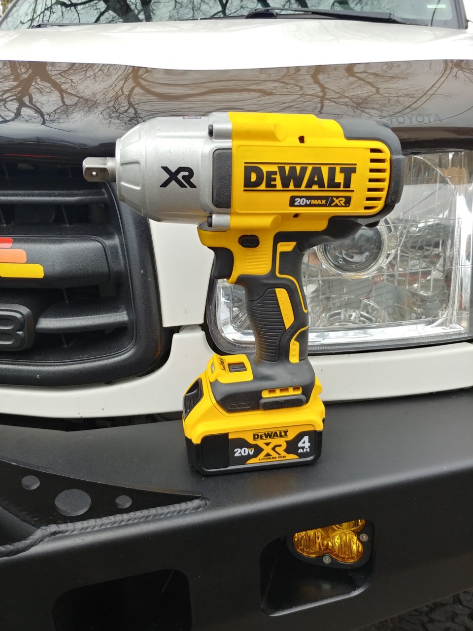

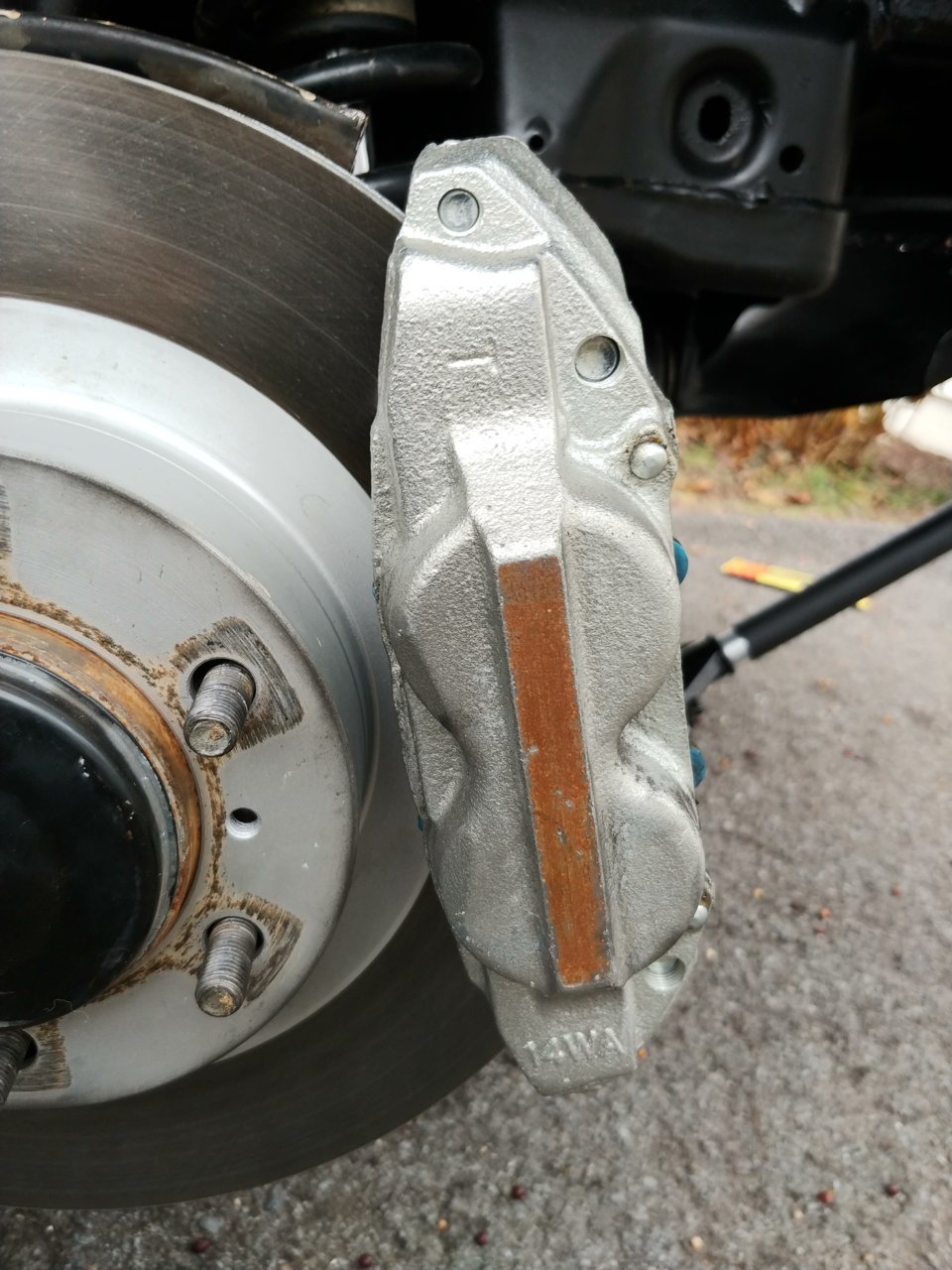

    Today's mission. Gomer had removed some of the finish on my calipers when he clamped them down to mill the ears.
    Sanded the rust off and sprayed them with high heat caliper paint.
    I love having an excuse to bust out Big Donnie.

    I like the TRIPPLE stripe on the grill, it goes good with the white, I don’t know if it would look good on phantom gray.

    Its incredible how quickly calipers rust isn't it? Mine were totally brown in a month, in California.

    Shoulda painted yours black before installing. My brakes are faster than yours. :rofl:

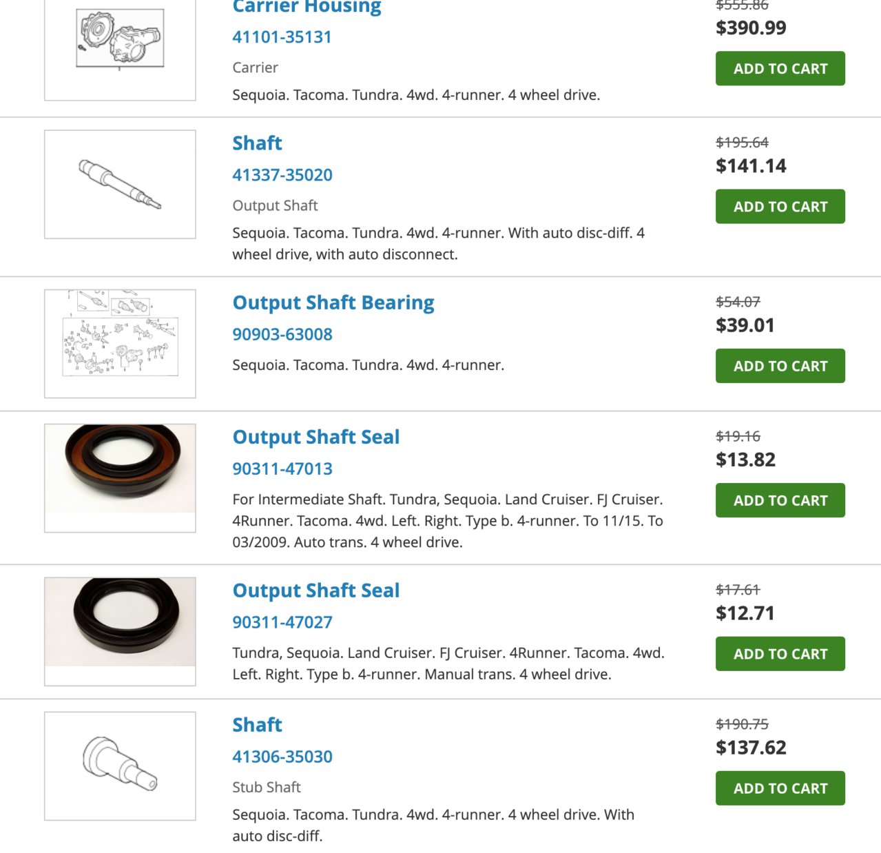

    Got it. Thanks guys. It goes away after being warm and it has new 02 sensors a year or two back as well. Wasn't sure if I was having a fuel injector issue or not.
    @empty_lord
    Heading out to my garage to the passenger CV axle since the diff seal is leaking. I think I may be confused as I bought two different seals.
    90311-47027 I think this is for a manual trans 4x4
    90311-47013 I think this one is for the auto trans 4x4 correct?
    So I shouldn't have bought one of each but instead bought 2- 47013 right?
    Obviously I have an auto

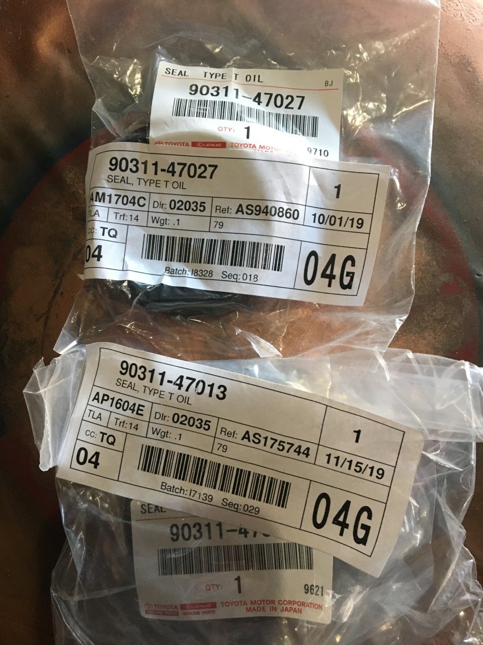

    @CodyP
    These are what I have, you should have gotten two different seals/pns image.jpg

    Ok. I’m assuming driver side will be smaller then.
  21. Dec 12, 2020 at 1:52 PM
    FrenchToasty
    Sep 15, 2019
    #36156
    18,609
    Mo
    The SoAz….. big surprise
    Bone stock
    I think so

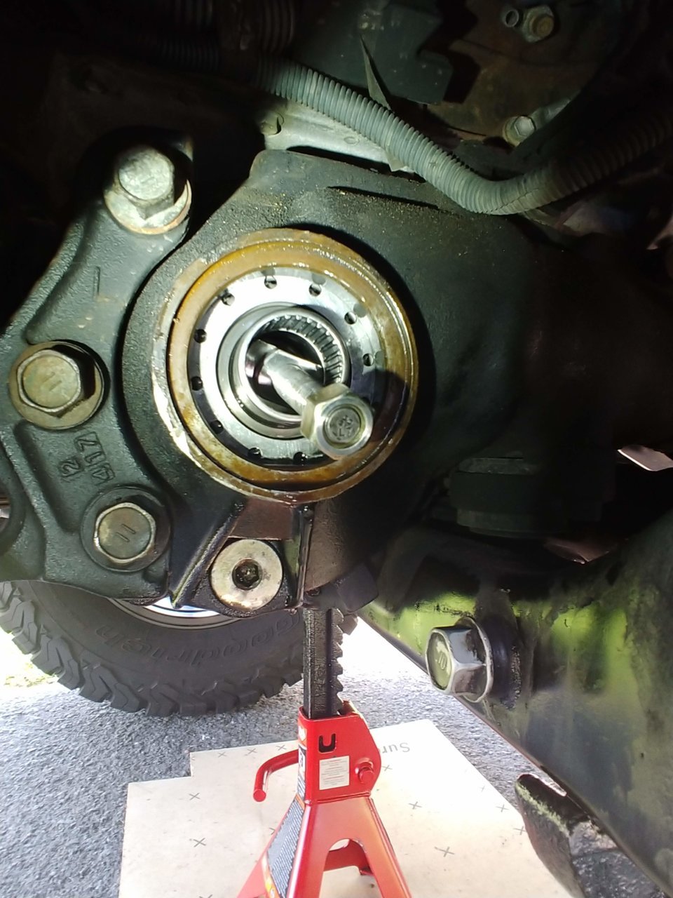

    Be careful. There is a certain depth you have to drive the new seal in. You'll know which side I'm talking about. The other side is easy.
    Edit- found some pics from May. It's the passenger side that can be driven too far. Here is the driver side after I removed the seal and started removing the needle bearing.

    I know, I regret it. When I ordered they said they were painted but whatever coating they had didn't last at all. They were silver for about a week.

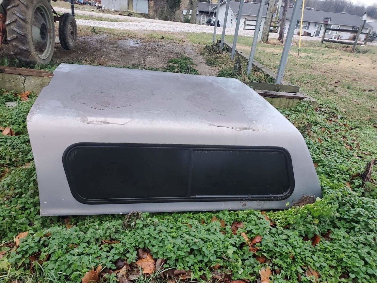

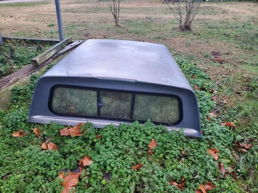

    Pops caught wind of an 01 camper shell for free.99 that one of his old coworkers has.
    Going to look at it tomorrow. He swears its a color match, but it looks like thunder grey metallic to me.
    If the dimensions are the same as my color matched shell I could swap over all my hardware, and glass.
    Worst case scenario I pay for a color match paint job from a local shop that dies excellent work.

    You lost me. You already have camper shell?
    Tundra2[QUOTED] and FrenchToasty like this.
  27. Dec 12, 2020 at 3:25 PM
    Tundra2
    Tundra2 Zoinked
    Feb 10, 2019
    #25875
    12,456
    Noah
    Western Kentucky
    Yes. Rear glass/harware is gone, and a replacement piece with no guarantee that it will fit is $1,200.
    Astro camper shells were absorbed by somebody else. Plus I don't have the pics, or the measurements for the glass anymore.

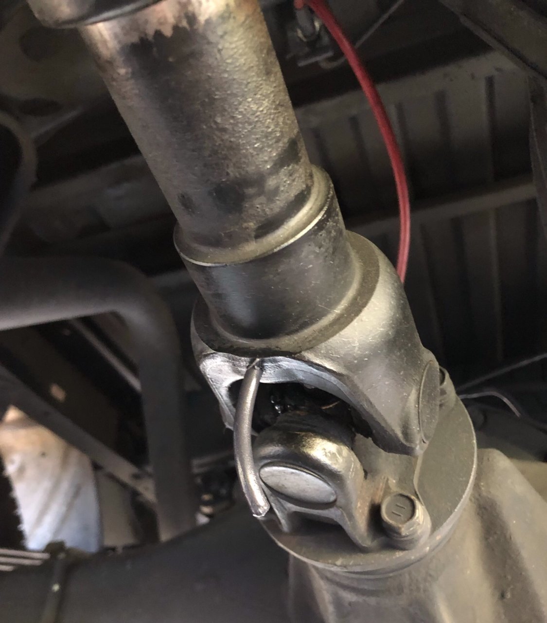

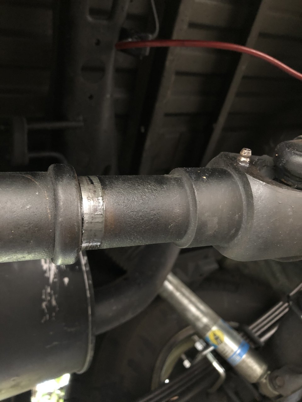

    Circled back to the Rear Shaft Slip Yoke/Zerk and noticed the same amount of movement as always after doing the zerk remove and jump the pressure out method for the first time. I’ll dispel that method as not applicable in my case. It may work for others with pressure problems.
    Went ahead and knocked some pitting off the shaft today with some emory cloth and brushed some left over grease from my brothers toothbrush. Yoke is smoov now and the grease will take a few days to settle in.

    Yes, the two seals appear to be different sizes so the 47013 fit the passenger side. I drove it in as much as I dared which was just a pinch outside of the old one so hopefully it's good. I did have an issue with CV axles though. Was given an old stock that a friend had that he never used new one (part #A) and then took that part number to Napa (part #B) and had them order me a new one but they were different...here were my concerns if anyone cares to poke at them:
