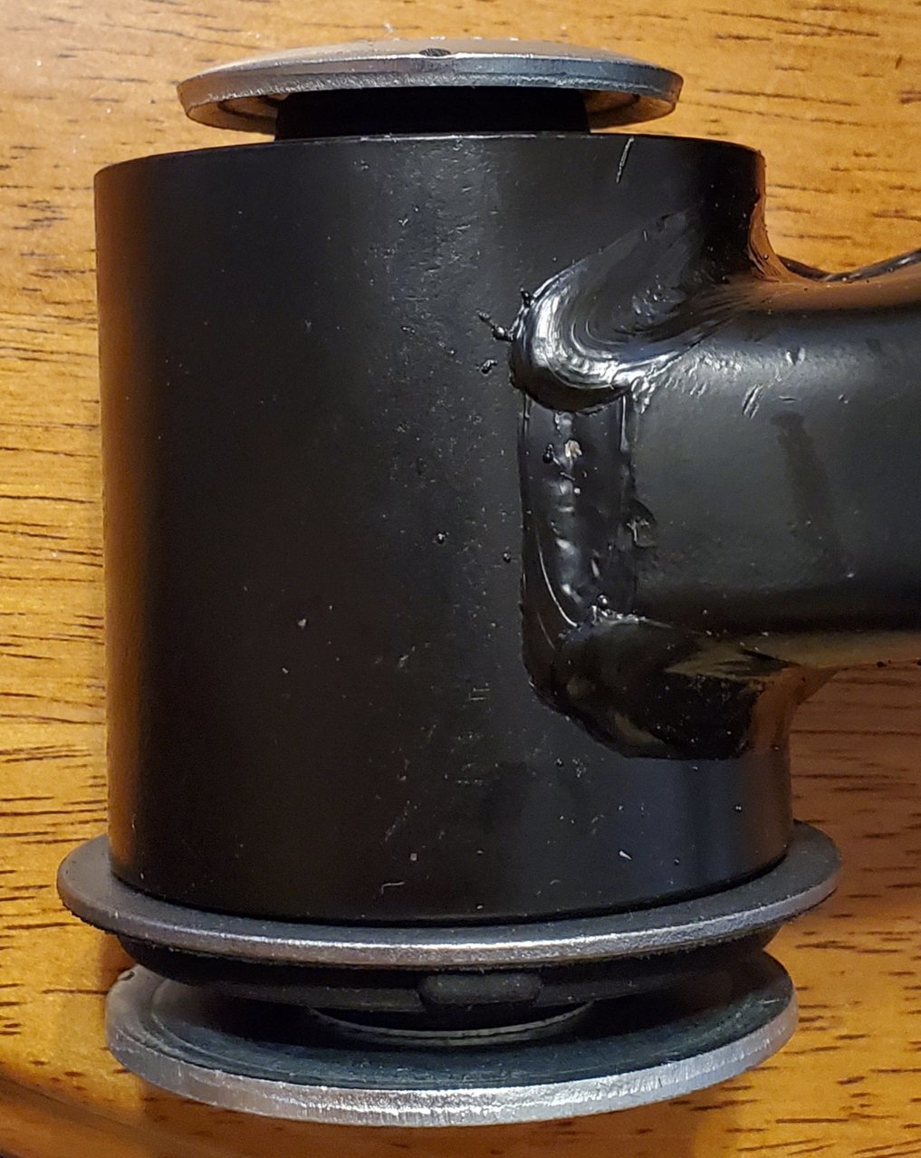

    I don't think I've seen Tundra lowers without bushings listed, could be wrong though.
    Pressing new bushings in is pretty easy compared to removing though. A big enough vice, or a piece of 1/2" threaded rod will do it.

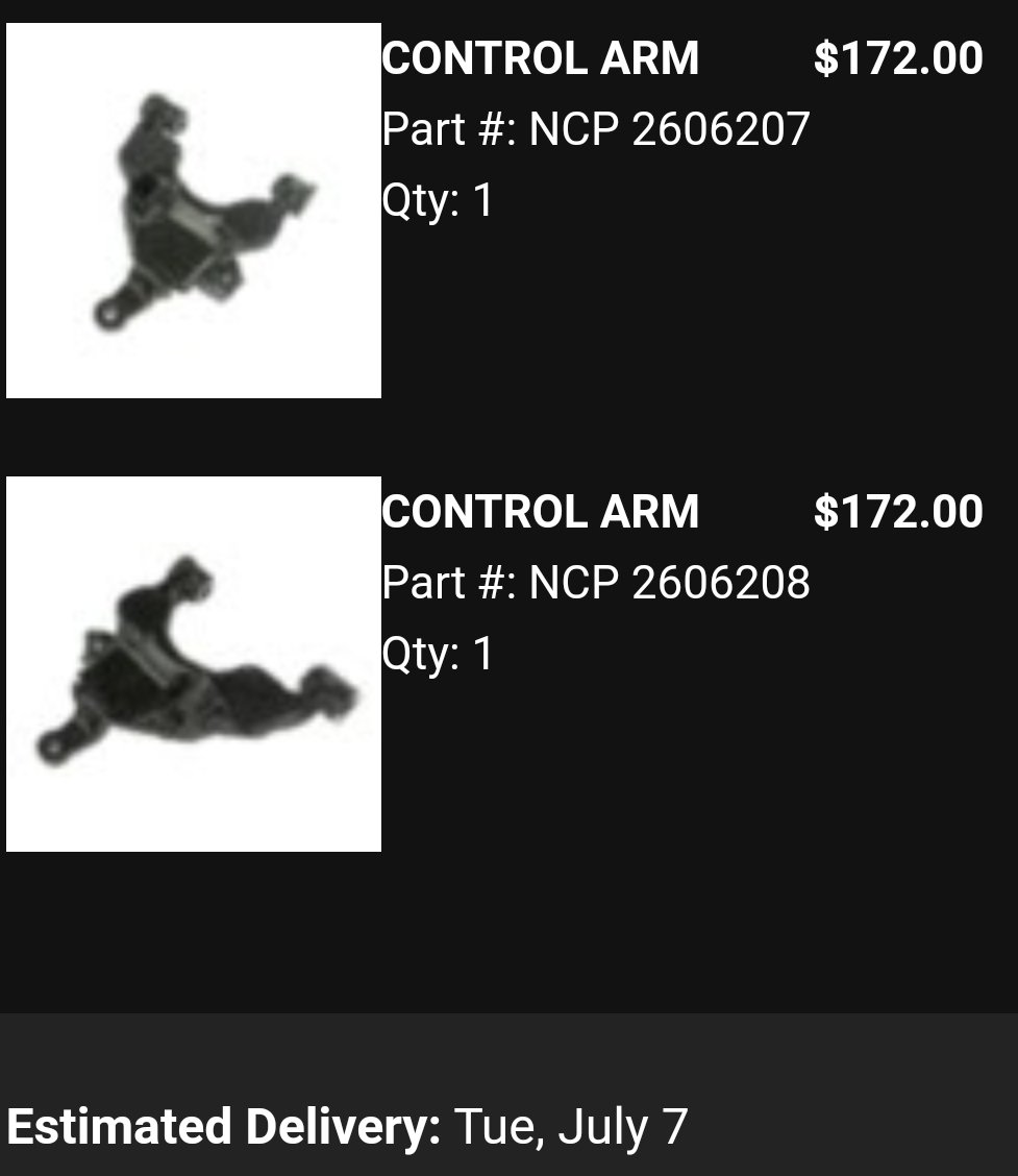

    Current pricing with the discount code if anyone is in need.

    Damn! Lol, that's okay. I ordered all these parts, and then got the call that I was going back to work the day after ordering. :(.
    Parts have been stacking up like @bmf4069.

    Any aftermarket arm has bushings installed already.

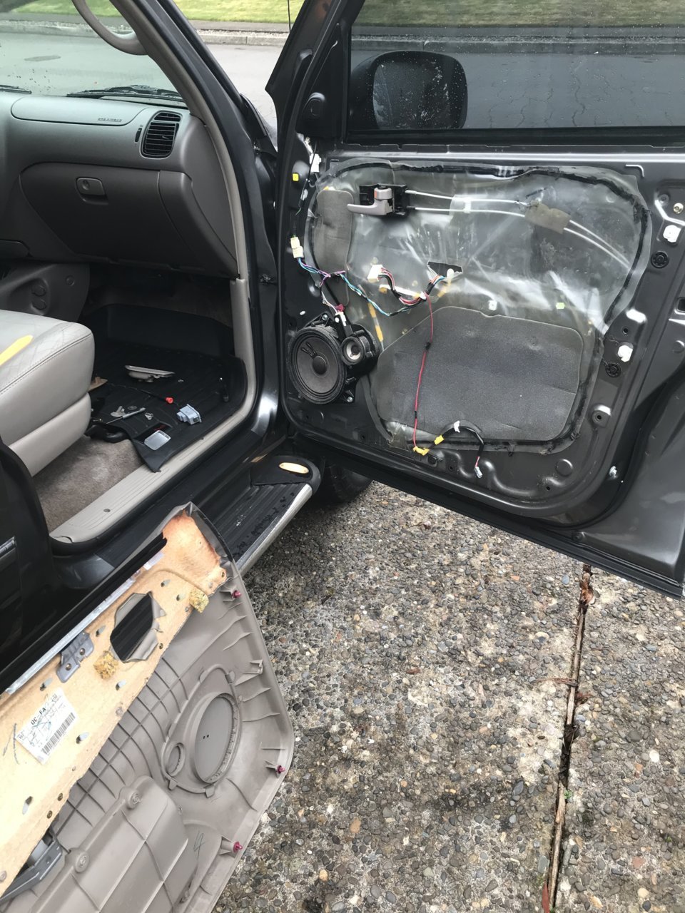

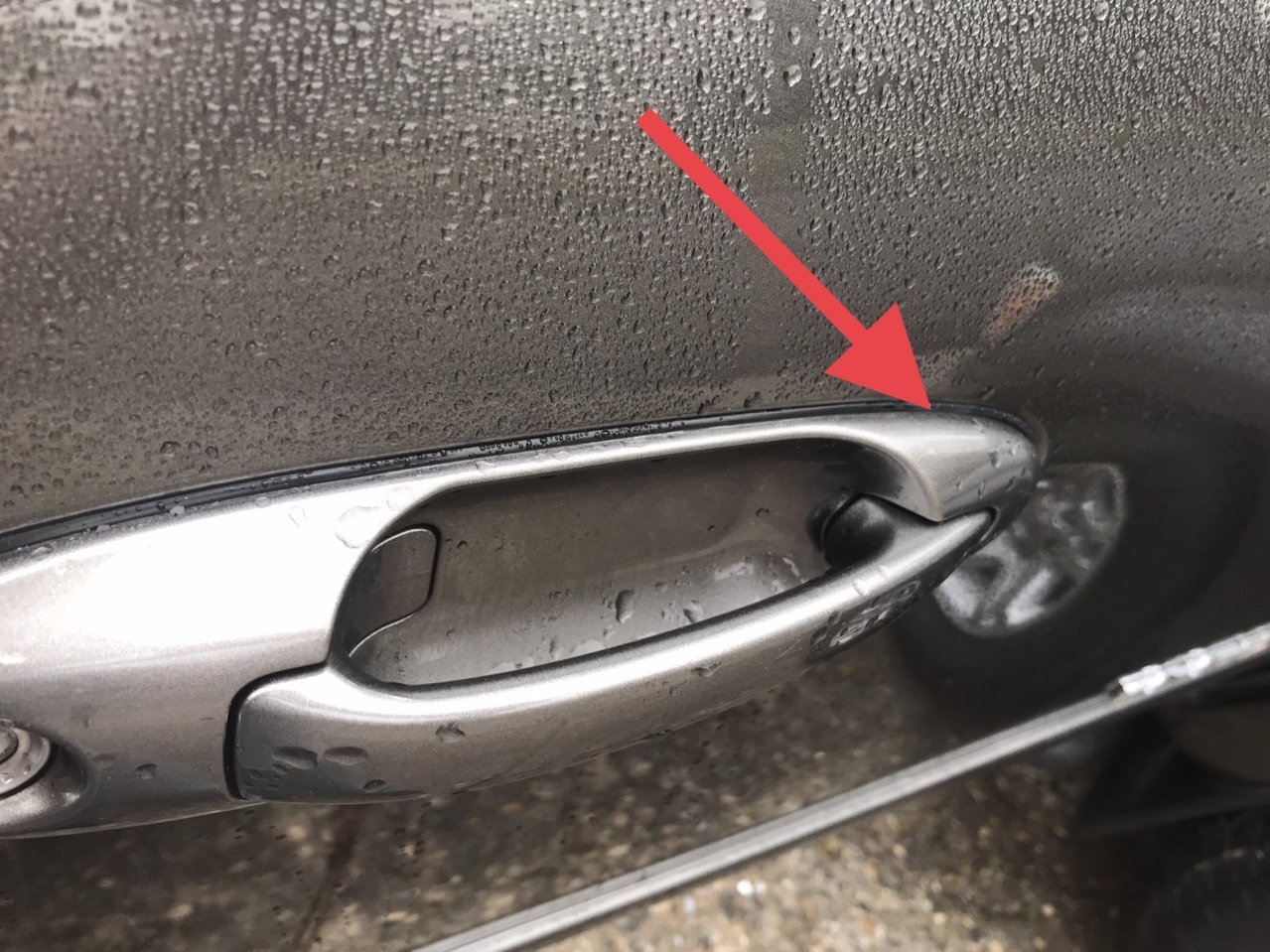

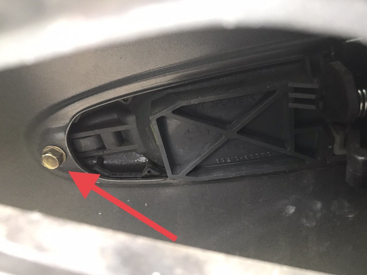

    Don’t use the Passanger door much but noticed the other day it was pulling out here
    found this bolt missing laying at the bottom of the inner door. Put it back in with a little blue loctite, put the panel back on. Took about 30 min to fix.
    Should be good for another 15 years. :D

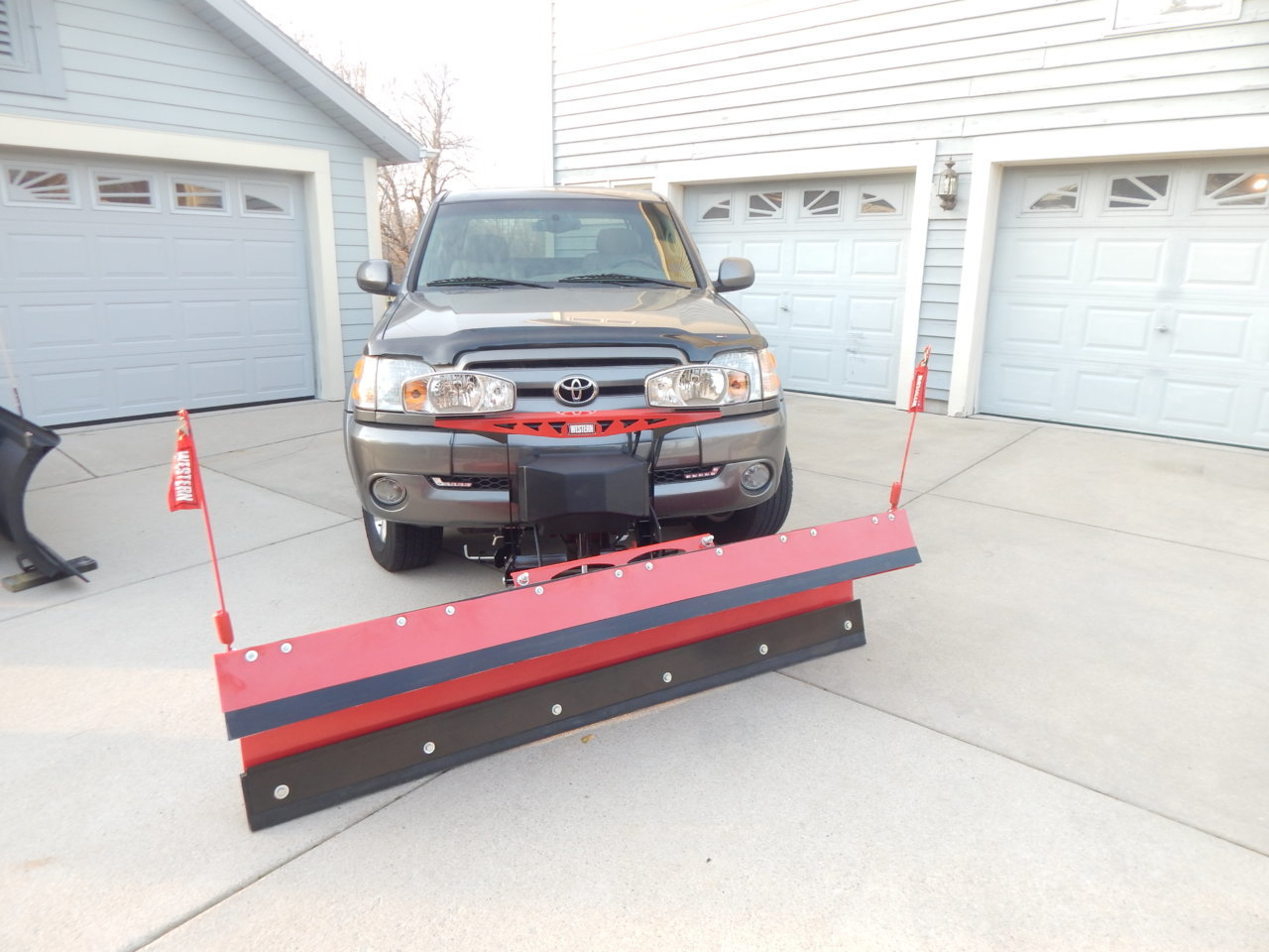

    Pretty much...
    Snow's comin'...I'm ready this year

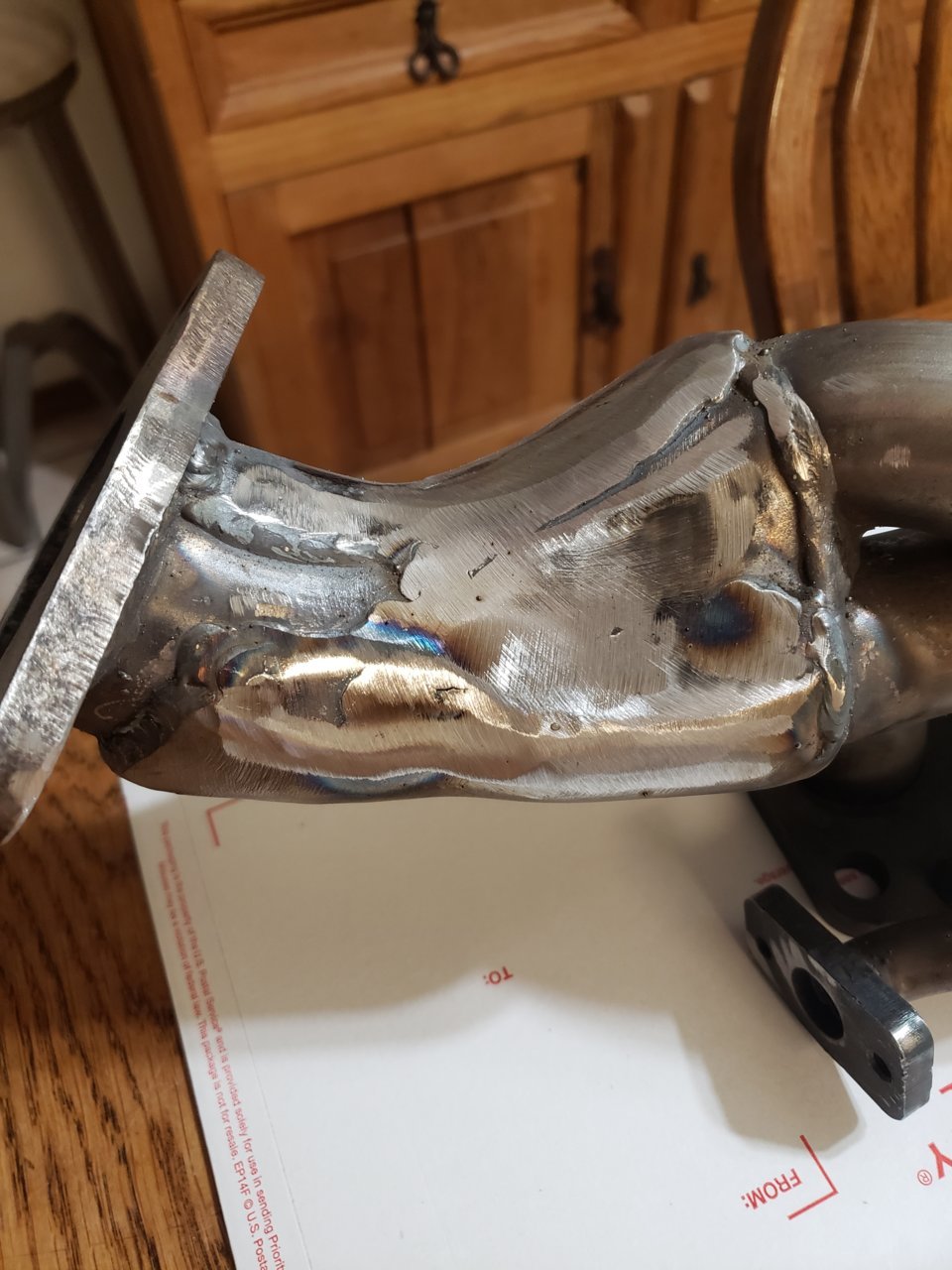

    Got the welded up and super reinforced shorty back today. If this breaks now then I have a serious issue somewhere.
    Here's an untouched one for reference:
