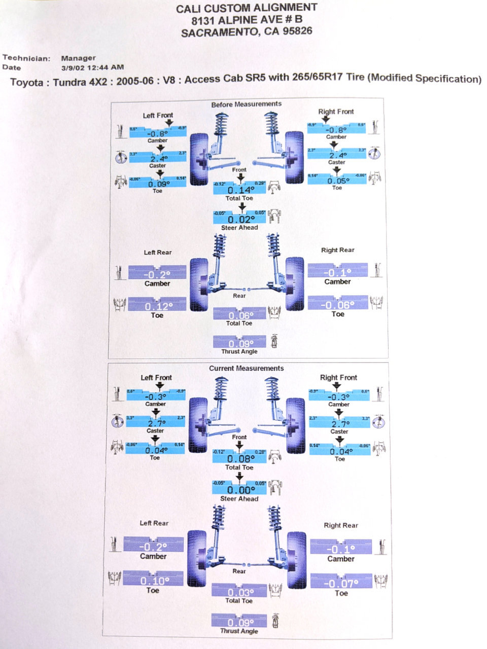

    Re-did my alignment, less camber & more caster.

    Hows the drive? Feel better?

    Yeah, it feels better. A little less vague when going straight and slightly more feedback in the first 20° or so of turning the steering wheel.
    These aren't stock specs fyi.
    The drivers side front adjuster is maxed out. I could get more caster but then I'd start adding camber. Granted, anything below -1° camber is more than fine.

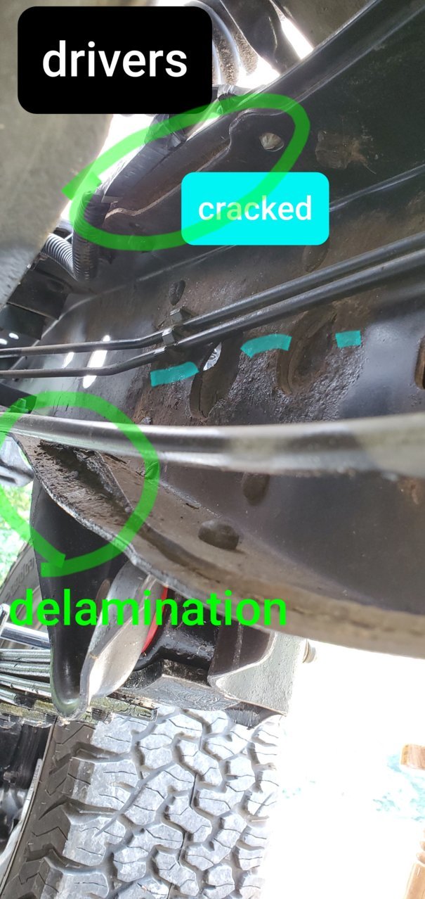

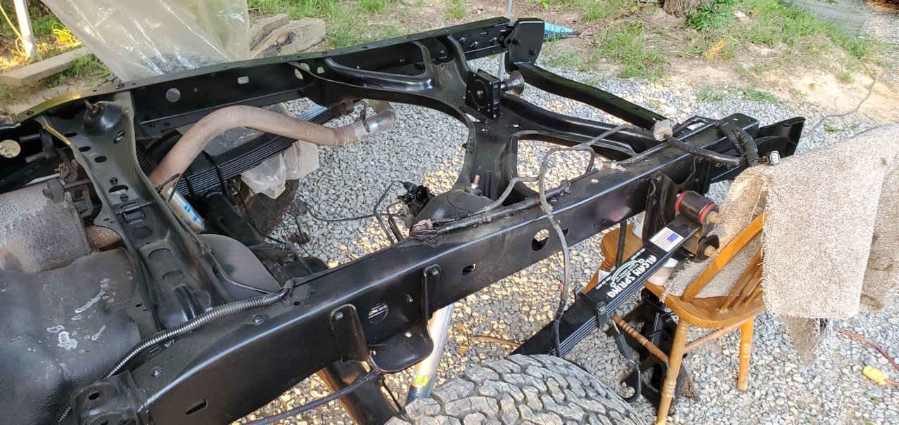

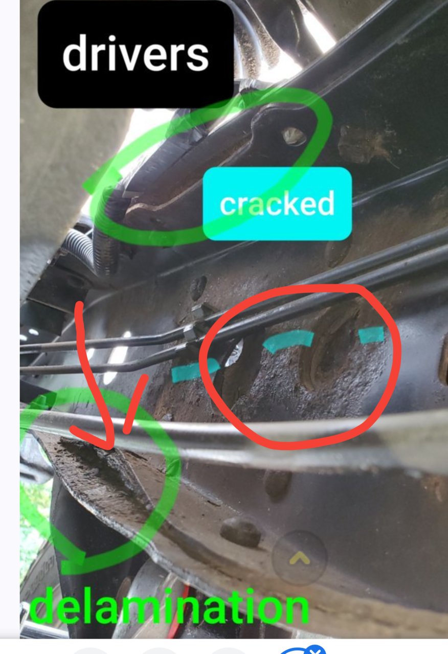

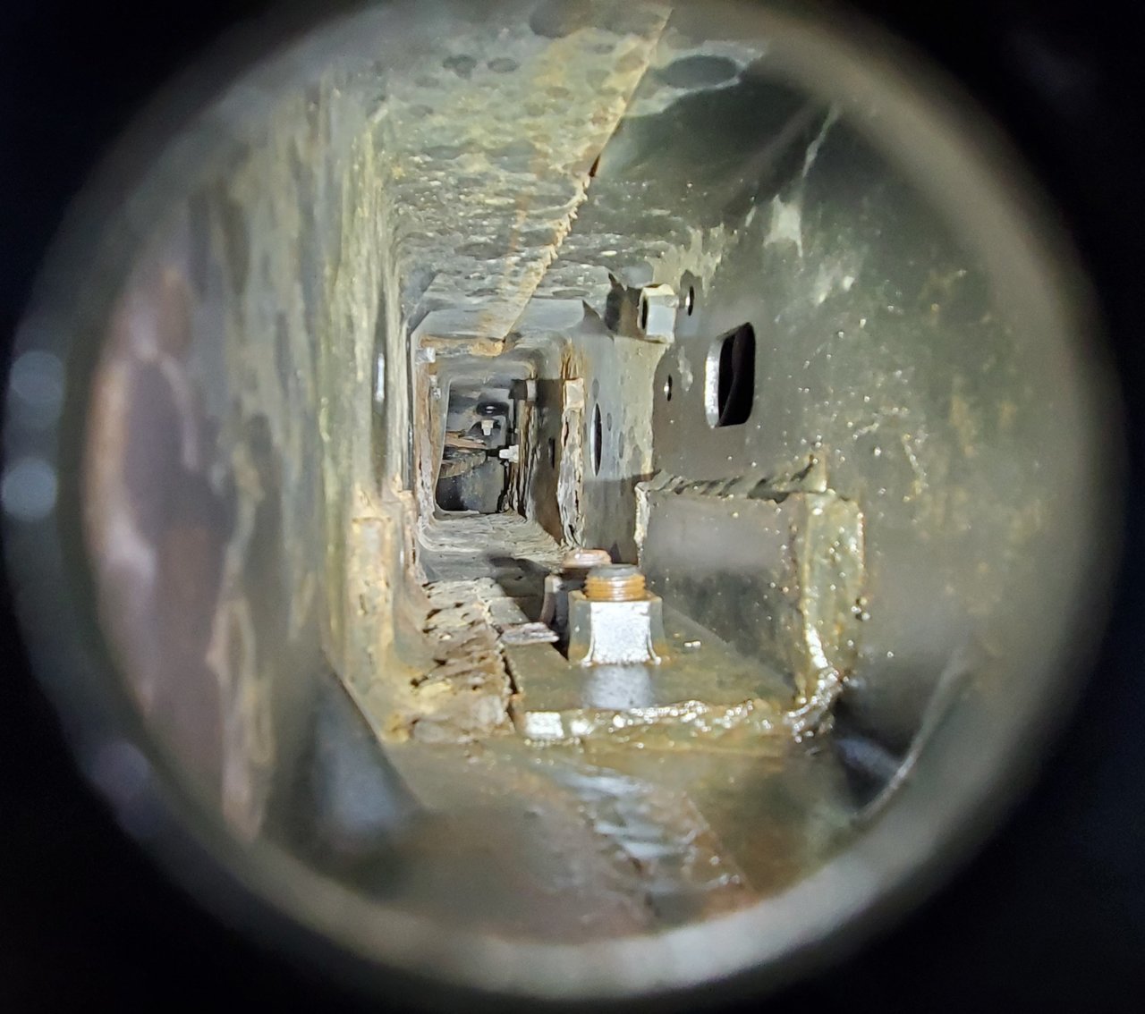

    100% agree here. My section of Kentucky does not salt heavily, and my truck was sold in Hopkinsville. Its been local 98% of its life excluding trips. Its spent about a week in VA/Western VA, about a week in Ohio.
    My frame was filthy when I pulled the bed.
    Here is what I consider extensive rust damage to critical areas.
    ^^^^ Cross member that goes over the front of the gas tank i think?
    ^^^^ front drivers side leaf mount.
    ^^^^ drivers side frame by transmission crossmember.
    Inside the front of the frame by bumper mounts.
    ^^^drivers side
    ^^^^ pass side.
    Here is what the rear looked like when I was done.
    I think that if I had been cleaning my frame annually it wouldn't have been this bad.

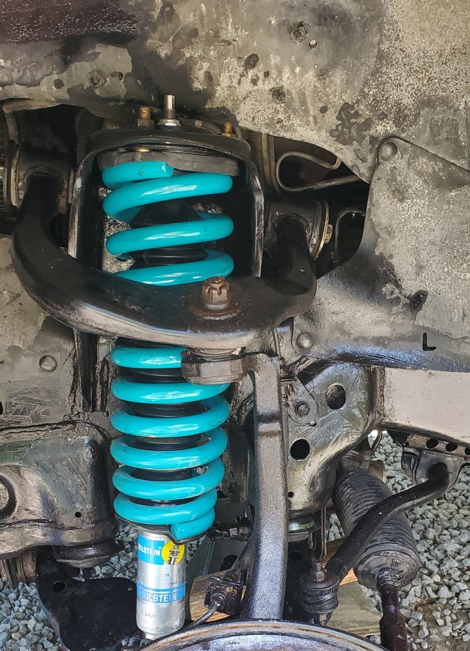

    They're the Deaver g57 springs if I recall correctly. They're actually softer than the original springs and they are more offroad oriented. The droop is insane. I have to lift the body over 2ft before the wheels lift off the ground.
    Here's a pic from when I installed them earlier this year
    I also added air bags with those daystar saddles to help when I tow. They are fantastic!
