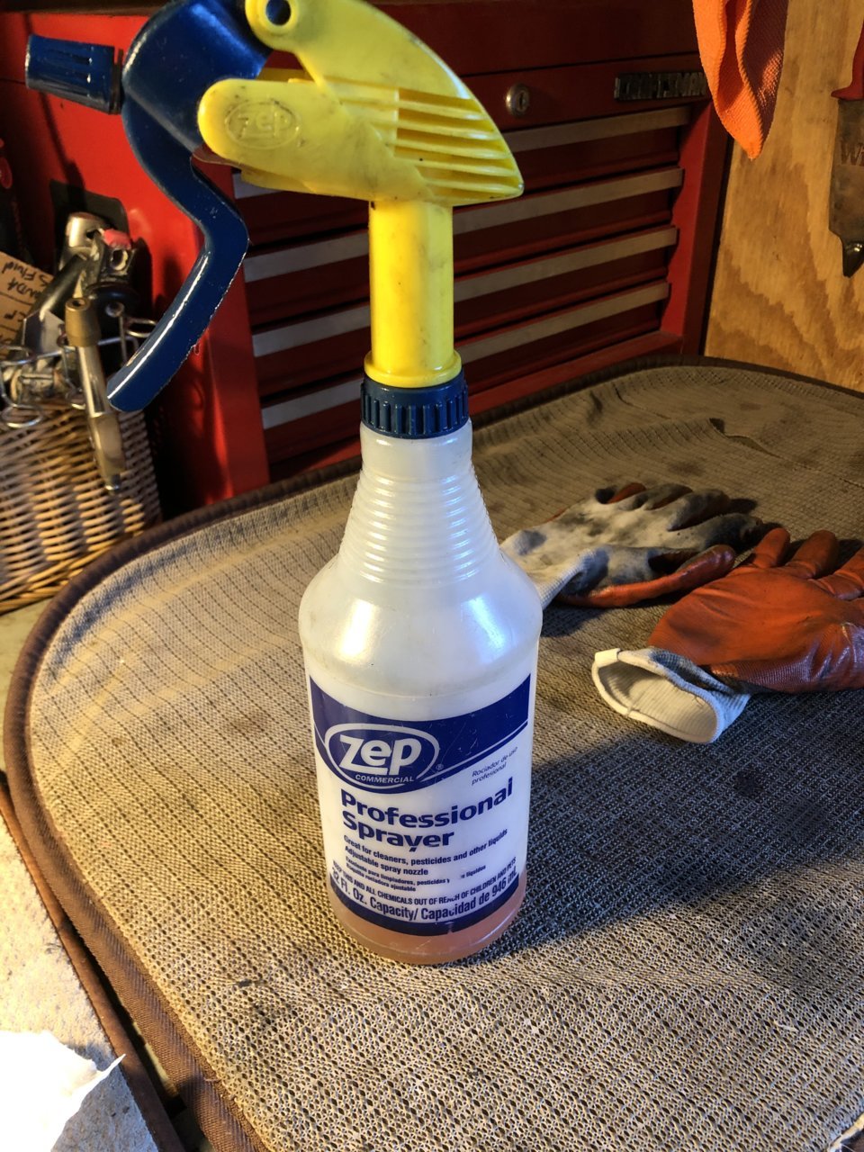

    The oil frame squirter. Works well with 0w-20. Might move up in viscosity.
    Pucks18, oscardog86 and Thrussn like this.

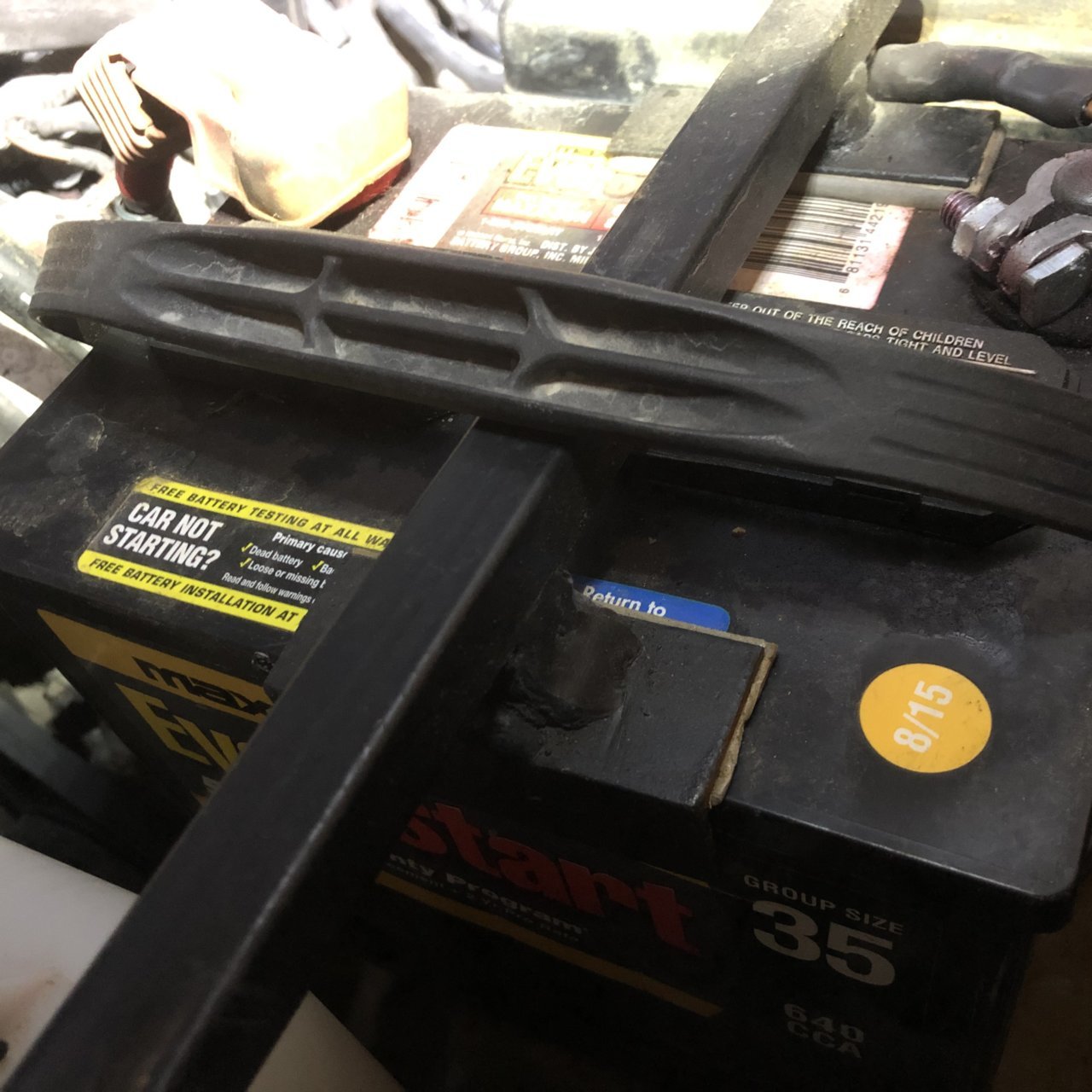

    Drums and shoes replaced? Check. Breaks greased? Check. Oil change? Check. New rotors, calipers, pads, lines, cylinders? Check, check, check, check, and check. ATF drain and fill? Check. O2 sensors? Check. Tires torqued? Check. Crossmember installed? Check. Brakes bled? Check. Check.
    All the in and out killed the 5.5yr old battery and when you were finally ready to start the thing, you can’t? :mad: Check.

    Good time to up them CCA's from 640 (although I think original spec is 585). Bummer on no victory lap after all that hard work!

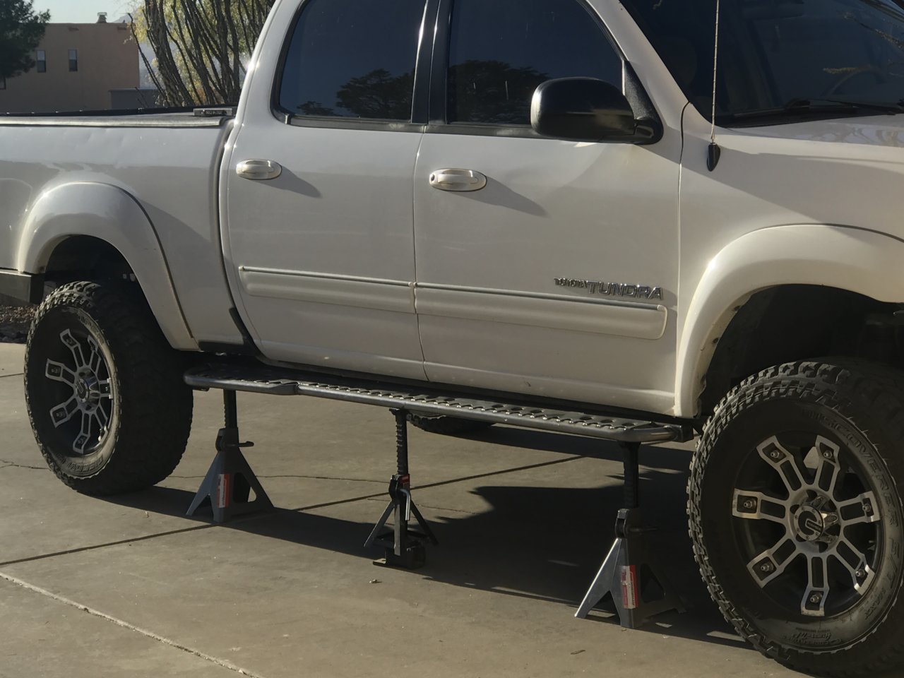

    Mocked up my new BRUTEFORCE FAB rock sliders!
    carpenter356, TRDGen, Voss and 8 others like this.
