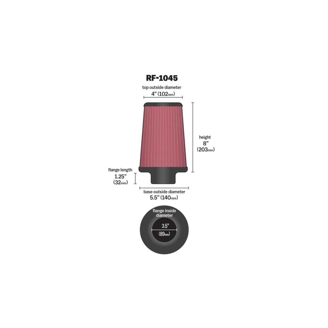

    it appears that this AEM will fit. That's based on the specs of the K&N compared.
    https://www.aemintakes.com/21-2049dk-aem-dryflow-air-filter
    I also found this Air Raid dry filter that is intriguing to me.
    https://www.airaid.com/701-422-special-order-univ-fltr

    @lsaami not sure if that AEM will fit. It lists the inside diameter as 3.5 where the K&N kit is 3.125
    Is the tube on your kit black plastic or the metal chrome one? That makes a difference. I have the black one, of course.

    I also have the black one. I was going off the ID of the filter that comes with the kit. RF-1045 which has an ID of 3.5. if the pipe has an ID of 3.125, it would make sense that the filter would have a larger ID to account for the wall thickness of the pipe.

    Interesting if yours came with that filter, mine came with RC-5100 and has different specs. If I have time later today I can dig mine up and measure the flange ID.

    Interesting... maybe they revised the model. I definitely have the black plastic, and the current black plastic model comes with the RF-1045. I'll have to take some photos and measurements of the flange/pipe.

    @Darkness To muddy the waters even further, there's a different model number between the 00-04 trucks, and the 05-06 trucks. and the 05-06 model has a 6" inlet.
    I give up! :annoyed:

    Yeah I recall that model change. I'm going to measure my filter and see, if it really is 3.5" and I've been thinking its 3.125 all this time that opens a lot of doors for better filters.

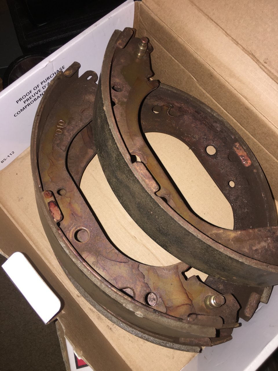

    Changed my rear brake shoes. Didn't buy a spring kit, so it was a PIA putting it all back together.
    Original ones lasted me to 225K miles. Huge difference in braking. My front rotors don't shake when braking from highway speeds anymore. Guess I should've done it 20K miles ago.
    Old pads below...
