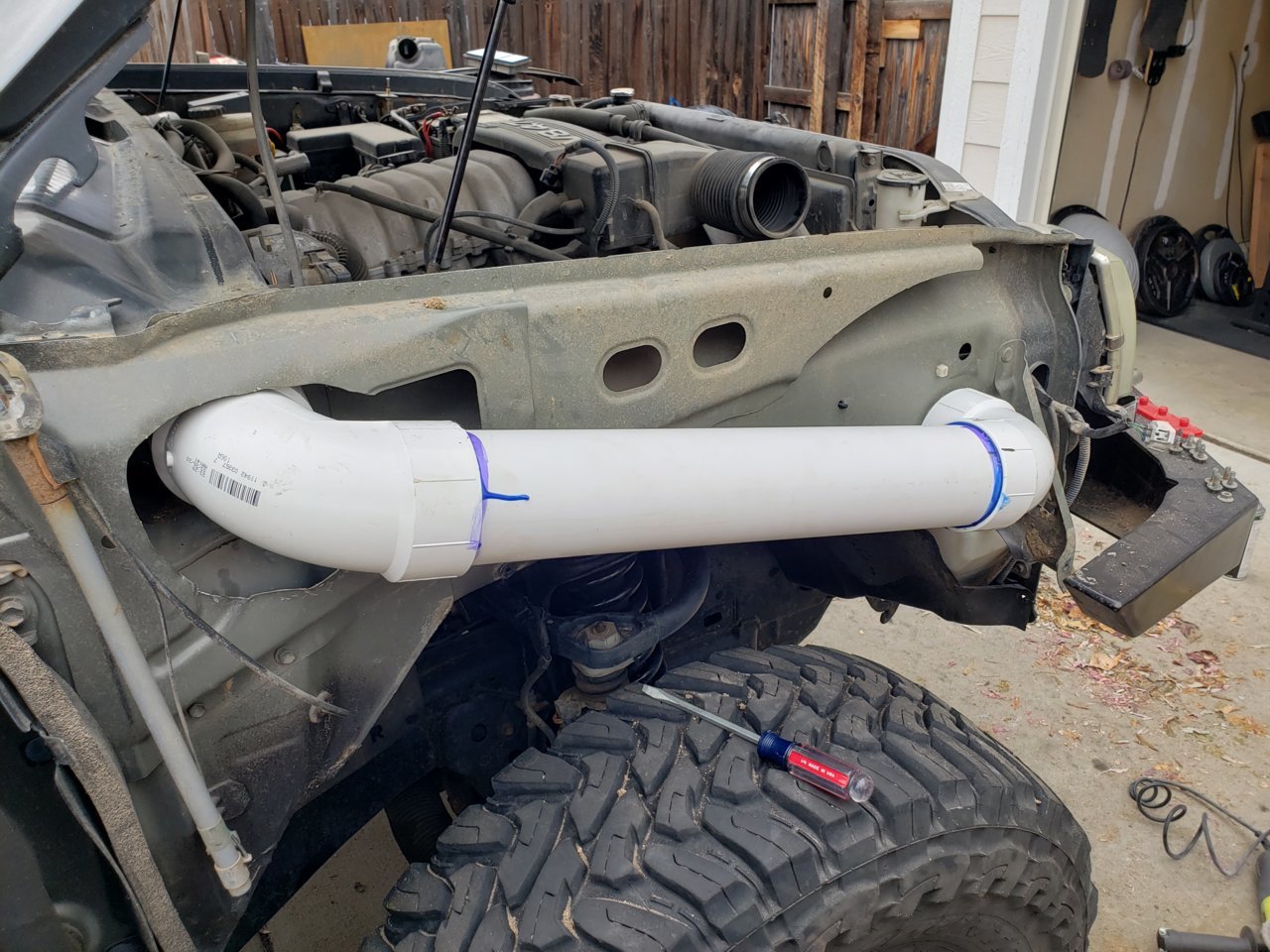

    Built a ghetto snorkel today.

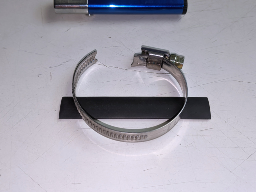

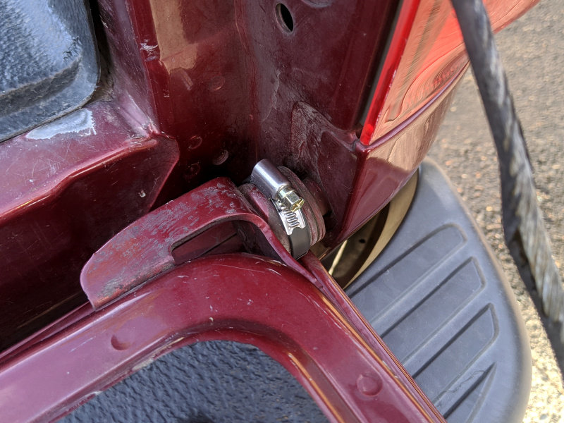

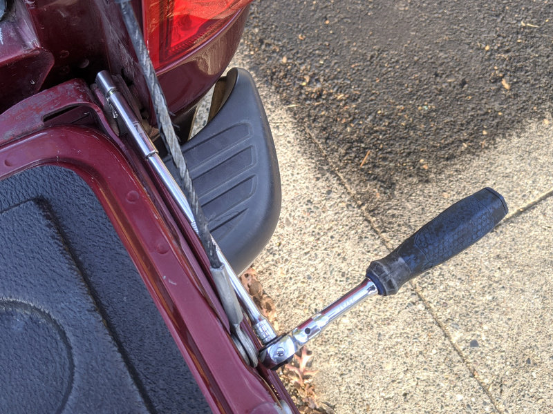

    Had a few of these SS formed thread clamps laying around. Threw a spare piece of heat shrink on and added it as the cheap anti-theft device.
    Nice thing about these style clamps is you can get a lot of torque on them. Unlike cheaper clamps that have slots cut in them. ;)
    Also gave a quick snug to the bottom window track 10mm bolts accessible on the front doors since I had the ratchet already out.

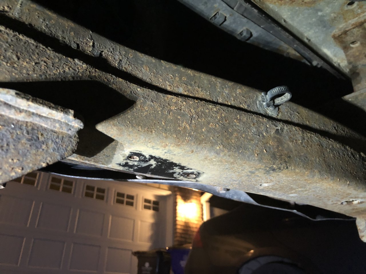

    Changed the trailer wiring harness to a working one, and found some black paint!

    Maybe it’s a Texas thing but as a youngun I was always taught to put the hose clamp on. It’s like a lock, it may not stop em but it’ll delay em long enough to get a shot off.

    are stolen tailgates a big issue in Texas or something?

    At least out here in oil field country, yes.

    I’ve considered doing this, but read that it makes noise inside the cabin increase as the fresh cabin air intake is located right there. Is this true?
    Reason for me doing is to eliminate the hot engine air suction during idle. The new mod would suck from the cowl screen.

    But if you hit water too fast, isn't the bow wave going to roll up the hood & into the cowl cover? Seems like that'd be the 2nd worst place to grab air?

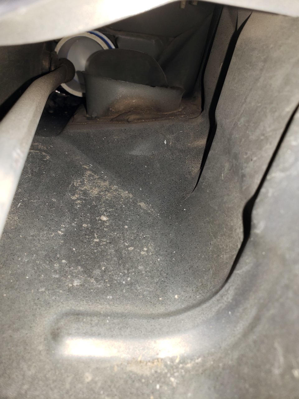

    Having had the cowl open quite a bit when fixing the clip leaks and even greasing the wiper blade arms inside, I can say that that area in the pass side corner is well protected. There are drain holes in there. I assume if the new intake arm is higher than the drain then one would be ok.

    Yeah when I removed mine, I was surprised how far away the actual vent on the cowl was from the AC air intake. It’s offset quite a bit

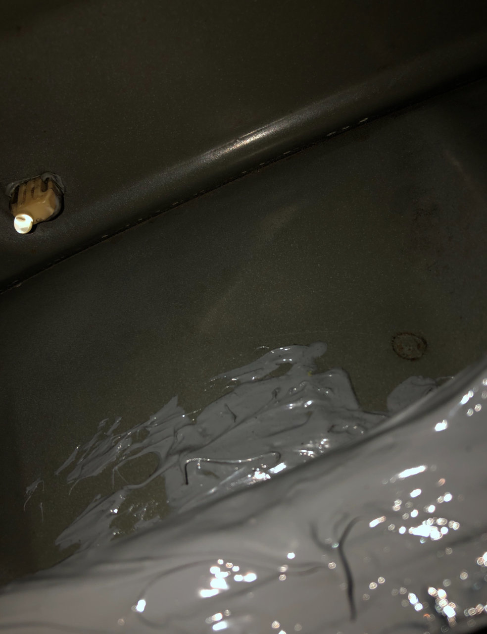

    It is offset pretty far. I gobbed FuzeIt all up in the rim of that Cowl Bowl and even along the outer gasket when tracking down that leak. Really quieted down the outside noises.

    You see that little water drop coming from the already glued Cowl Clip?

    Cabin air is right there, yes / I'm certain there will be increased noise. I haven't taken it for a drive yet since I got right into steering rack bushings yesterday, but can update you this afternoon.

    Did everything right and it still leaked I suppose through a crack in the clip. I ended up loading that up with a gob.
