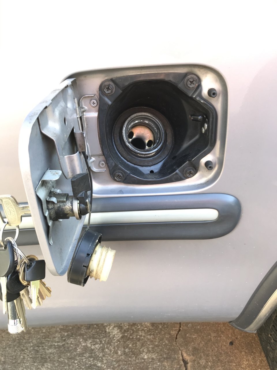

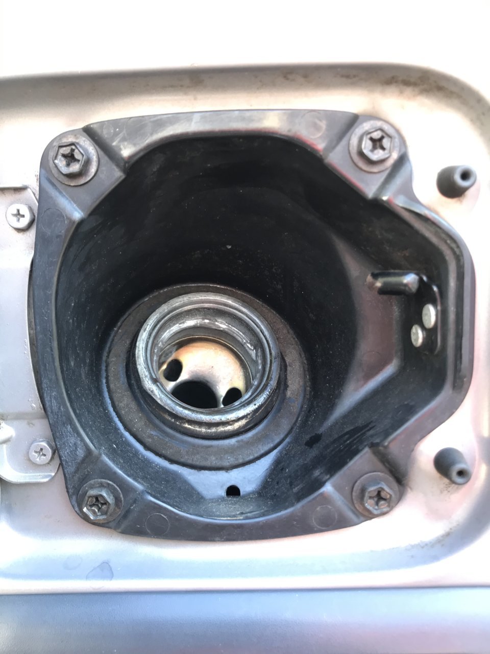

    @Rex Kramer can you grab a picture of the filler neck with the gas cap off on your truck? I need to see if mines set right... it doesn’t appear to be abs I can’t remember what it use ti be like.

    Hmmm I guess mine is right... just looks off to me

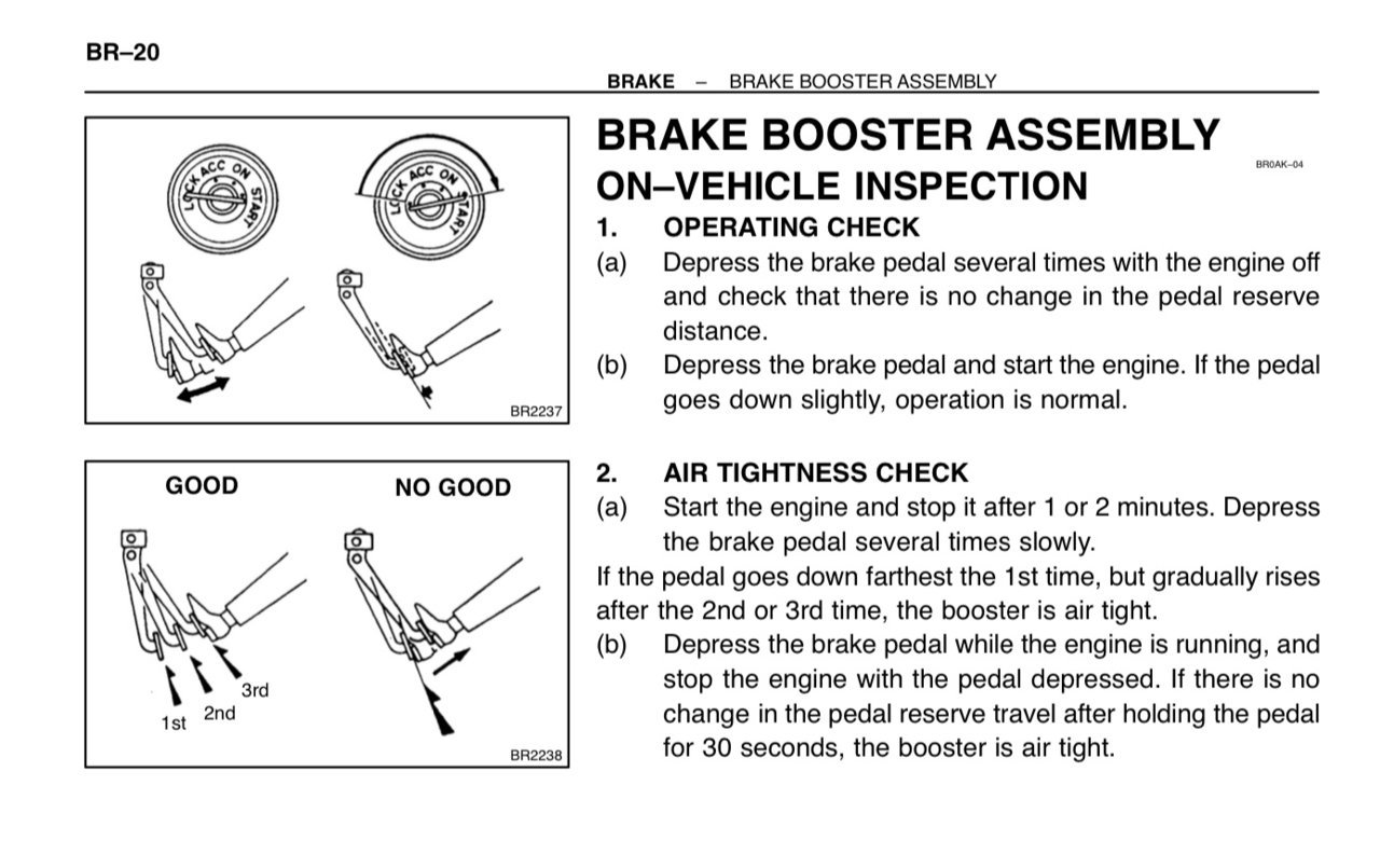

    There is a FSM brake test I’ve posted here quite a few times in which you’ll know what is or isn’t a problem.

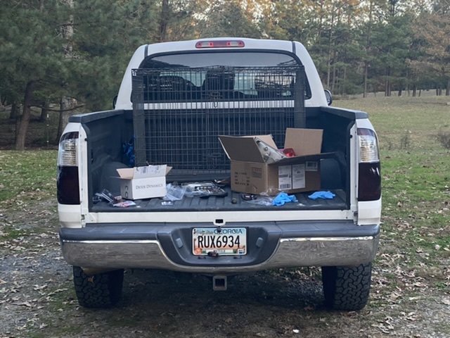

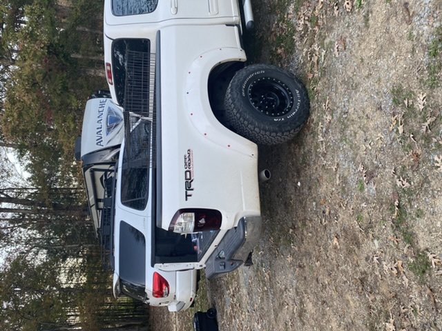

    Got to do a little something on the truck today
    installed:
    *spyder xtune smoked rear tails
    *Diode dynamics smart tap flasher relay
    *diode dynamics Red Xp80’s in taillights/brake lights
    *diode dynamics Amber xp80’s in turn signals
    *diode dynamcis Hp5’s in the license plate lights
    Not sure on my reverse lights, they’re probably gonna suck they came with the tail lights as an add on but we’ll see
    oscardog86 likes this.

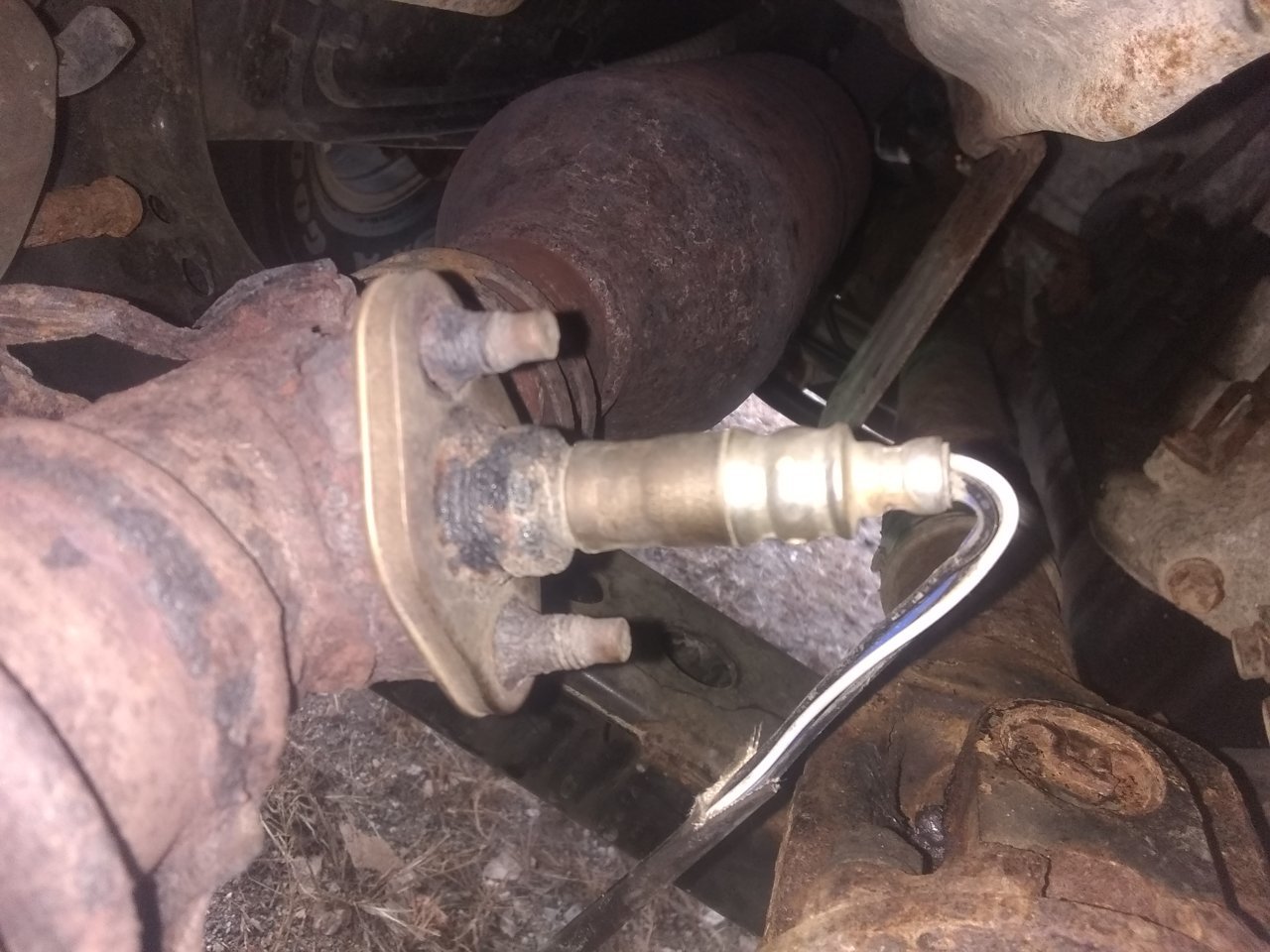

    Been getting an intermittent code from bank 1 #2 O2 sensor circuit. Checked the wires, fuzeafuze, cleaned the connector this morning to rule out the circuit before replacing the sensor.
    I also snapped this picture:IMG_20201107_074504444.jpg
    WTF do you guys think is holding that sensor on, good will? It looks to me that the nuts have rusted away, and there is just a little bit of something left holding it in place. Sensor is a denso, does not look that old, and does not move when I pull on it. I think I'm just going to order one and replace the nuts, these can throw a code if there is a leak right?
    Also fluid filmed the entire undercarriage.

    My old ones looked worse than yours and I believe they were original. They weren’t throwing codes, but I replaced them anyway as a precaution. When they were removed and tested on a Digital Meter they had Zero Resistance. Way out of Spec. :rofl:
    I replaced the fronts as well as they were Bosch. Wanted all 4 speaking Japanese. Total cost around $200. You can check my build page for the thread chaser and front sensor removal tools ($20).
    Truck torque is amazing afterwards. Better MPG, too.

    Looks like what mine started as.
    Heres a link to the post way back on page 537.
    The two 12mm nuts basically rusted into that. I almost thought it was a weld, but I was wrong. Thankfully.
