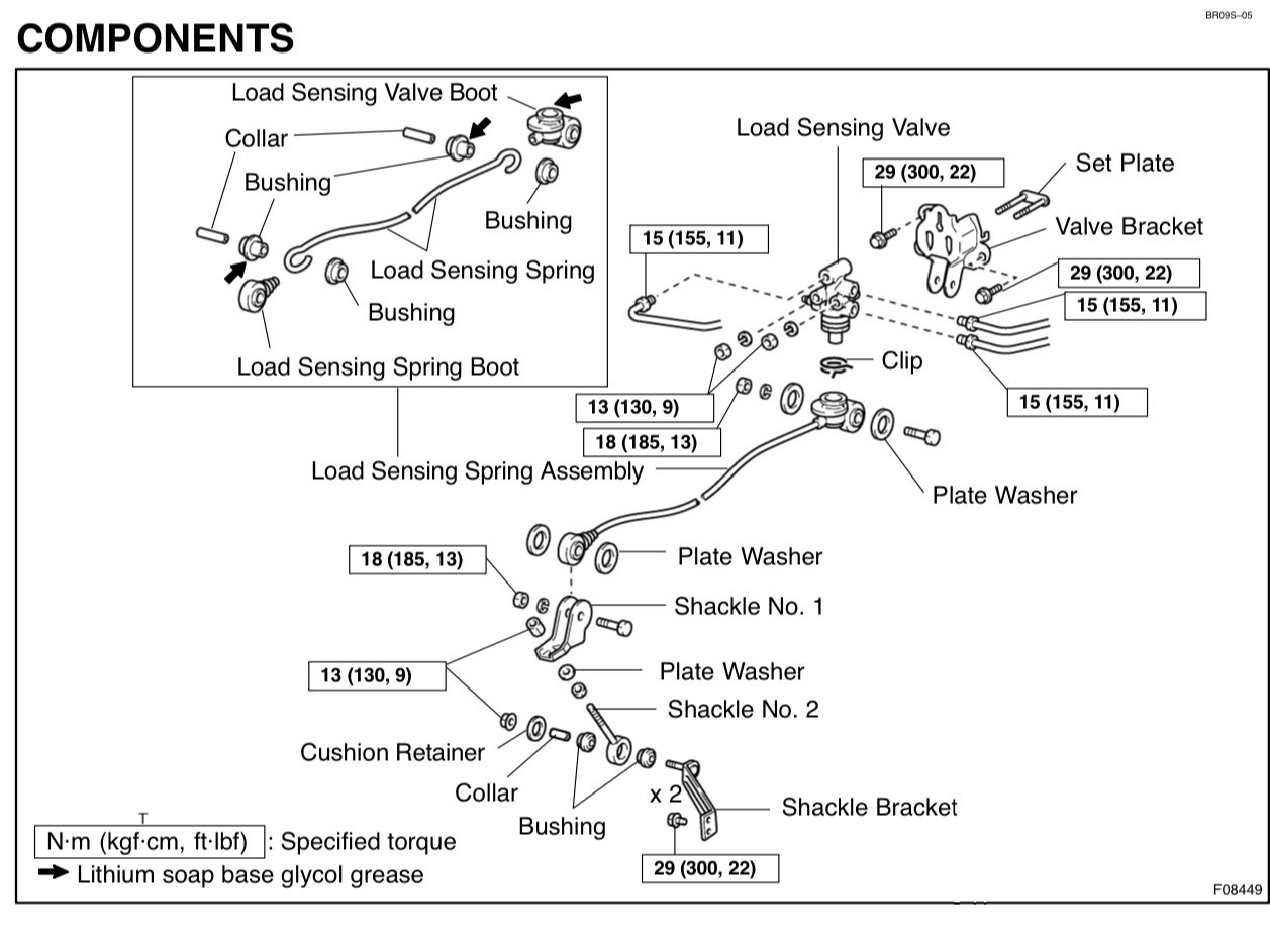

    Couple of things worth repeating:
    1) Adjust Nuts UP to make the rear brakes work more. Adjust DOWN to make rears work less.
    2) Fix your parking brake/cables and you won’t need to do the clicks through the rear plates. I’ve shown the way on this multiple times. It just takes time and some finesse.
    3) Do your homework before following advice here or elsewhere. I remember reading some stupid mods on another site from years past that made no sense. You’d see them post with no follow up and then the lemmings follow in behind and do the same! Consider the entire cost of the big picture.
    @FirstGenVol sounds like tinkering with the edges won’t work for you. I see it a few ways:
    1) Tinker with the edges and live with soft brake pedal.
    2) Follow the g-hoff brake dudes advice as he probably has heard some negative feedback and hedged his brake sales with that disclaimer. Double D Booster and new cylinder is required. I remember posting up on the total cost back when these brakes were the rage after research. You’ll spend $1500 minimum to do it the right way. Still haven’t heard a good review on these brakes on this site that give me a good feeling. Seems like nothing but problems from my reading. Spongy pedal. Brake power not kicking in until last second. Sketch!
    3) Buy a new OEM booster (single) and hope it fixes your problems. If not, then more $$$$ on top of more$$$$ to execute option 2.
    4) Switch to WL13 Calipers if New OEM (single) Booster doesn’t make things better on the big brakes.

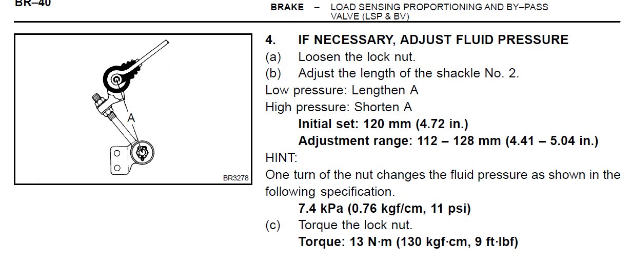

    According to the service manual, lengthening the shaft decreases the brake pressure...

    I read that as; if you have low pressure, lengthen A. If you have high pressure, shorten A

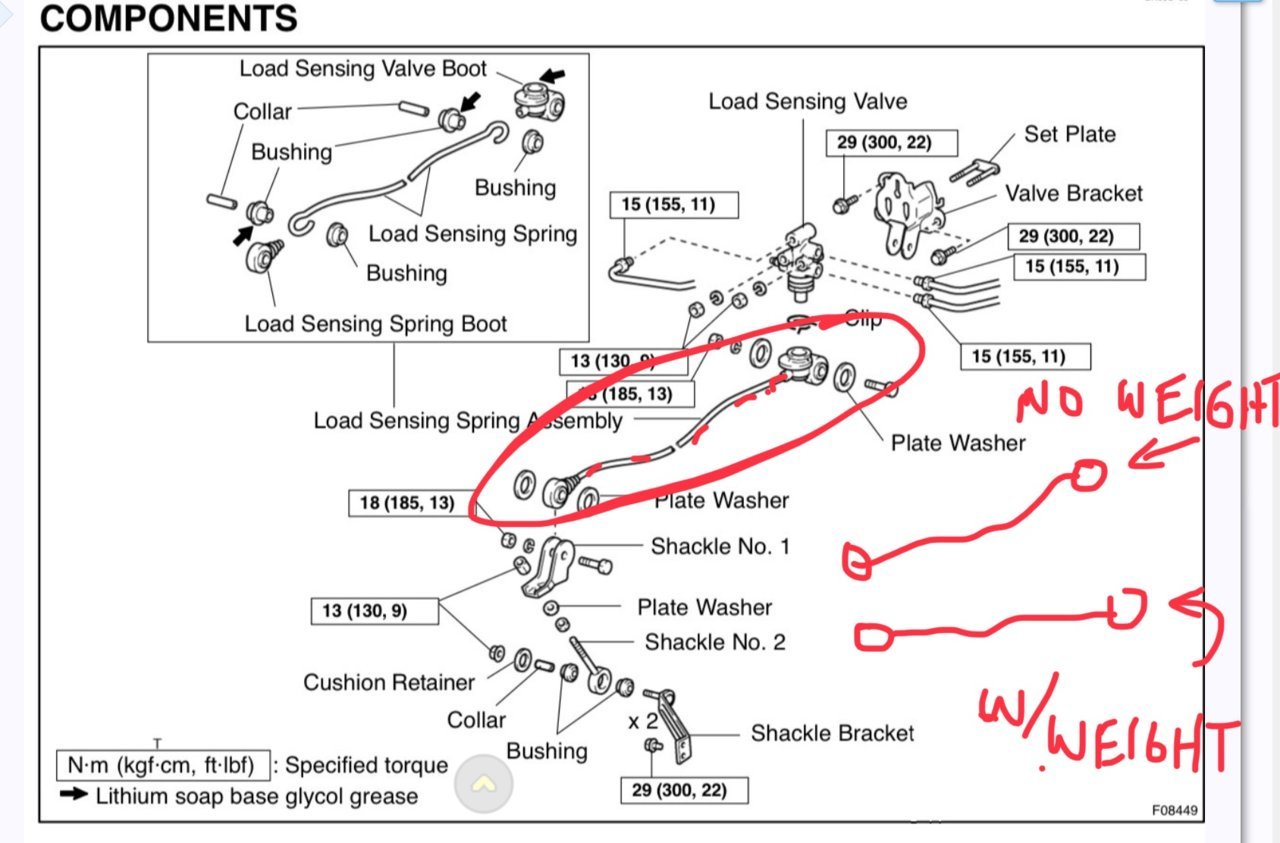

    The above diagram shows what weight in the bed does to the valve arm. When the arm goes horizontal, then that sends more distribution of braking to the rear.
    Adjusting the Nuts UP short cuts and mimics (by making arm horizontal) weight in the rear bed and makes the rear brakes work more. Its tricking the rears into thinking there is a load.

    When lifted, the LSPV should be raised the same amount as the rear is lifted, this also helps keep it driving like stock. Lifting the rear and not adjusting it leads to less brake force in the back
