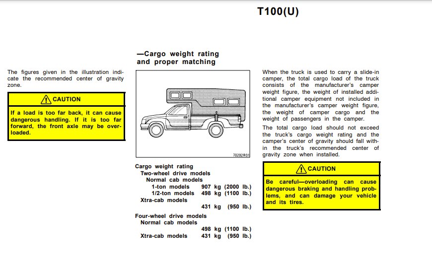

    It's so weird that if you read through all that, it reads like Toyota downgraded the brakes for the newer and heavier and higher payload/tow rating new Tundra in 2000....it's a head scratcher...:notsure:
    This is from a 1998 T100 owners manual....I did not know the T100 had a 1-ton option....I would imagine it would have beefier brake components for sure...:monocle:
    https://www.toyota.com/t3Portal/document/om-s/OM34412U/pdf/OM34412U_edited.pdf

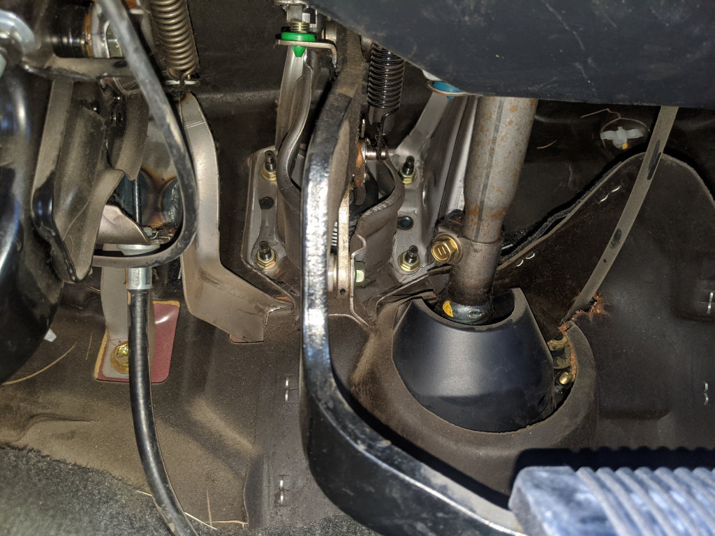

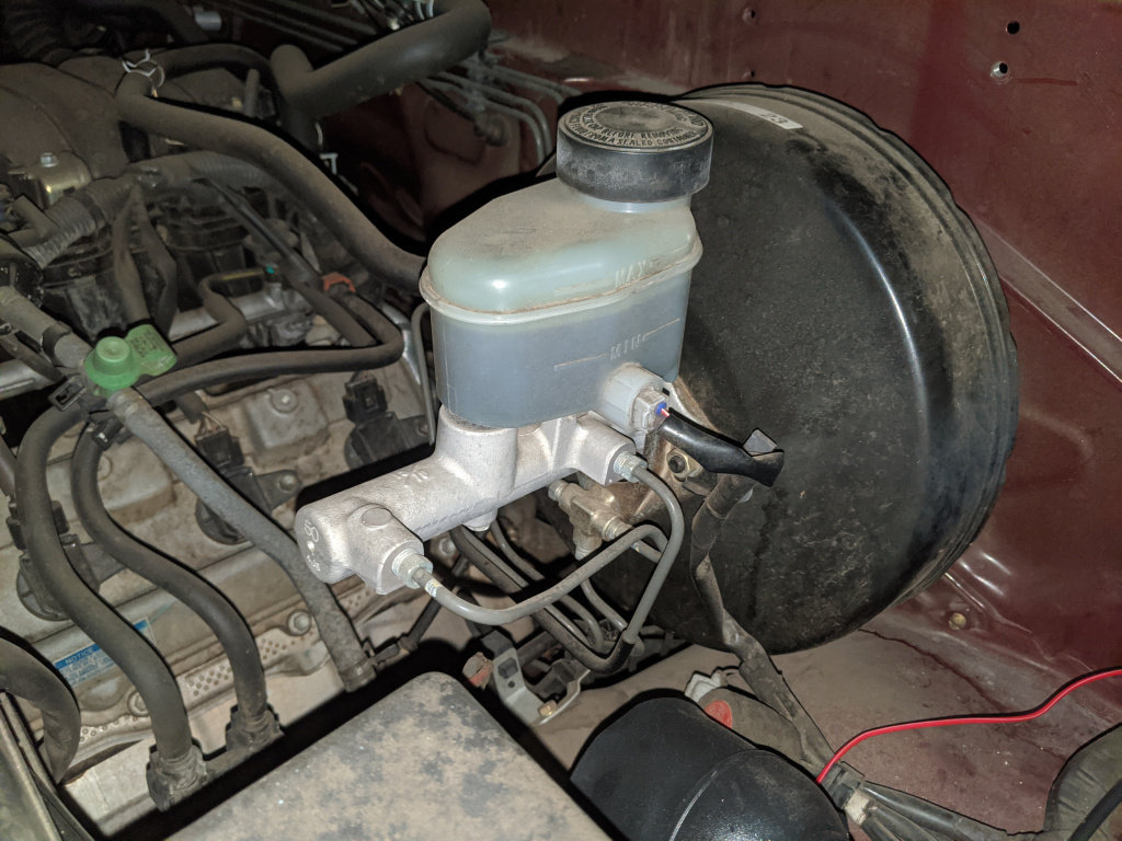

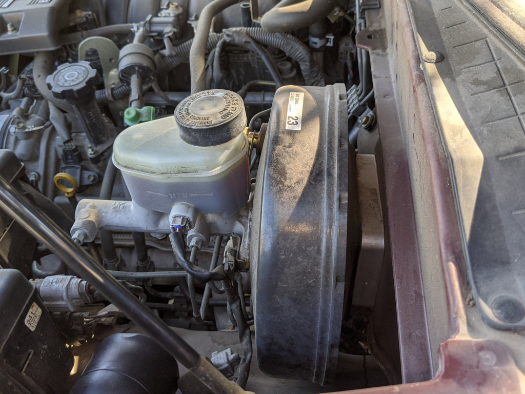

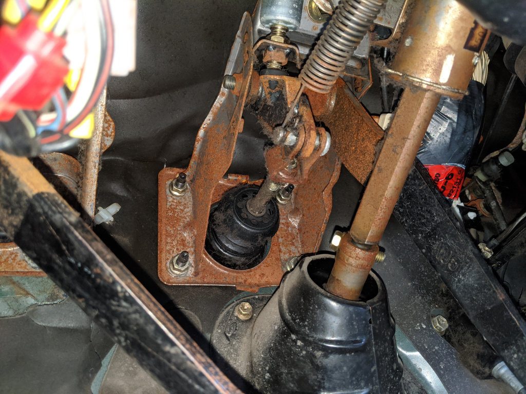

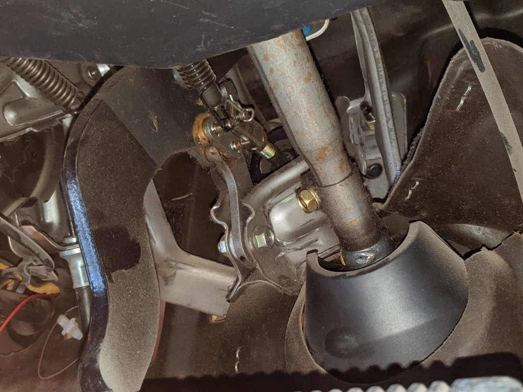

    Since one of my other vehicles is a 4wd Tacoma... I went out and snapped a few pics of the Brake master/booster and inside mounting. The 1st gen Tacomas and T100's shared many parts and most of their drivetrain.
    Here's a few of my Tundra.
    Here's the spacer that was talked about in the TS thread. If the studs from the Tacoma/T100 booster were longer you could run the spacer and NOT have to cut the adjusting rod down.
    Looking at things inside the Tundra, the articulated adjuster in the Tundra is probably why the adjusting rod had to be shortened on the Tacoma/T100 booster.
    That said, there could be a bolt in, no cutting required solution out there. Just would require some research and test fitting.
