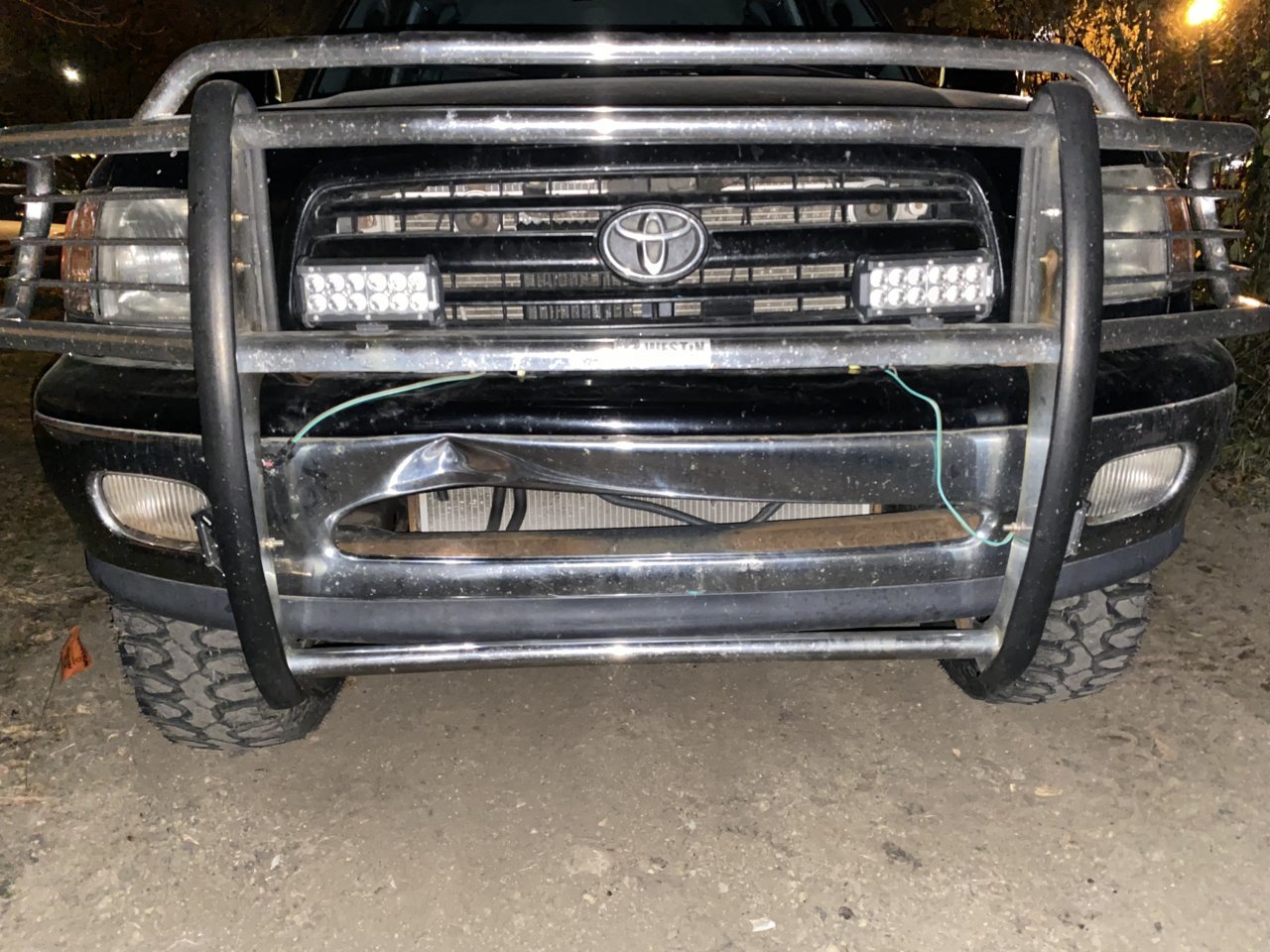

    I hit a deer with my Tundra today.

    How fast were you going?
    I'm worried about hitting bambi, and him flying inside the deer guard just like it appears happened to you.
    Depending on speed that may have just been its head hitting your bumper while the deer guard took the brunt of it.
    Turned its brain to pink goo.

    i hit the body believe it or not. It was coming across from the drivers side, I locked up the brakes so I was probably only doing 30-40 when I hit it. Bumper is obviously smashed, grille guard is tweaked, and probably the code support deal that goes underneath the grill.
    good news is, I have a replacement core support, so I’m going to try angle the insurance company to allow me to fix it myself.
