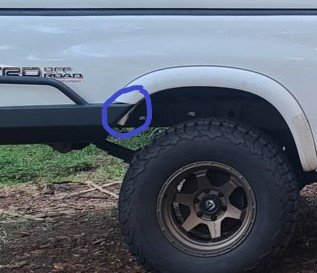

    You ganna cut this little piece?

    Yes sir! Next weekend.
    My fabricator noticed it right as I was picking it up doing the walk around. He also pointed out right above that when trimming the fender flare it got a little away from him so it doesn't sit flush on the bumper like the other side.
    Still a few things to address!

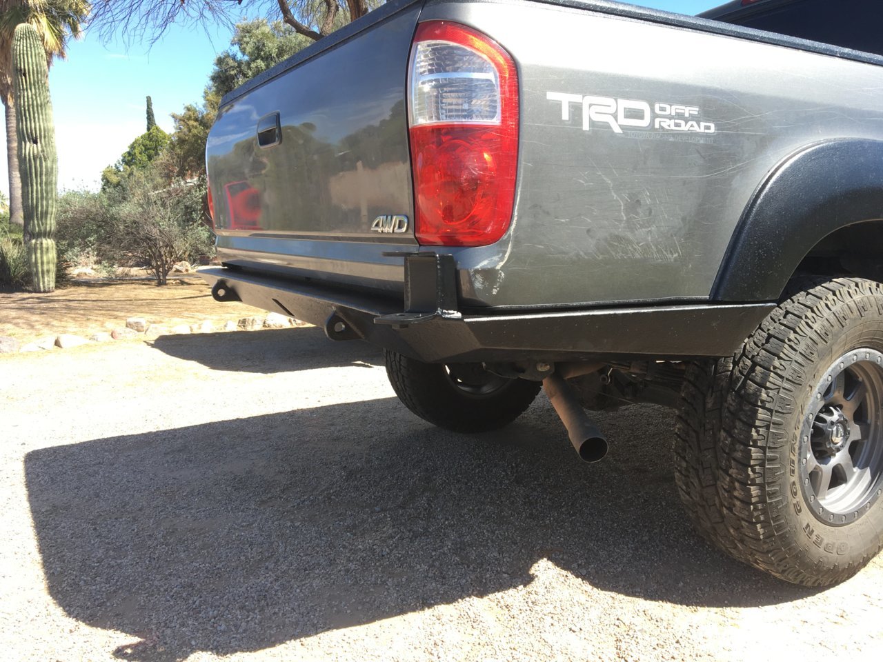

    Be careful if it indeed does sit on the bumper, things flex and the bed will start to rub into the paint and metal. I left almost 1/2 gap between my bumper and fender/flare, and then used a edging material to cover the sharp edge

    The bed line is actually below the bumper on mine so there isn't a gap.
    The gap I'm referring to is the fender flare that was cut after the fact.
    For some reason, we didn't receive instructions with everything (and/or the powder coater lost them?) so it was a guessing game on how everything went together/how much to cut. So, being careful, only cut what he thought and I'm actually really happy how it turned out and essentially pushing the bed inward a little so there's not a gap at all. Looks really clean compared to some ive seen but I do like how you put the edging material between. That looks good as well!

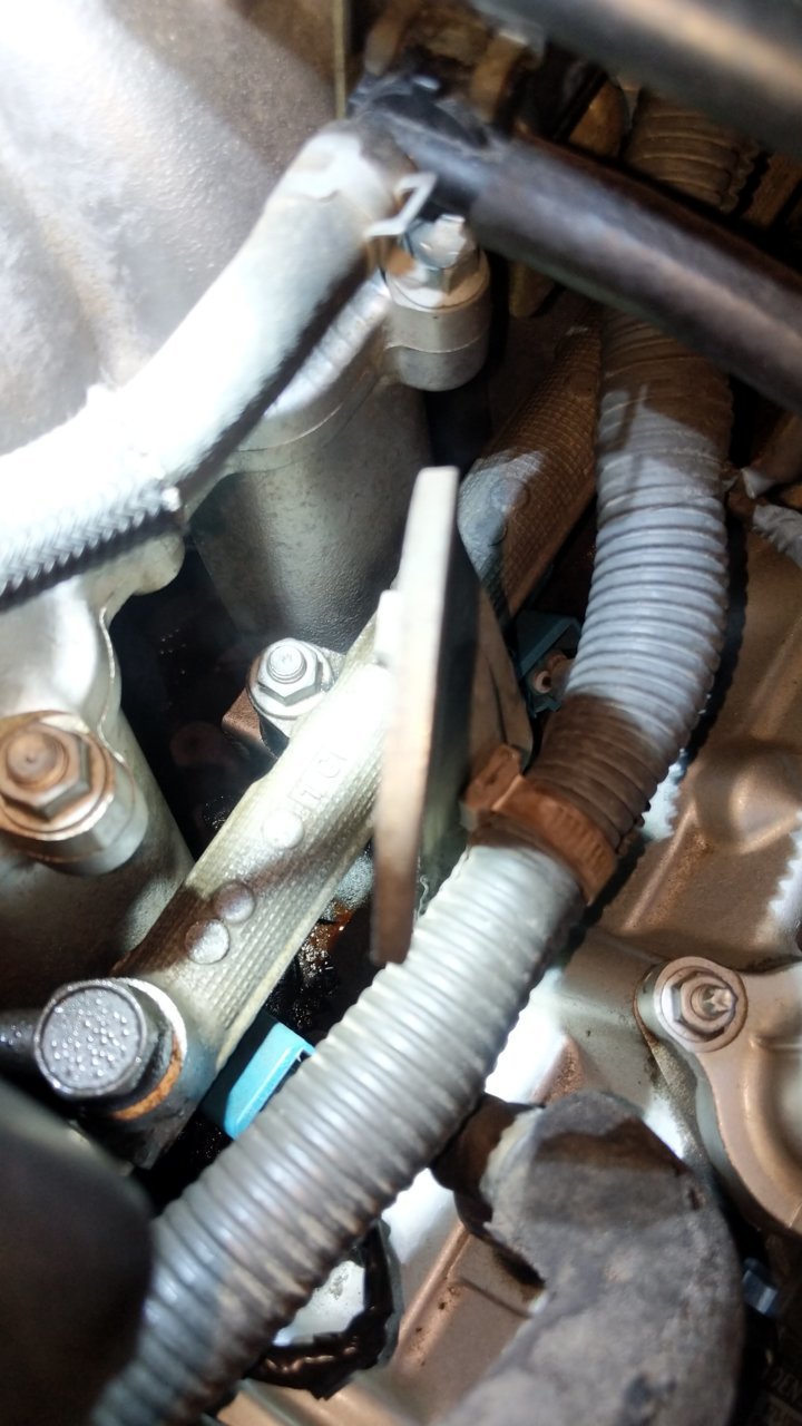

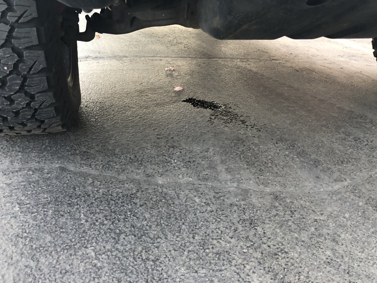

    GUYS.
    I think my engine's toast. After warming her up I heard a loud squeaking and saw the temperature gauge shoot up. There is red coolant leaking all over underneath the valve covers (and smoking up) which you can kinda see in the photos.
    Do you think it's a leaky head gasket? What are the chances head is cracked? I caught it quickly. While the first I can repair, I'm super assuming the worst.

    Could it be coming from one of the Throttle Body Hoses?

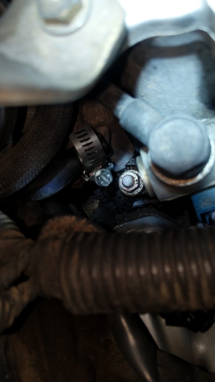

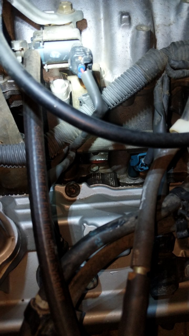

    The throttle body hoses seem to be connected.
    The one not shown under the body is connected.

    What did you replace recently. Coolant runs through the intake manifold in the back and front and may leak. I’ve also seen the heater hose tube leak too if someone bumped it to hard

    New timing belt, water pump, and stuff a year ago, valve cover gaskets, radiator, spark plugs, and throttle body gasket a few months ago. The coolant seems pretty high up on the engine to be any of the lower heater hoses.

    Maybe your new Throttle Body Gasket. Try snugging her down a bit?

    Throttle body is tight. Took off the skid plate and all hoses I can see seem to be fine

    Tomorrow I'm going to remove the intake manifold and confirm whether or not it's the head gasket for sure. Either way, I'll probably be looking at selling the truck. I'm glad y'all have pristine beasts but I've had an endless score of problems and hurdles with mine.

    doubt you'll find a head gasket issue. for it to leak like that someone either had the heads off and damaged something, or your just seriously unlucky. heres to hoping its an easy fix
