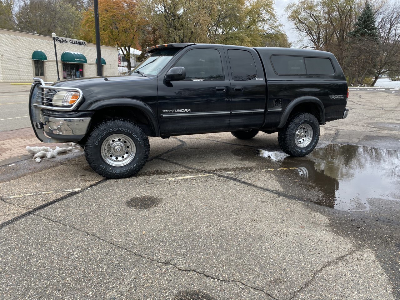

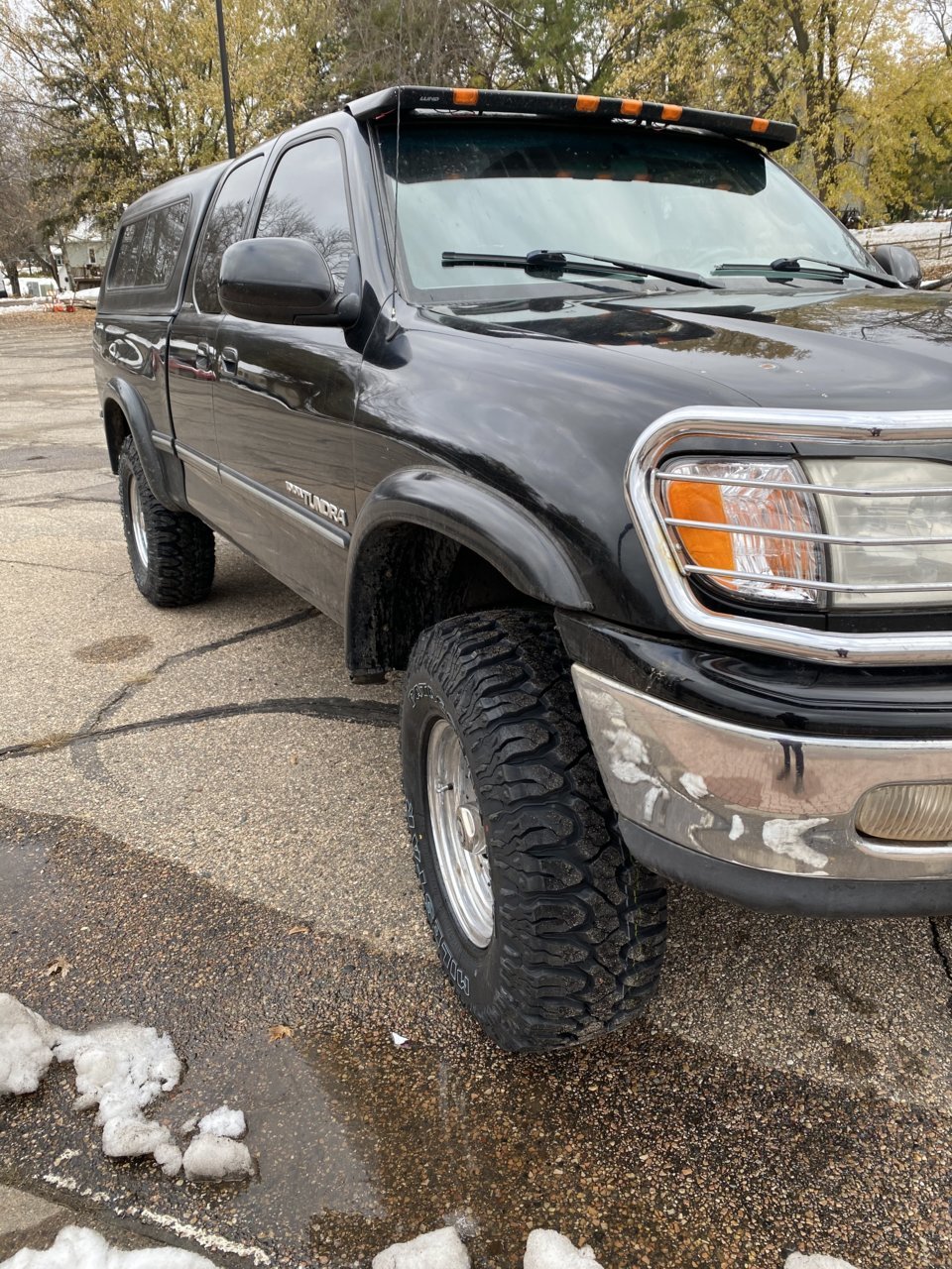

    2000 Tundra 4x4 "$1100 Build"
    3/2" lift, visor, 33s, eibach pro-truck, Cvj axles BFF Bumper 4.56 Tacoma Diffs
    new kicks!

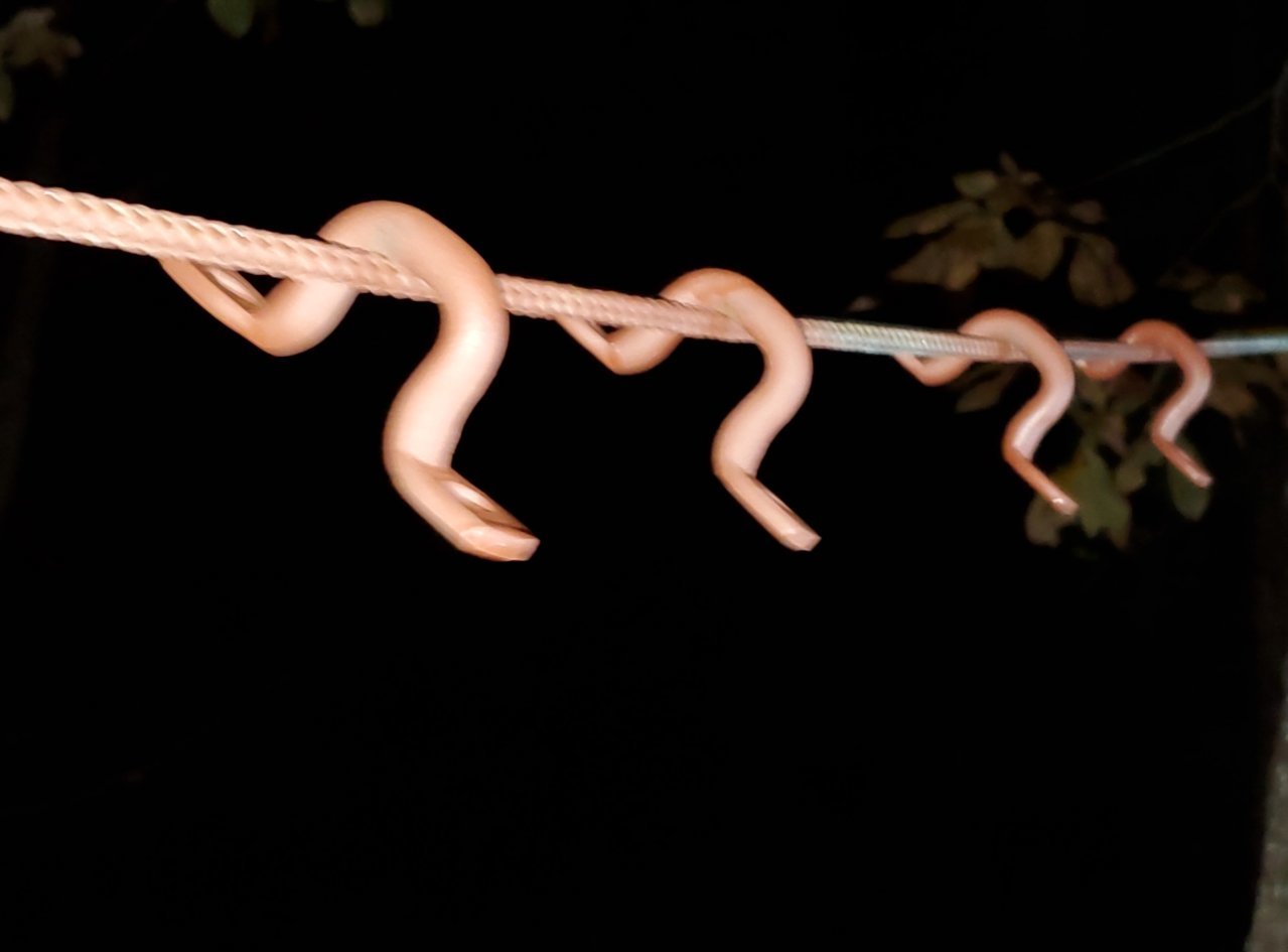

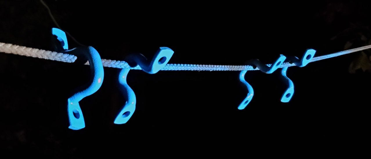

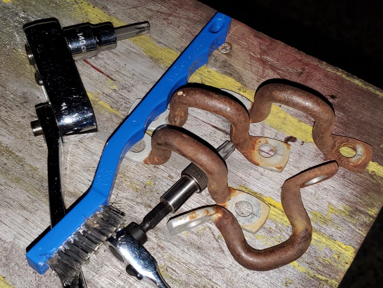

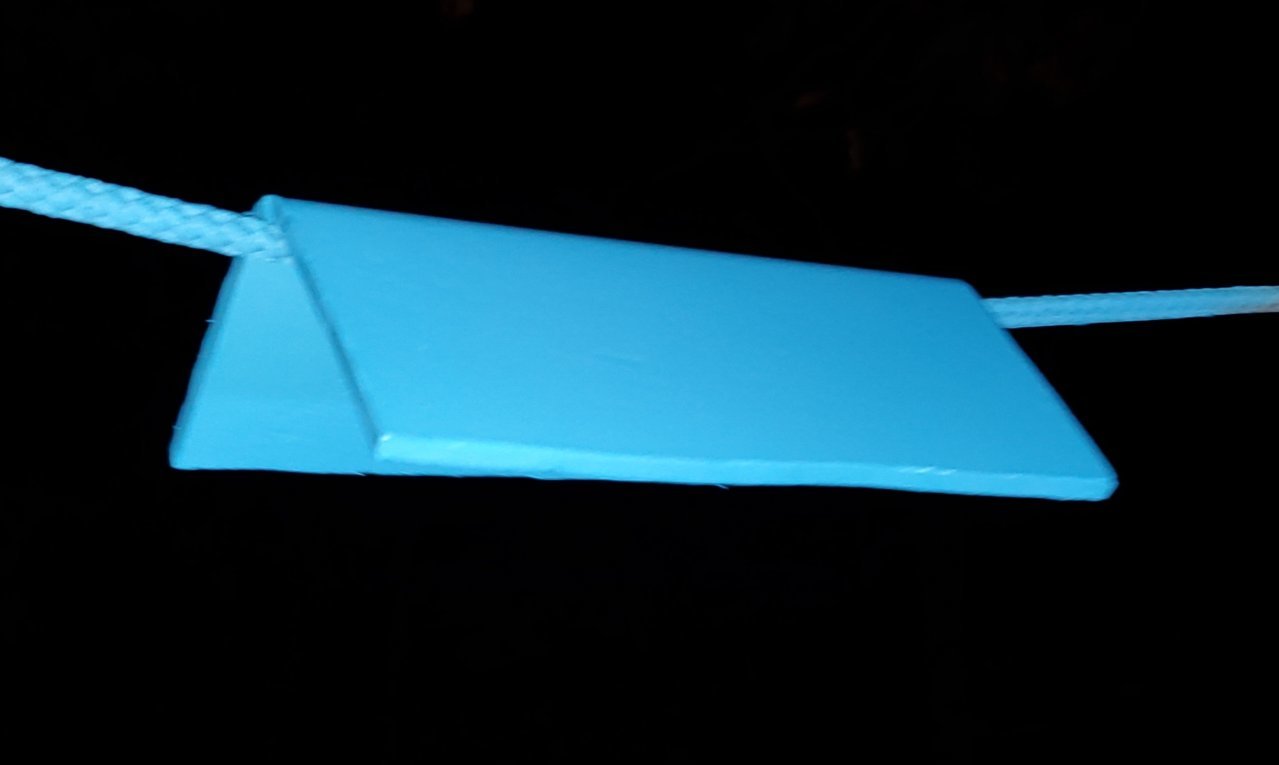

    Adjusted headlights
    Adjusted fogs
    Cut 3×3 square tube into angle iron for wheel well mount.
    Primed, and painted.
    Removed bed hooks, brushed...
    primed...
    painted.
    I wanted to do more, but I was being "too loud." Perks of being a vampire :D

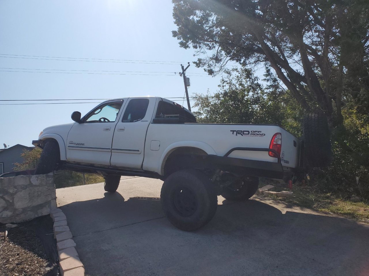

    Did your reverse into that flex.........if ya ain’t cheatin, you ain’t tryin!

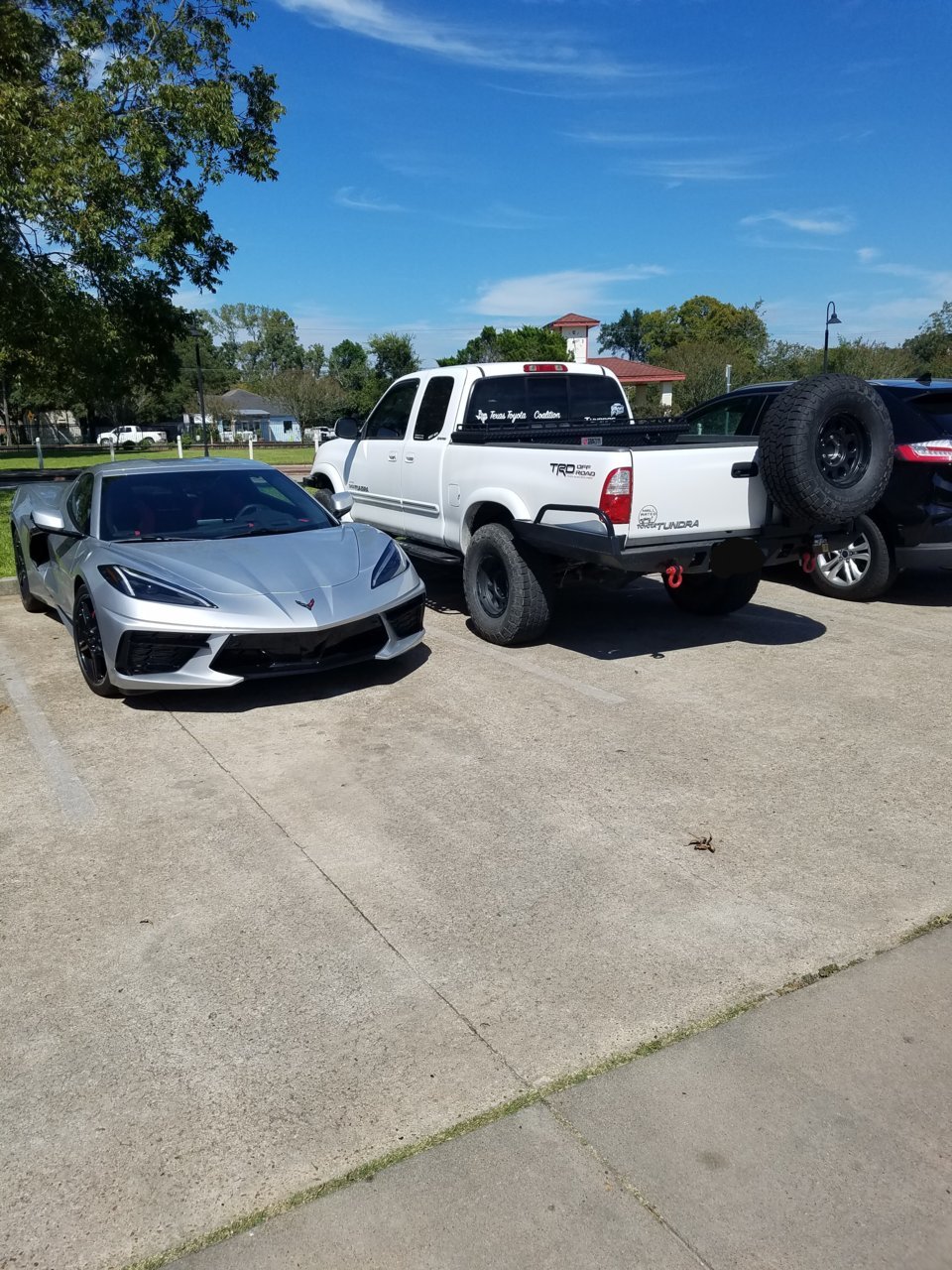

    What rear bumper is that?

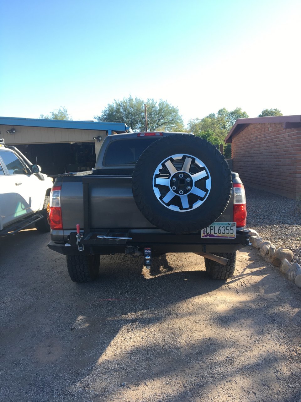

    Looking good. Is that the coastal off road or custom?

    It’s the coastal, I don’t know if you were here YET, but it had some weird fitment issues starting at the main base plate, I made it work with little help from coastal. I then decided to make my own swing out based on their helpfulness.

    I really need to do this pretty badly. I think I might hit mine with some rustoleum hammered-finish though, or Rust Bullet, it's like POR-15 but silver. Don't want to pull mine til I figure out what's going on it first.

    @TomGreen and @FrenchToasty those bumper looks good, I want something along that lines. Just not completely sold on tire carrier for my truck

    Yeah to be honest the tire carrier is a Lil much, I went full retard I on that build.

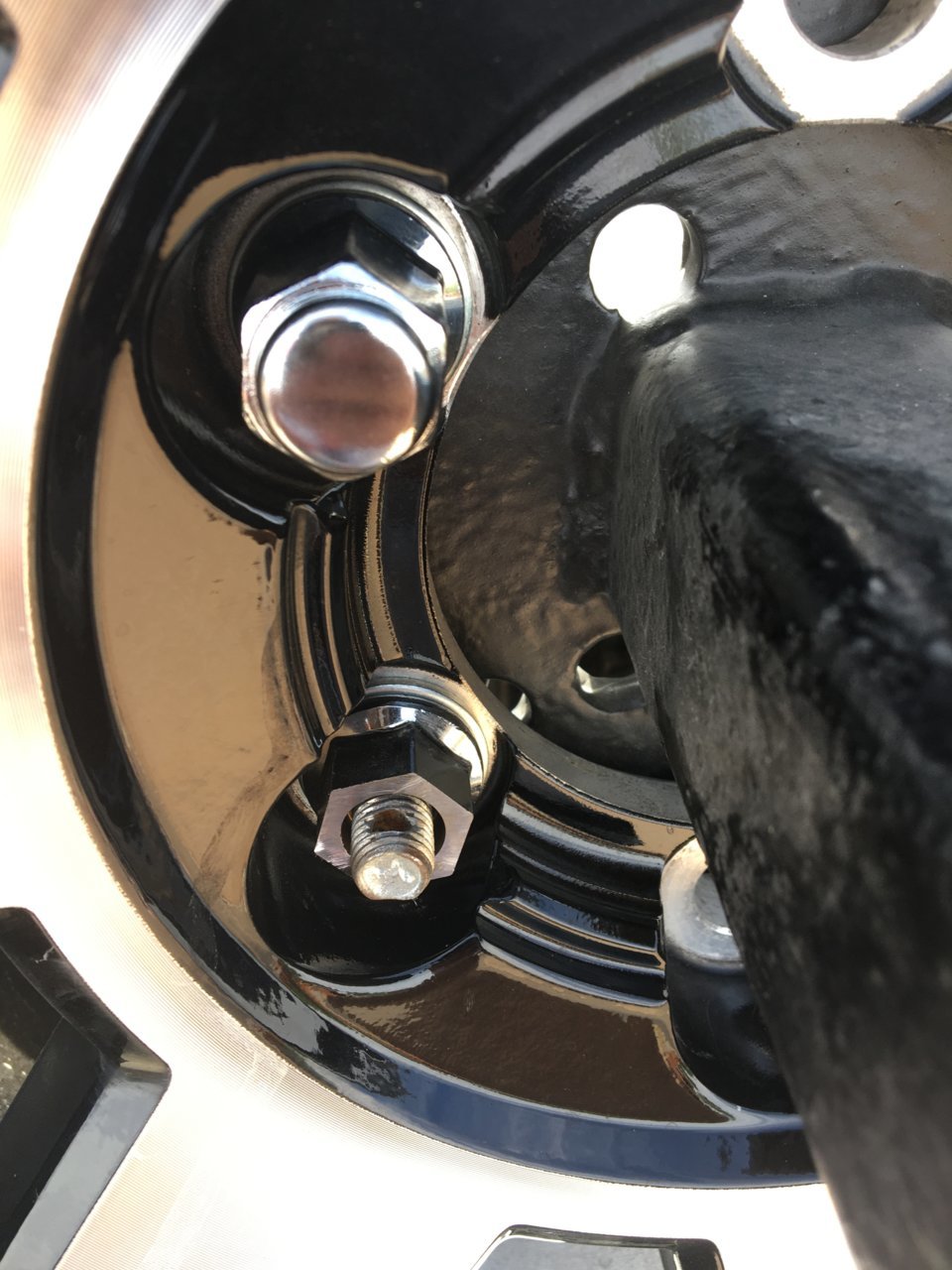

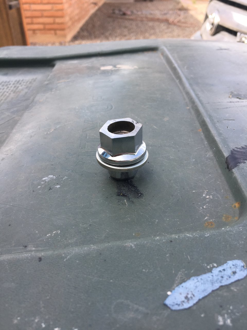

    5C6A7182-9129-434D-92CD-D3372CF822D0.jpg Got my spare fully mounted with mag lugs, I was only going to get 4 lugs but then realized my aftermarket rims aren’t mags, so I’ve got two extra mag lugs in my glove box for when I do need the spare. Grinder cut thru the lug like butter, and no threads 3/4 of the way up the hex part of the lug so I didn’t need to chase any threads. I didn’t realize I could have gotten open faced mags meant for a car....... oh well
