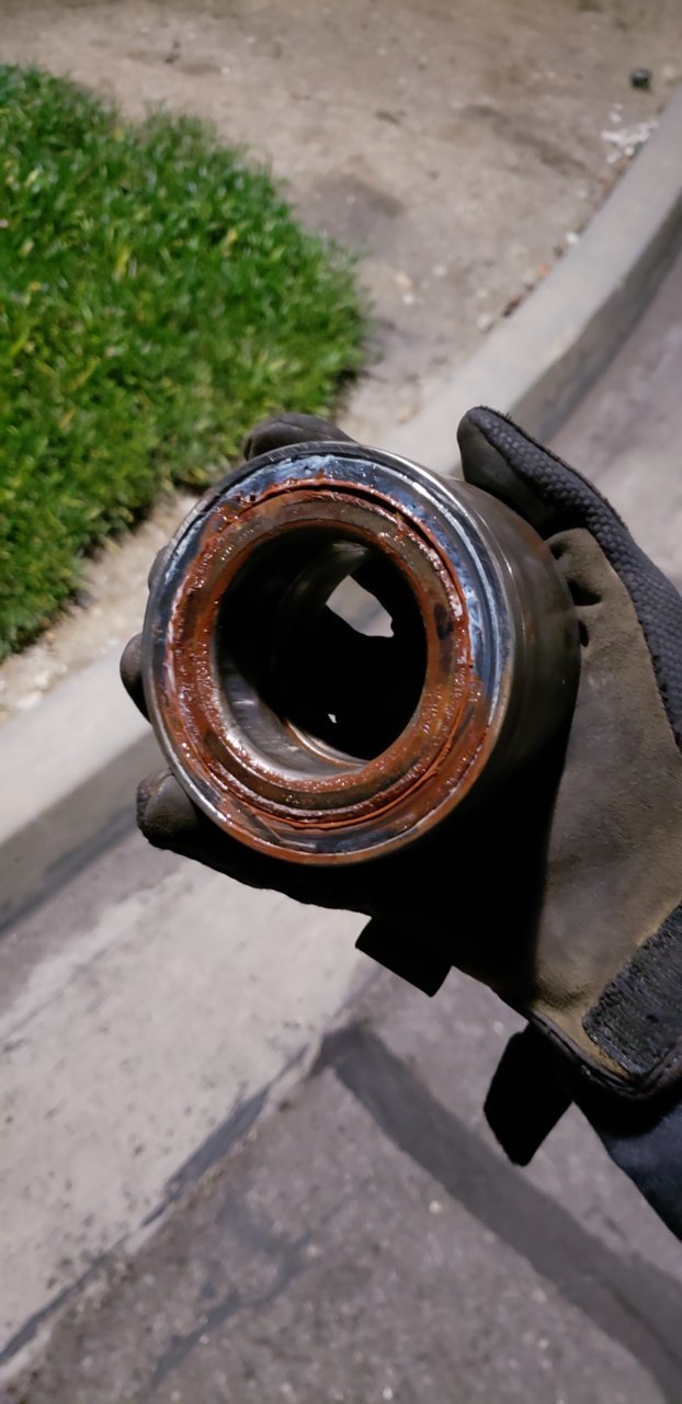

    Idk what the big deal is. Maybe it's harder for 4wd? I disconnected the sway bar and put a foot on the lower arm, no problems.
    Got some stuff in my trunk to install soon
    Old bearings were thrashed. ABS rings were fine but I put new ones in anyway.

    Holy Bearing :eek:

    Asked Toyota for a price on alignment cams and they were well over $200, that's just murder. Ordered up a set of SPC kits from Wheelers for $70, I can live with that. I'll let everybody know how they are after install.
  30. Dec 5, 2018 at 1:25 PM
    #2280
    Sunnier
    Aug 21, 2017
    #9171
    12,311
    Sunny
    San Diego, CA
    What part of the assembly are these, what do they do?
