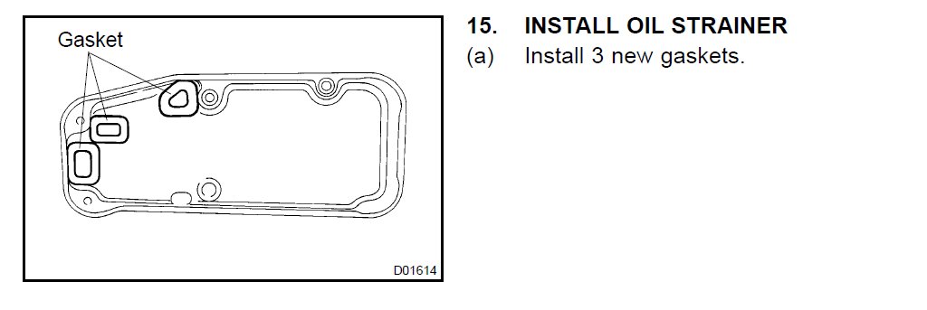

    @bmf4069 and @lsaami did you have to buy 3 gaskets for the filter as well? Or do they come with it?

    Depending on which brand filter you buy, they usually come with them.

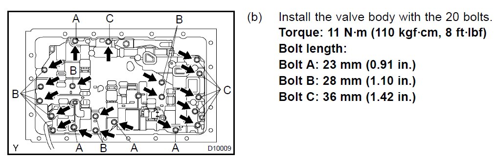

    Found it, 96 inch lbs.
    Given my propensity to break things, I think I'm going to pass. :D Especially since the bolts are different lengths. Seems like a PITA.

    The one I got had them in place already.

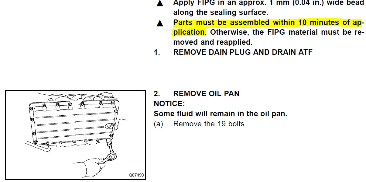

    How did you fix that? I just went out and removed all 19 bolts for the pan and removed the bolt that holds the dipstick tube. Now I just wait for the new parts to arrive.

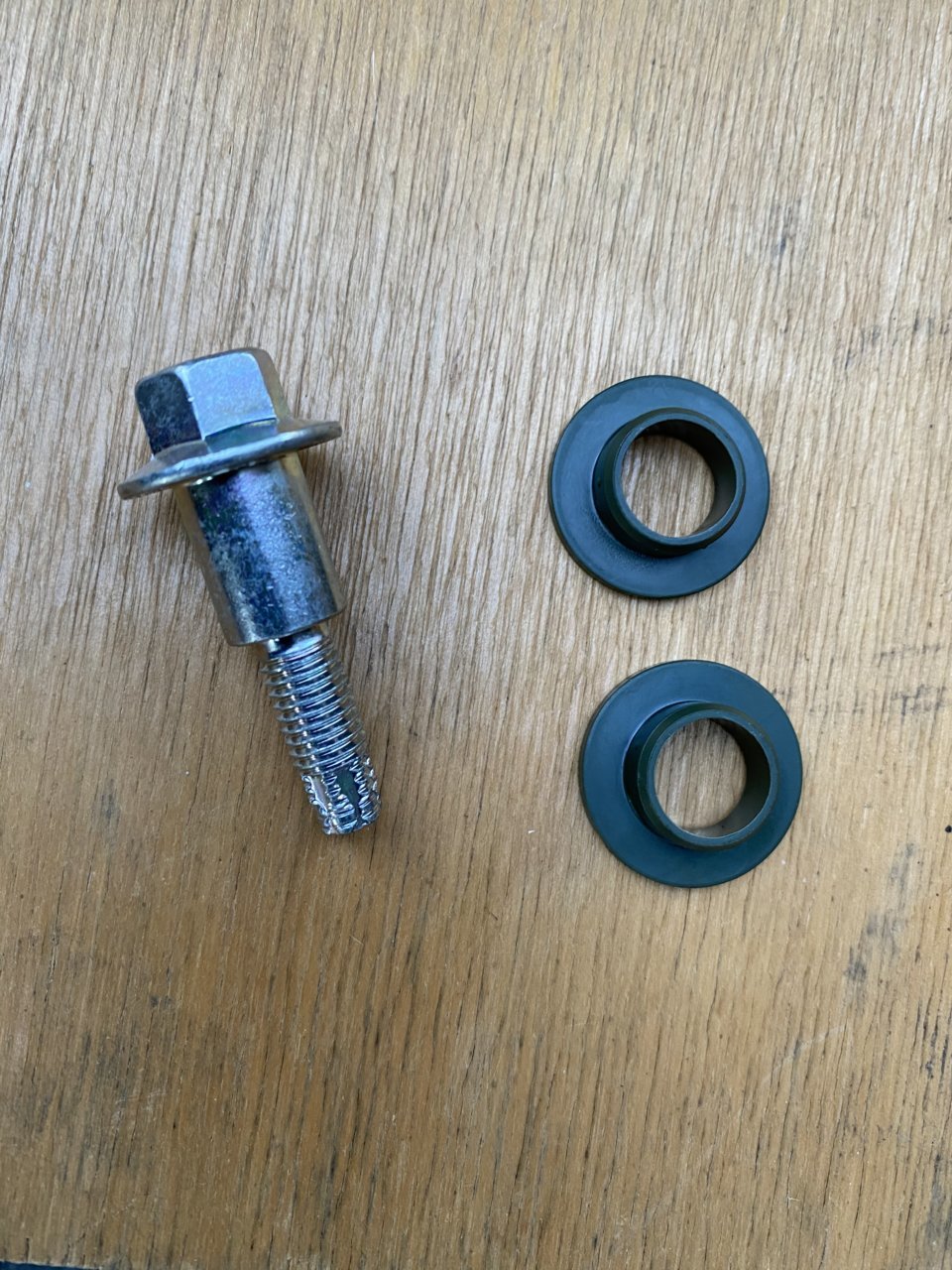

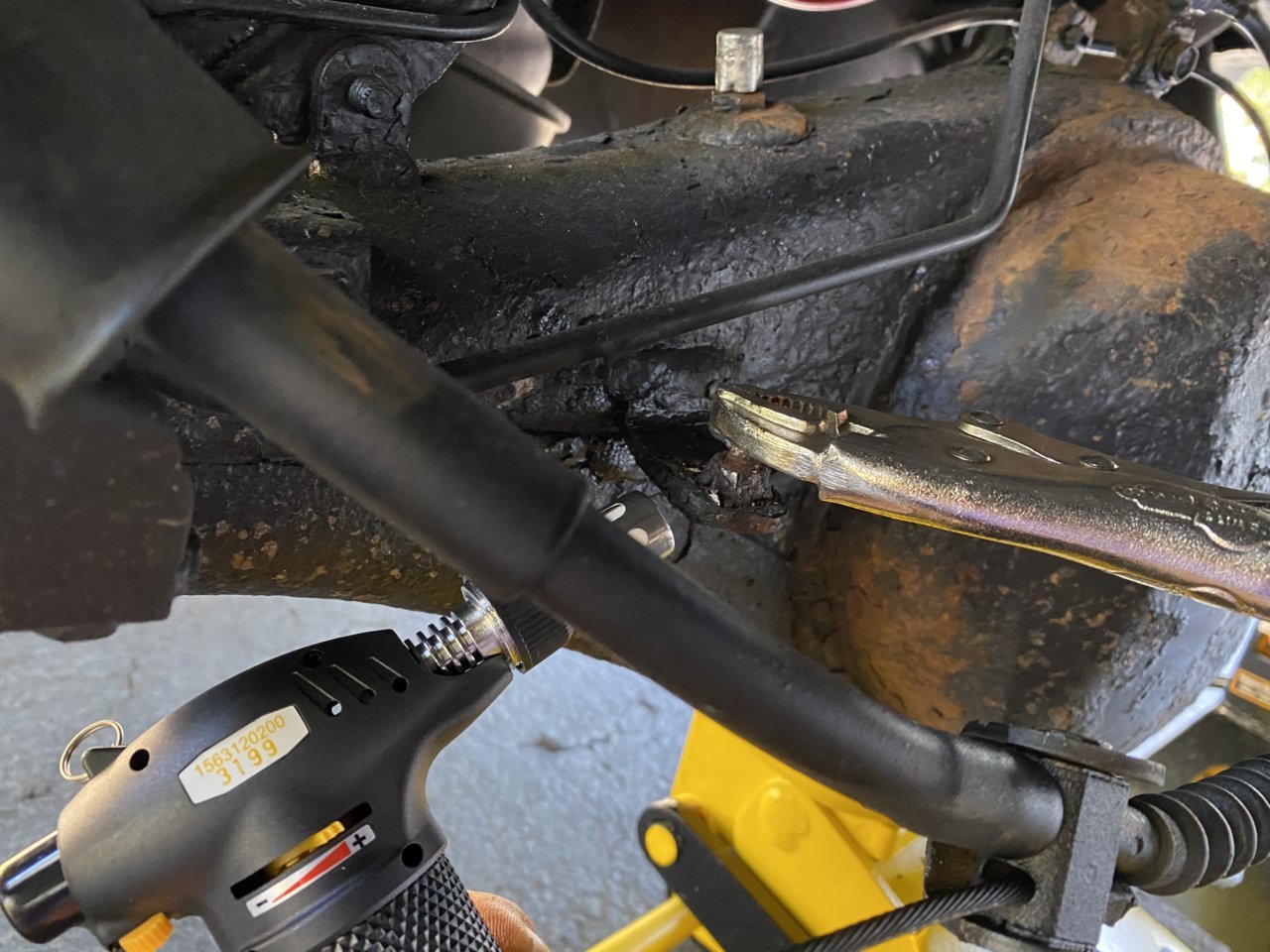

    Wooooot! I managed to get the broken stud out. As a contingency, I ordered a die and tap set.
    there was enough meat on the stud for a vice grip. needed to heat the bolt and stud twice before I could start wiggling the stud.
    Got the replacement today.
    So happy I didn’t have to drill it out!!!!
