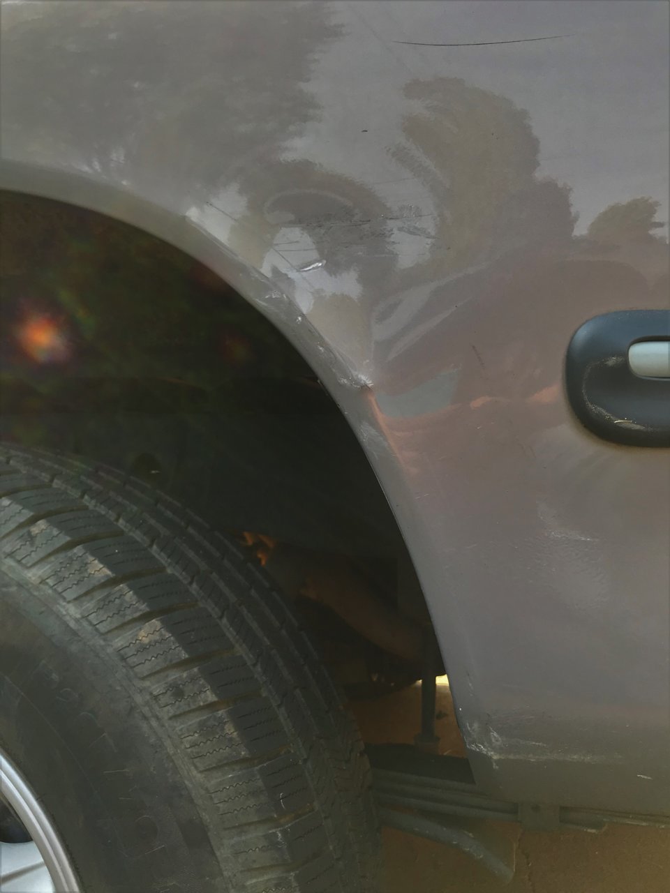

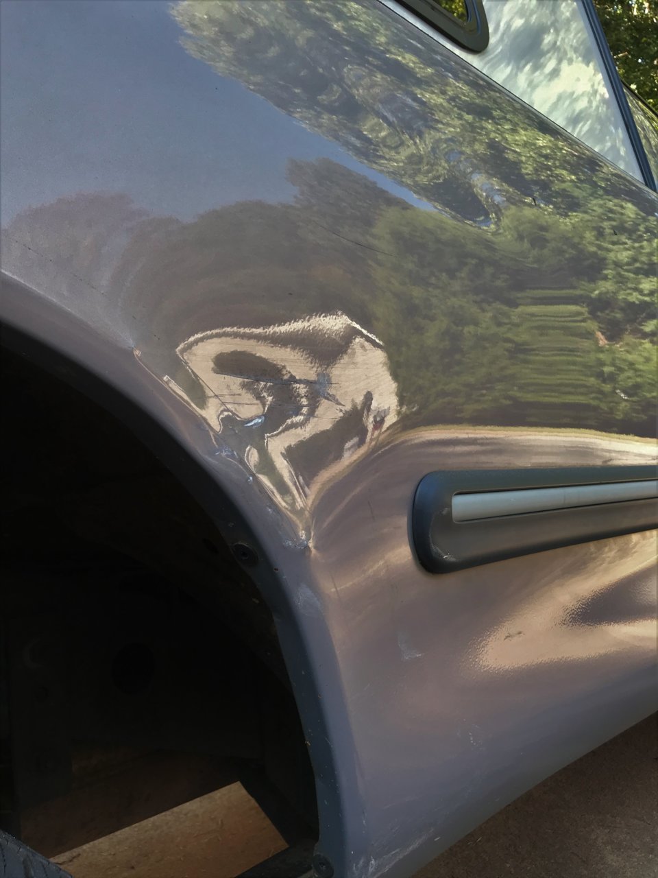

    A few years back a lady who was high on meds turned into me while I was going through an intersection at 40mph. She hit my rear drivers wheel perfectly and spun me out. Her insurance covered the repairs, but I needed a new flare, wheel, tire, and leaf springs. The axle was fine and I didn't suffer any other damages.
    chrisb, bmf4069, artsr2002 and 3 others like this.

    These are tough trucks, and I am glad you were able to have your Tundra repaired.
    I drove mine to the gas station this evening, and after eyeballing it on level ground from various angles I am almost certain there is no hidden damage... both the bed & leaf springs look fine. It will require body work and paint, but I don't know how they will match 18 year old weathered paint to my satisfaction without painting the entire truck.

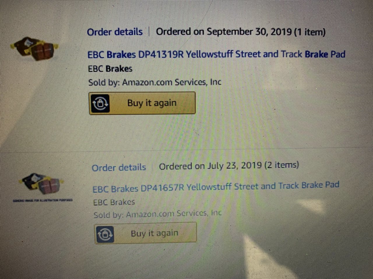

    I have a serious time constraint... can’t do this at home or at Bruce’s in time for my trip, and my mechanic is a safety-first kinda guy (which I like in a mechanic)— not gonna get him to shave off 3.0mm of anything. :ballchain:
    I did read it though, just would have to do that Big Brake upgrade ourselves and no time now to work out the details.
    __________
    It occurs to me: I should bring y’all up to date on my considerations, because it’s different from both the “big brake” and the “Big Brake” options. So it may be no go UNLESS the fitment can match the 13WL or 13WG component sizes.
    A recommendation (considered due to time restraints) from a knowledgable off-road race mechanic (who may/ may not know about the 13WL and 13WG upgrade options for my 2002 Tundra— I’ll tell him tomorrow and see how his recommendation jibes) was to “upgrade” to this:
    https://www.summitracing.com/parts/pwr-kc2323/all/year/2002/make/toyota/model/tundra
    I’d like to keep using the yellow race pads Bruce put on Hulk last year, instead of the pads on this set shown above... so I need to be able to compare the component sizes (not shown in the info linked above) with the components currently on Hulk (I’ll verify tomorrow if those are 13WL or 13WG), to make sure the new set is the same size... and get the right sized yellow pads.
    Short version alternative: if the set linked above isn’t similar on size to 13WL or 13WG, I’ll maybe skip it. Or I’ll try to find a set like that linked above, but for an 04 Tundra, based on the info Luis posted above.
    All additional suggestions, feedback, tips appreciated. @Darkness @Professional Hand Model
    Edit: the yellow brake pads we like (top of two pictured):DAD586D5-0F23-48A2-9B11-4024F3B0A2D7.jpg
