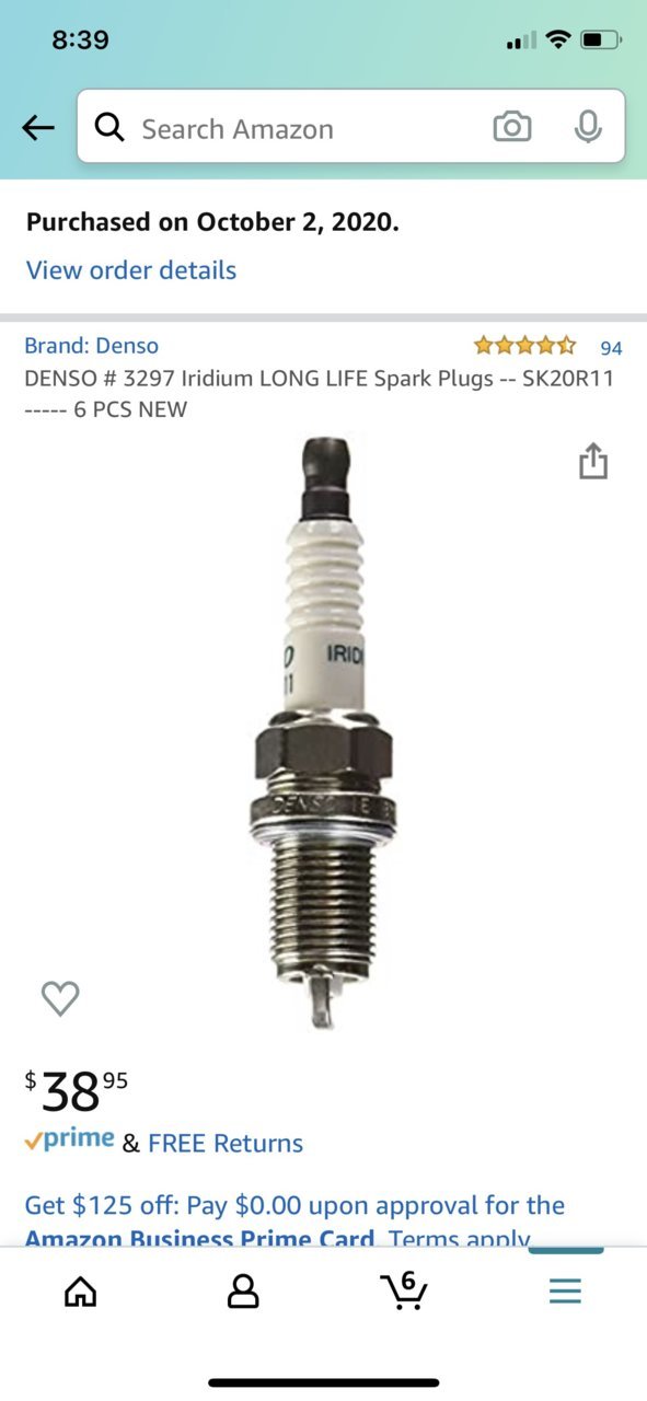

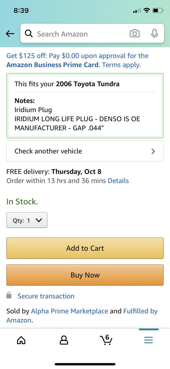

    Here is the listing. Although from what I understand, Amazon batch warehouses so maybe this seller drop shipped legit stuff but the warehouse sent out bunk product.

    Post a picture of the fire-end of the plug. It'll be easy to tell if it's counterfeit or not.
    If it is, file a report of seller violation, but don't use the word "fake" in your report. Instructions: https://sellercentral.amazon.com/gp...guage=en-US&ref=mpbc_200414340_cont_200444420
    Specifically, it's a seller violation of this policy: https://sellercentral.amazon.com/gp/help/external/201165970

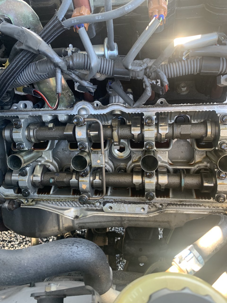

    176,000 miles and she looks brand new. Thanks to routine maintenance. Changing the valve cover gaskets. I think the bolts were just loose, but might as well change the gaskets now.469053CA-AEC9-405B-BF1B-DC56B4A6EC3A.jpg

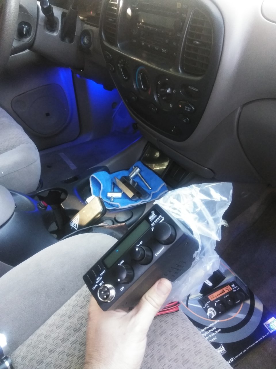

    Hopefully this weekend find a place to put this

    "Breaker, breaker... what's your 10-20?"
    Boy, I haven't tinkered with that since the late 70's. That was the AIM chat of the day.
    Does anyone use them anymore? Nowadays, I use Waze for others reporting the 10-20 of Smokey(s).

    Will it fit in the place of the cubby just in front of the blue cloth in your pic? That pocket should just pop out.

    It's about the size of a single din headunit. I vote upgrade your factory stereo to a single din and install it right below your new radio :)

    Rear air duct runs there.
    I’ve actually seen someone remove their pull out cup holders and fab something for it there.

    Back up camera is in that spot.
    I was thinking maybe the cup holder next to the ashtray..

    What oil have you been using? Looks clean in there.

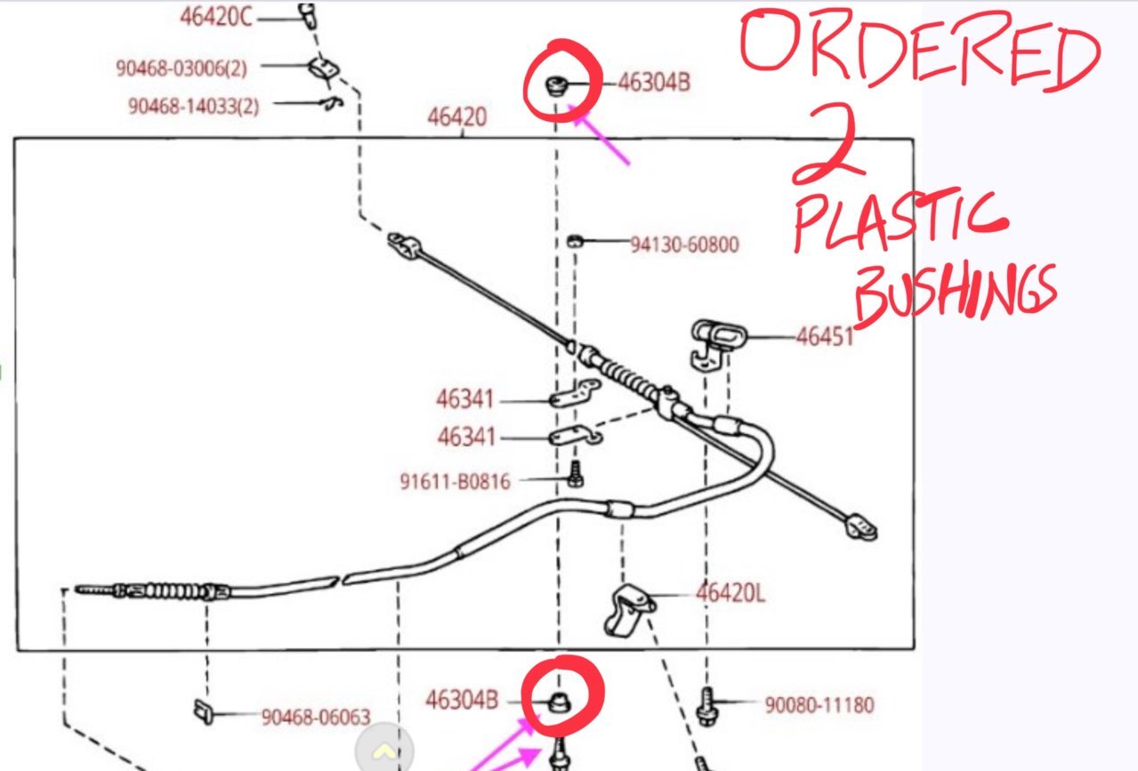

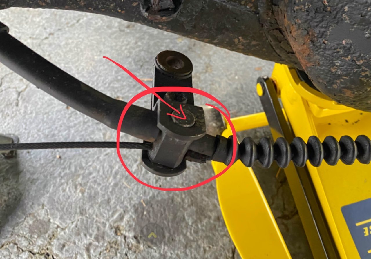

    I checked that bolt/bushing on my truck today and discovered the bottom bushing lip was disintegrating. Bolt came off without snapping like yours did. Also discovered that Pin Lever (circled) adjacent to the bolt was seized. Didn’t realize it was suppose to also swivel until feeling the Mojo. Ended up penetrating spraying and lubing the pin until the orange bled out. Made a make shift washer to accommodate until two new bushings arrive.
    The parking brake action is better now. Maybe this explains why with all the adjustments for the better that the pass wheel of the rear still needed a manual adjustment at the star hole 3-5 clicks.

    Adds a whole new meaning to the missing link! Glad that works out for you.
    I can’t believe your previous $tealer visits never completely solved it.
