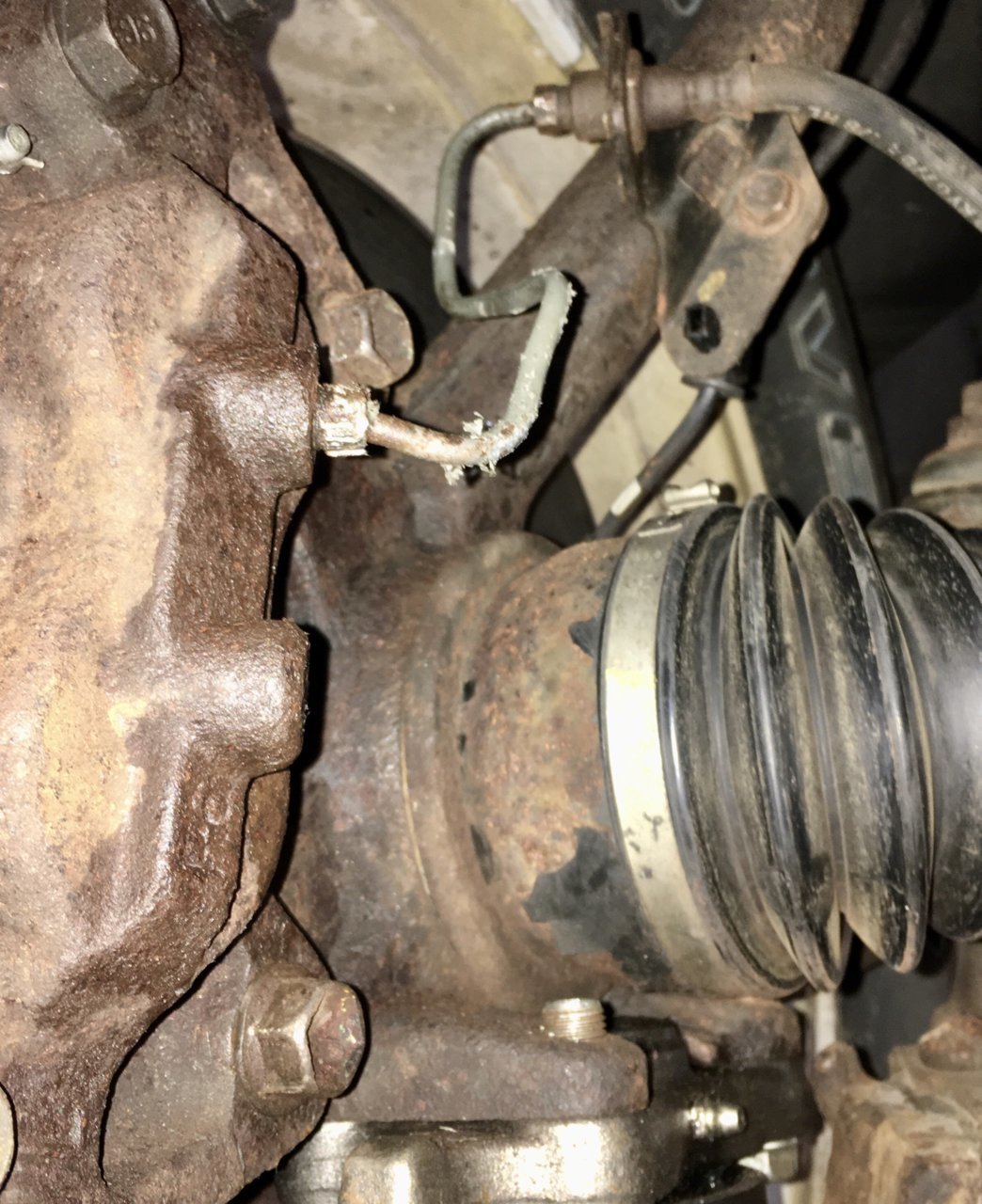

    “Today,” I :censored: a brake line fitting.

    Easy peasy to replace... I just did this over last weekend. Lemme look up the part, that's the passenger side front, correct?

    Easy to replace....once he gets it out of that caliper. He's gonna need heat, kroil, and a prayer.

    473150C020
    Thanks! Ordered one already! It really helps if you use the right tool, right? :lol:

    Cut the line at the fitting (clamp the rubber like to prevent leakage) and they come right out with an impact 90% of the time. The one on the flexible line you need to be a bit more careful but also usually comes off easily with an impact if you grab hold of the metal to keep it from spinning

    I was tempted to cut it off multiple times
    Eventually got it out with liquid wrench and a good grip with my vice grips

    Would you clamp high performance SS braided hoses?

    Oh... well if their stainless no. Rubber yes. Stainless the best bet is having the brake pedal pinned to the floor and nothing will dribble out

    Hmm, I would think the fluid would come blasting out if you push the pedal all the way down. How does that work?

    You pop the bleeder. Get a stick or something and hold the pedal to the floor. Fluid will come out when you hit it so use a hose to direct it. Then just leave the pedal to the floor. It will not allow more fluid to dribble out of the lines. This is actually how Toyota tells us to do it.
