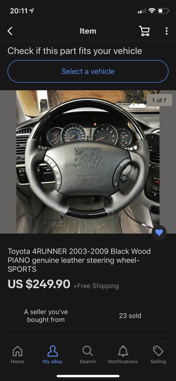

    Hey @empty_lord question for you. It would be easier for me to use the 2003-2009 4Runner steering wheel instead of this 2nd gen tundra wheel right? My airbag would match up as well as the 4Runner would use the same steering wheel controls so there would be no having to figure out the wiring.

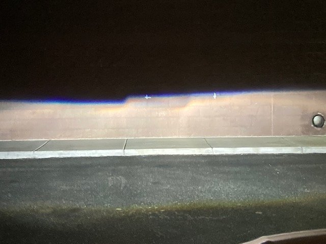

    I am working on adjusting my new eyes:
    Anyone considering LEDs, just skip it and go with HID retro fit. I highly recommend @SouthPaw s kit.
    With LEDs in the city with oncoming traffic, it seemed as if I didn't even have my headlights on. Now, I gots light and the high beams are ridiculous! The beam pattern is so nice compared to the LEDs. Halo's connected to my repurposed dash switch too.

    yup, i have a 2008 4runner wheel in my tundra.

    Done. I’m going to that one instead then. Hope it doesn’t look too terrible with my tan controls and airbag

    you have the 2nd gen tundra wheel frame right?

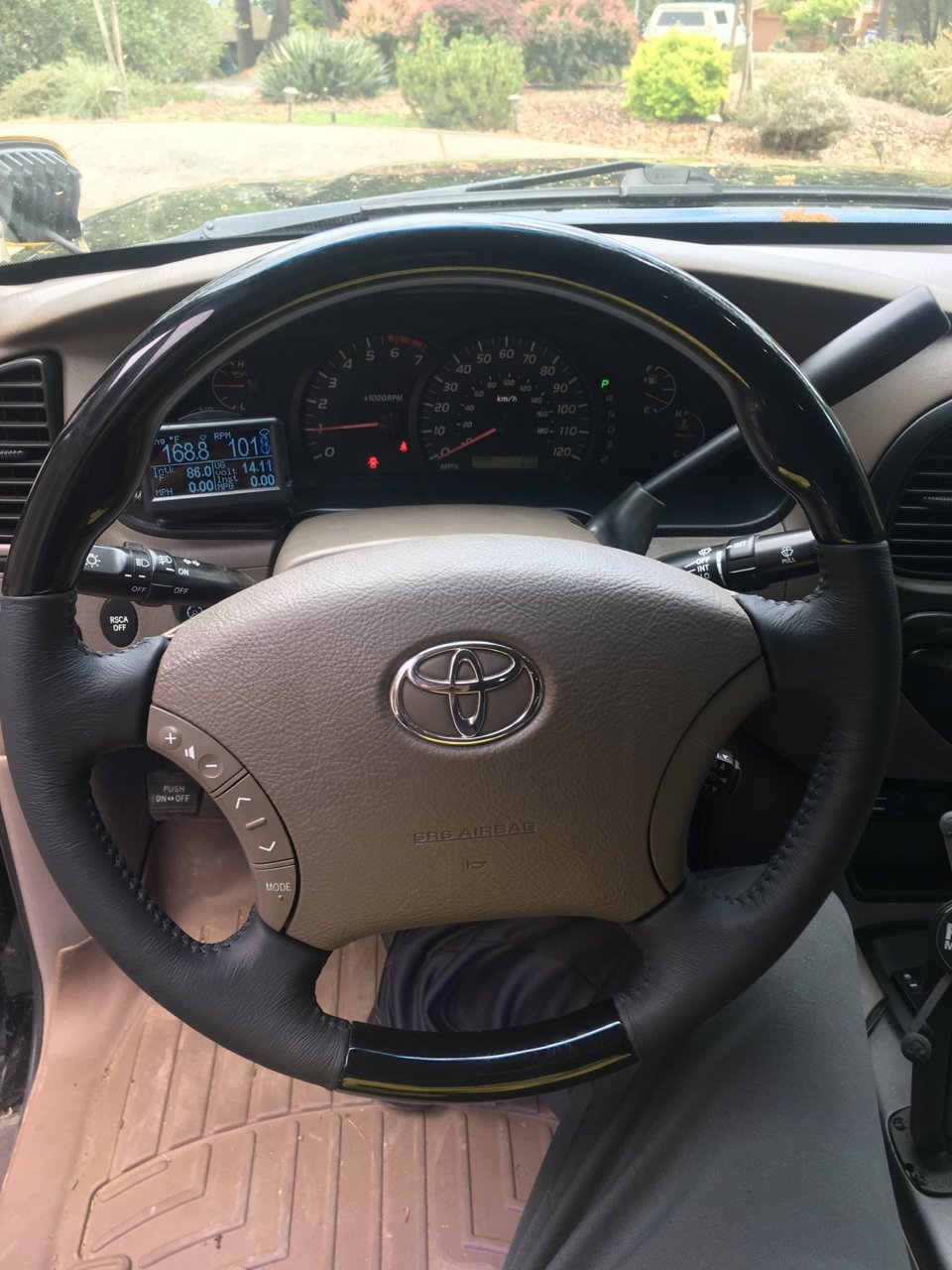

    This will give you an idea:

    Correct. I’m gonna send it back unless you wanna buy it?

    Awesome thanks. That’s exactly how it will look.

    Curious, do the right-hand controls for phone audio work? It looks like they just attach via ribbon cable to the left-hand radio controls when the airbag assembly is off so I was really curious if our truck had the correct wiring in place (passing thru the clock spring) to support the extra buttons or not.

    Yes. Its plug and play

    Adding to the list. I noticed there are a few different versions of that control, used for 4Runner, Camry, and others.
    What year 4Runner is that from again? I probably should be looking for that too, instead of just Tundra and Sequoia.
    Edit: Looks like the part# in dark grey for that button is 84244-35030-B0 (But I think it's orange/amber backlit). I can't seem to find the p/n for the cable to connect it to the left-hand control, though! (found it: 84204-58010)

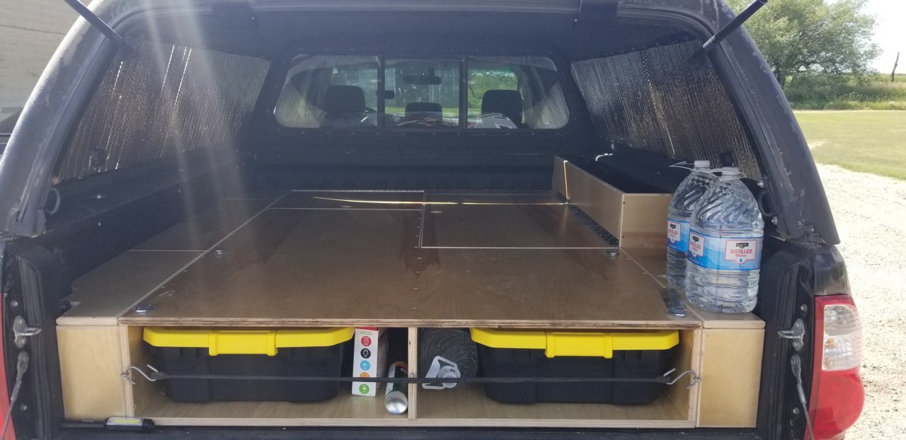

    Overlander bed platform almost complete. Now I have to wire in lights and inverter. Next up is prinsu style rack for the solar panel and other goodies.
    I weighed all components before installing and comes to a grand total of 138lbs

    The Camry setup is for a clock on the right side. So it won’t work. The 4runner and 2nd gen Tacoma black (dark grey) will work. The led color is amber mind you. Super rare and expensive, siennas had the FAWN color voice command and what not switches for the wheel on the right

    That's the one thing I didn't consider. I don't even recall what color the LEDs are on my current controls. I just bought a replacement left control a couple months ago because mine are worn just about smooth.
    So you're saying the 4R and Taco both have amber voice control buttons, or just the Taco?
    Sorry for the bajillion questions. Thanks for taking the time.

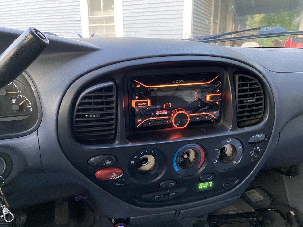

    Spent a bunch of time tweaking the new head unit today. It sounds great. Now I just need a sub to round it out.

    Both. the leds can be replaced with some soldering
