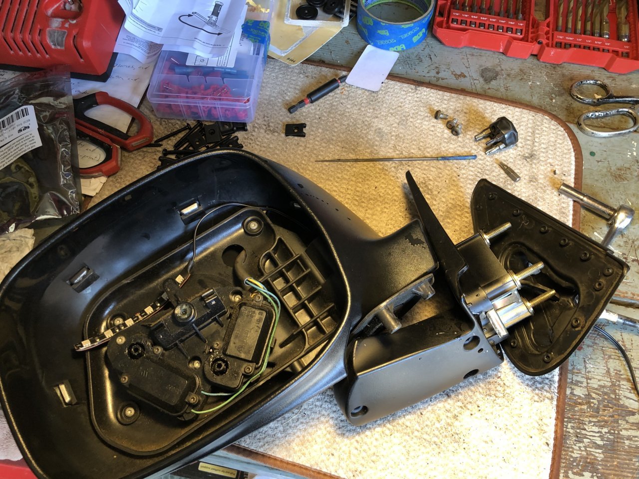

    Is it possible to tighten up the mirrors on our trucks? My driver's side one is getting pretty wobbly in normal driving conditions.

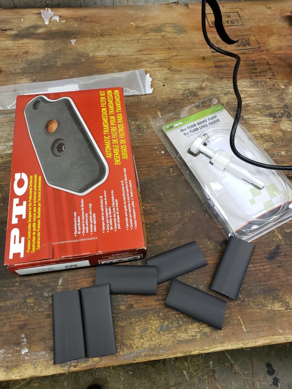

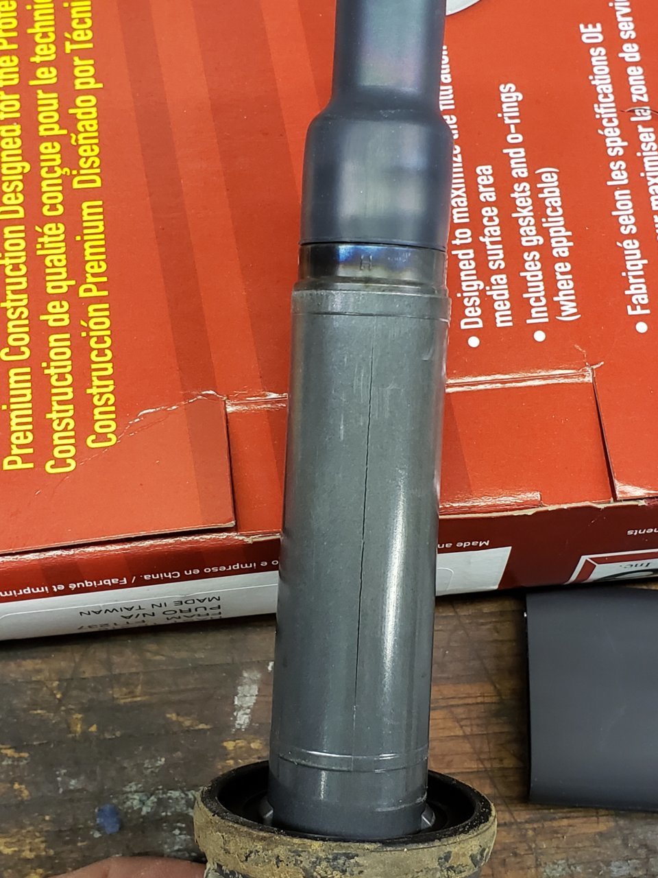

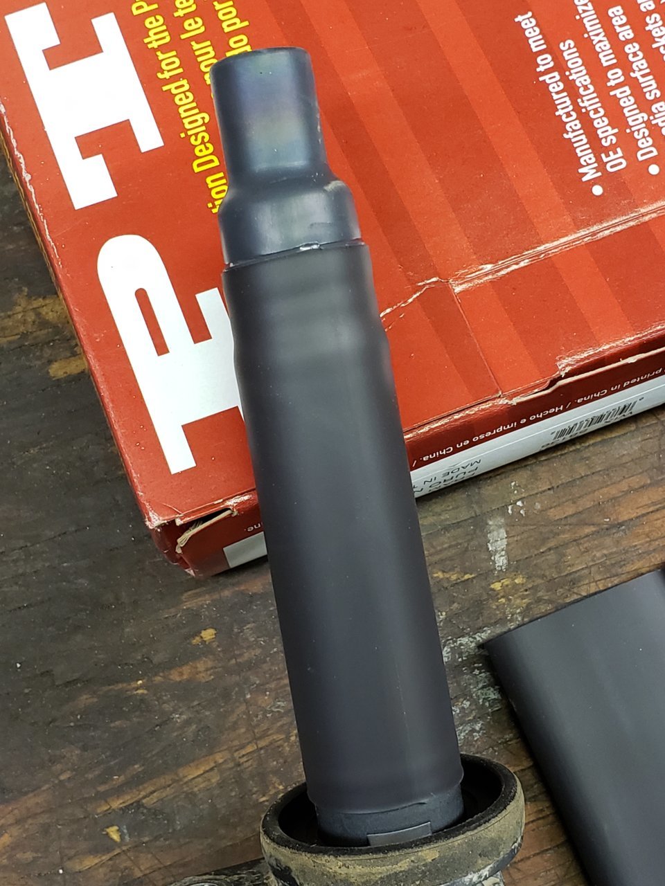

    Quick tip/write up
    I tackled the cracks on my coils with a write-up I saw from a while back. Apparently you can heat shrink the coils and it will keep all the electricities inside better.
    I also quickly learned that the heat shrink makes the coil diameter too large and the wrapped coils will not fit back into the engine no matter how much you spit on it.
    Long story short, don't even bother trying to do this fix. It won't work. Maybe I can smear some JB weld on the cracks, but that can be for the future when I'm in the mood again. Lol

    Yes. I’ll draw up a fix. You must remove the mirror to tighten the 3rd and most important one. To access the mirror removal posts/bolts you must remove the entire door panel.
    Fun stuff the first time, but you’ll remove the two Torx screws at the door handle, the one screw at the pull lever, and two screws behind the little cover things that need popping off first. Once those screws are off then its a matter of prying the bottom corners up and softly get your fingers under and pop the plastic plug inserts off one at a time with leverage. They are about every 10inches along the sides and bottom. The top is hooked on with a metal bracket and lifts off once the plastic plugs are popped.
    Now you’ll need to disconnect the tweeter and courtesy lights wires/connectors. I forgot to tell you to remove the door lock/window up/down first by using a push under to depress the spring clip. Do that first before removing the panel as its harder to do it after the panel pop off. No other easy way to remove the tweeter/courtesy connectors until the panel is swinging in your one hand and you are balancing the other tasks with your other hand.

    I see your a scissor man! I’ve got the same milwaiki ones, and a few pairs of the old steel ones like you’ve got too.

    Yeah buddy. The Milwaukee's are real nice. Power and precision. I use the old metal ones for junk cuts.

    Nice try though. Seems like a good idea if the Coils are still in spec. I know those new Densos are $480 for 8 new ones, but better than them going out one at a time.

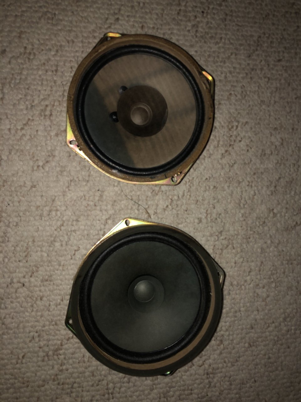

    Old OEM front vs rear speakers. These have pumped out a lot of tunes over the years as best as they could. They still sounded pretty good. Probably would have kept them if it were’t for the window track rattle repair which requires the speaker removal. Doing the LED Strip Signal was a cheap $8 bonus while in there and I got to tighten that 3rd Nut on the side mirror. I don’t ever want to go back in these panels for a long time!
    Chapter closed.

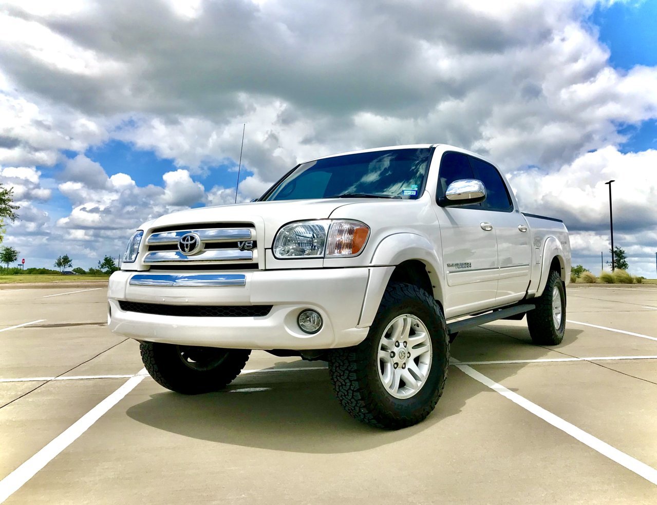

    Ran it over to a parking lot to shoot rockets with my kiddos. To keep mama happy, we used “safe” rockets using baking soda and vinegar - fail. Maybe 10 feet max of lift. We tried, time to get engines and igniters involved :)

    Great picture!
