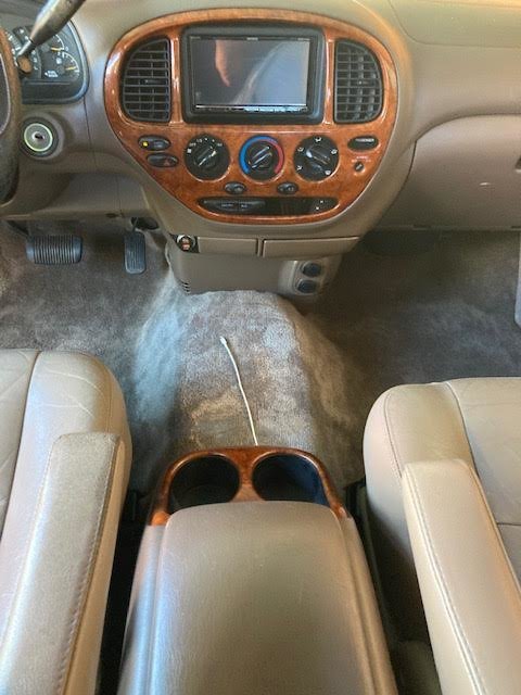

    And the interior after reinstall and running the vacuum I don't know how many times:
    I am not happy with the phone cord. I was originally thinking of drilling a hole in the center console and that would allow the phone to be placed inside, but I am not sure that is a good place either.
    Any suggestions?

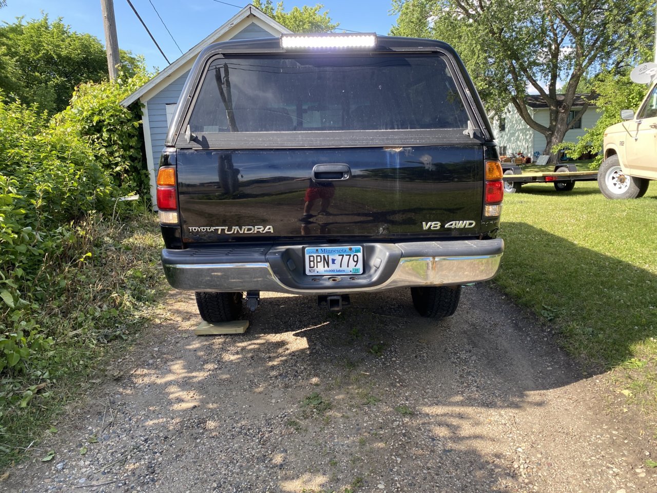

    Had some Fun! Got her all wired up to function in reverse, as well as by switch in the bed.

    That’s dangerous with your line of work no?

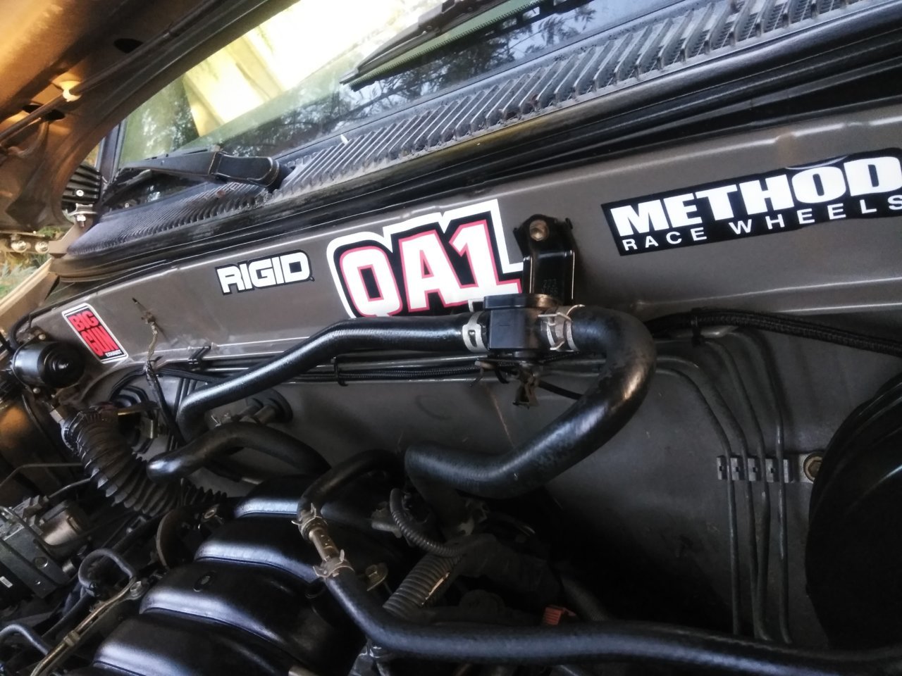

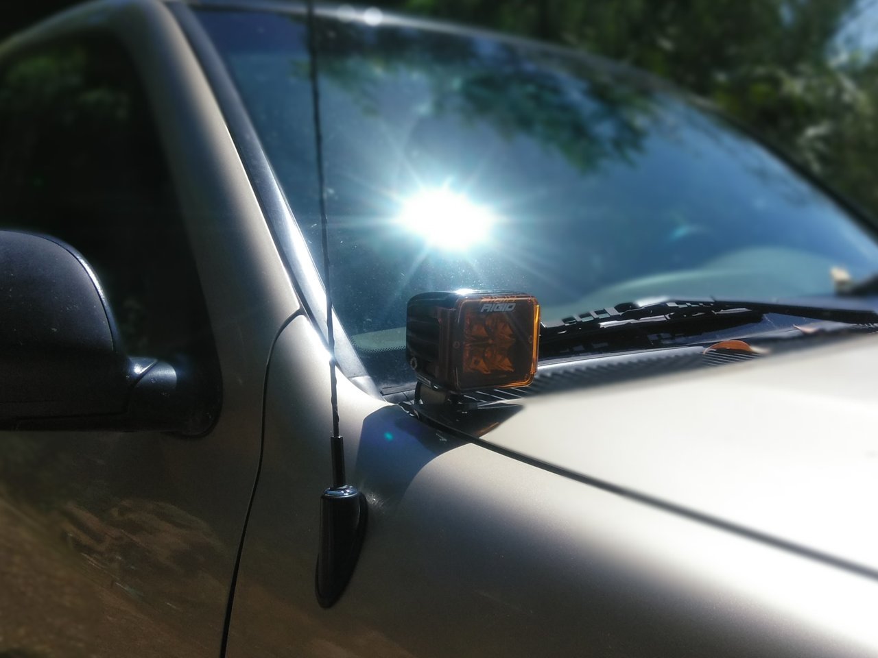

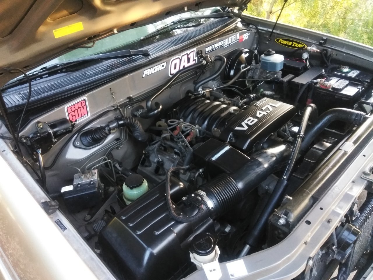

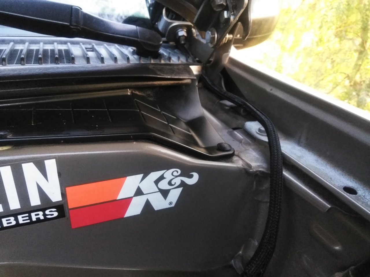

    Today I put sleeving on and rerouted my ditch light wires. The sleeving is what we use on all our MQ-9 Reapers and other drone wiring ...(good stuff). Changed the oil (factory filter, Mobile+1 Synthetic). Cleaned the K&N stuck it back in dry. Also drained about 3Qts from the trans and replaced it with Factory WS trans fluid...

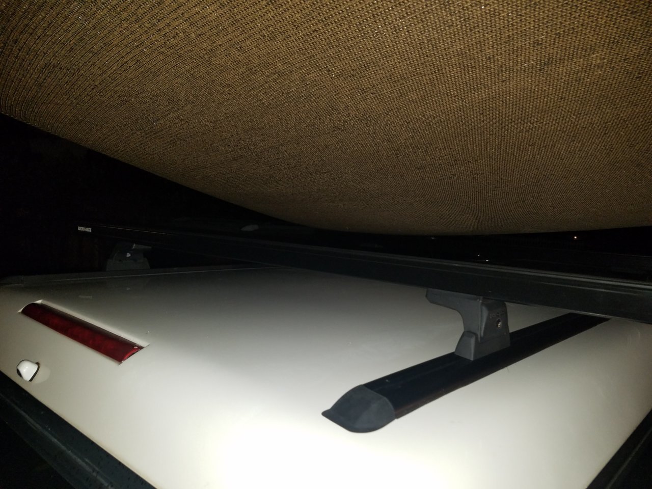

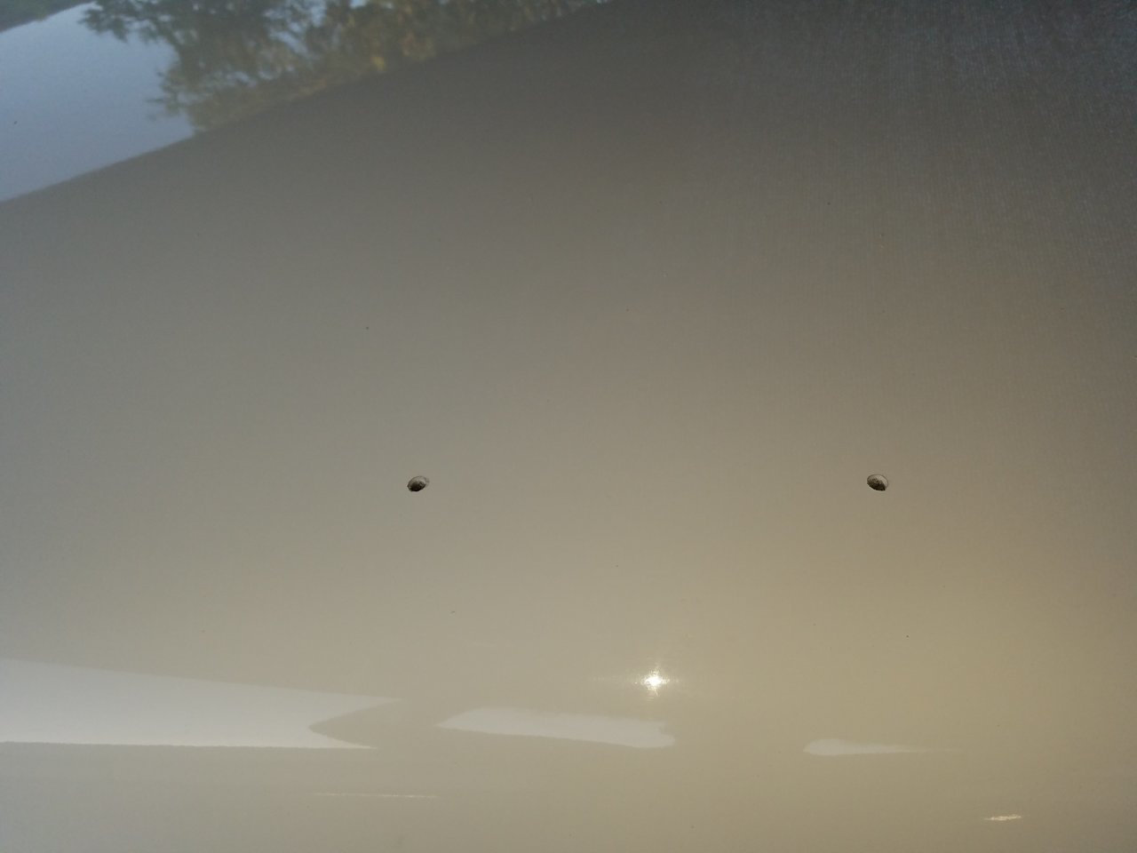

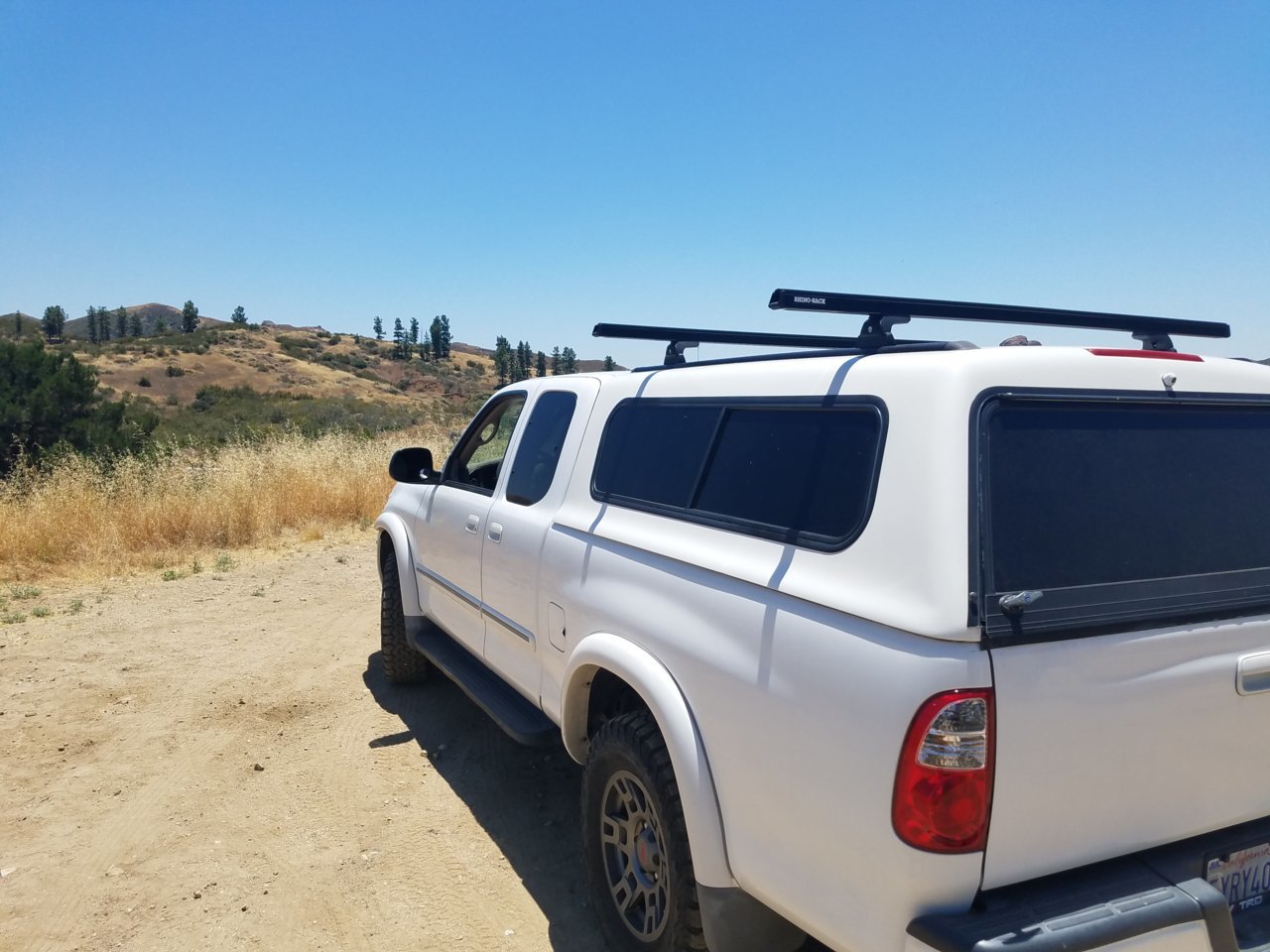

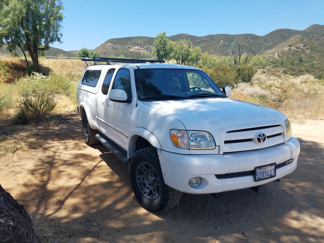

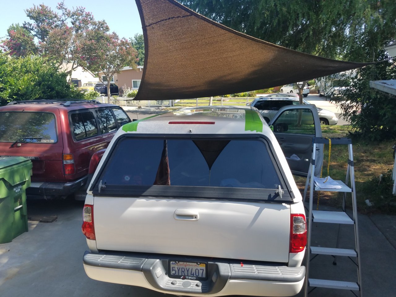

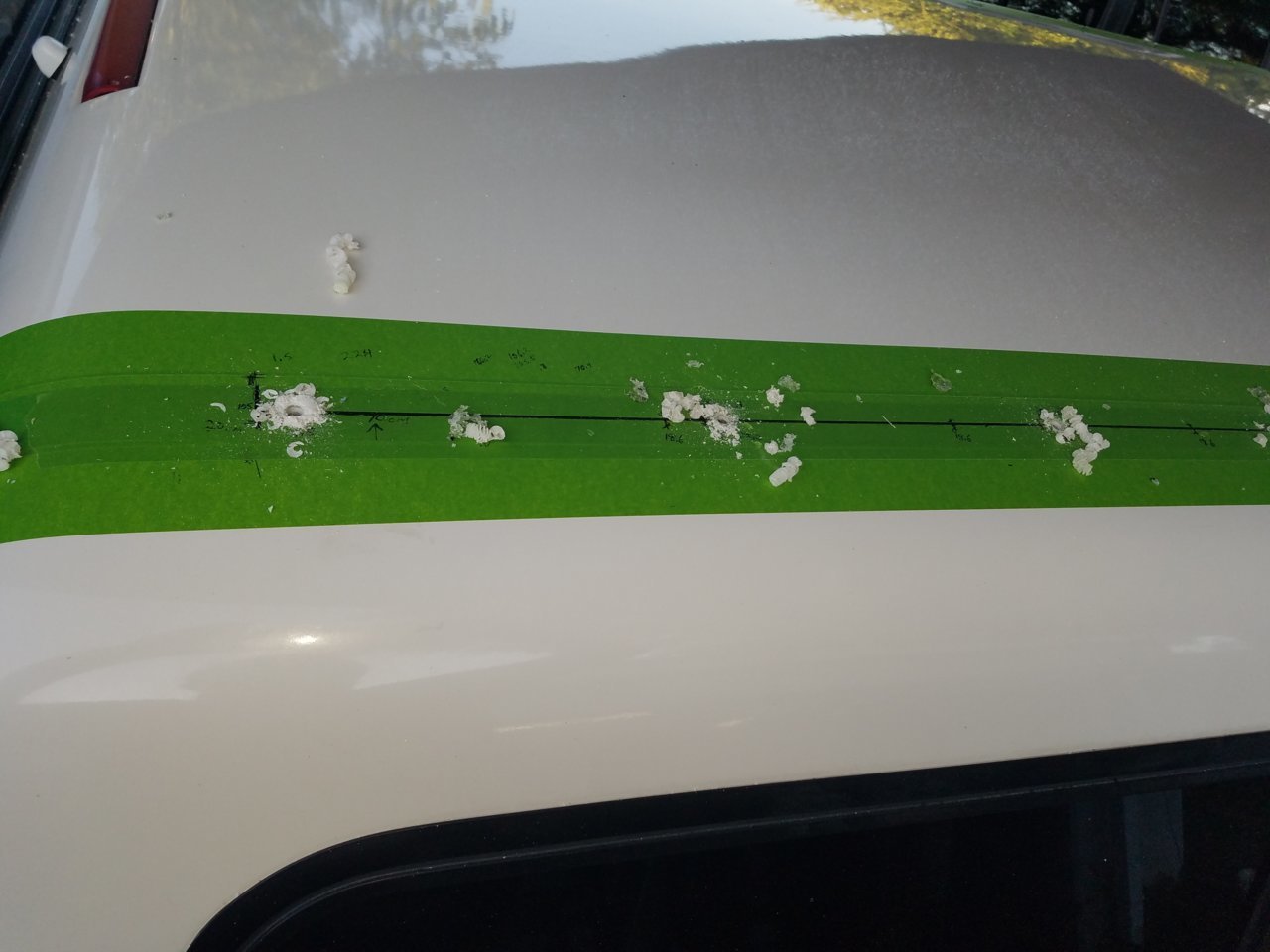

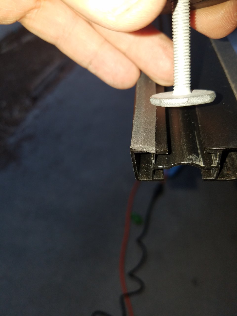

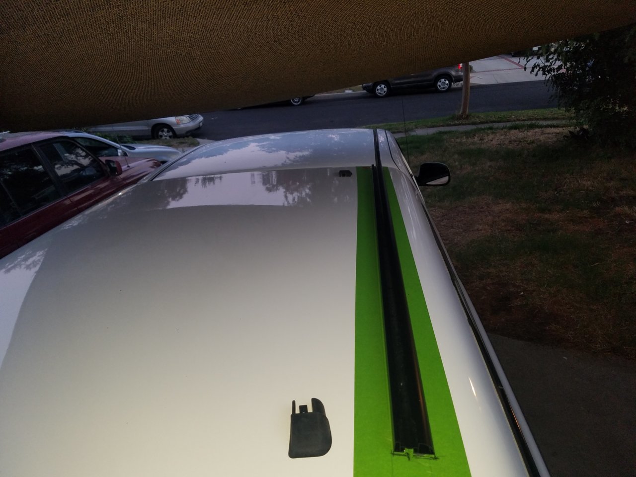

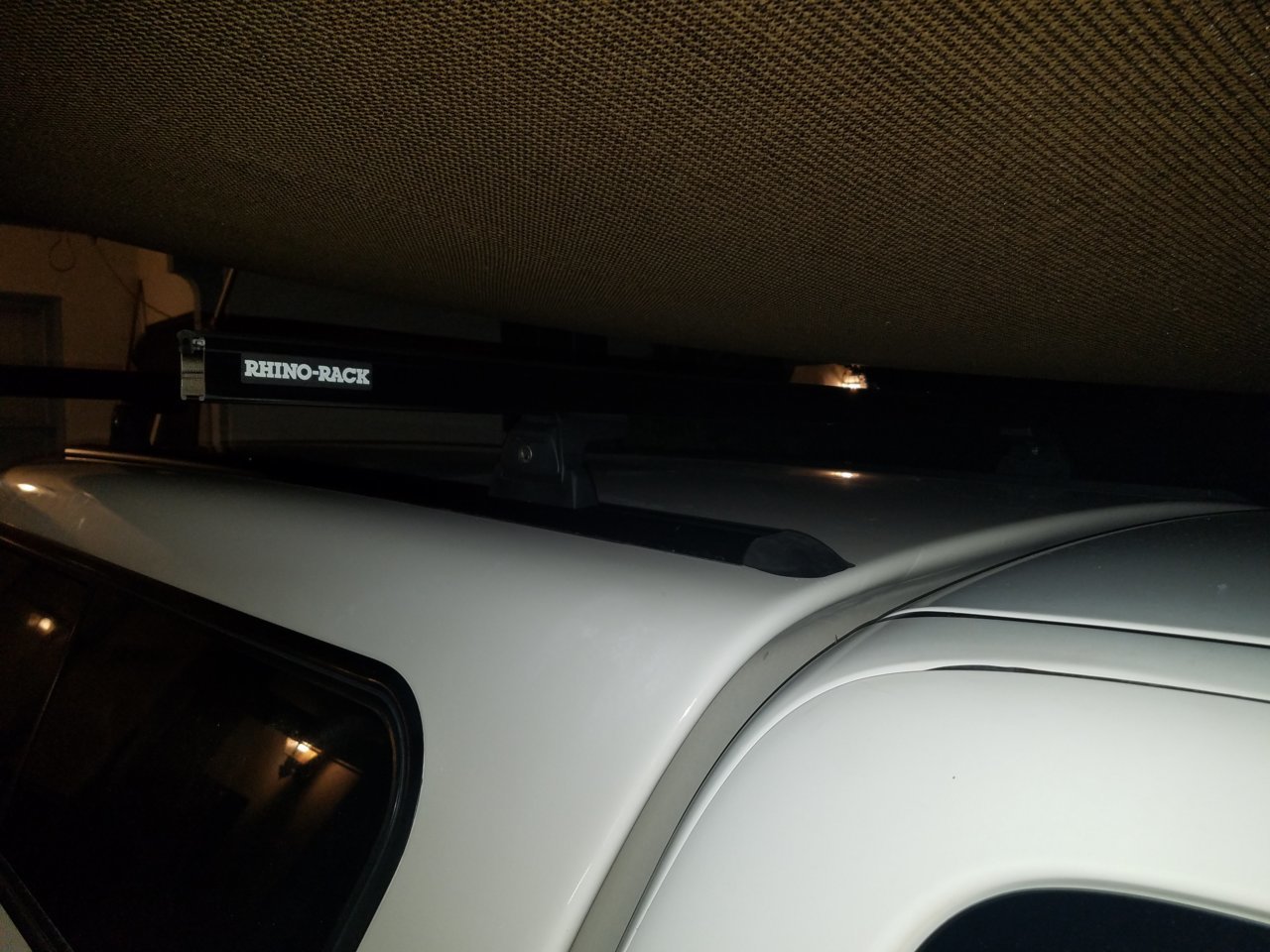

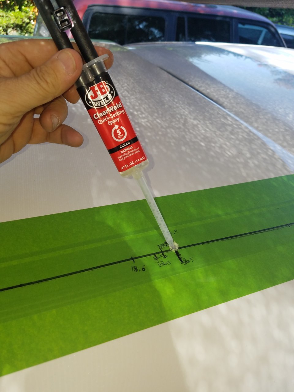

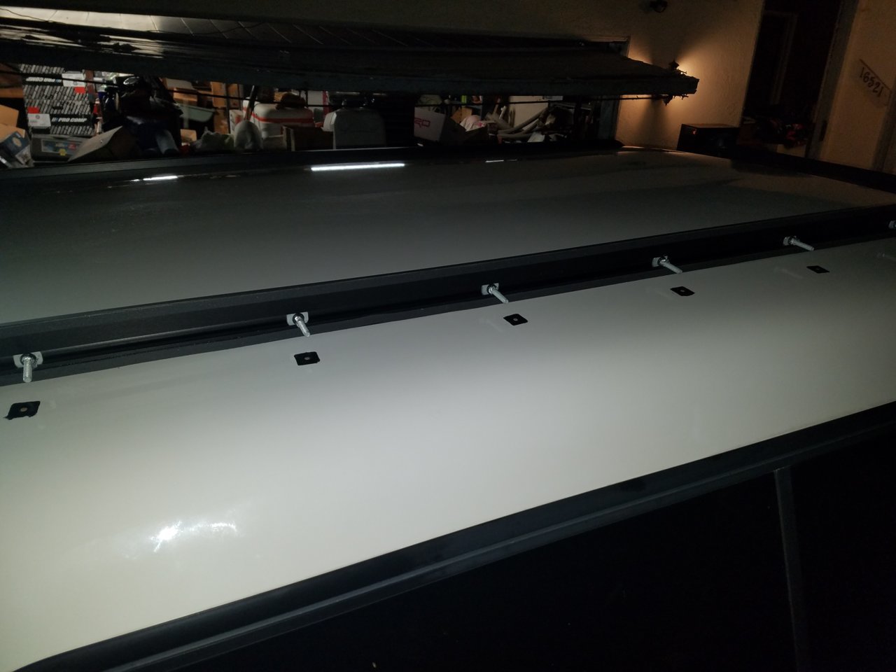

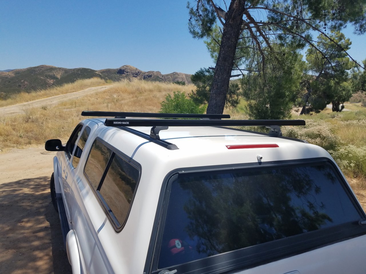

    So I did this today. It only took about 5 hours longer than the 5 hours I expected it to take. Measure, measure, measure and measure again. Not only is the shell higher in the middle then the ends, but there is a slight taper in the rear. It's a Rhino Rack made for fiberglass shells. It's the strongest I could find. Rated for 100 kg (220 lbs) dynamic weight. My shell has a double wall roof, so in order to ensure that water would never leak into the void I drilled holes in the top layer and then injected epoxy to fill the void before re-drilling the hole through the roof.
