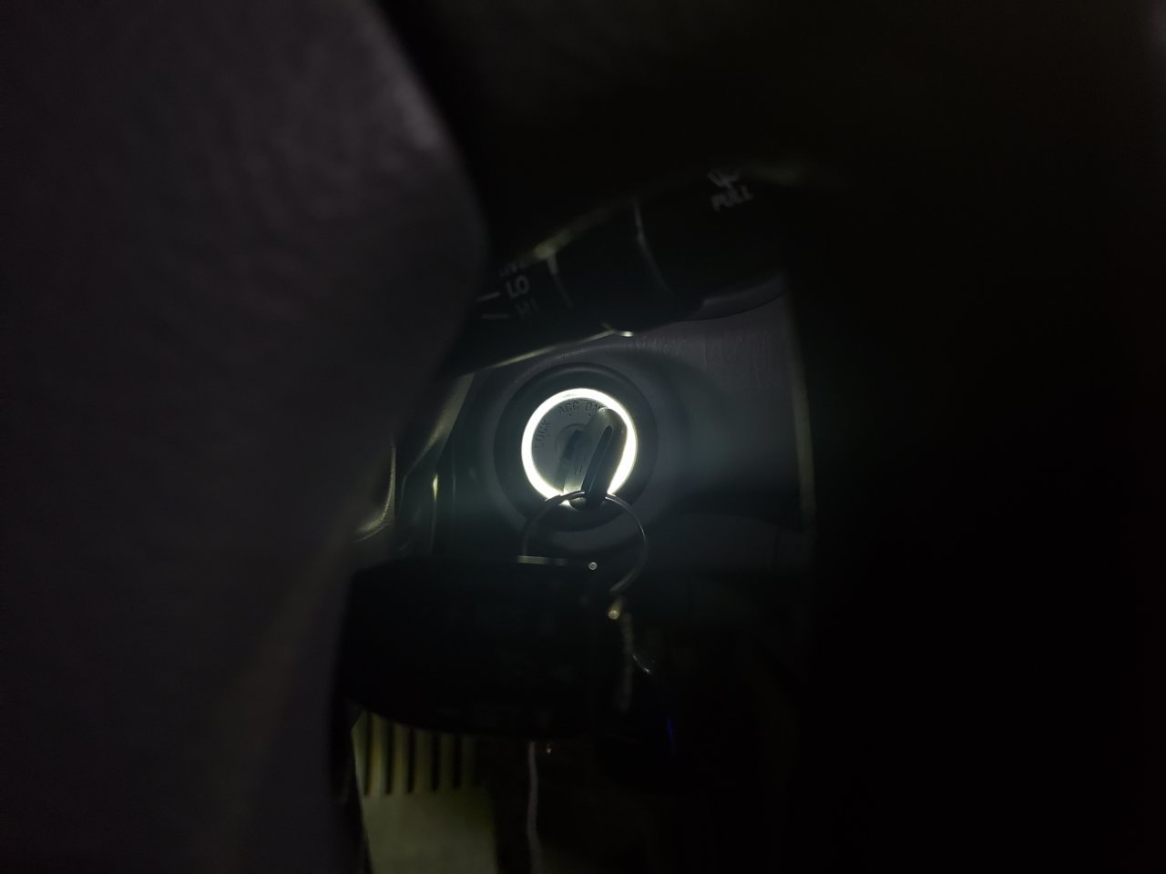

    I pulled off the panel under my steering wheel to take a look at my wiring for my light bar. Out of curiosity, I took a closer look at the ignition light and it was super hot. I happened to have extra LEDs from when I changed the floor lamp and glove box bulbs. It's really white and I like it.
    After doing that, I decided I needed to pull my instrument cluster and finally sand down that green tint. I left some green because I can't change the ODO color. Still debating on how I feel, but I really like the white.
    I don't think I have any bulbs left in the truck that aren't white LEDs and I'm proud of it.

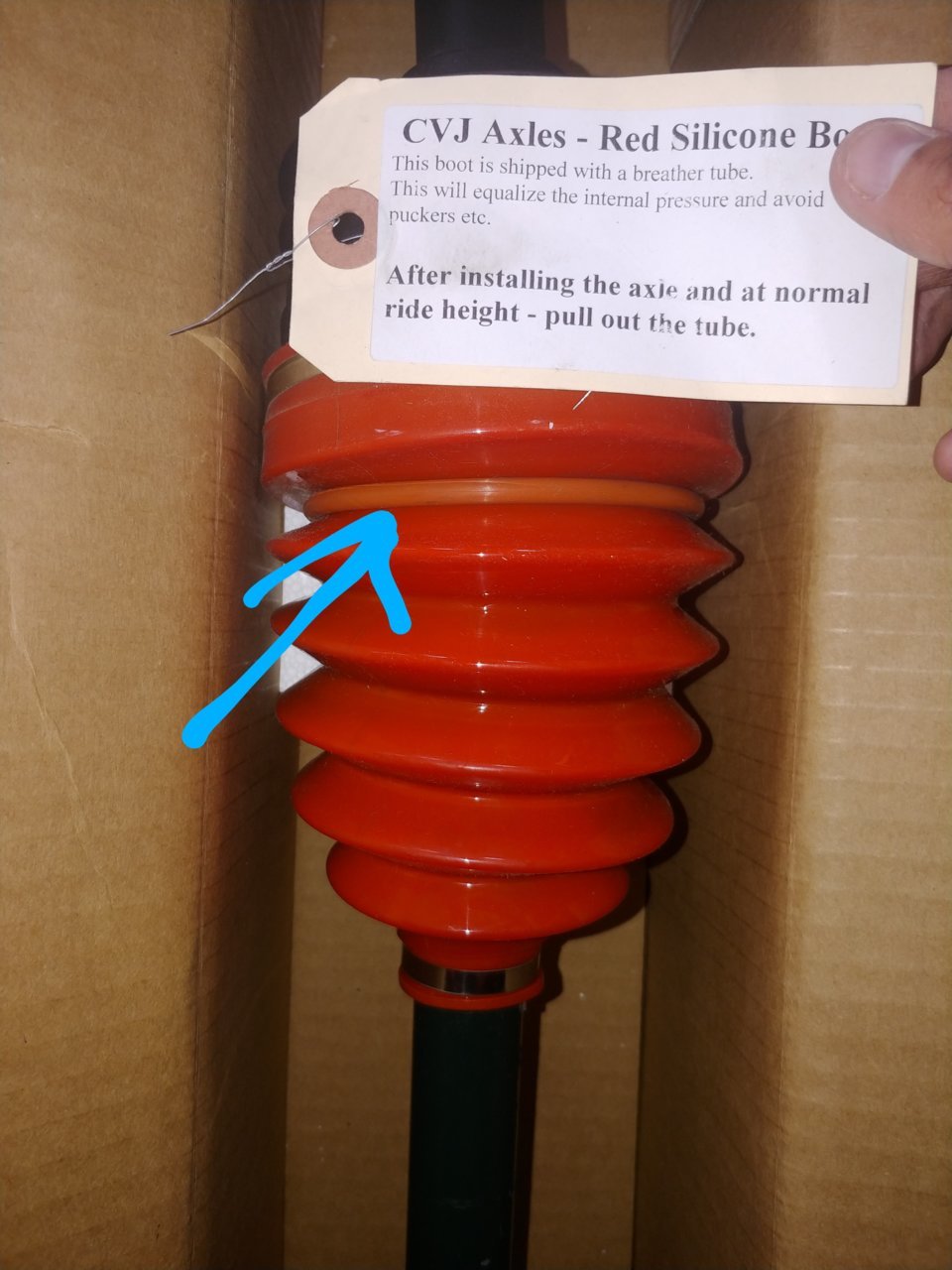

    Just a heads up for those considering CVJ axles. I was under the impression they cover return shipping on the core. They do not. It's around $25 to ship my axle back from TN. You have to request a return label.
    Additionally, they only put this note one one of my two axles and I didn't see it until I opened the 2nd box. I'll have to go back and pull this tube out of the one I installed. Not a big deal but surprised me they didn't put it on both.
    Also, I asked about the orange rubber band on here. They said it stays there to keep the boot from touching.

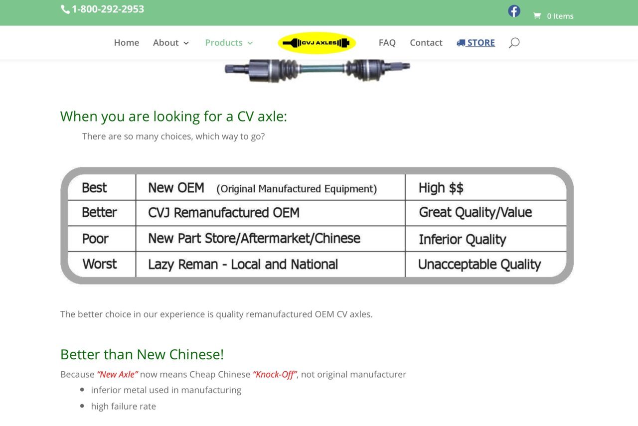

    I read that in the fine print back a few months ago. It reduces the core from $85 to $60 each. Cool heads up on the rubber band as a possible friction reducer.
    Also, on CVJ Reman Site they state that a brand new OEM Toy Axle is the best.

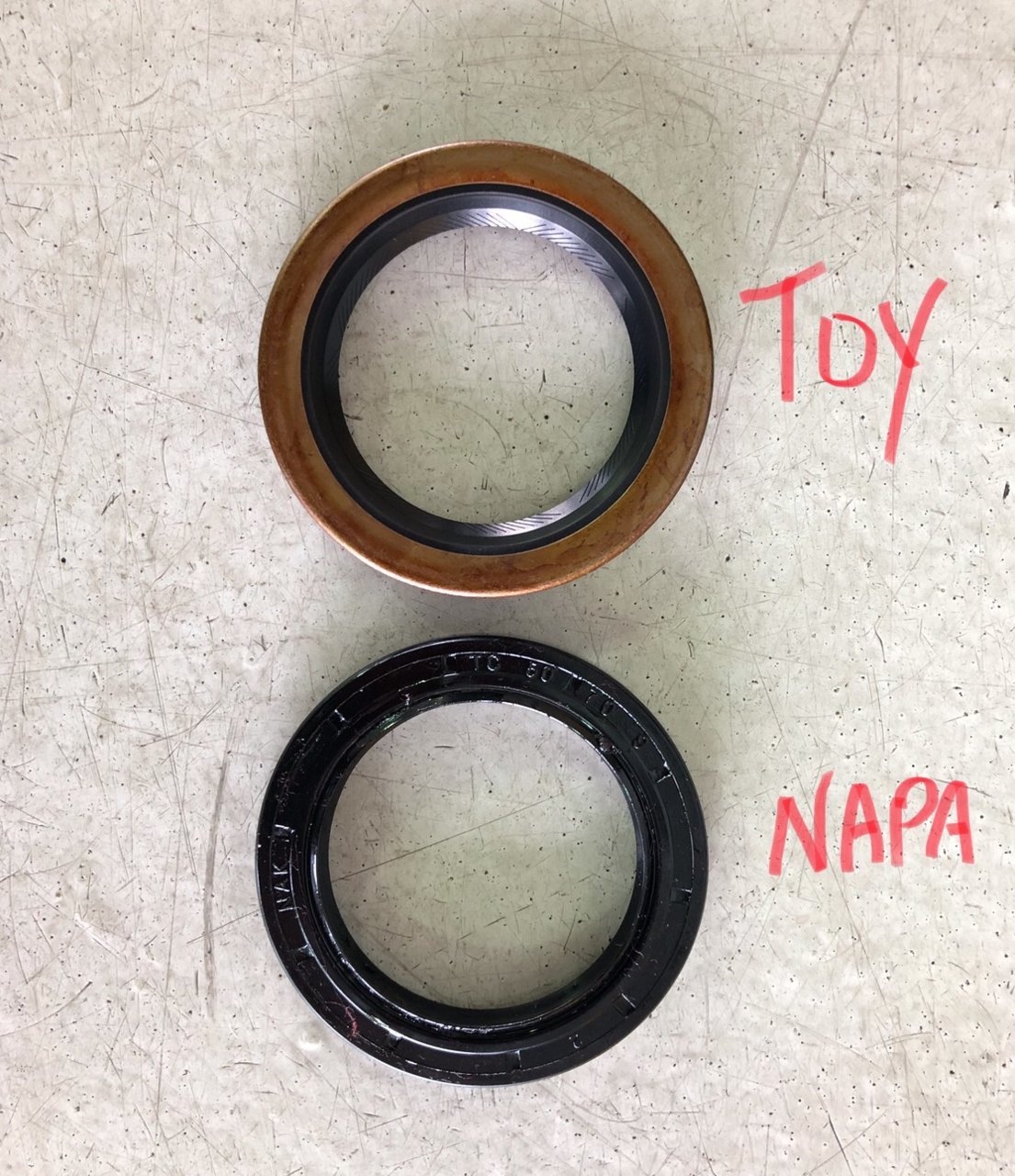

    Took her in bright and early for round 3 of Part II bearing repair oil seal leak.
    Spoke with the tech personally and he already knew about the grease/marker test on the oil seal. He admitted to his prior mistakes:
    1) He put the new NAPA oil seal on like the Botched Garage installed it during the first install.
    2) He re-used the NAPA seal and ‘finessed’ it on the second warranty repair.
    3) He reused the retainer ring and reinstalled it on the second warranty repair.
    The problem could have been rectified on the second visit when:
    1) Service Rep was told to reinstall a new Toy Seal by me.
    2) Service Rep was told to reinstall new OEM Spec Japanese Brake shoes.
    Manager states the problem ended up being that the new NAPA Seal opening is slightly larger than the Toy OEM Seal. It is. It was also crooked from reuse.
    Conclusion: Use Toy OEM Oil Seals and retainer rings when doing these axles. I also saved a ton on money by not buying a new Toy axle in lieu of the NAPA axle and bearing, as the dealer wanted me to do. A simple checking of the seals differences by the tech was his mistake on round 1&2. Cost him dearly, probably.
    We’ll see how this seal holds up. If it leaks again, I’ll have my CC company refund and end up doing this job myself.
    Post Mortem Pic

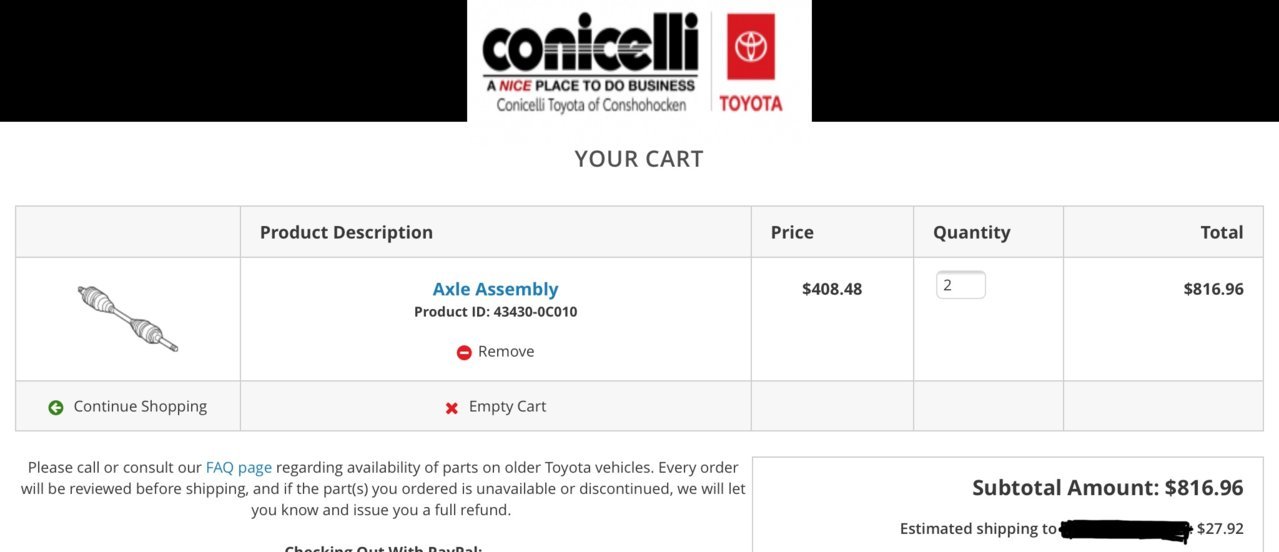

    Yeah. Will go with the Brand New Toy Axle. My old ones were still good. No noises. They just had ripped boots and slung some grease. I bet I could have just cleaned them up and greased them real good with new boots and been good to go. The OEM axles turn better (even though you are suppose to limit turning).
    Found an online stealer that sells both the new ones for right at $840 with shipping! No cores.

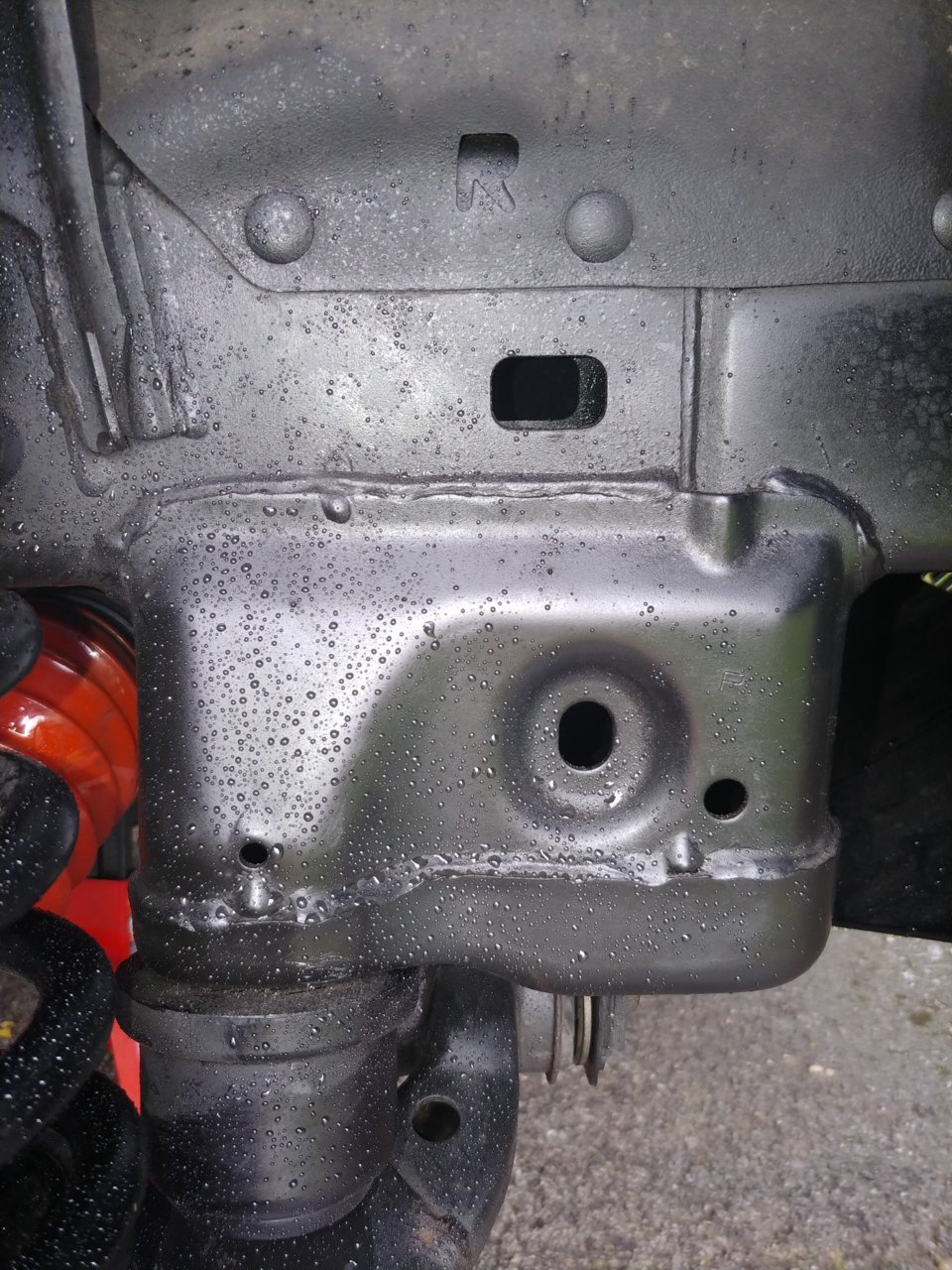

    Not trying to start another fluid film debate. I'm sure they may be better products and grease will last longer.
    I just went outside to wash the copious amount of bird shit off my truck. I sprayed my frame and it beads up like paint that's been waxed. This is from fluid film I sprayed in November. We've had over 30 inches of rain just since 1/1. For comparison, Seattle has had only 20".
    What I've noticed is that FF doesn't look like it's there, but it's working, at least on my truck. Given this, I'll likely keep applying it every November before the first chance of salt.
    oscardog86, Darkness, bmf4069 and 8 others like this.
