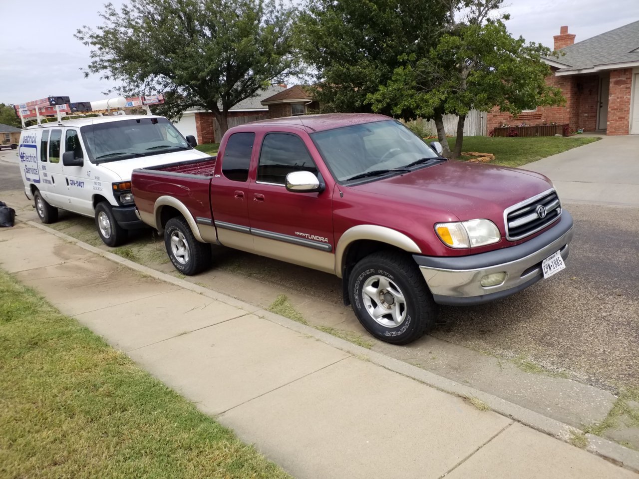

    Peeling door window trim.
    Might be on to something. Please explain 2 tone. Paint them all black (or another color)?

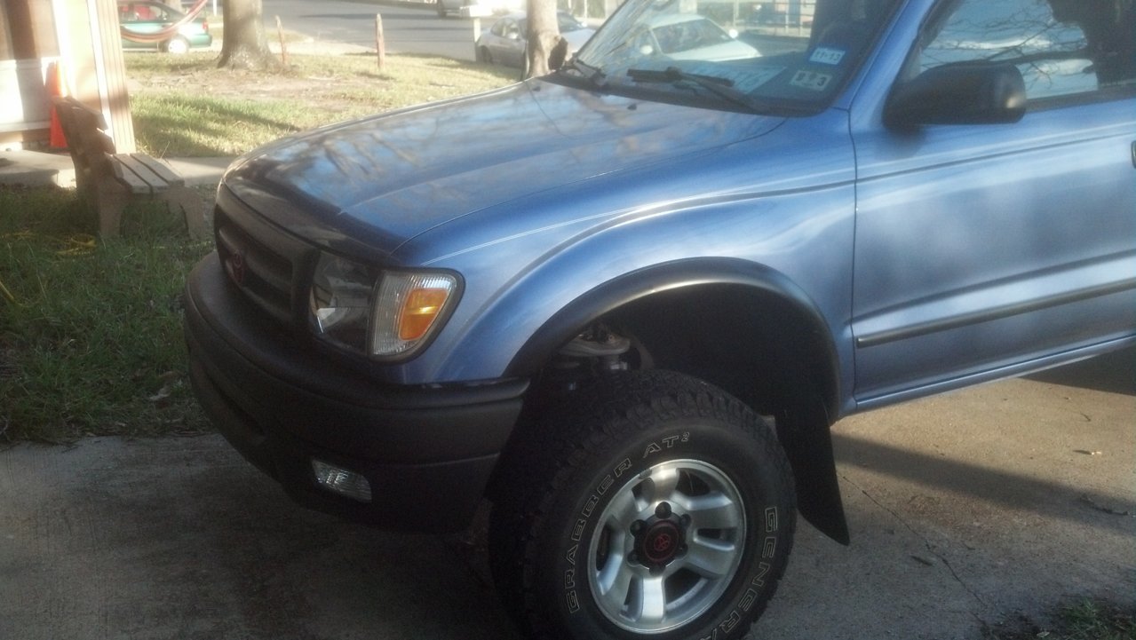

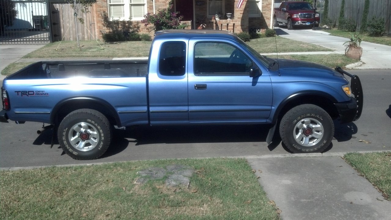

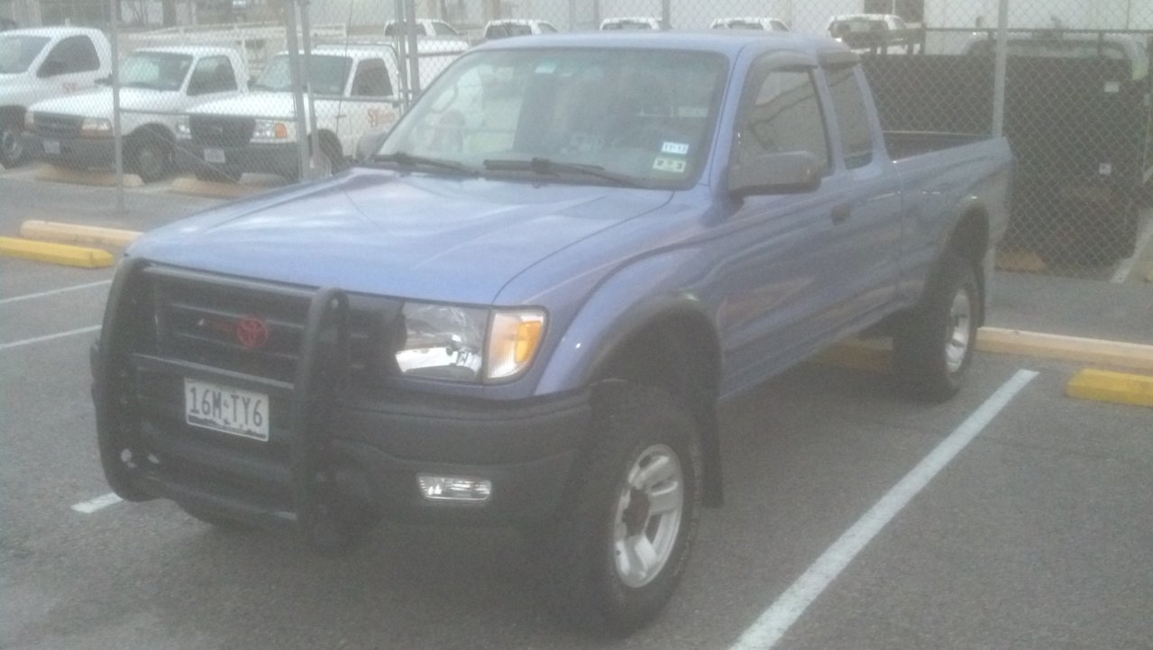

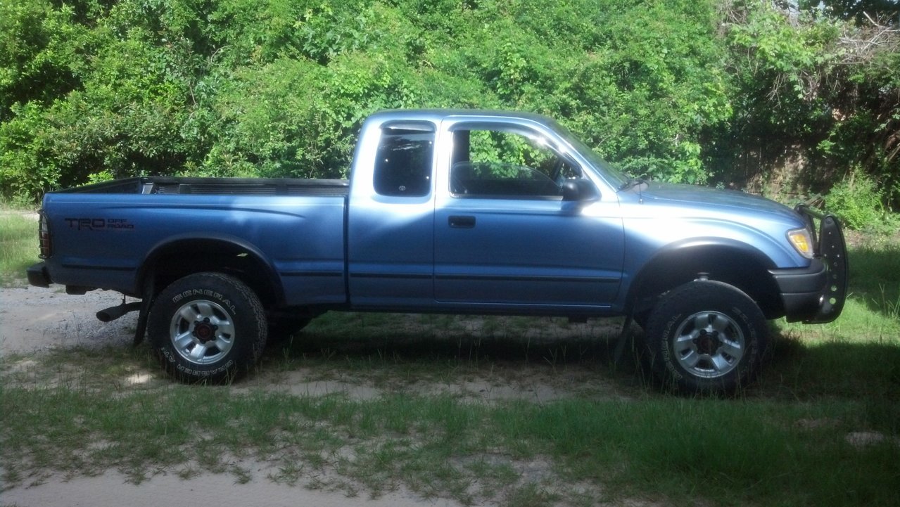

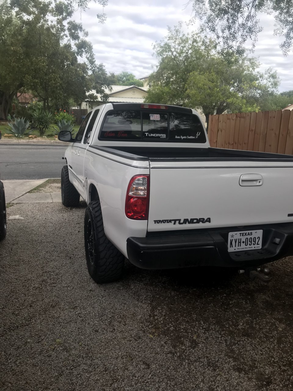

    Like this:
    Or whatever would match y'alls color scheme. Black would be awesome!
    Darkness likes this.

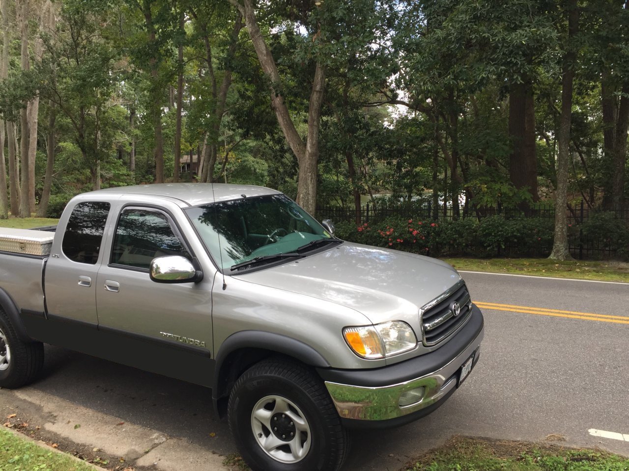

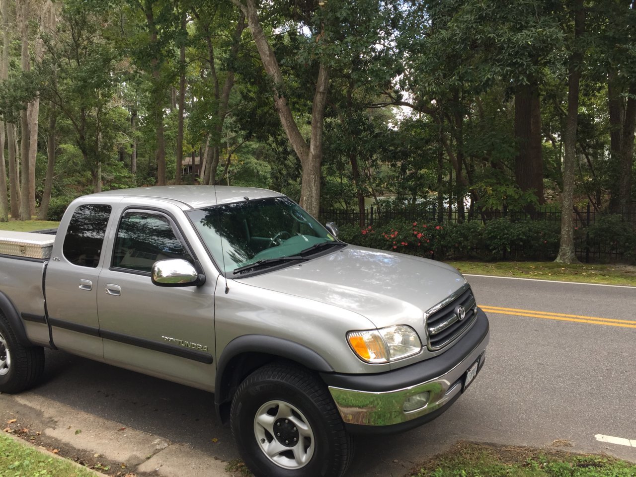

    Like this. I painted all my black trim last winter as it was faded. Used Rustoleum flat black. Lots of prep taping, little bit of sanding, and patience.

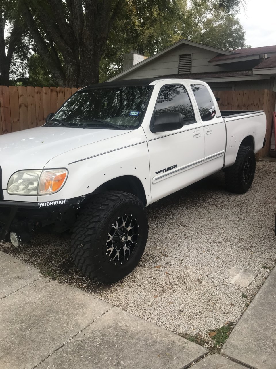

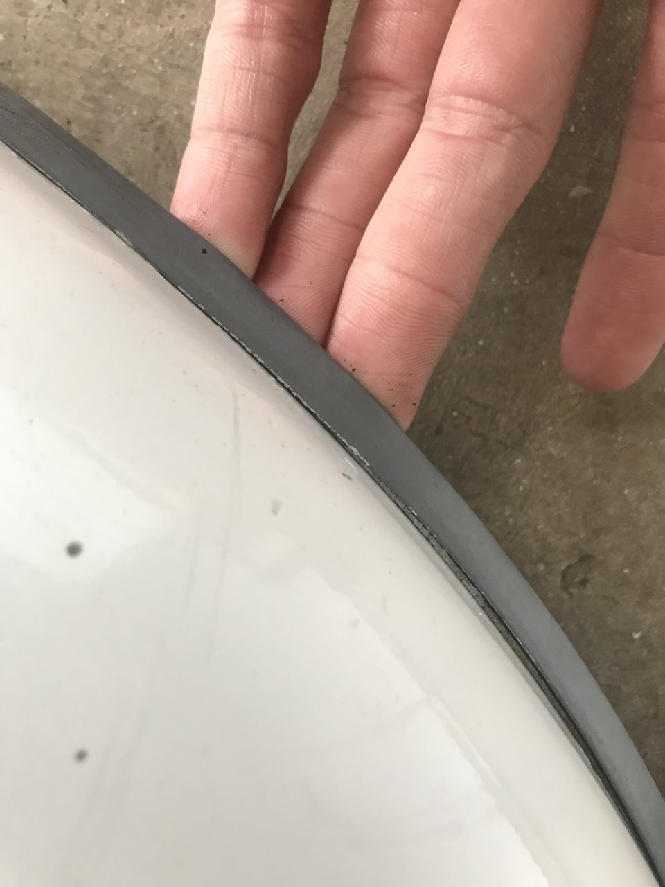

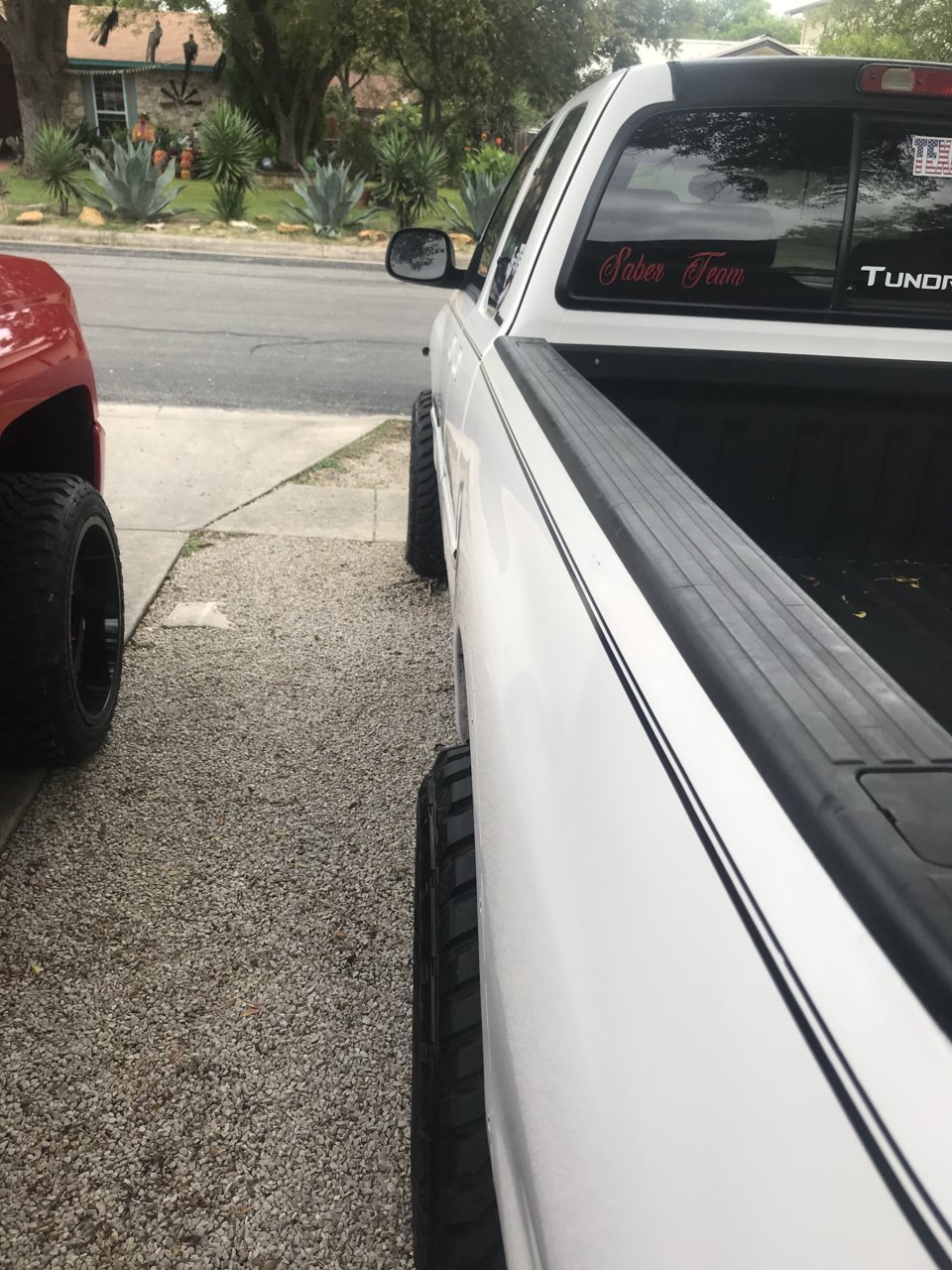

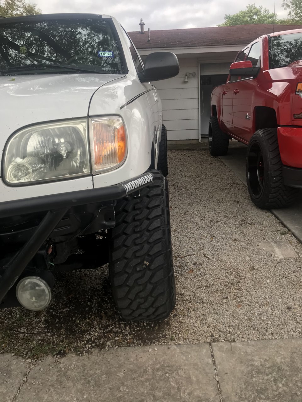

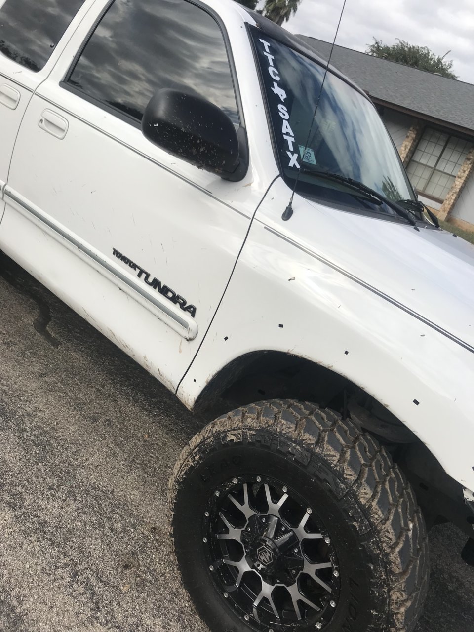

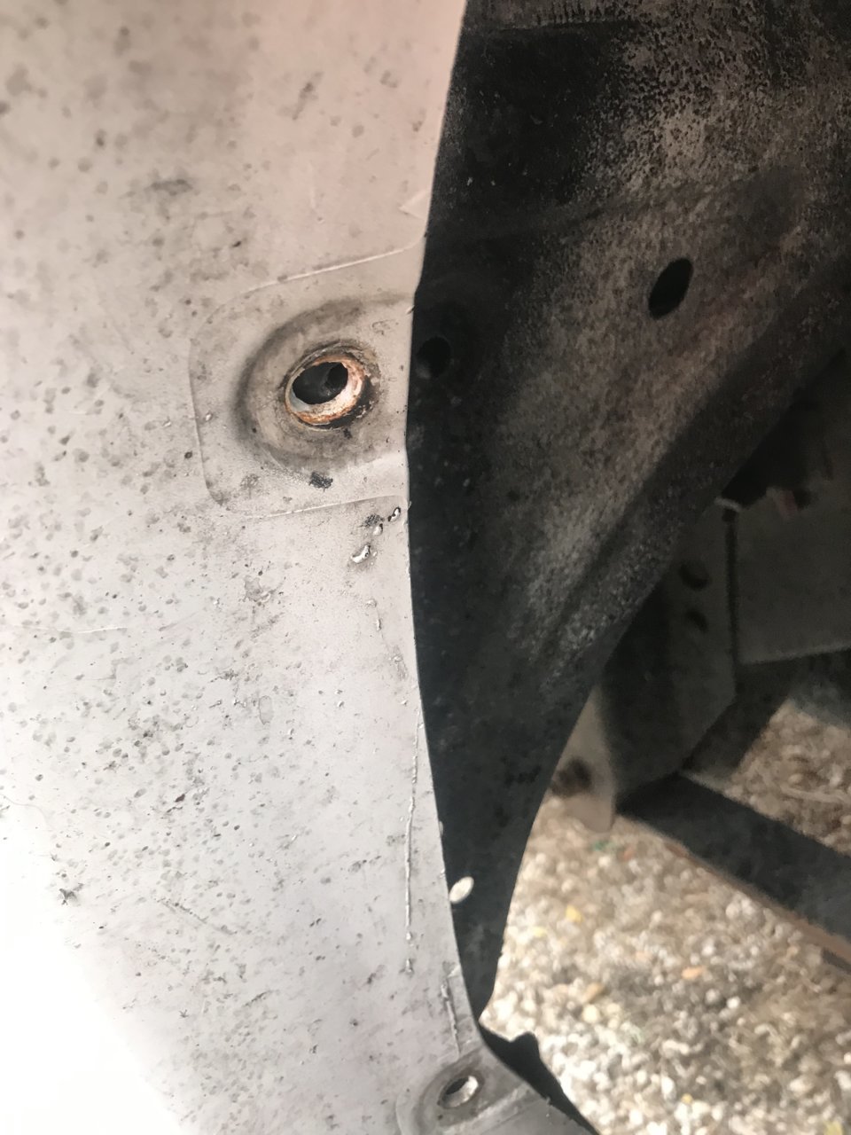

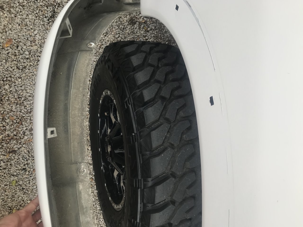

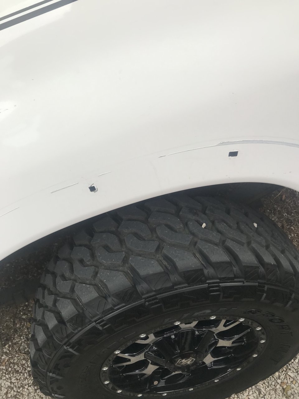

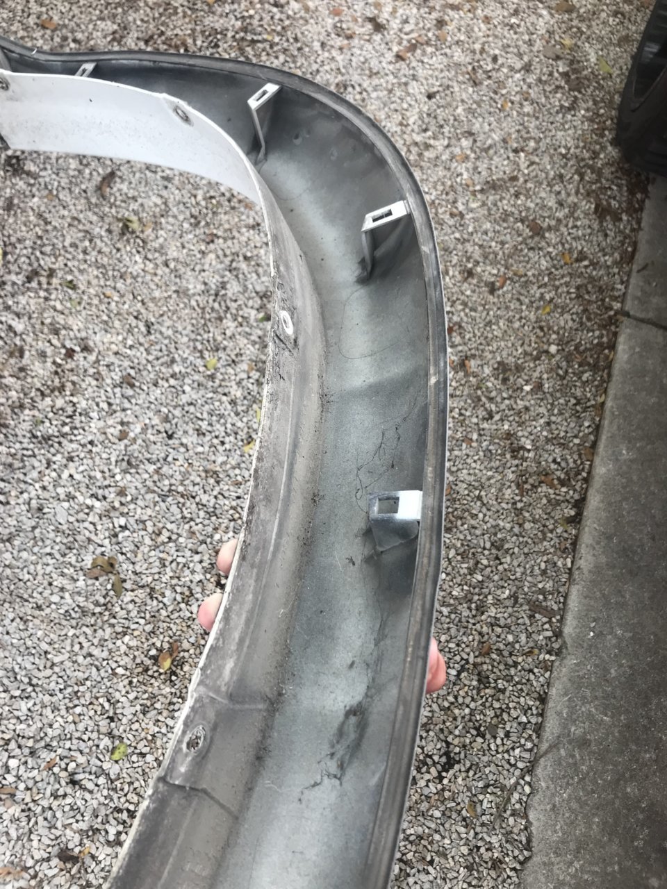

    Yes, it is possible, you may break a pop-in clip or two, so i would order some just in case. Once you remove all these:
    You can then pull one piece of the flare at a time, pulling straight out, and a little in the direction of the next clip youre gonna pop out. And thats about it, here are some pictures , the little gray scuff marks come off, all that is is the weather seal shown in the pic after
    These are the holes left behind
    And of course the clips can be re used, if they arent broken. You can always order more. Here is a picture of what it looks like after, my tires are 275/70 r17 with a +18 offset.

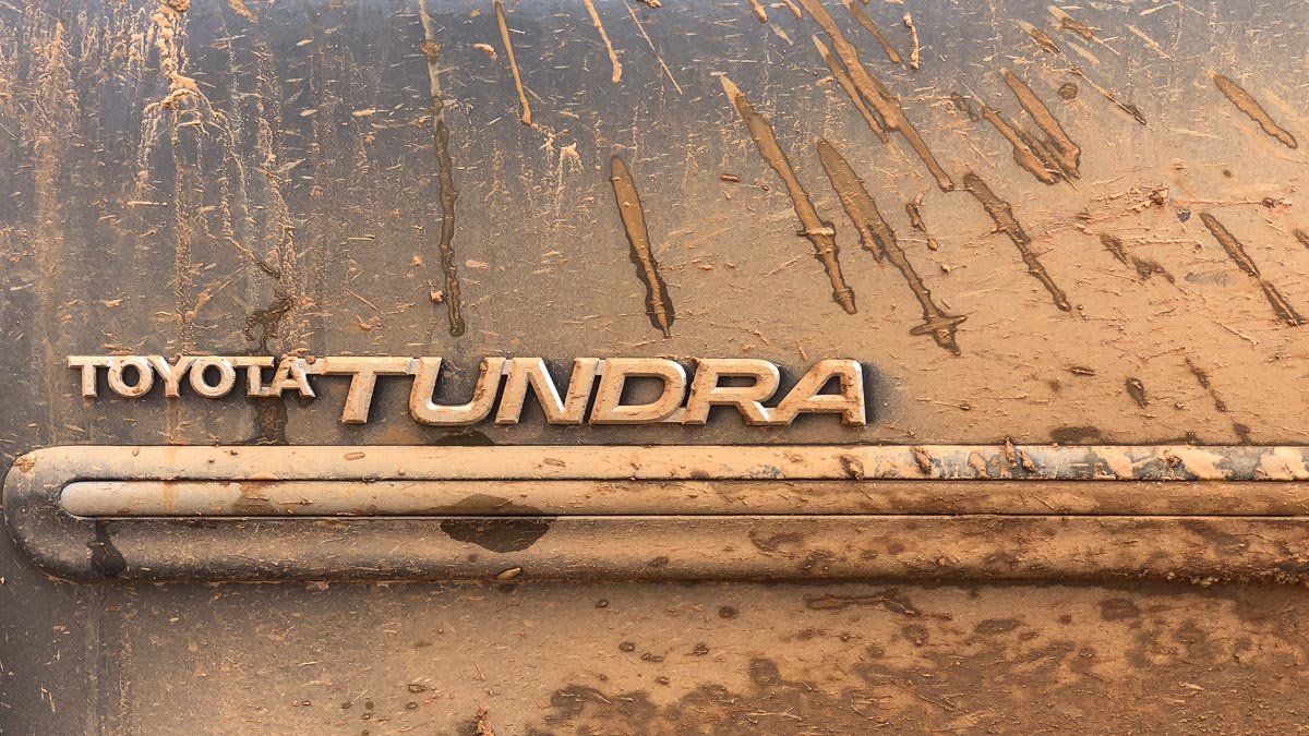

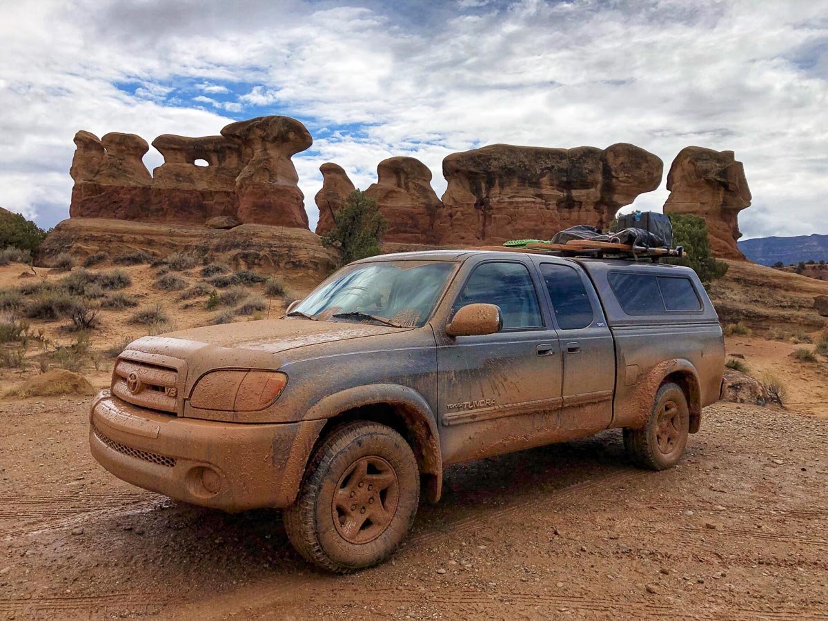

    Not something I did "today", exactly, but just got back from a two-week trip to southern Utah and just now getting a chance to go through pics. Got my first gen a little muddy down Hole in the Rock Road!
    On a related topic, is there a strategy for cleaning gritty mud off the windshield without scratching the shit out of the glass? While sliding sideways down the road, that is. Obviously stopping and flushing with water would probably be ideal...

    Some rain on the Burr Trail washed some of the mud off...

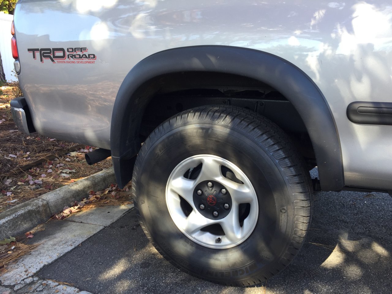

    Colored in the Toy symbol on wheel lug cap with some subdued red match (close) to the TRD logo. 2 coats. May do a third.

    Looks really good, ties in well with the sticker colors.

    I rember doing this on my 99 taco 15s. I sprayed em black and then used red nail polish and then clear coated em. I wish I had some better pics or took more pics in general (RIP Pearl).

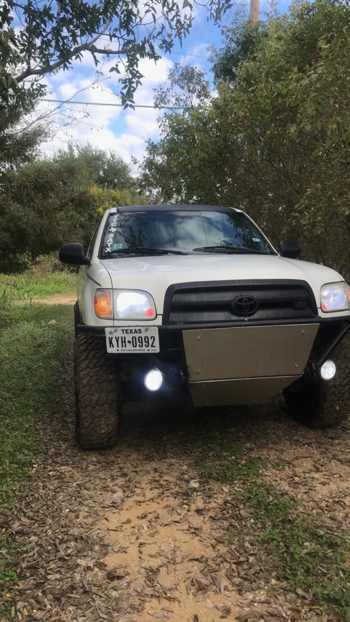

    Had to go get her shoes a lil dirty, went to a trail behind my neighborhood to get some pictures. this will be a teaser, i didnt let it rip like i wanted but soon i will, was trying to keep it clean for pictures

    Nice! I used some oil paint from the art store. Had a real nice expensive chisel art brush laying around that did the detail work. Those caps were flaked out and I painted them last year. Always thought they needed a little special touch and this was it. Very subdued.
