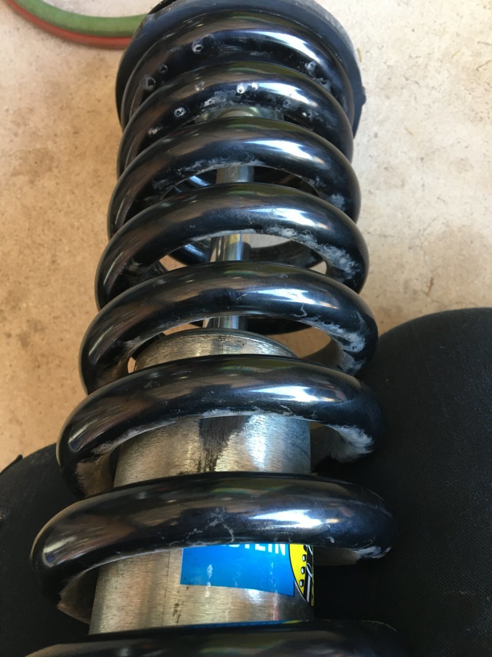

    Well I pulled the coilovers off, took them to Cooters garage and used their bench mounted spring compressor, I wouldn’t even think of renting those death compressors. Anyways, New top hats, I set both on the same clip; used to be 8driver 6pass, with 3/4 differences in height, so I set both on 7th clip. The passenger side was the one making contact during travel, I tried reclocking the spring, re clocking the top hat, but nothing seemed to help really. It looks better than it did, and hopefully I just needed a C hair of clearance. I’m not sure if billy bob would warranty that or not. It’s a tad bit TOASTY outside, so I’ll drink a few tasty beverages and get down in a few hours

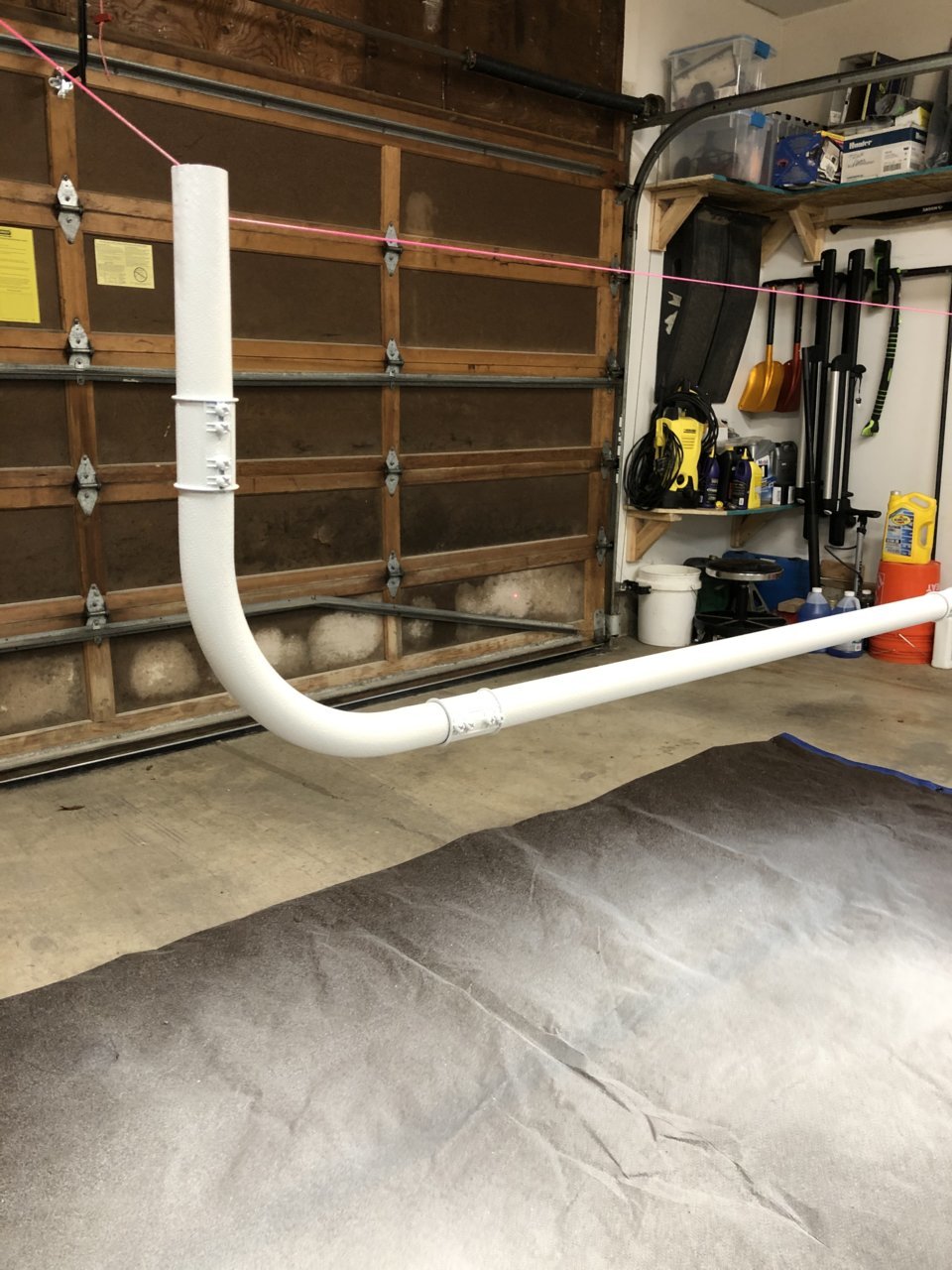

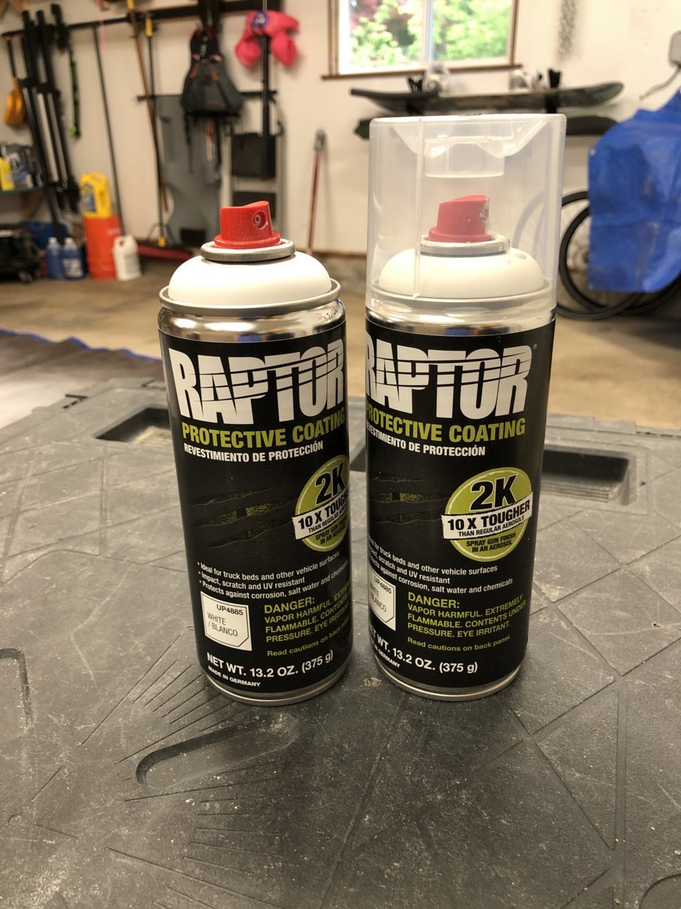

    Raptor lining the kayak rack for it. I originally bought this ‘bed liner’ to do my rear bumper and fender flares but it’s permanent so I’ve had it sitting on the shelf for months because I’ve been too scared. Two cans of this stuff is gonna get me a pinch over 3 coats on this so be warned it goes fast. Also wasn’t sure how the color would match my white tundra and if it would turn yellow down the road or not

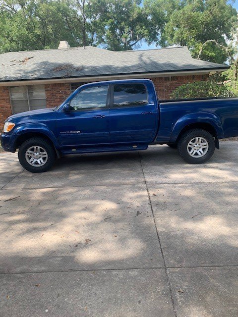

    2006 Tundra Limitied 4x4 190000 miles
    Just put 5100 Bilsteins on the front and rear. Lifted 1.5 in the front. Also went up to 275/70/17 Milestar Patagonia tires. (i know they are cheap tires)
    Rides great now.
