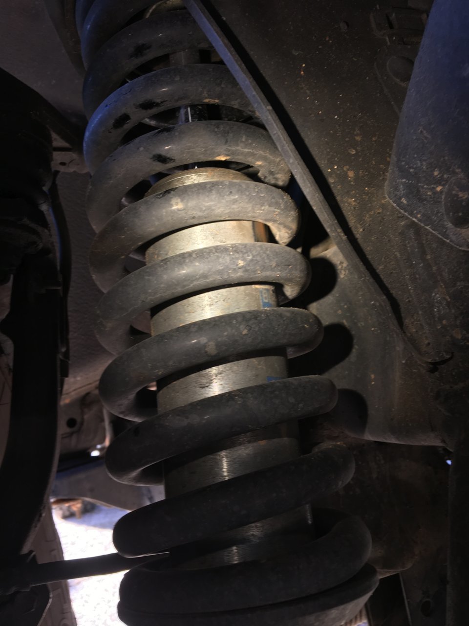

    Ahhhh I’ve found the stupid noise that’s been driving me bananas!!! 6100s on the very top perch and apparently they are making slight contact with the strut body.
    Has anyone else dealt with this, what are my options? F2D94782-FF5A-4F65-A1F1-BA77D86F7DB5.jpg
    Do I just need to re seat the upper part of the spring in the top hat?

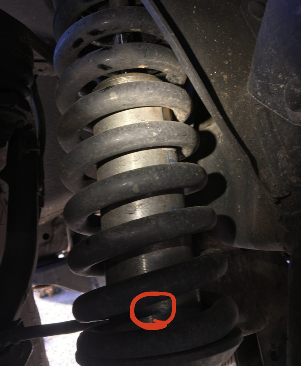

    Hard to tel but is this red circle where it’s making contact? My only guess would be that you have the springs compressed too short since you said your 6100s are on the top perch and the spring when collapsed still needs to go somewhere to it flexes to a side and the inside of the coil is rubbing the strut. Make sense?

    That makes sense for sure, but it’s up at the top right side, kinda looks like rust, from where the spring has rubbed thru the paint

    is the spring upside down or did it come unseated from the top perch? You know how it has that flattened spot at the end of the coil. Believe that goes on the bottom.

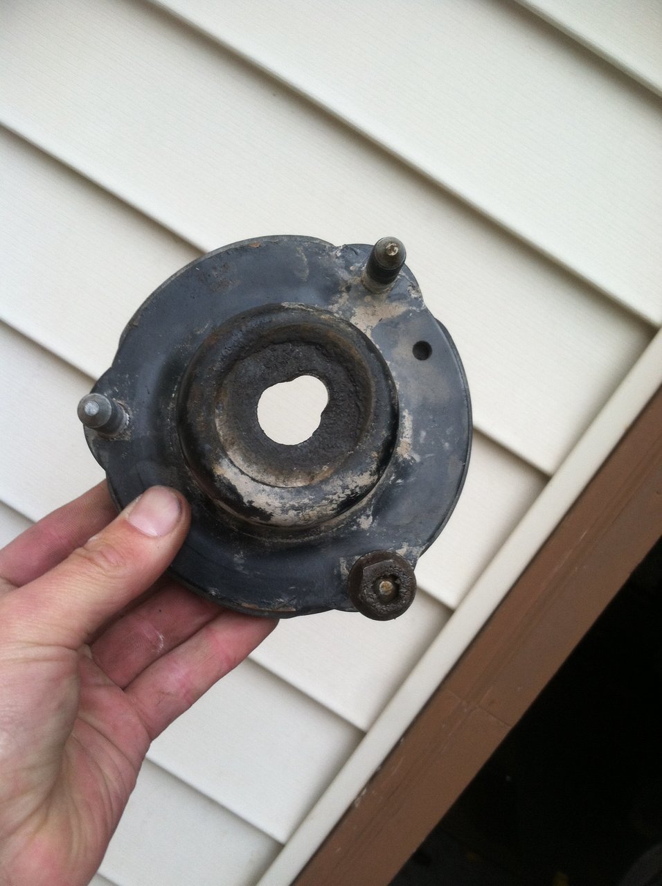

    You prob need to check your top hat for wear. I have seen where Tacomas can do this.

    The only difference I saw from side to side was the passenger side(side rubbing) is on perch 6, while the driver side is on perch 8. Giving my driver side 3/4” more height than passenger. I’m trying to ask the PO what the shop set them at.
    maybe I will order some of those KYB top hats and redo those while I re perch it properly. It’s just weird, the one with more preload isn’t touching at all

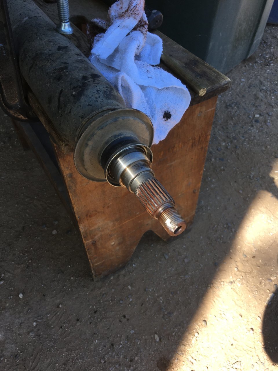

    image.jpg Carrier bearing came off way easier than I expected, I was mainly worried about the dent in the capture nut not clearing the threads, but ol beef cake impact had no issues!
    Now I just need to look up torque values

    That is weird. I'm outta ideas but I do like checking the top hats and at like $30/piece its not a bad idea since you're gonna adjust the perches anyways.

    Yeah maybe the circlip fell down a groove unevenly? I’ll get it sorted out after I can decompress them and see what’s going on exactly

    Drive line feels smooth as a hairless cat now. There seemed to be quite a bit of slop in the old CB, and it basically fell off after I removed the mating surface flange.
