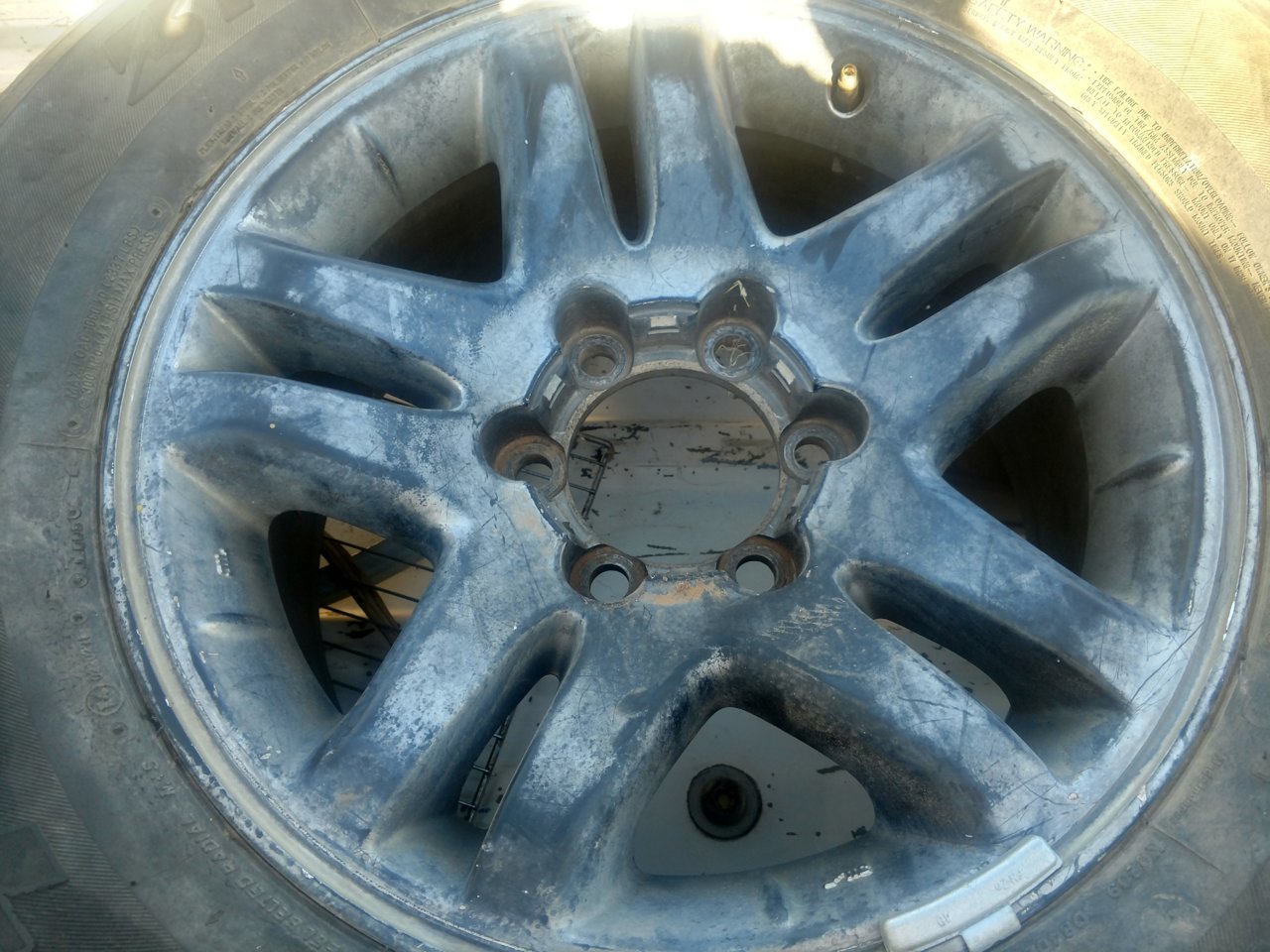

    I believe toyota started using those 17’s in 2003.

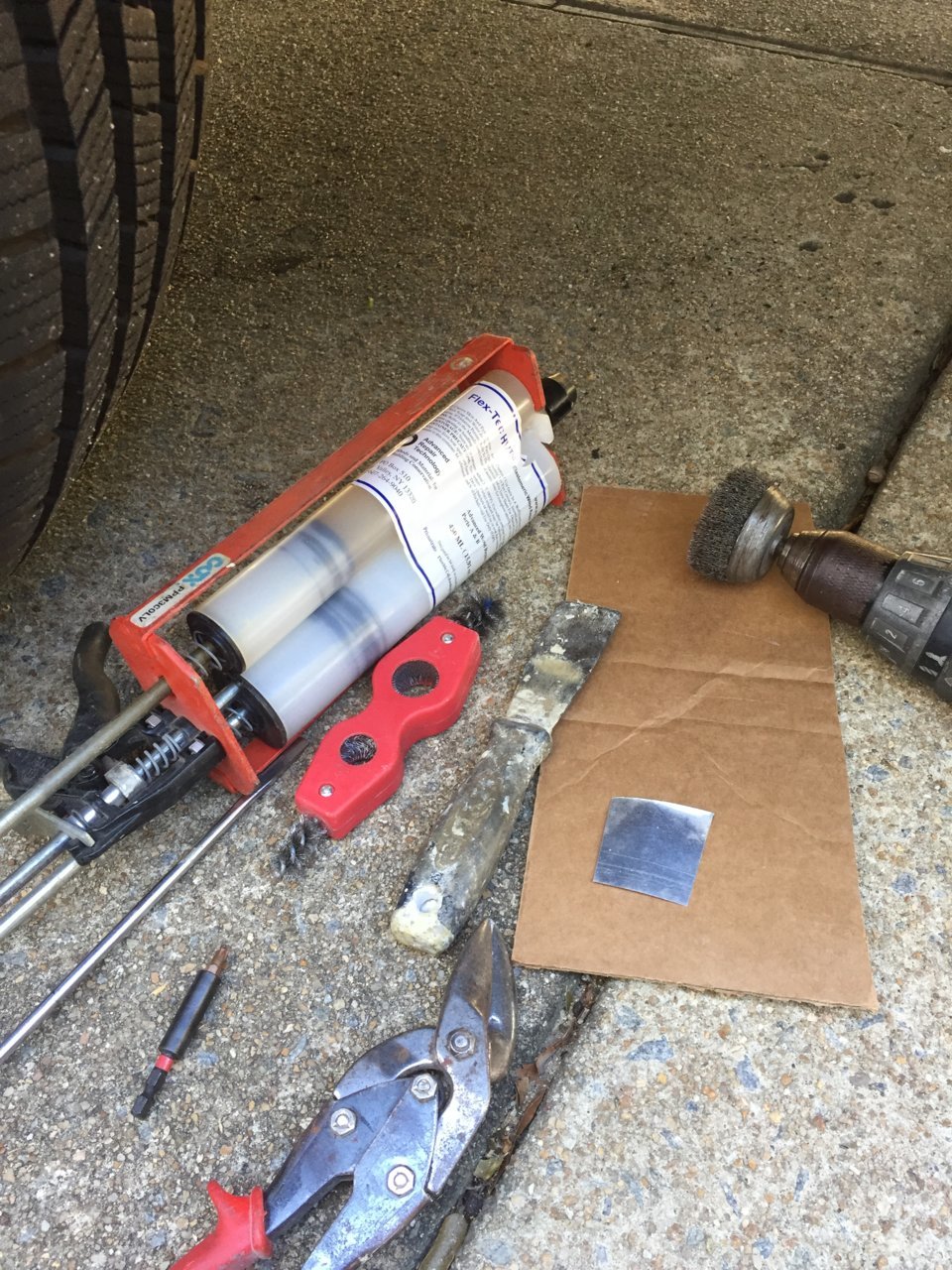

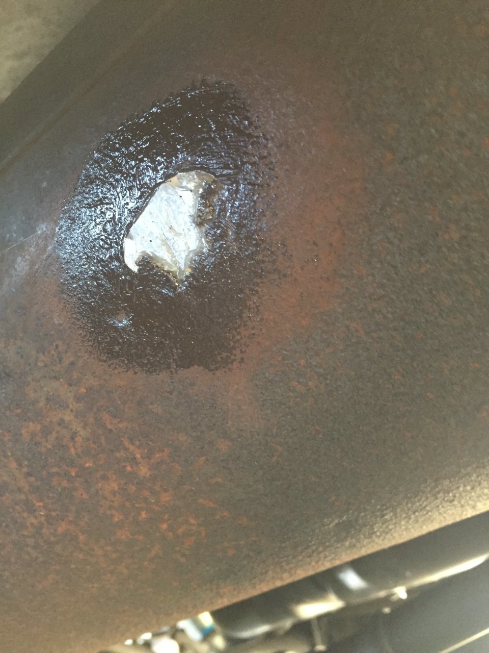

    Rube Goldberg’d the muffler (OEM) with a custom cut piece of metal sandwiched in a bed of epoxy. Made sure to wire brush things pretty good. Stuck a long screw driver up in there and poked around pretty good a test for weaknesses. None that I could feel or hear. The outside is still solid too except for that one spot. Will put a second skim coat on the repair tomorrow for good measure.

    Ran the VIN. It is a 2000 2wd. Not going to get the wheels, because there are only 3 17's, and the spare is a 16. Someone already grabbed the other wheel. Will grab the steering wheel. Also, should I grab the center console, just in case I come across a set of captain's chairs? Any other requests? Going out Thursday. Also located a 2004 in another salvage yard on the other side of town. Recently arrived. Will be checking it out also

    Yep. This muffler is still solid overall. If she develops more holes I’ll cross that bridge, as the propeller rebuild job is coming soon and consuming my focus.
    The muffler sounds deeper again with the patch job! No exhaust leaks under the truck!

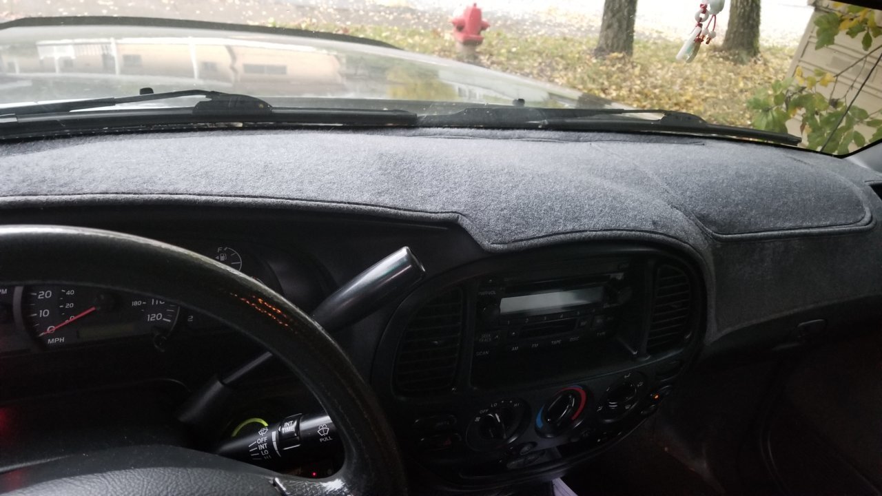

    None yet - plan backup camera, led lighting, head unit, box organizer, and canopy or tonneau if one can be found local affordable.
    I finally got my dash carpet installed that I picked up on evilbay for $29

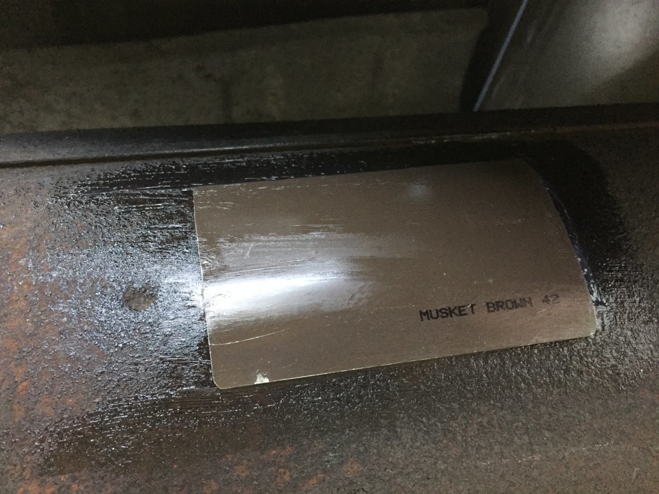

    Musket Brown color match patch on the muffler. Not bad. Doubled up over yesterdays patch.
