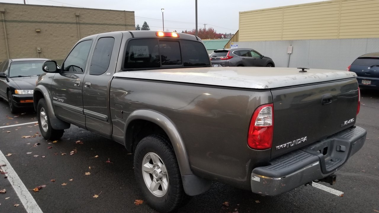

    06 DC

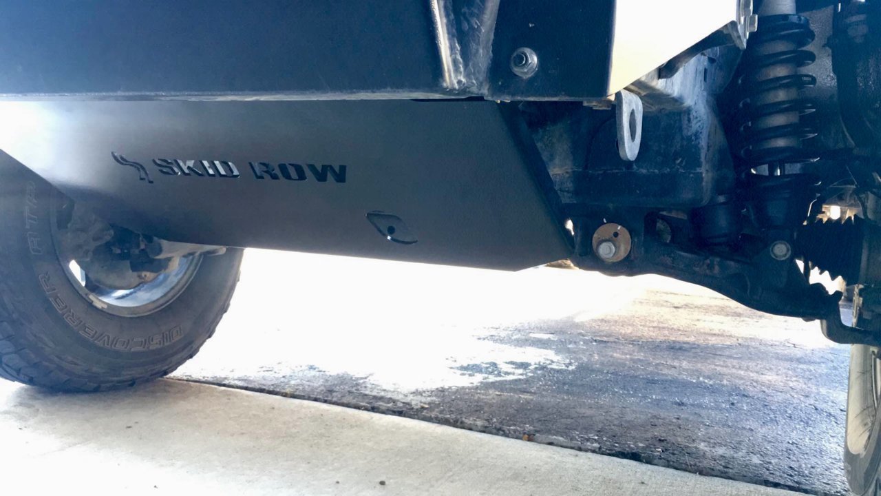

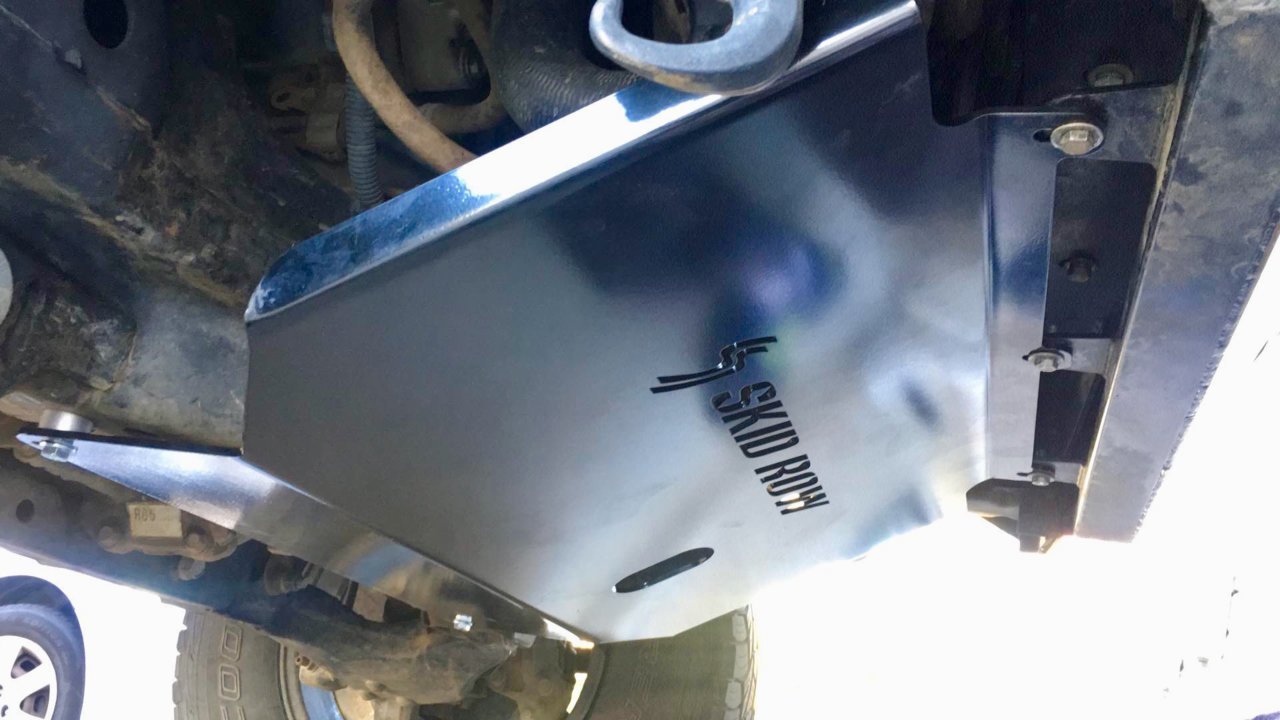

    Got the Skid Row Skid installed this morning. Fit like magic! Now I’ve got a stock skid for sale... the holes don’t line up anymore lol it’s a tad bent... :anonymous:

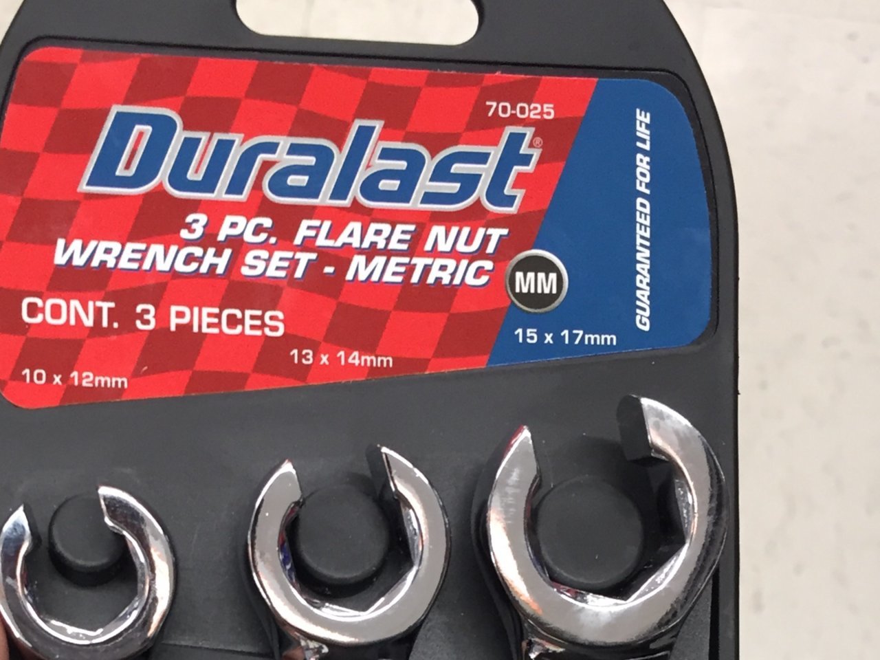

    Now for the carrier bearing. The new one looks identical to the old one in size and quality. Made some Sharpie marks to front and back direction. Feeling good on this purchase.
    All bolts/nuts are 14mm except very front flange bolts are 17mm and the nuts are 14mm.
    I did a dry run on one of the bolts. The wrench box end felt loose (only engaged two sides). The other side (12 point) was loose fitting as well. Not feeling good about possible stripping. Went to auto store and saw some flare nut wrenches that look like they would engage 5 of the 6 sides of the bolt/nut. They are a little short on leverage though.
    Last hurdle to cross is the Cardan Joint where only a wrench can access. No socket with universal adaptor will fit in there as is very tight which means I need some type of lever bar. Question is: Do I use the flare nut wrenches? Or, the metric 12 point?

    Flare nut or line wrenches are intended for fuel or brake lines because they have 4 points of contact and less chance of wounding the nut off. I love them and use them on rusty/old bolts on the Duster project. If you can’t get enough leverage, slip the handle of your floor jack over the wrench and pull away. Or use a rubber mallet for some convincing.

    I added a tonneau cover yesterday. Got it for a bill, ive gotta replace the handle and paint it. But for now, I can move forward on building my box
